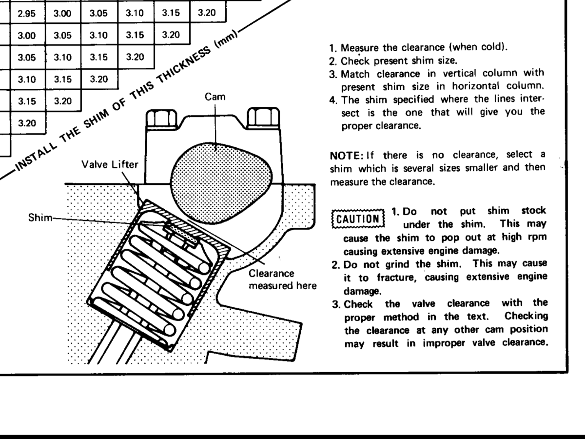

ThatFiveOhTho wrote: Yes, factory spec. B8ES if I remember correctly.
The new valve cover gasket has been ordered. Just to clarify, I looked in the manual and came up with a different photo then you.

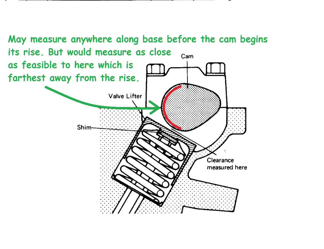

I do it this way.

Haha don't get me wrong. Not trying to beat a dead horse, since I've already checked with the cam pointing directly away, and more then likely I'll be checking at more than one angle and recording it. Just getting tired of buying valve cover gaskets. ;)
I read somewhere else of someone getting different clearences based on cam position. We will see though.

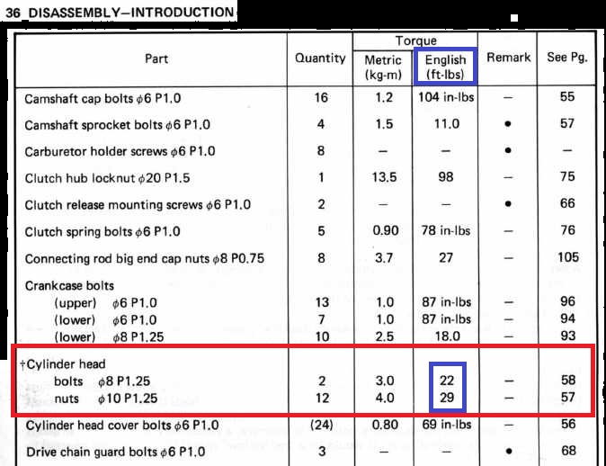

So, kind of unrelated (maybe.) But I seem to have an oil leak from the head gasket, on the left side of the bike. I cleaned the oil off a few days ago and it's back. I'll probably retorque the head nuts to a full 42 ftlbs before the valve clearences are checked next weekend.

Isn't that too much. Mine says 30.

ThatFiveOhTho wrote: So, kind of unrelated (maybe.) But I seem to have an oil leak from the head gasket, on the left side of the bike. I cleaned the oil off a few days ago and it's back. I'll probably retorque the head nuts to a full 42 ftlbs before the valve clearences are checked next weekend.
Holy cow - Where in the world did you see anything that stated 42 ft lbs? You really need to consult the Kawasaki Service Manual before you ruin that engine. Here's a cut & paste from the torque table. Ed

I remember reading it off of a post regarding the very same issue, probably a different bike. I would have checked the manual regarding torque specs when it was time to do them but I appreciate the snappy correction none the less. Is the procedure still individually loosen a half turn and then retorque to 29ft-lbs or am I fudging that up too :laugh:
