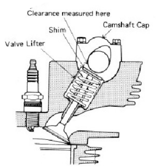

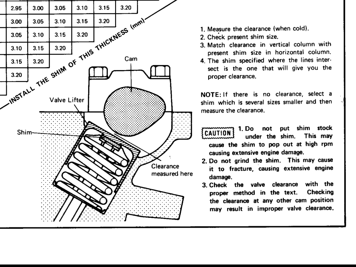

The new valve cover gasket has been ordered. Just to clarify, I looked in the manual and came up with a different photo then you.

To be honest I don't think they were boiling. Hot maybe but I realized the battery makes the same noise that the carbs did that night.. probably not a coincidence since fuel didn't boil when I added it manually. Also I've edited my previous message in what I found in the FSM.
