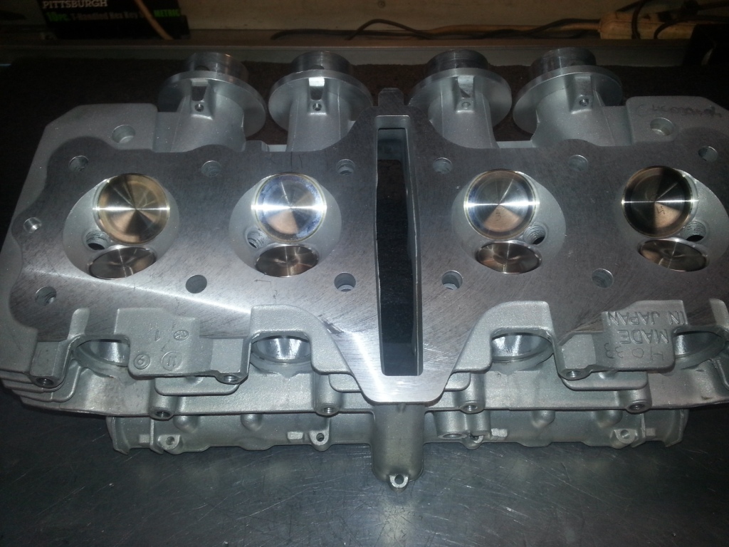

Here's a J head....see any squish left in it?
To be fair it's setup for a 1428 drag bike and also has 40 / 33 valves.
The point being that little bit of squish in a stock J head isn't a huge factor in making HP.

LarryC wrote: Here's a J head....see any squish left in it?
I understand the small amount of squish area doesn't mean a lot, but at this point I'm willing to go the extra step with zero deck clearance to give me the .040" squish.

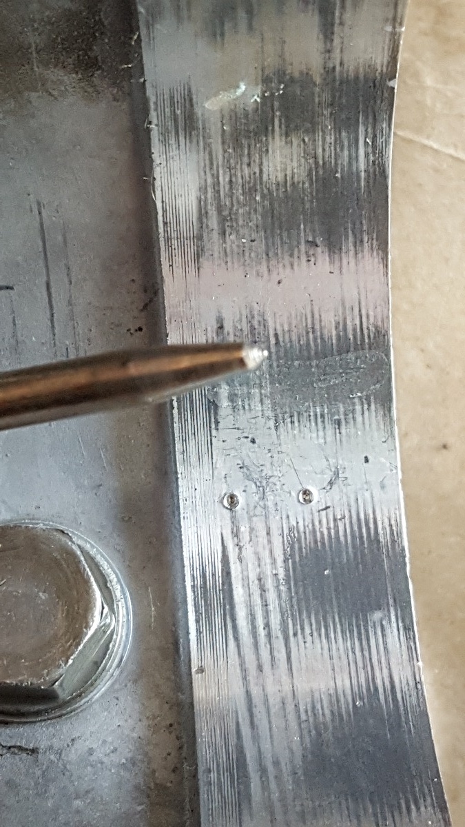

OK. Plastigauge came out .0015 - .002 across the board. Used a small spring-loaded punch on the main cap and the mark raised the surface about .003". With a second shot I get about .0045".

Pic, I used three.

If I lay the cap on the crank it now pivots slightly, Originally it sat flush with no tension on the bearing. With additional punches across the cap, and the Loctite it will definitely be tight.

Re: Kawi J engine squish clearance?
20 Apr 2017 15:09 - 20 Apr 2017 15:11
Do no more punches, use some drops of Loctite on the journal or outer bearing surface. Loctite will fill the micro gap and centered the bearing in the journal. Loctite will fill the tension in the bearing journal you are missing and hold the bearing in position permanently.

I did it along the radius. I didn't like the rocking. If I could I would have replaced the main bolts.

I checked the clearance at the trans bearing journals also and got the same thing, about .002". So I'm gonna apply the fix to all.
I'm gonna go with 3 pairs of punches with one shot at each journal. I got the little pivot at the main cap doing that, but I'm not too worried about cracking the case. These are just little dimples that get flattened when you torque them down, as opposed to the additional force if you added .003" of metal to the entire journal. Plus the pivot at the main cap from the twisted crank was huge, and it didn't break anything.
