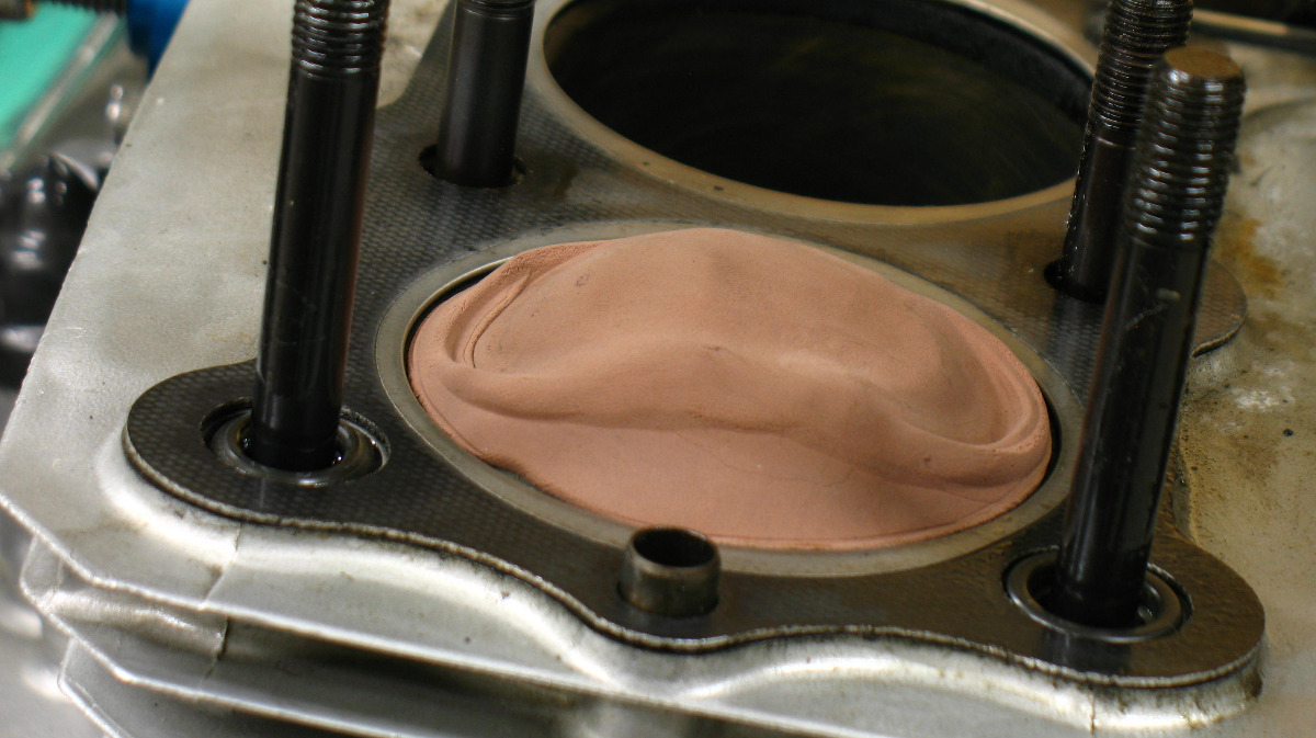

As for the squish. as mentioned, I would just get zero deck height and leave it at that.
I think you are getting a bit obsessed with getting the squish tight at the detriment of other areas of the build when It won't really make any measurable difference.
The width of the band created by the overbore isn't wide enough to create significant turbulence and if you want to build an engine with effective squish you need to start with the 83 onwards 1100 Unitrack with the bathtub twin swirl combustion chamber as these have a substantial squish area machined in with pistons shaped to match.

Note the clay shape in the pic below, which shows the actual squish area/combustion chamber relationship of the bathtub head and Std. J-pistons as it exists in my engine.

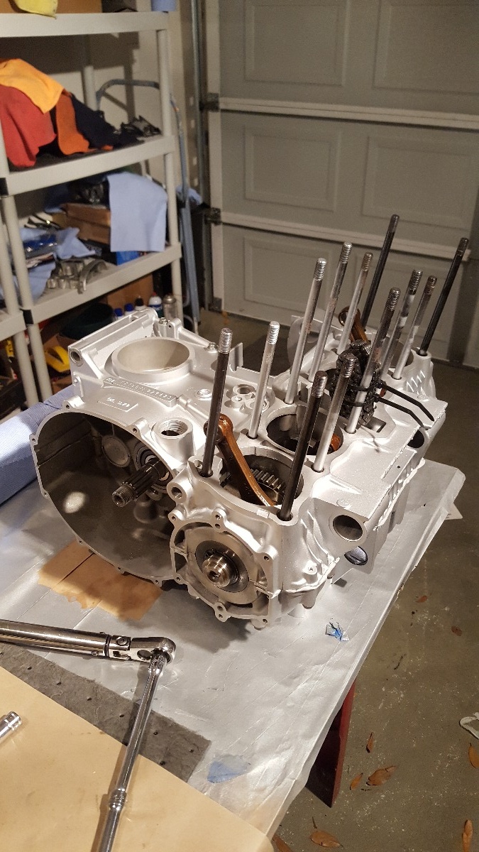

Re: Kawi J engine squish clearance?
03 Apr 2017 17:59
OK. Finally got everything in and the bottom end will be assembled tomorrow. Next I'll bolt on the block and head with a piston to check squish.
I'll use the Cometic gasket to test. So anything above .043" with be my deck clearance.
I have .060" rosin core solder. Is that safe to use? I heard someone say hollowing out acid core is softer and safer.
