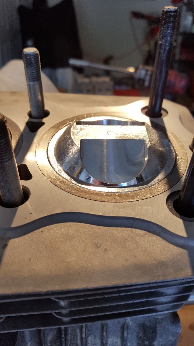

Can't get the OEM paint off the new case with paint stripper, and trouble finding someone local to soda blast it. So I went ahead and assembled to check the squish.
It was tough placing the solder because there's only a few mm of head deck that overlaps the bore. But I have about .041" squish with the Cometic composition gasket, which is .043" thick after torque. This means I'm already a couple thousandths negative piston deck clearance. I confirmed that after pulling the head and the piston at tdc is still flush with the block deck.
Now here's the decision. I don't like the Cometic comp gasket. I can use the OEM gaskets at about .050" thickness giving me .048" squish, or the Cometic MLS gasket with a thickness of .040" giving me .038" squish.

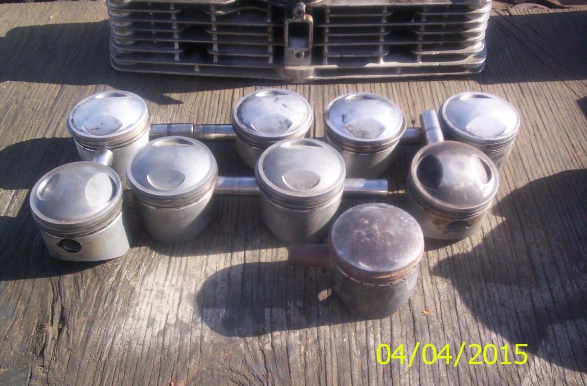

Don't know the actual compression without cranking or volume testing, but these are MTC 10.5:1 pistons. I'm no engineer, but I don't see an advantage in grinding off the head deck to equal combustion chamber to bore size. Correct squish is a good thing, and these heads have very little squish area to begin with. Taking that metal off definitely lowers compression. How much, I don't know.

Don't know. Maybe better with flat top pistons?
