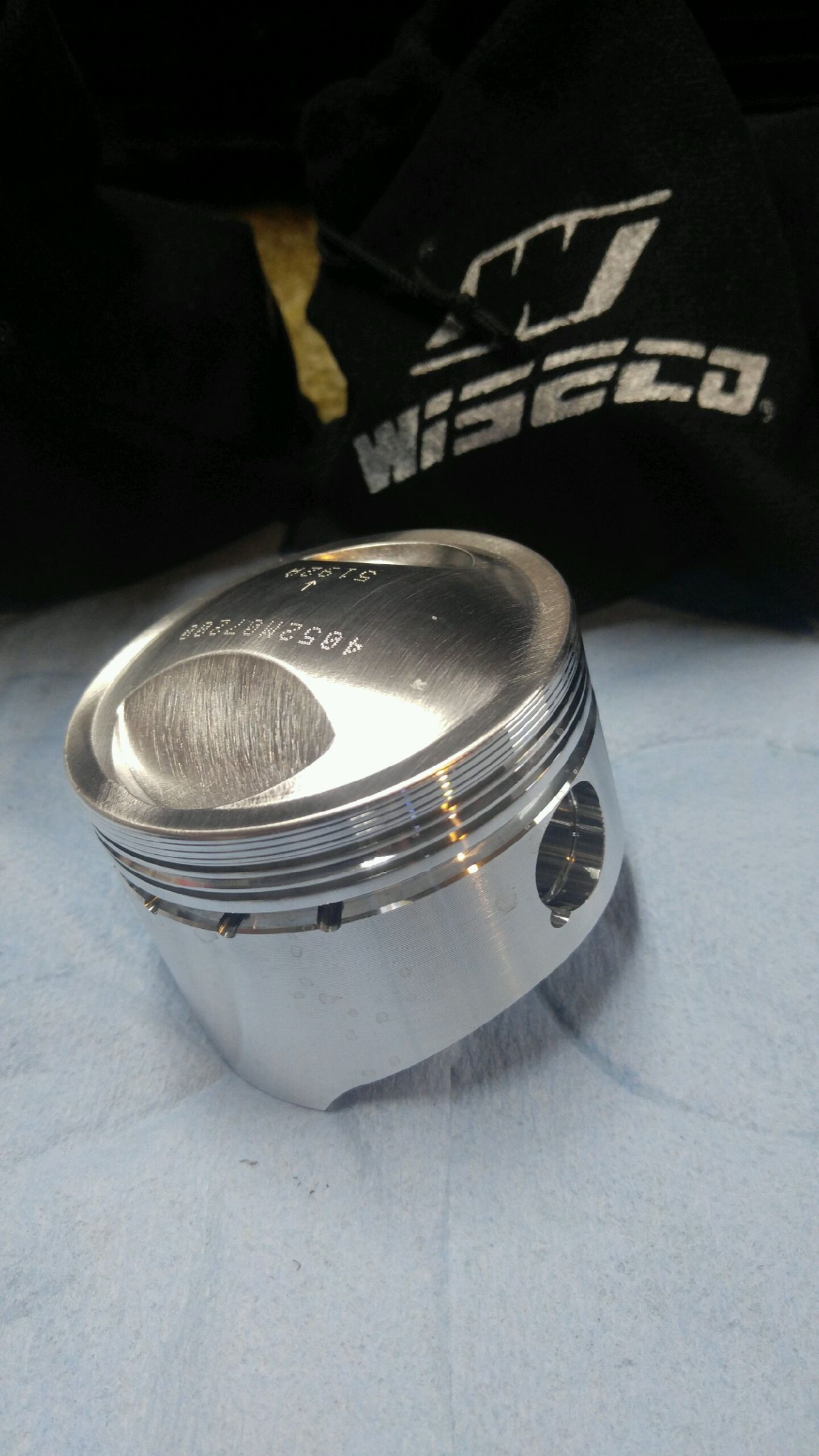

Ok, so some good news at last, my cylinders are round!
They are within spec to still use a 72mm piston.
I placed another order with z1 ent. For my piston set and timing chain rollers. I was hoping to get more done on my 2 days off this week but it wasn't in the cards.
I went with the forged 10.25:1 pistons and I'm looking forward to getting this thing back together next week.
While I'm waiting on parts I'm going thru the brakes and removing the brake dust jello from inside the calipers, lubimg the slide pins etc, etc.
Then I'll move on to installing the dyna s pickups.
Spent more cash than I wanted, but that's nearly always the case.

Ok, some progress.
Pistons are on the rods, evil wiseco pin clips installed
Cylinder block on, head on, getting ready to tackle the the buckets, shims and cams.
A microscope was needed to see the damn timing mark on the exhaust cam, that's a sick joke papa Kaw!
Anyway, it's starting to look like a bike again. Can't wait to fire it up and see what mistakes I've made :silly:

:woohoo: today was a good day.
At about 10am this morning I was holding my new pistons in my hands.
At 11:56pm the bike was alive again!
Fired right up, let it run at about 2k rpm and come up to temp. Ran it for about 5 minutes on the stand with a fan blowing on it, shut it down,
Going to let it sit all night and retorque in the morning.
I'd like to thank this forum, Z1 enterprizes and my visa card.
