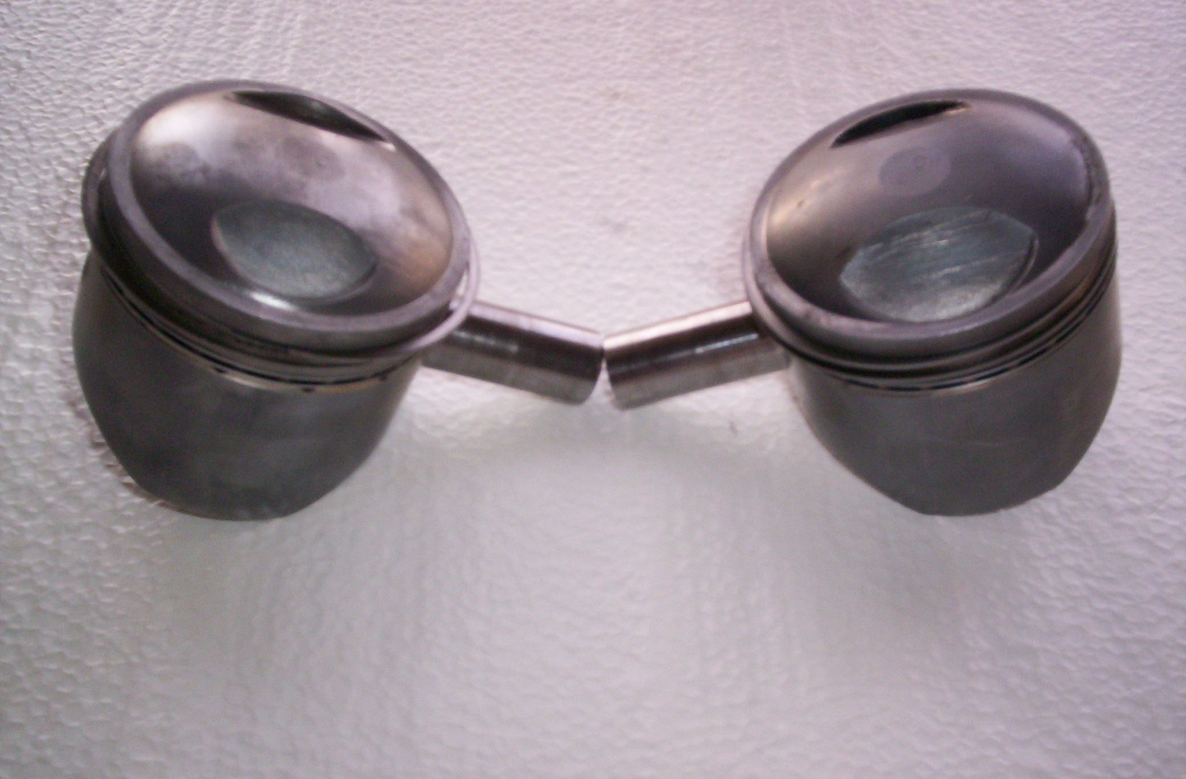

Re: Low compression, oil out the breather. kz900/1000
11 Jun 2016 06:48
Looks like a big bore kit has been installed. I wonder what other goodies are in it?
- MadShad
- Posts: 232
- Thanks: 8
11 Jun 2016 07:24 - 11 Jun 2016 07:25
I know it has at least 1000 pistons in it because of the kz1000 cylinder block, outside of that I have no idea.
That's one helluva dome on those pistons! (keep in mind this is first kz engine I've ever had apart).
The cams looked like it was in decent shape and didn't look to me to be any crazy hop up parts but I've not measured anything yet.
Also i read you could identify the head year by looking at the cam guide chan holder so I'll attach a pic of it as well.

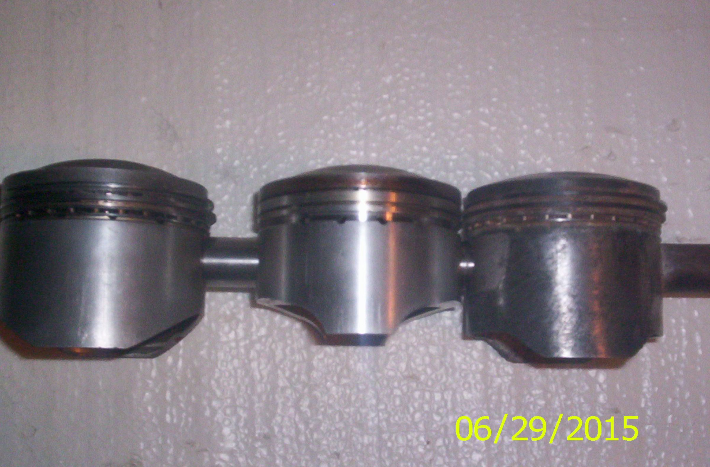

11 Jun 2016 07:33
These are the cast 10.25/1 pistons.
The 1015 billet piston is in the center. Stock is on the right.

Well here's the problem (or one of them)
