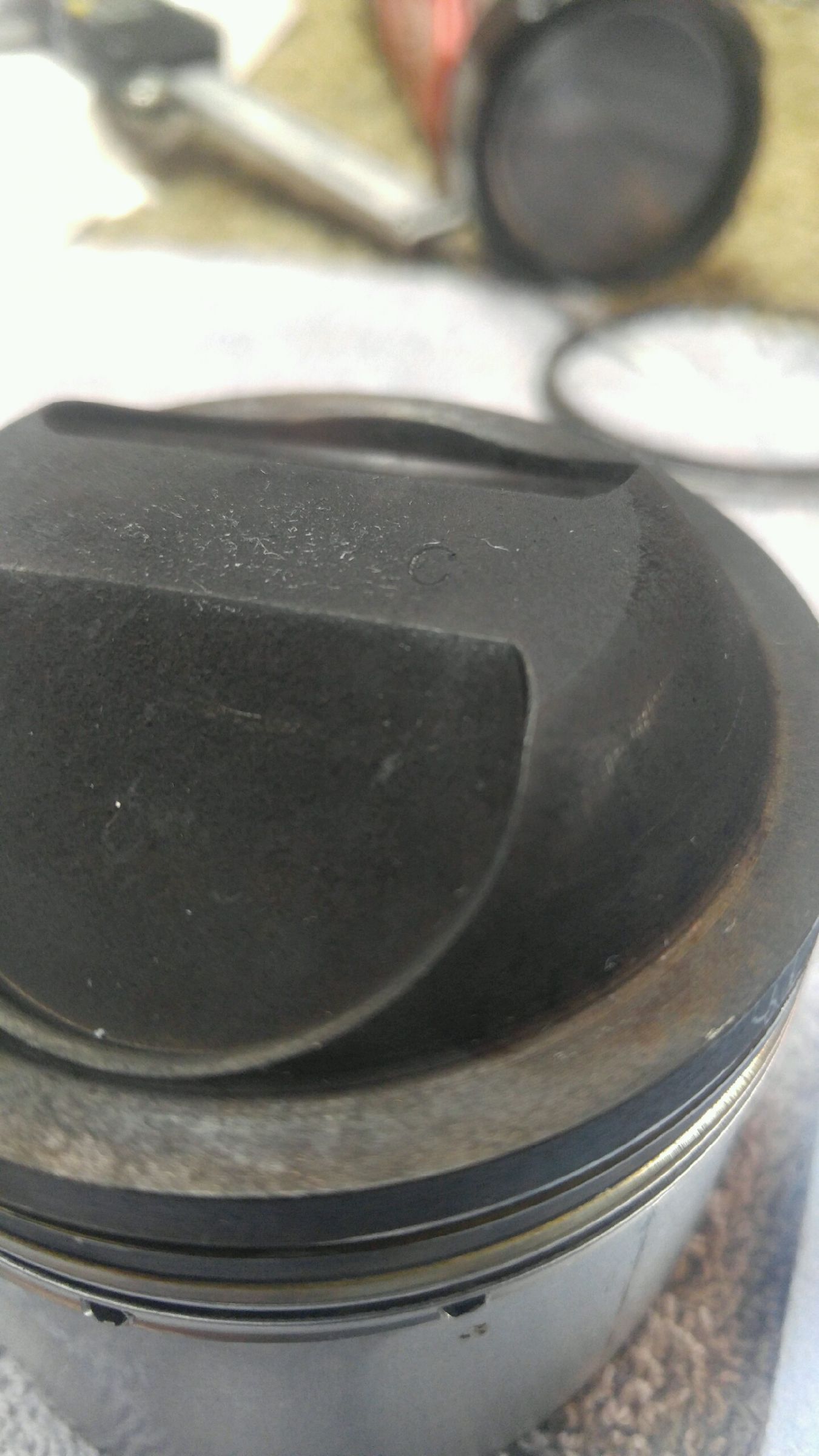

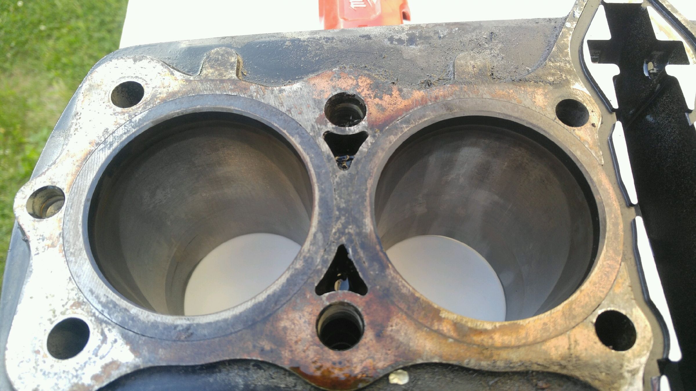

What am I looking at?

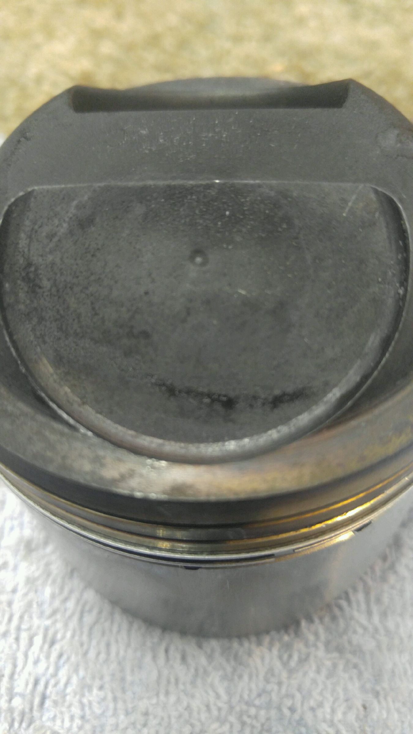

You are looking at the shiny spot on the ringland between the top 2 rings that's worn and shiny.
The top ring was fine, the oil ring was fine.
The middle ring was stuck.

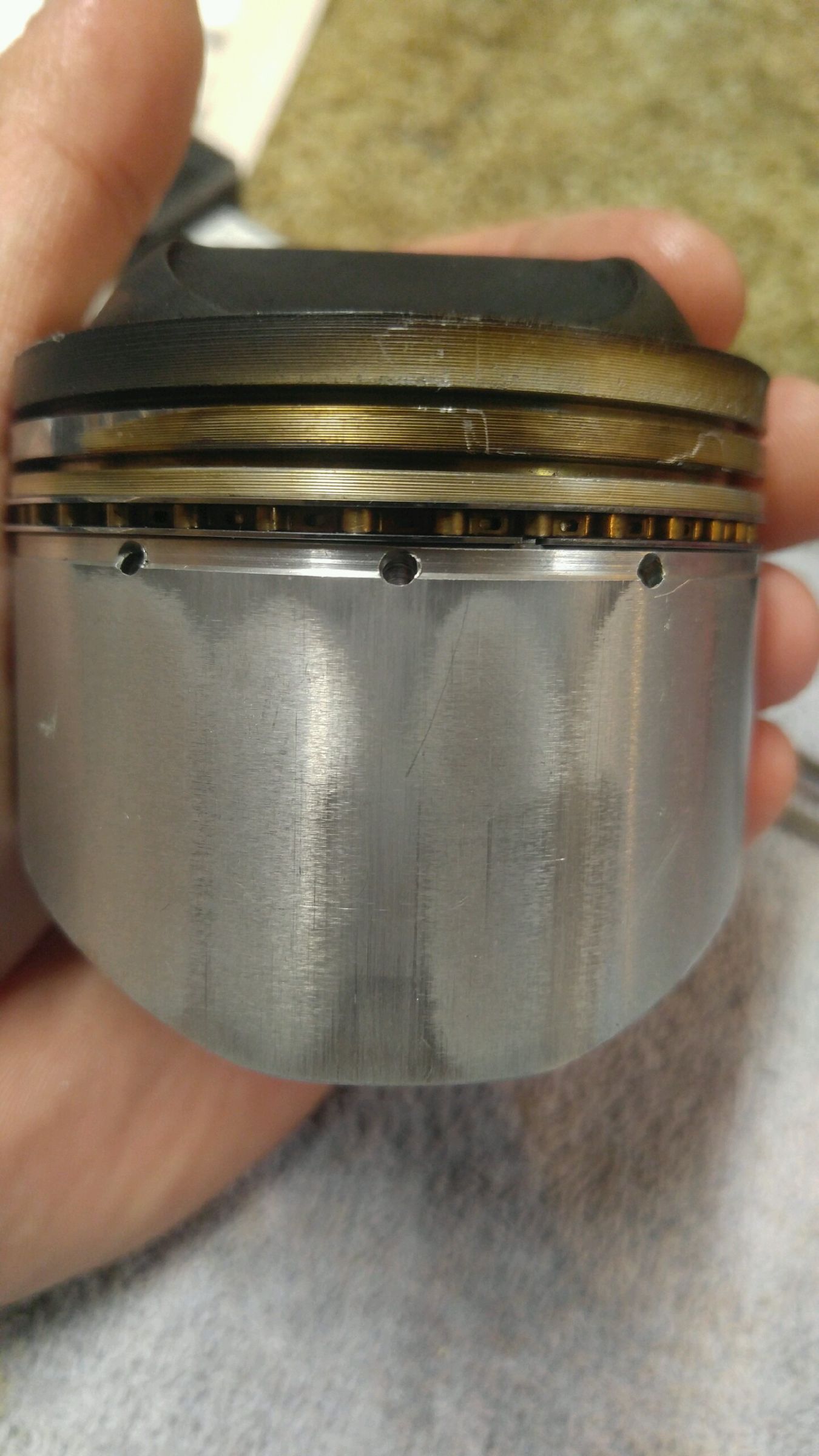

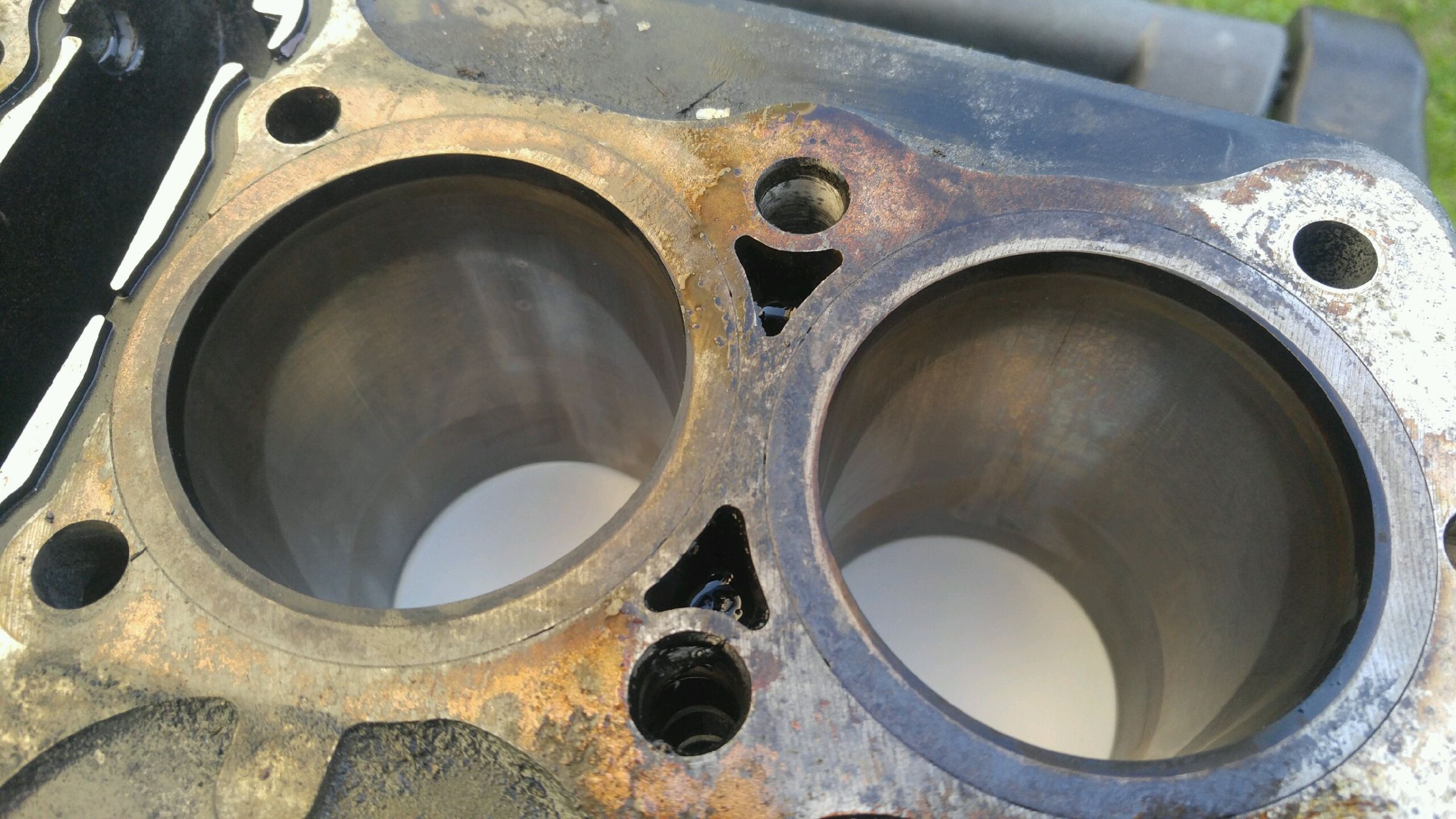

Doesn't look too bad to me. What do the piston skirts look like and the bores? Also the combustion chambers.

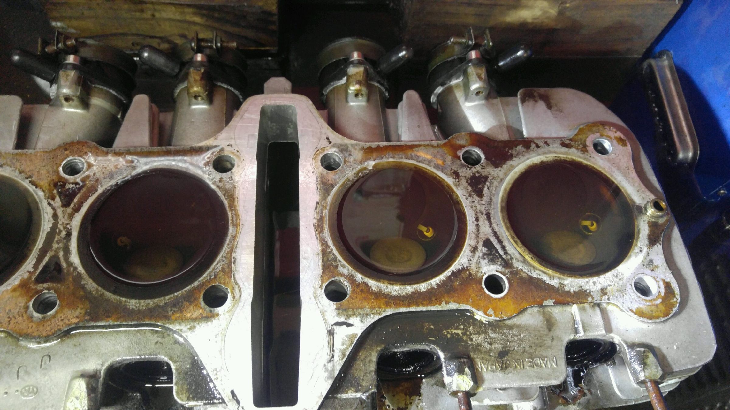

Here ya go.
The chambers have been holding kerosene with no leaks for about 5 hours.
#2 cyl had low compresssion and a very tight intake valve, so i hope that's the cause.
#3 cyl was leaking down into the case, stuck ring.
The bores and skirts look ok to me (yes they could always be better).
I still need to id the piston, it has some markings that I'll try to upload in a bit. They measure 71.5mm

I'd take a good piston and measure them upside down in the bores top, middle and bottom with a feeler gauge. Could be new rings and they will be runnable.

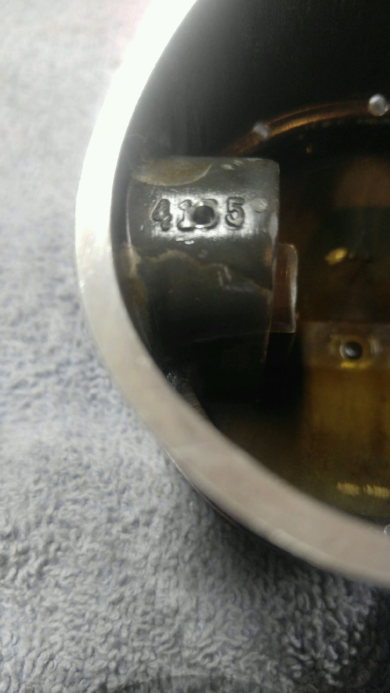

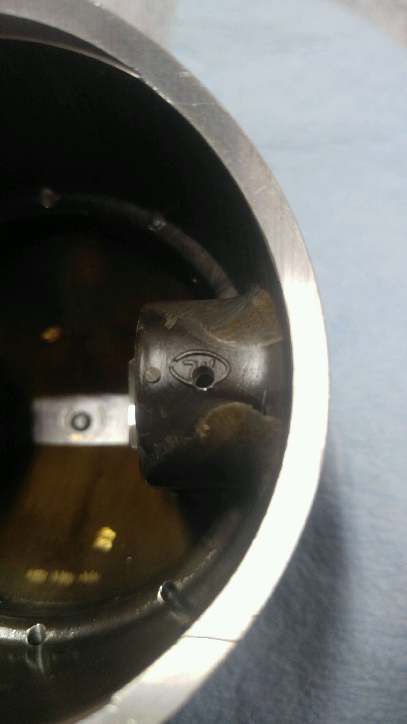

"C" stamped on the piston top.
"41?5" on one side and "7?" on the other on the bottom where the wrist pin goes thru.

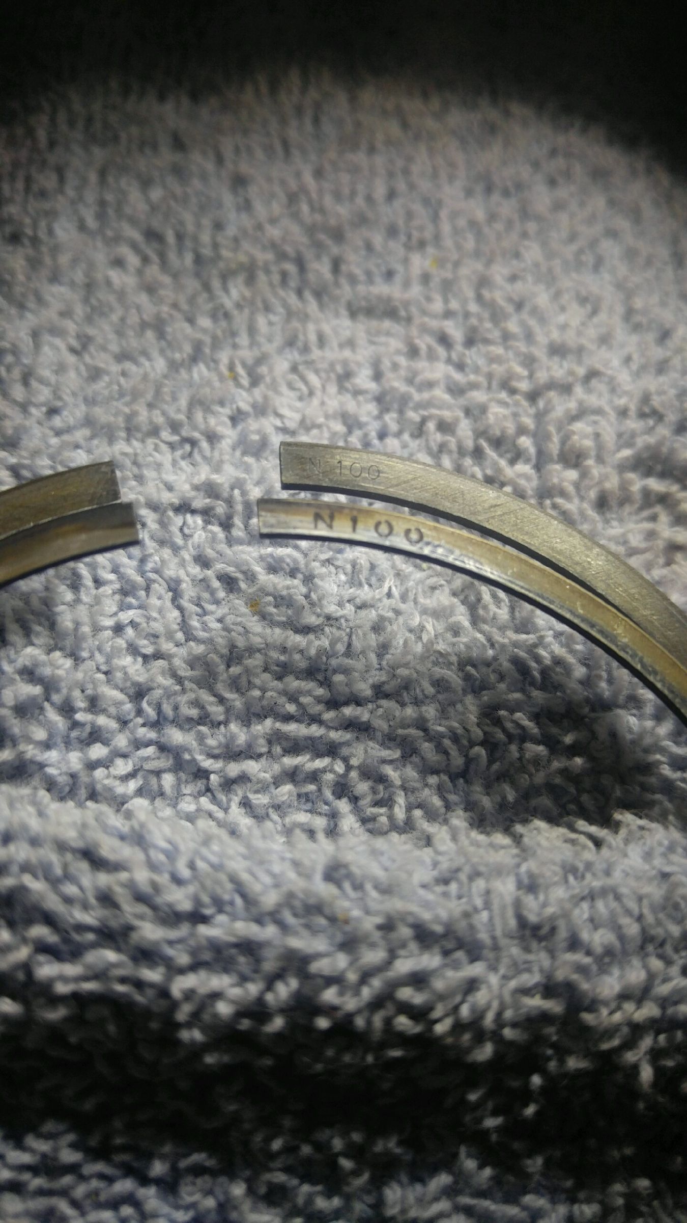

What is that ring in the valve pocket? MTC pistons?

11 Jun 2016 18:56swest wrote: What is that ring in the valve pocket? MTC pistons?
I'm afraid you will have to tell me, haha! It's my first rodeo!
Both rings are marked "n100".

Maybe nothing. Might be too many dry starts.
