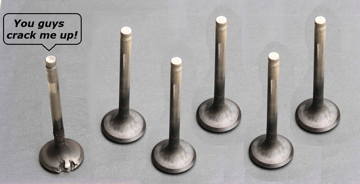

Indicates failure of the intake valve to fully seal (for whatever reason) when it's supposedly closed.
Often, but not always, remedied by adjusting clearance of the intake valve to bring clearance within spec.
What happens is that part of the combustion inside the cylinder escapes through the leaking (not fully sealed when supposedly closed) intake valve and goes out backward through the intake port and into the carb.
