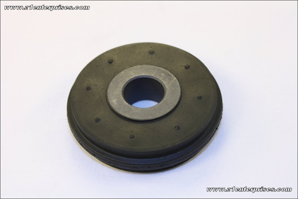

i think they look pretty good, I should hone regardless right? I also noticed one of my idler sprockets is missing rubber and the other is wearing down. I found some replacements that aren't quite as worn on ebay but wonder if it's necessary since some aftermarket ones i've seen have no rubber at all. I don't mind the bike being noisier if that's the rubber's only purpose. The rubber dampeners are also rock hard and I'm assuming should be replaced

They should all be replaced.

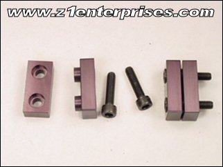

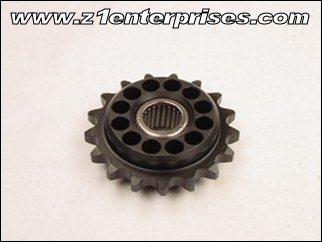

Always give the jugs a 45* cross hatch hone so the rings will seat in. Go to Z1E and buy the Liska rollers. The ones you have will come apart in no time. I broke a cam chain that way. These will last two or three rebuilds.

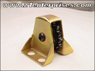

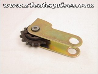

Are all those components compatible with the kz650? I don't think I need the last piece do I? here is the diagram
Attachment cam_chain.jpg not found

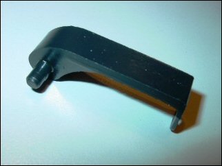

If you replace the chain you need to split the case or go with a chain link which I was talked out of doing.......... the o ring you need is 92055-101 and the oval one for the head is 92055-111 I have a KZ parts catalog I picked up on Ebay that lists the parts and numbers but Partzilla is also a good place for break downs and part numbers. And correct the last pic is for a 1000 tentioner which you don't use.
I replaced #12 with a liska and got a NOS rubber #10 off Ebay..... #4 I used over....... the 2 sprokets #5 I don't think are avaliable although I could be wrong but won't be cheap. I re use those too. (Never mind on the sprokets I see you know about them). Do Replace the #6-#7 and #2 rubber blocks and think about the #20 spring for the chain tentioner too my was way weaker than the new one and cheap.
