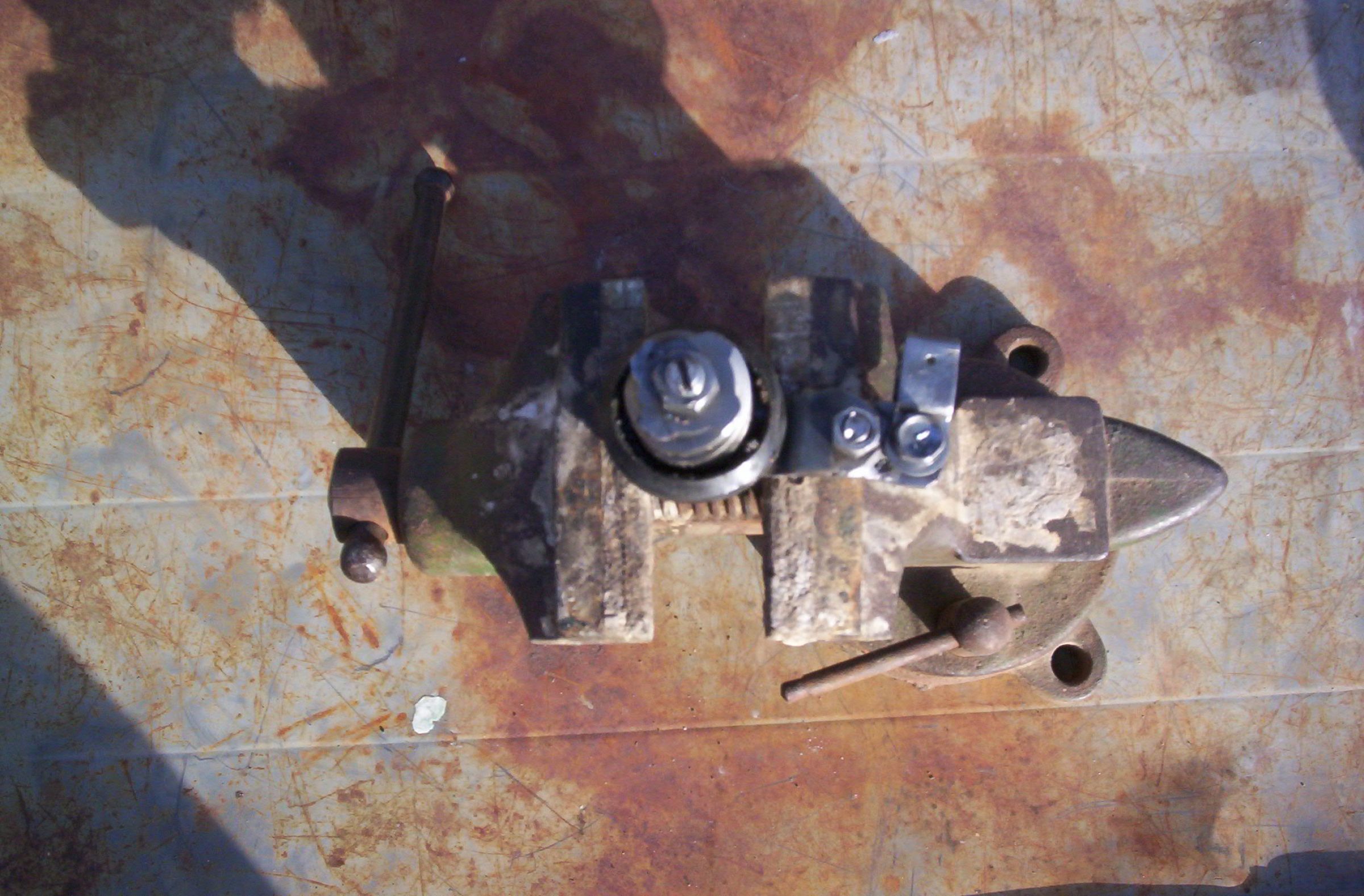

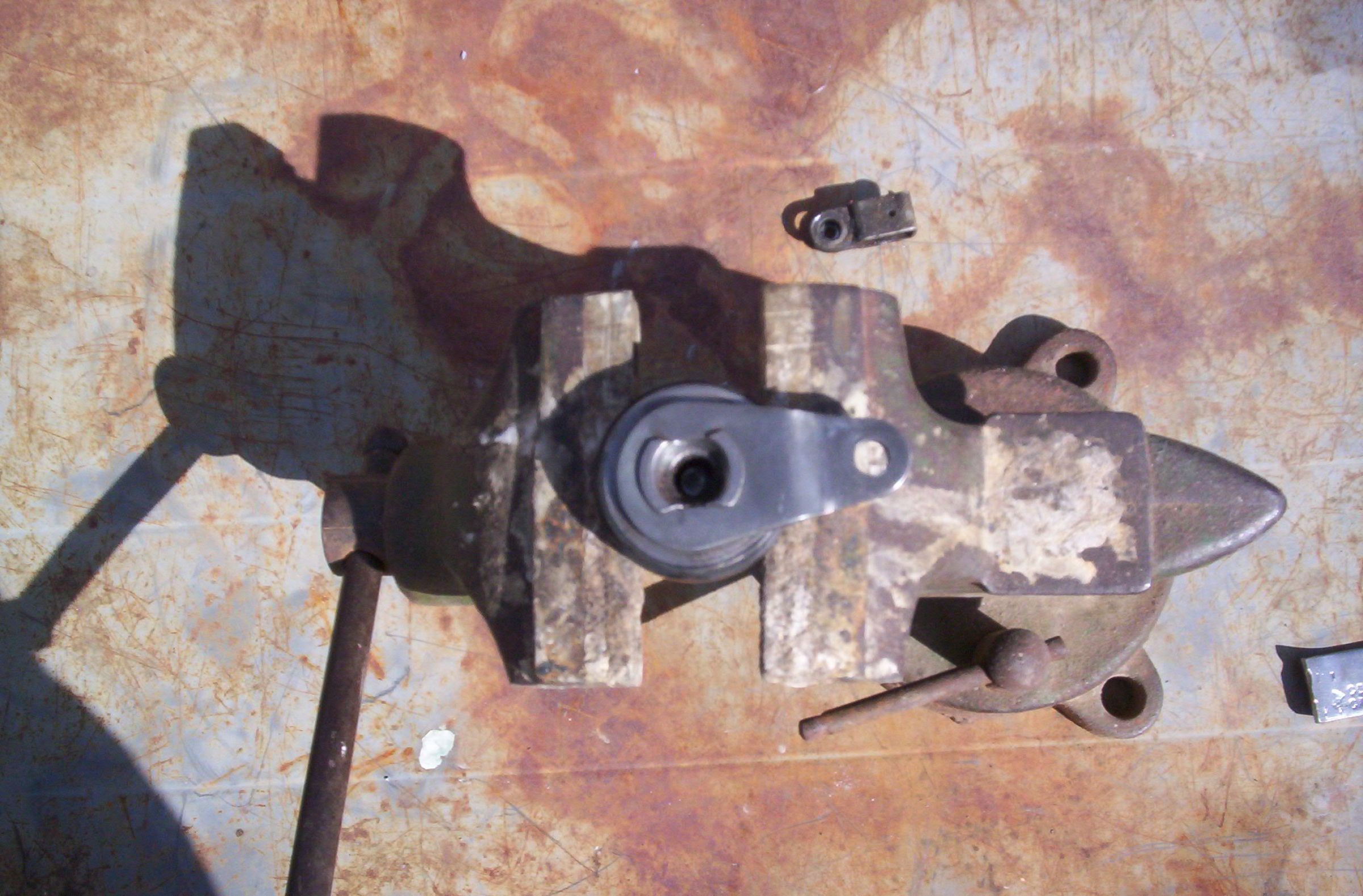

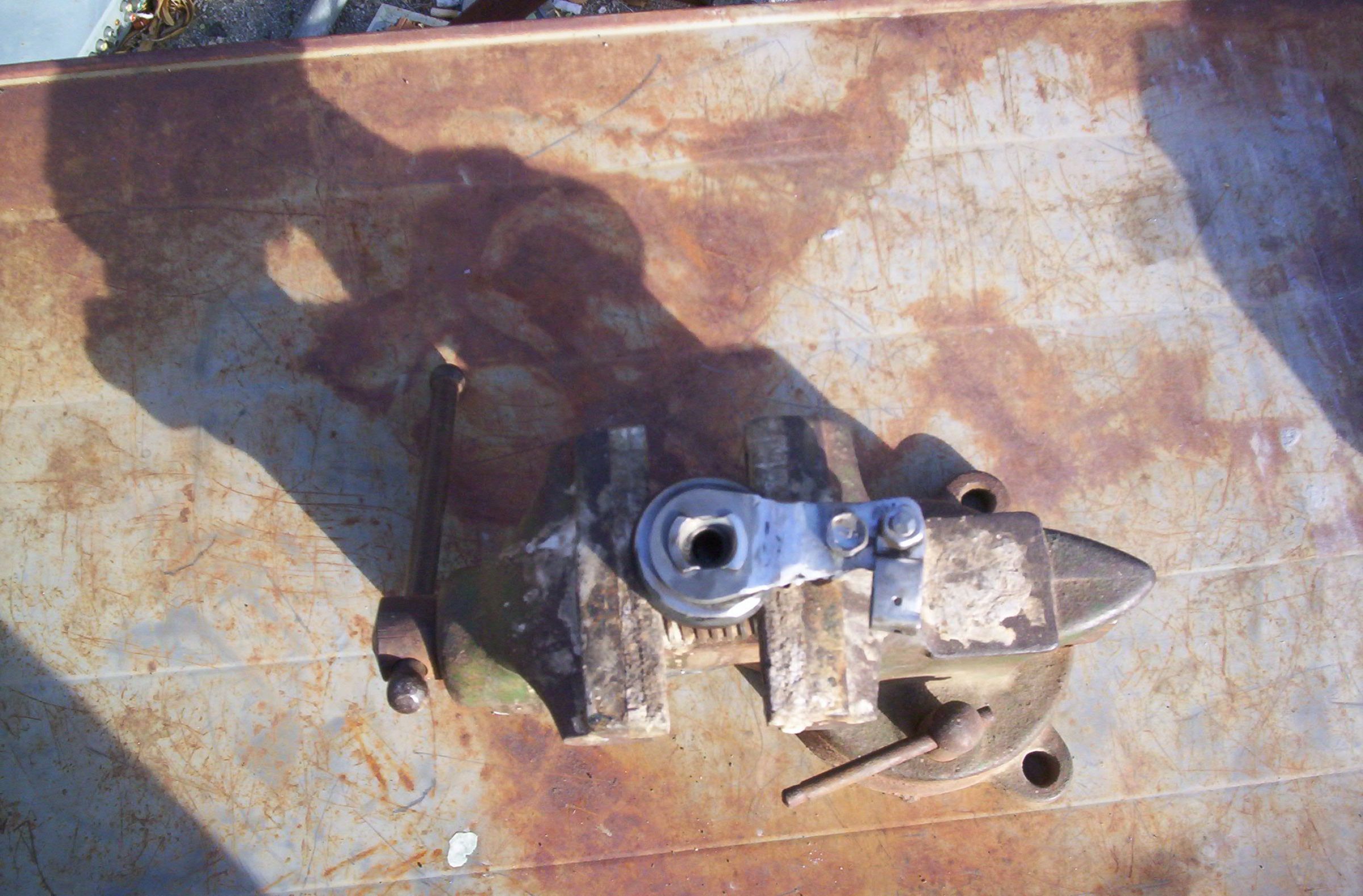

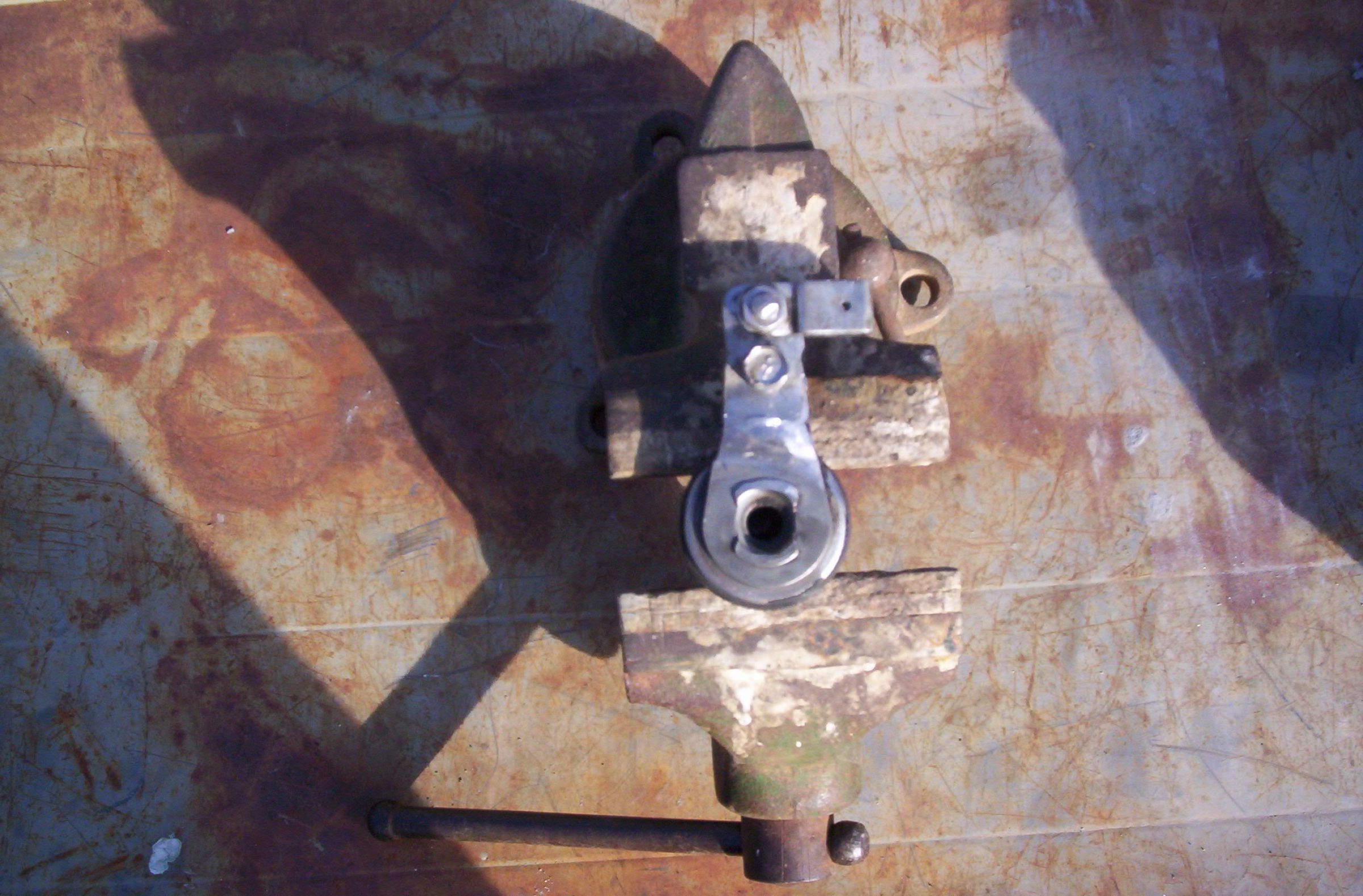

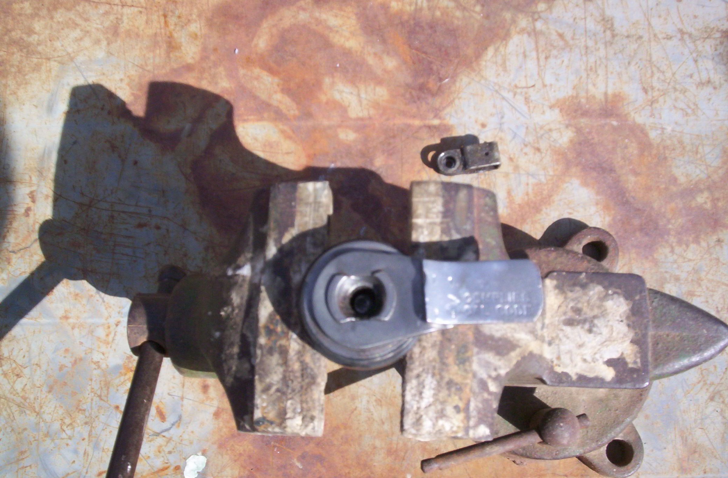

Thanks to zukedave for the idea. Last year when I bought the clutch basket and clutch assys, I also got the sprocket cover complete with the actuator assy from the same bike. KZ900. Dave told how he modded his so it wouldn't be so stiff and he had more control. I'm tired of my stiff clutch and going through cables every two years so I decided to copy his idea. This is what I came up with.

Why does that help? Is it because it's longer so more leverage?

That's the idea. It was getting dark so I'll put it in in the morning and see how it works. Like all mods there will probably be some adjustments.

Looks good. I find the lever has more movement than necessary, so this should work well.

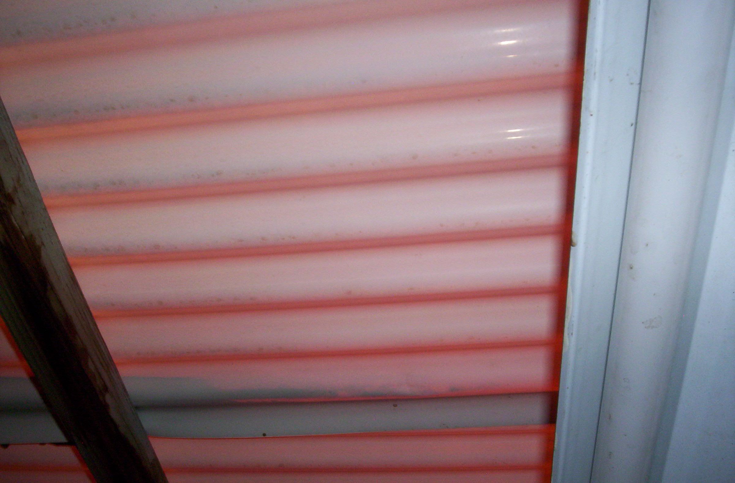

The PVC is what I have laying around. I'm going to make a Quonset hut for the bike with some corrugated plastic sheets. I'll try to get a pic while I'm there.

This stuff is great. I used it on my daughter's green house 17 years ago and now it's Bossie's shed/tool crib. Last year I threw together a shade cover on the front so I would have a place to work on her out of the sun. It doesn't radiate heat like sheet metal or plywood and is fairly cheap $21 for a 2X12 sheet. Bossie's hut will be 10X12 and three sided next to the house. The shed is right next to the road where the local Meth Heads can get at it.
