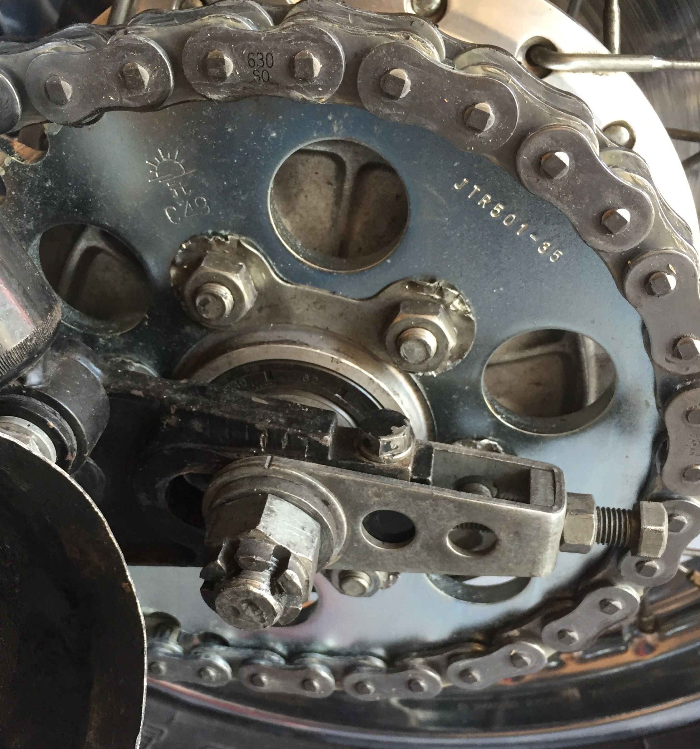

Regardless, tonight, I just put my brand new 15/35 sprockets on with my brand new 94 link, 630-SO chain!
Zero test miles yet as I am repacking my Denco header collector tonight too ....
and is this crazy ass old bitch, with the 1075cc 10.25:1 pistons is loud as Hell with out the baffle in!!! :ohmy:
Anyhow, my axle adjuster notches are right at about the 4th groove/notch from the fiont, or the marks on the swing arm that would be in front of the axle.
That seems to put the axle a little further back then I remember with a new chain.... the old 630-SO chain and rear sprocket are both scary worn out so there is no use in comparing the two.
Which leads me to the next question, I wonder if I should drag the grinder and chain breaker out to take the other two links off in order to pull the axle further forward?

Being this is my thread, I don't mind if it goes off topic a little. I'd take out the two links and make it 92. With my 16T I was at the beginning of the adjustment. After 1350 miles, I still didn't need to adjust it but put on the 15T. Plenty of adjustment room to go. This is what I wanted in 13 but the 15 year NOS O ring chain was dried out and developed kinks, then the Chinese chain GANK, running standard chains (2) until I could get a new set up. The standard chain I had to adjust constantly and was noisey. A little loose is better than tight. Besides, if tight the sprockets will wear faster, Lovin my O ring chain. I'll get a pic of my old sprockets in a hour or so.

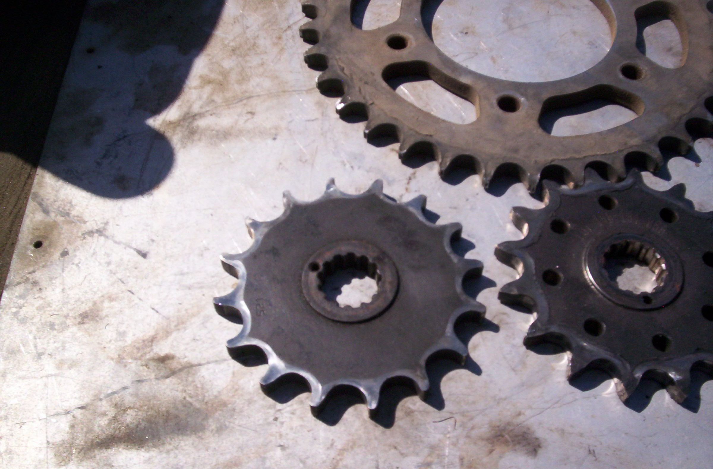

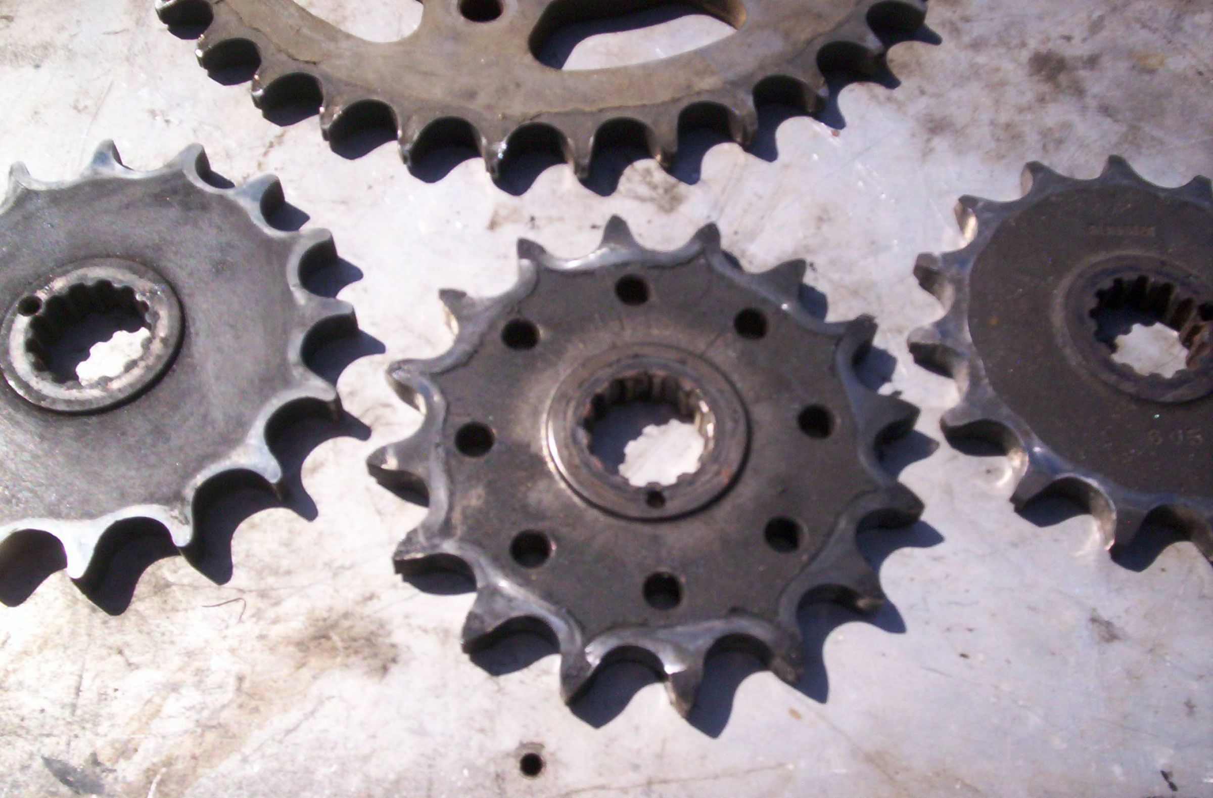

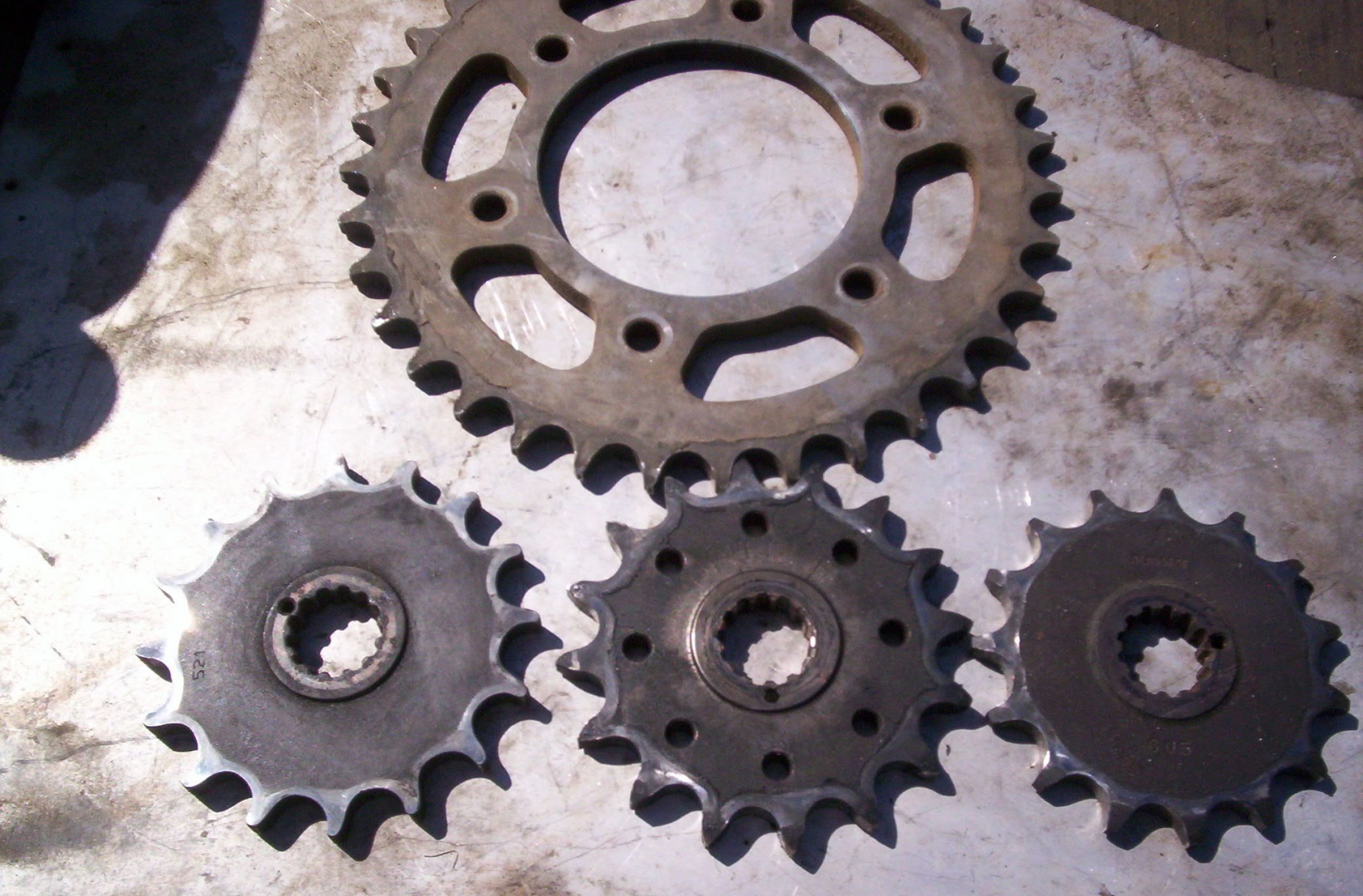

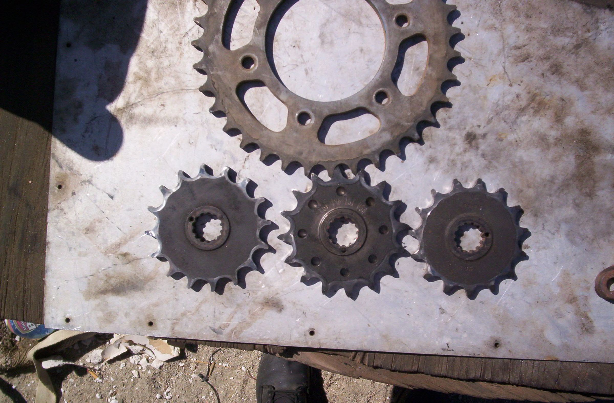

Pics of the old sprockets. Could have used three of them but with a new O ring chain, that would have been stupid.
