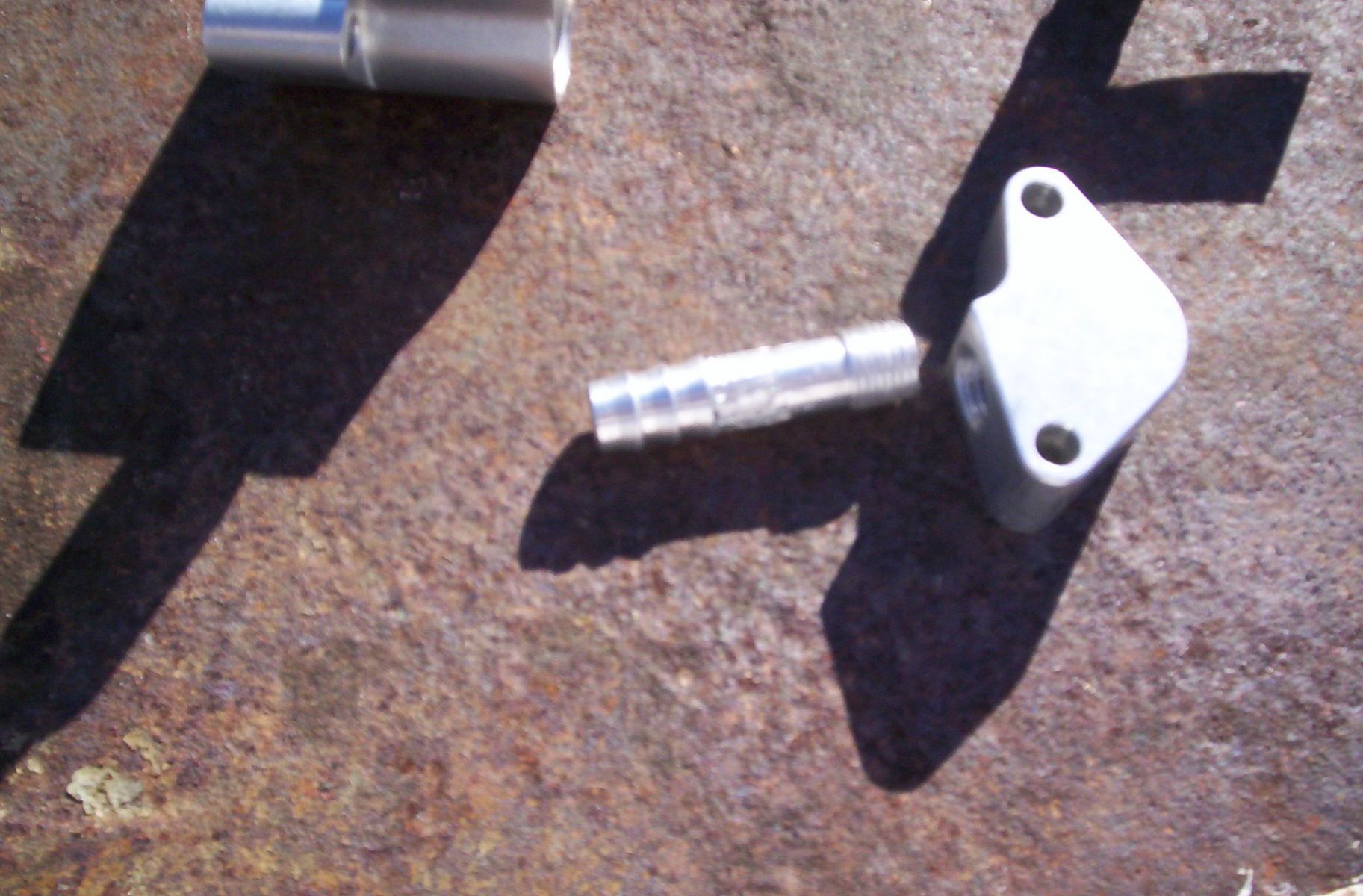

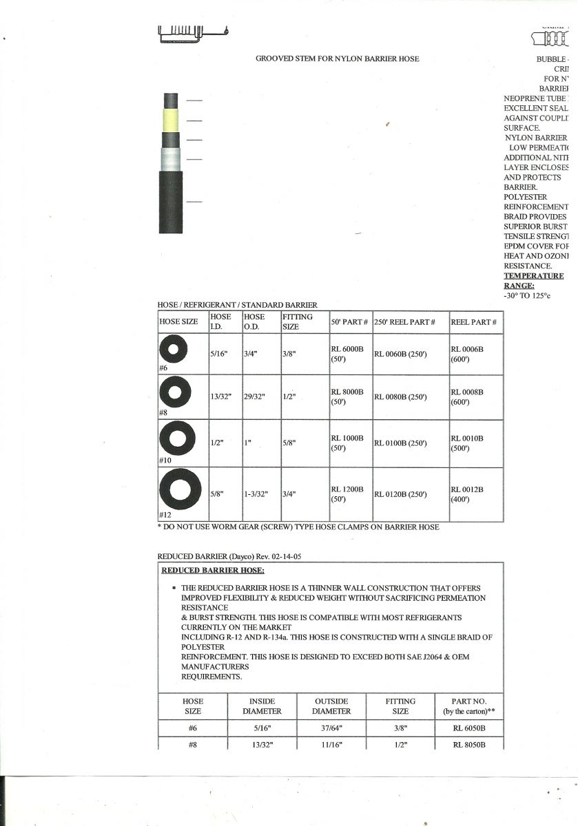

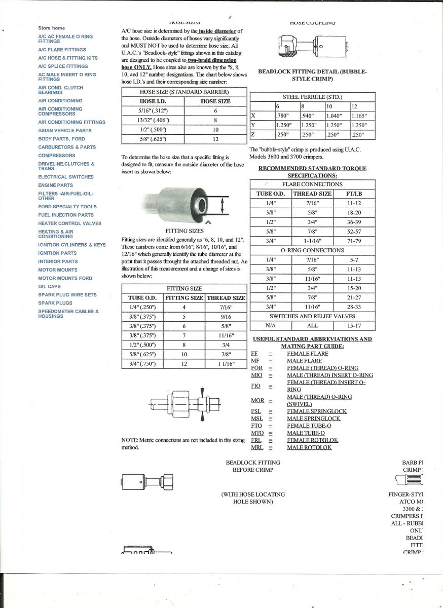

No eBay APP ID and/or Cert ID defined in Kunena configurationNo eBay APP ID and/or Cert ID defined in Kunena configurationHere's a FYI for those looking for odd ball fittings. After looking at plumbing and hydrolic fittings, I remembered A/C fittings come in different sizes and shapes. I ordered the #8 barb fitting and talked to the guy about the other ones. He told me to type in chart so I can download it. He gives them away free with the orders. Nice man. I may be able to get the REAL elbows to fit on the cooler too.

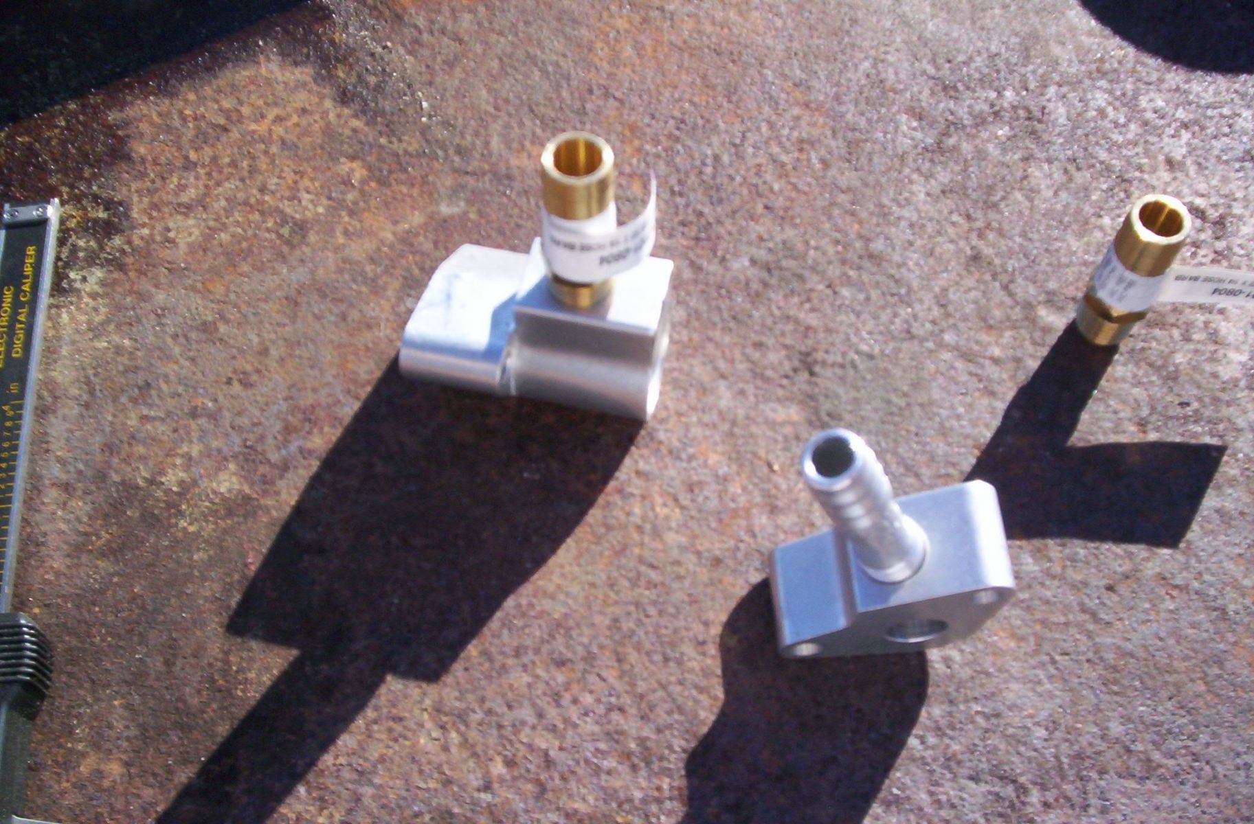

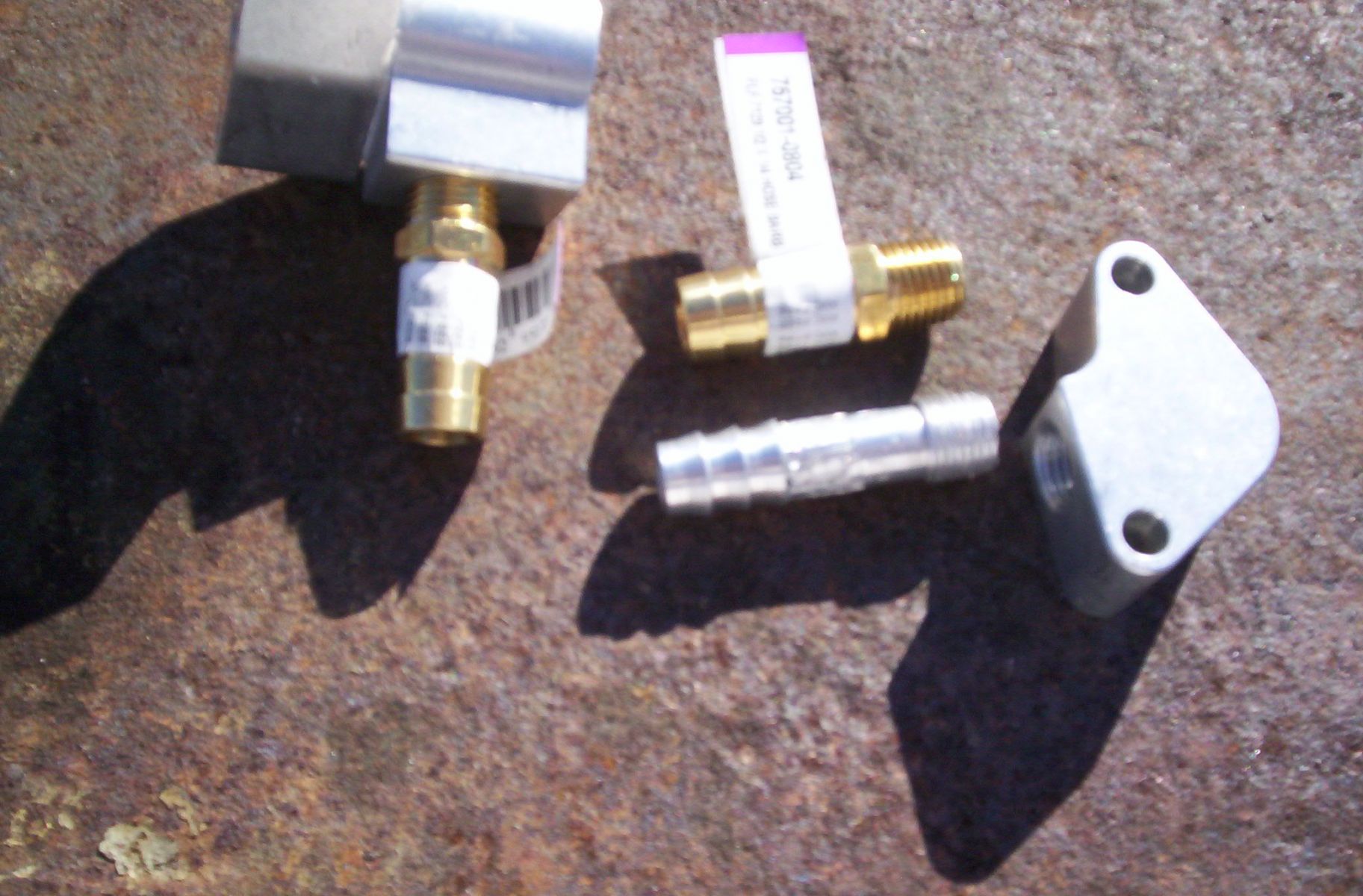

Well, I got the fitting. It's too small. I must be speaking Martian or something. The ID MUST be 1/2"/13mm. Now that the weather is cleared, I can go and chose one myself.

Well they do make 1/4 NPT X 1/2" barb fittings. Just went down the hill to the new True Value and there they were. Much better selection than those other bums. I was planning on getting a double barb, cutting it in half then threading it to fit.The #8 I got was still too small inside. Ready to hook it up. :woohoo:

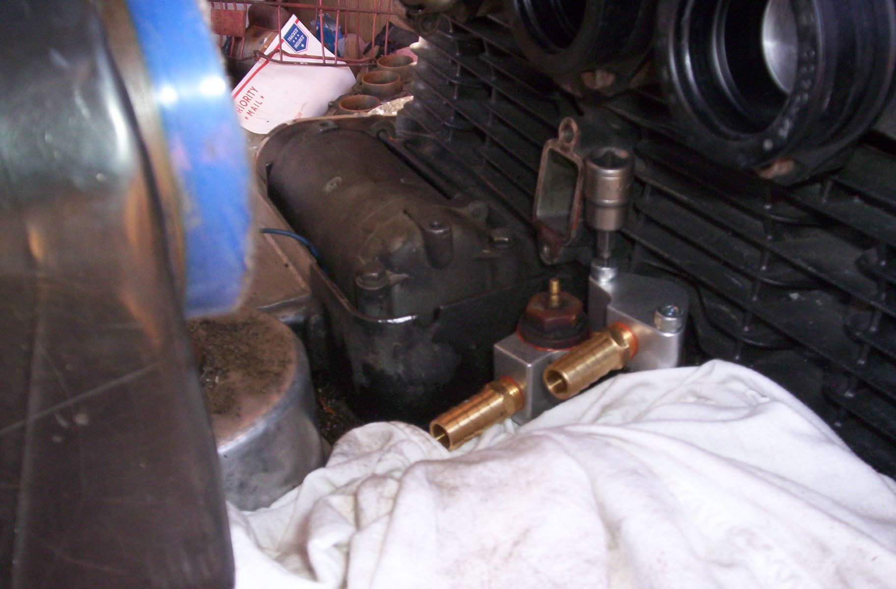

Did a little work this morning, then got it hooked up. Found some 2X18mm O rings at OR. The old rizer was weeping and a small amount of oil was dripping behind the sprocket cover. Another phantom oil leak solved.
Planned on going through the carbs a little more and do the clear tube test. Started getting dark and cold. I put the carbs back on and parked the bike in her spot. The boots are still pushed into the box so I'll do it in the morning. Carb holder screws not quite tight. They are now.
Must have settled in with the heat. I primed the oil cooler until I noticed the level rising in the peep hole. Just under 1 QT. This may sound odd but it seems to have more oil pressure at idle and rev. More capacity above the engine? They say it's going to be 80* on Friday. Hmmm. February is supposed to be our coldest month.
