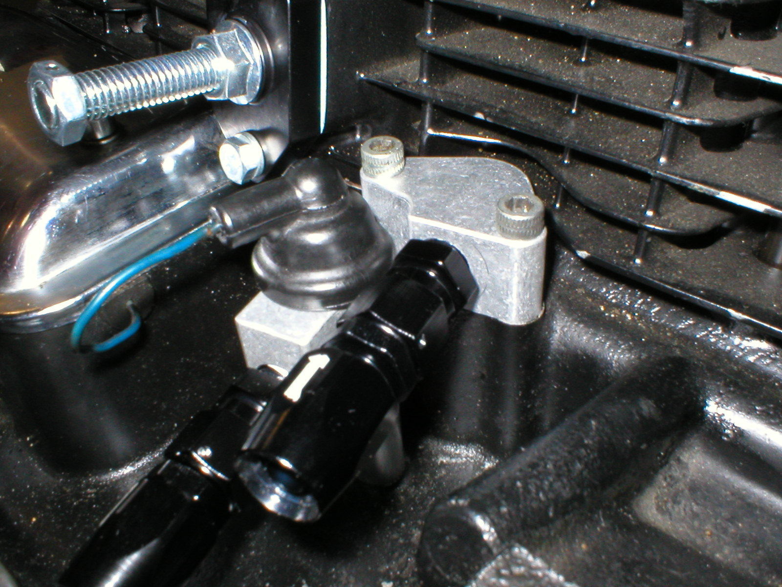

Hey Steve, now I see what you were talking about on that other oil cooler thread. Do your engine fittings actually have a 3/8" threaded hole? That does seem very small. My oil cooler and engine fittings are 1/2" NPT by 3/8" barbed. I knew I had 3/8 hose and was thinking 3/8 threaded also but they are definitely half inch on the threaded end.

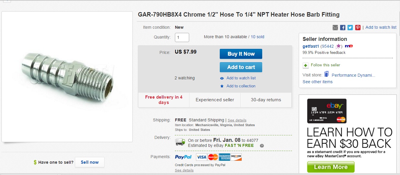

My old ones that were destroyed in the fire were 1/2" barb. The ones I just bought don't have enough meat to drill and tap larger. Can you take pics with a rule to show the sizes? The intakes on the cooler look like 1/2 but the fittings look like 3/8's.

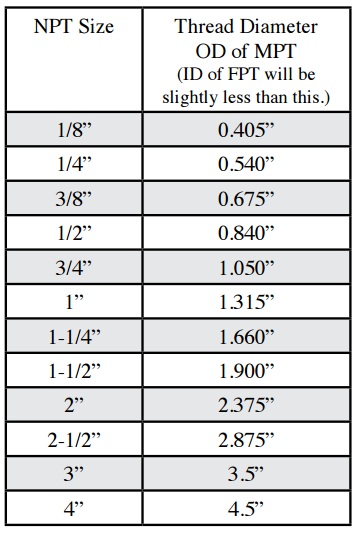

On my set up, the fittings for the engine adapters and the oil cooler are the same. The maximum OD of the male threads is .527. I assumed that was 1/2" but forgot that NPT sizing is very unique. I think the .527 OD is actually 1/4" NPT. So not sure what size they are technically, but they physically measure just over 1/2". The ID of the female threads is .437". That is at the tip of the threads, the smallest part of the hole.The barbed portion for the hose end measures .375" OD (on the smaller part, not the flare/barb).

If you'll look further you'll see the 1/4 comes with two different barb sizes, 1/4" and 3/8". The threads and bore are tapered so they will seal themselves. A/C fittings are a whole different animal.

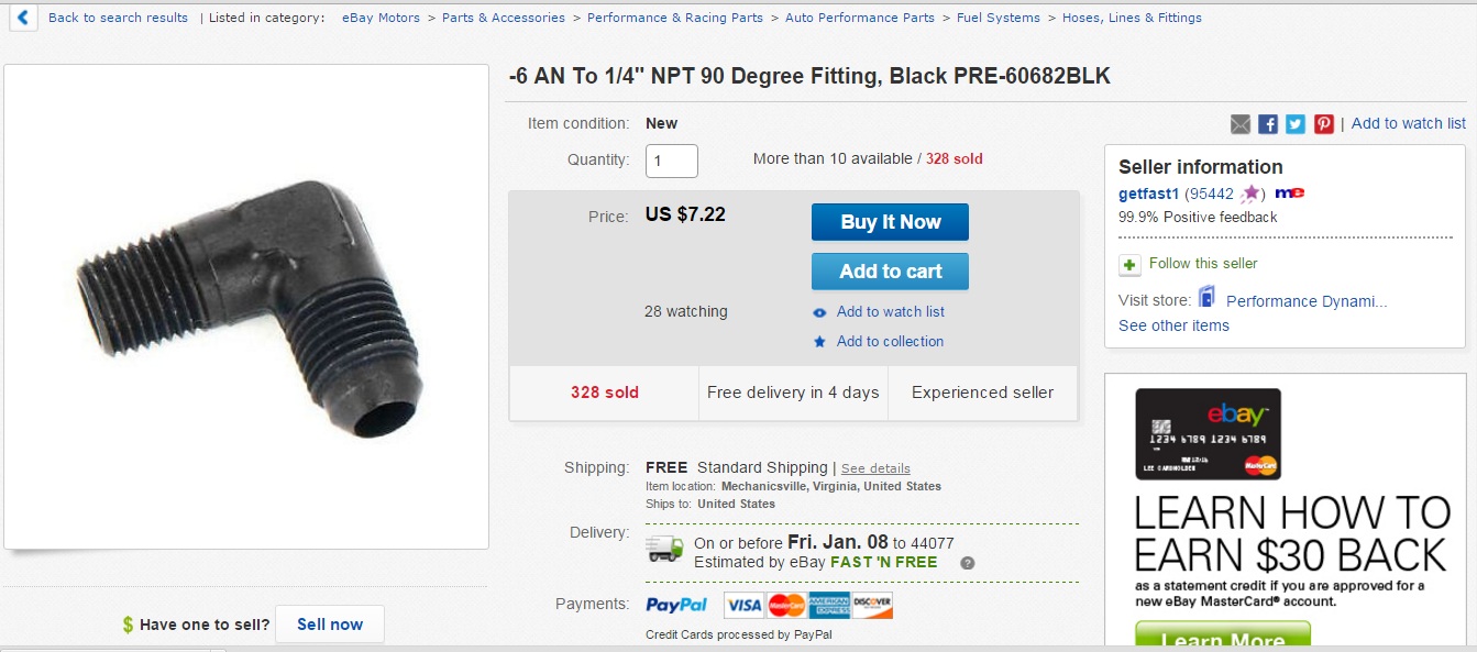

Why not go -6 AN?

Maybe I'm not understanding what you're after exactly, but I guess what I'm saying is this: It seems that 1/4" NPT, like what you have, seems to be very common on the KZ engine adapter fittings. I think you'd be fine with 3/8" hose. If you'd rather go 1/2" hose, just buy adapters to go from the 1/4" NPT to 1/2" barb (or -8AN).
