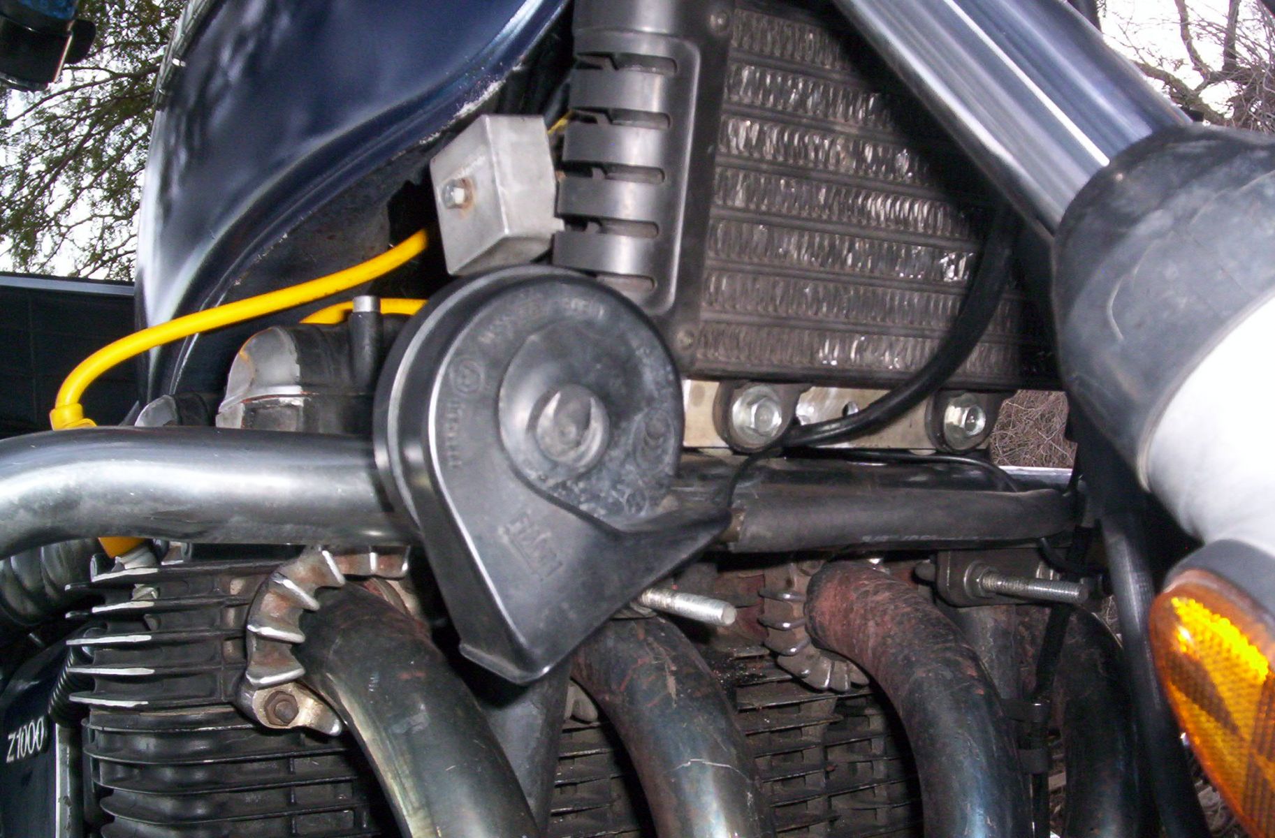

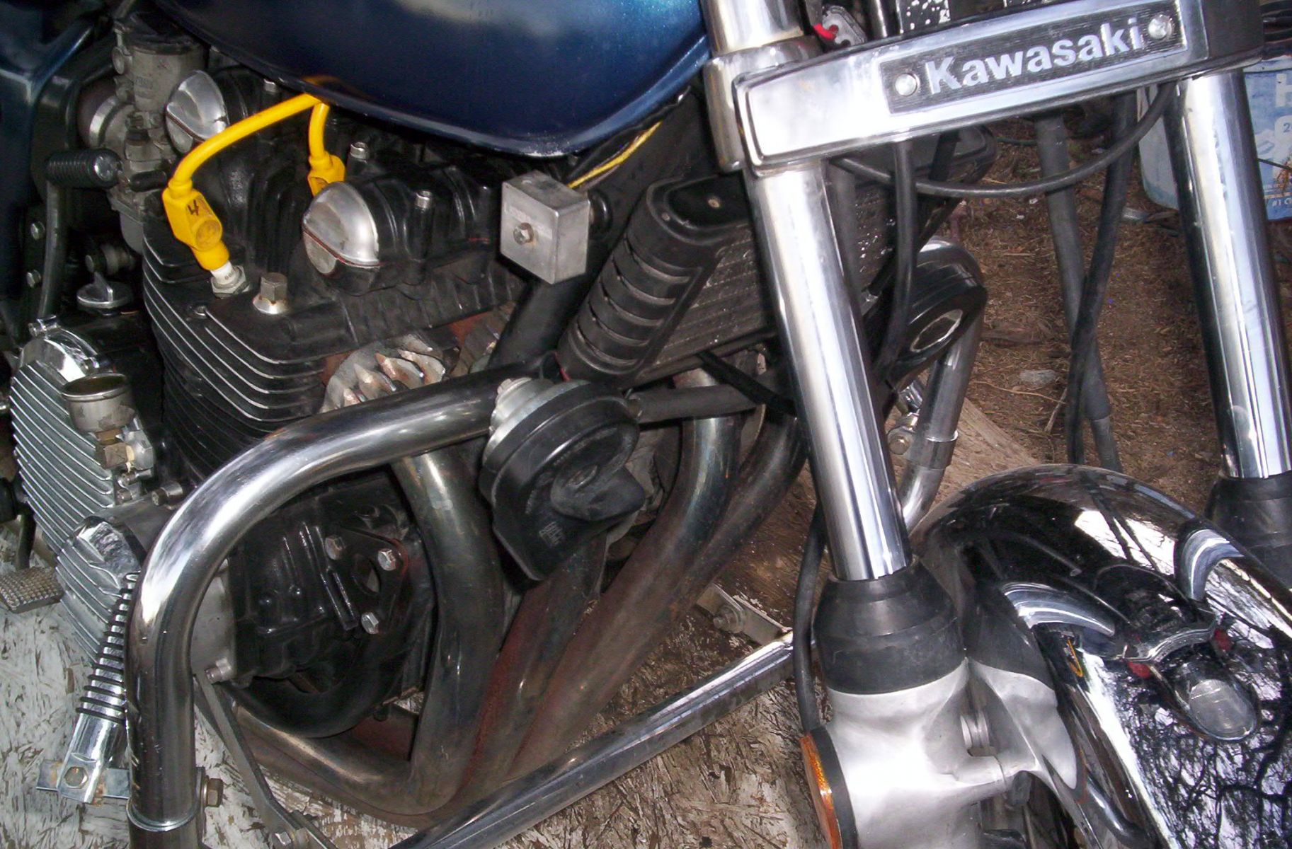

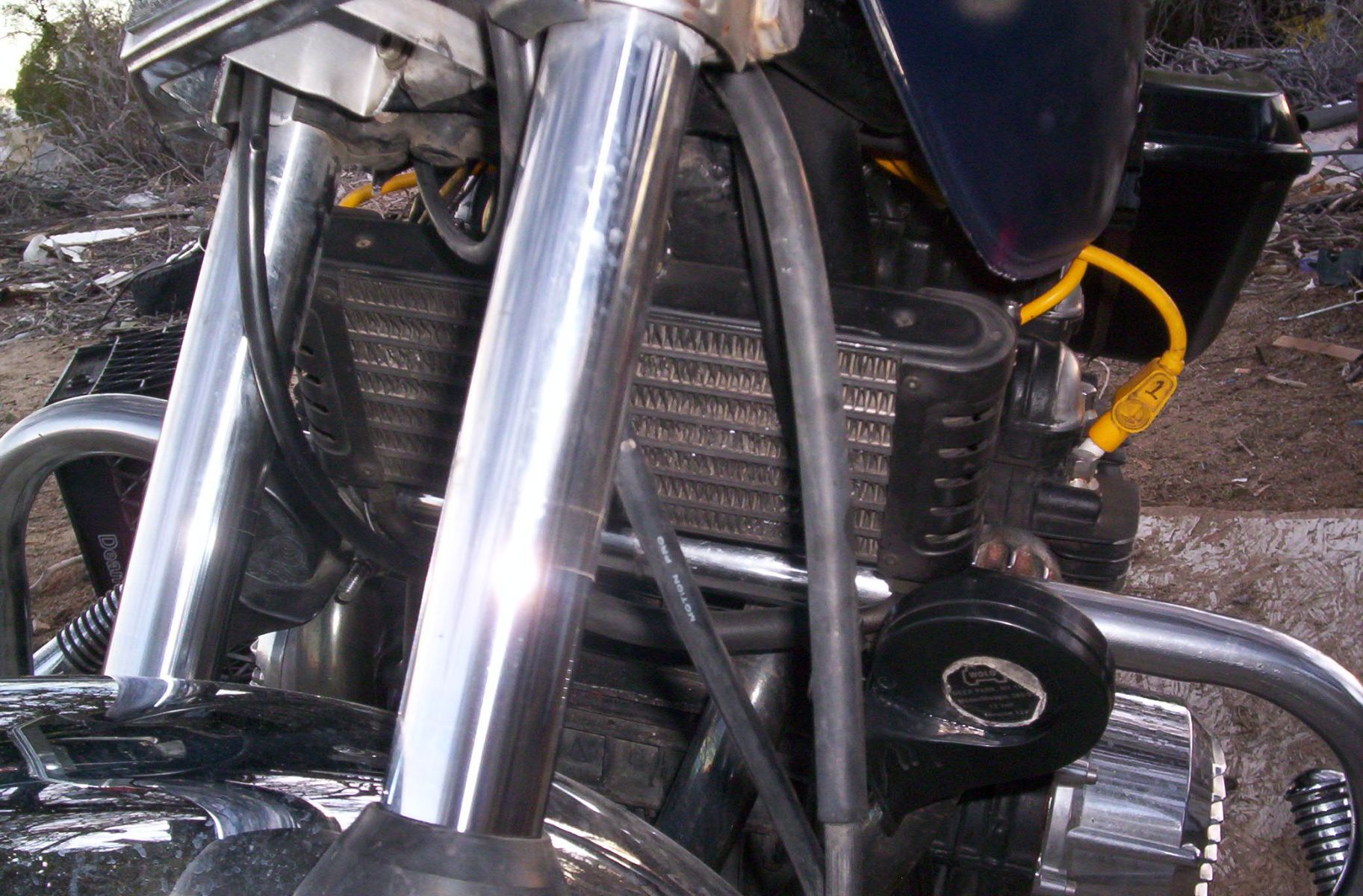

Started playing with it yesterday afternoon. It won't work up side down as I planned. Too big. The top bolt was no problem but the bottom ones I had to make a bracket for. I have some 6.37mm aluminum flat bar stock, so I used that. This stuff is HARD. I;ll have to go flexable lines to criss/cross under it, then behind the steering head, along the back bone tubes, then down between the 2-3 intake boots. 3/8 line all the way. I have a line connecting the inlets to keep out dirt for now. Looking for a 3/8 bypass valve. Should be ready for summer.
Looking at the pics, I need to do some polishing.

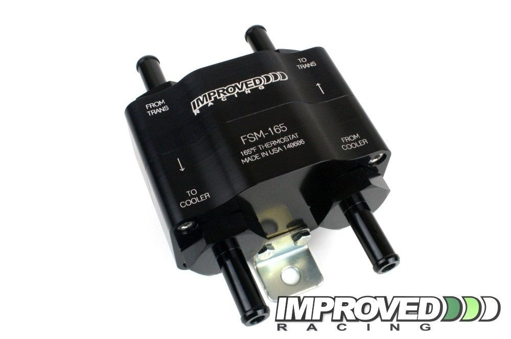

This is all you need.
www.merlinmotorsport.co.uk/p/mocal-oil-t...OZoskCFSYUwwodAdECkg
Or this
www.doghouserepair.com/store/item/575/33...il-circulation-empi/
But replace the 3/8" barbs with 1/2" though.
Or this

Nice. $37 in UK. How much in US?
- Posts: 8141
- Thanks: 3526
Re: ZX7/Z1 Oil Cooler
21 Nov 2015 11:37 - 21 Nov 2015 11:38
Still trying to catch my breath after seeing the price of that IMPROVED Racing thermostat. :ohmy:
Those "Mocal" thermostats have been around a while and I think, sold under more than one name. Price is MUCH better obviously.

You're right. Been looking at three way valves. That one for $37 is doable. Ed, do you know off hand what size fittings are on the cooler? I'd like to have larger inlets.
- Posts: 23759
- Thanks: 3023
21 Nov 2015 13:02
That's even better. Almost local .Cool looking too. I saved it.

Those 3/8ths couplings are a little too small.
Remember KZ's are high volume - low pressure so 1/2 inch /13mm is the size you need or you will have trouble.
That bypass is intended for higher pressure systems.

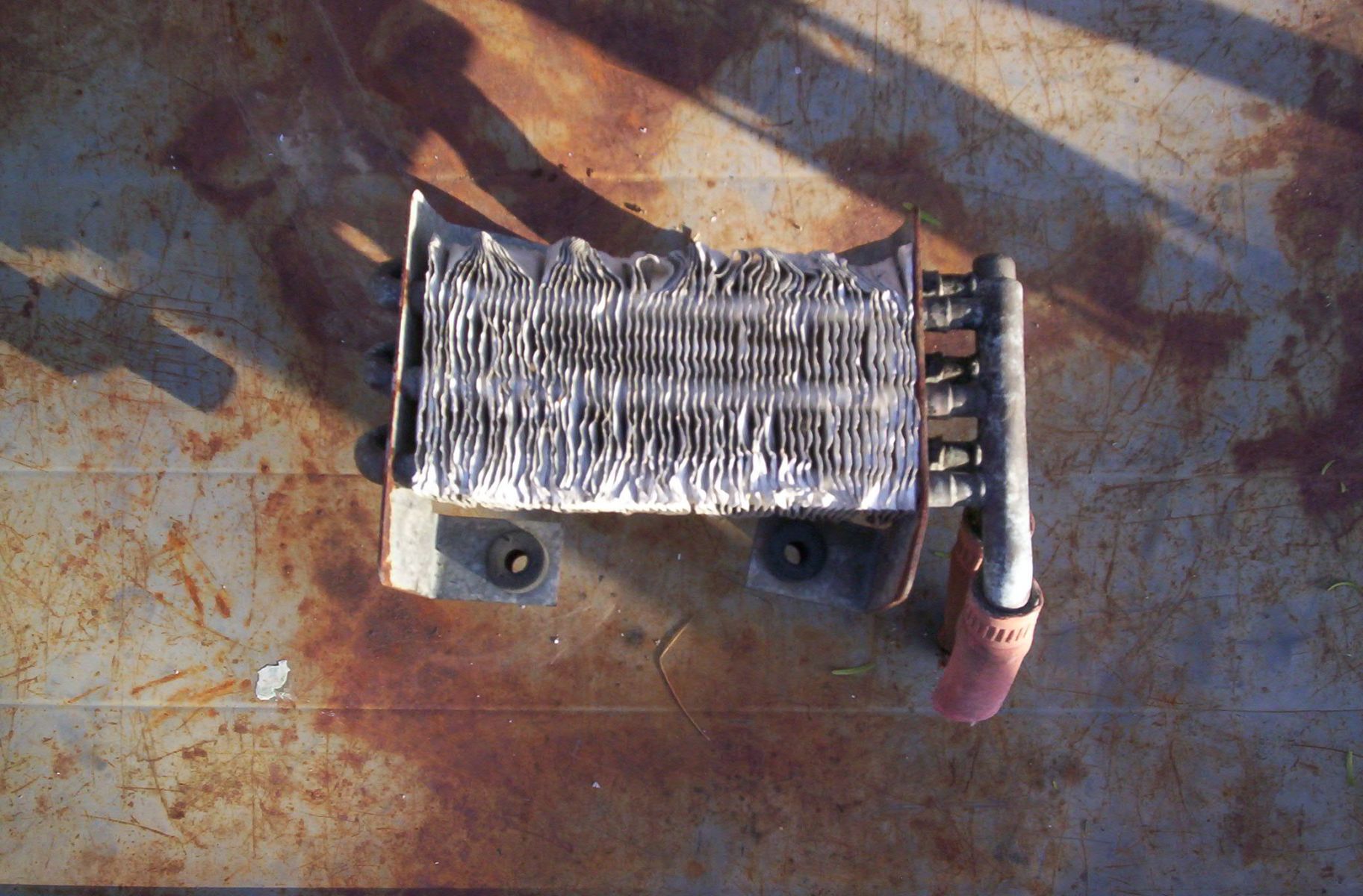

No eBay APP ID and/or Cert ID defined in Kunena configurationI've got it worked out. The old cooler had 1/2" inlets. I have some fittings off a FI fuel pressure regulator that will fit. I can drill them out and fit 1/2" barbs on them. These are the fittings I plan on getting off eBay. I was thinking the same thing. 3/8" is too small.
The fittings I had before were for 1/2".

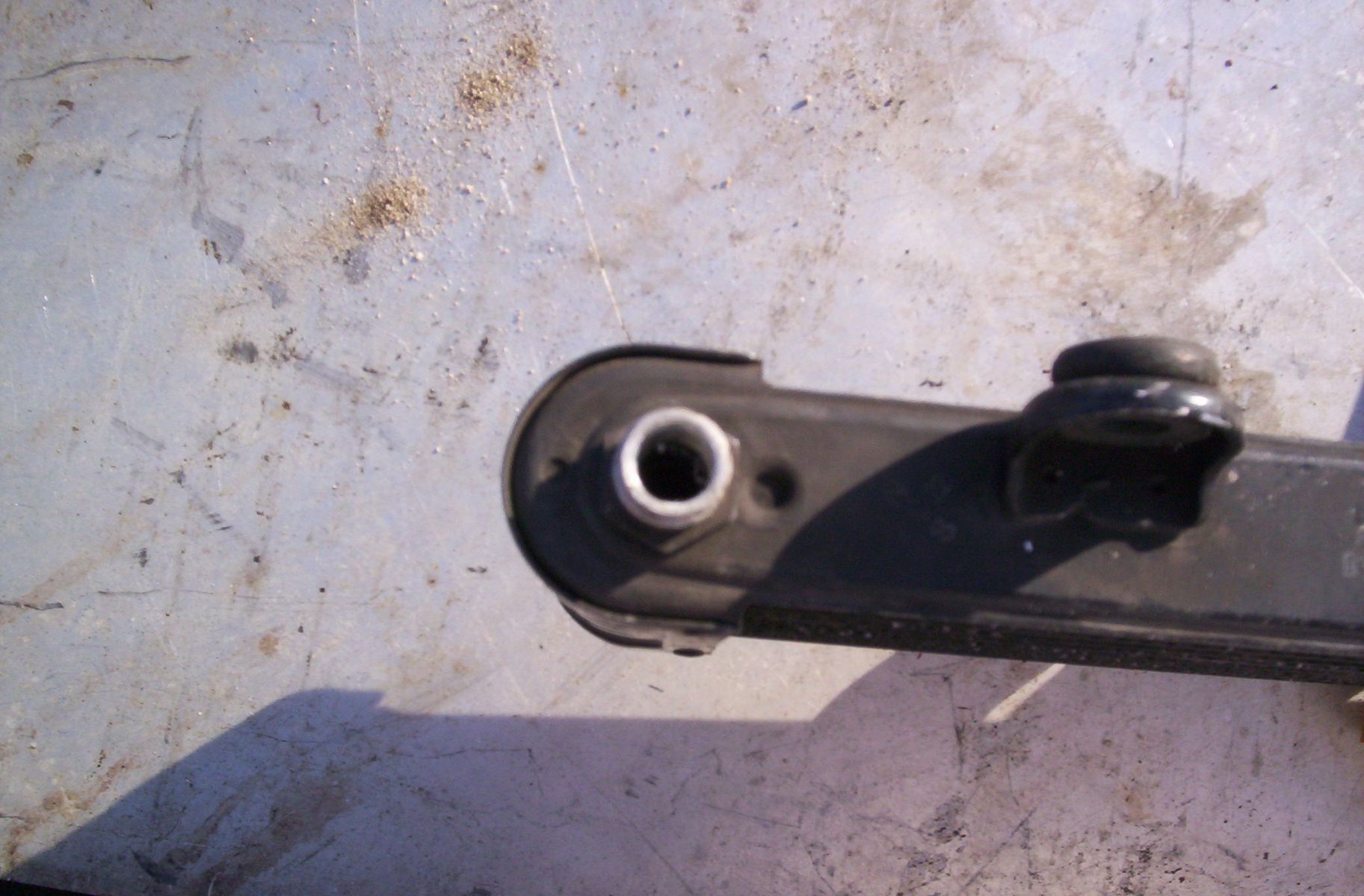

Zed 1015's comments were well taken. While watching and commenting on the other cooler thread, I've been quietly playing with mine.
The cooler was meant for a high pressure system. The hoses were 3/8. The fitting size was much smaller.
I cut the nipples off my old cooler, drilled and sweat soldered them to the couplings that came with it. The solder has a high tin content (no lead), so heat shouldn't be a problem. Just in case I flared the inside a little.
Being the lines were small with a O ring, the next step was to open the intakes more. .435"/ 11.08mm. The nipple ID is .434"/ 11.03mm.
There was a lot of meat there. Should work out pretty well.
Now to run the lines. I'll prime the cooler before I put it into service.
More to come.
