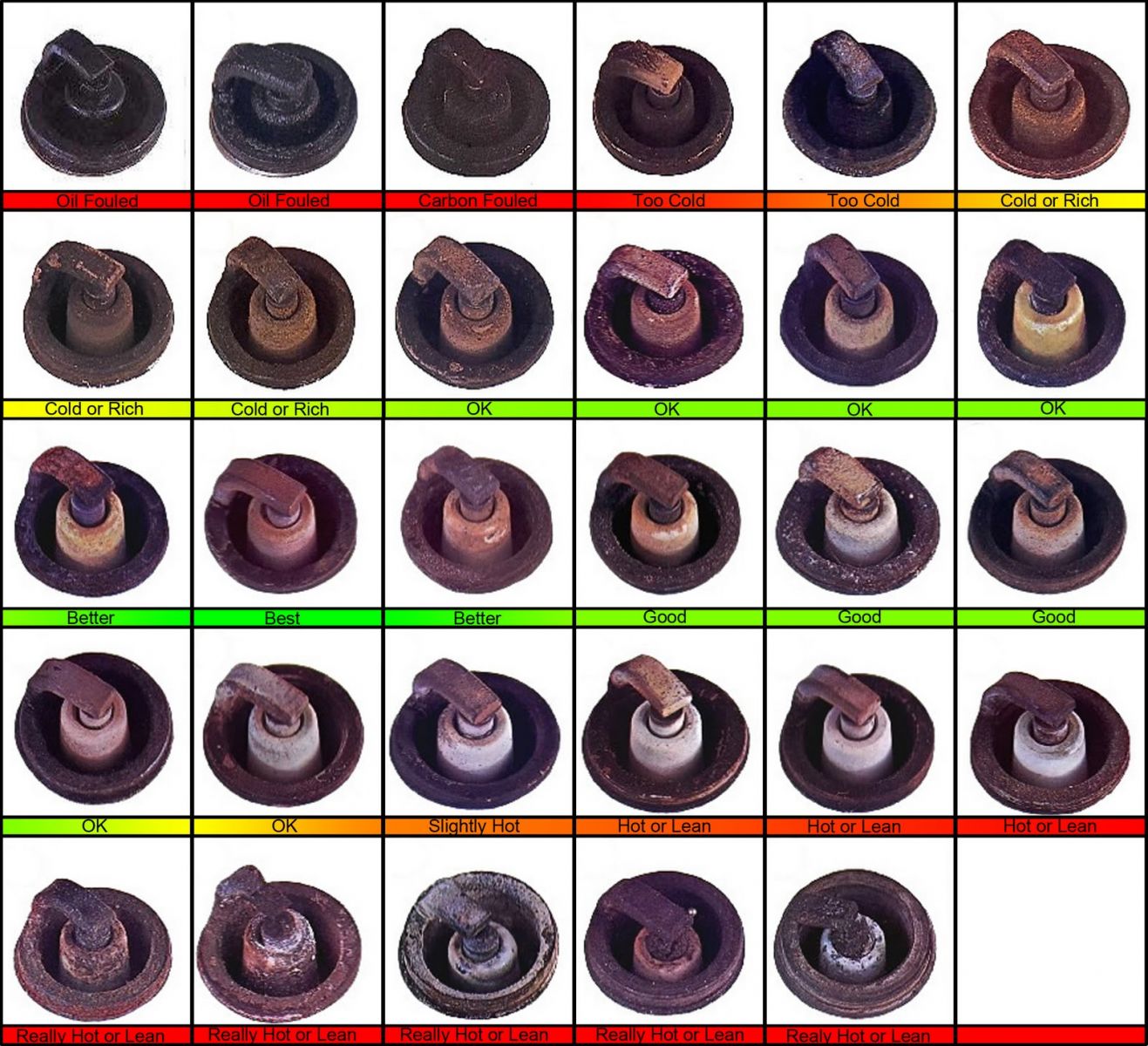

Hey guys, working on diagnosing my rough idle while I wait for brake parts. I've got a '78 kz650 d1. It was recommended that I test my coils and check my valves a while back. I tested my coils and they failed, so I have a new set coming. I measured my valves today and here's the measurements. The manual says they should all be .15.
#1= .1
#2= 0
#3= .08
#4= .08
#5= 0
#6= 0
#7= 0
#8= 0
I'm guessing this is extremely bad. I've only run it about 5 hours around town after buying it last summer and a little on the highway at low cruising speeds. I noticed some light knocking/tapping while warming up but it progressed into stalling at idle once warm and progressed to hard starting before i shelved it.
Also, I noticed that the securing brackets on #5/6 are reversed. Any possible damage from that? You can see it in the photos attached.
Again.. you guys are so appreciated. Thanks for your continued help and support.

That's the problem. The guys don't want to adjust the valves because it isn't easy or too expensive at a shop, so they just run it then sell it. Adjust the valves and hopefully they will seat in. Looks like oil fouling on those plugs. Could be valve guide seals. See what they look like after the adjustment.

...Looks more like carbon fouled, rich jetting to me.

Agree on carbon. Looks like dry power from the pictures.
Its running rich, or you have been using the choke to warm the bike up.
Regardless, I would not run that bike till you get some valve clearance back.

Yes it won't start without choke and it takes several minutes before I can take the choke off. I am looking into what I need for a valve adjustment right now. I won't start it until I take care of that and then we'll go from there.

Sounds like It may be hard to start due to the valves, and the carbon is coming in play from the choke your applying for compensation.

Having to use choke for a minute or two at startup is as it is supposed to be, so that doesn't tell anything really. Pretty bad valve measurements though.
