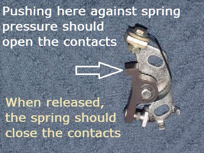

16 Oct 2014 17:37The normal "resting" position is closed -- being held closed by spring pressure.

Point Springs intake. Can manually open them then release them with spring tension back to close.

Spring tension on either sets of points keeps the points contacts closed when releasing the heel.
