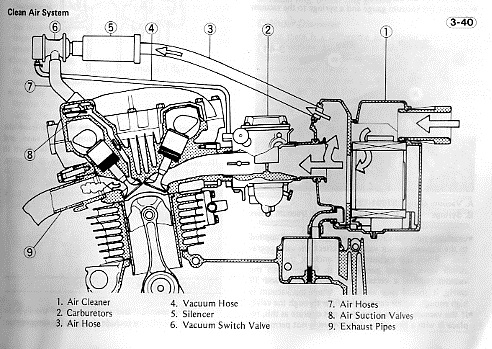

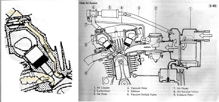

As most of you know iam in the process of my own little build. Anyway it was suggested that i might want to consider running another crankcase vent for more ventaltion. So i thought about turning my plugged off smog covers into a crankcase vent. I just thought about drilling some holes in each emmision port and allow it to run out hoses. Anyone did anything similar? or any tips or advice? Thanks, Eric

I think those have one way reed valves that let air into the exhaust. I wouldn't mess with them.

I already have them plugged off. right now i dont even have the reed valves in i did wonder if i could flip them over and use them?

Maybe iam misunderstood. I have a j model head on my mk11 motor. I have already plugged the head to block off the emmission ports. It was sugested that i need more crankcase vent. I still am running stock crankcase vent on the top of the crankcase.But i wanted to drill out the valve cover inside the old emmission housing and possibly flip over the reed valves so the air can be pushed out the cover and thru the emmission port on the valve cover. Turning it into a crankcase vent for extra ventaltion. I just worried about oil get pushed out there. And wasnt sure if anyone else has done this. Or if anyone had a any tips. Thanks, Eric

19 Nov 2012 12:12 - 19 Nov 2012 12:22Powerstroke_fan wrote: Maybe iam misunderstood. I have a j model head on my mk11 motor. I have already plugged the head to block off the emmission ports. It was sugested that i need more crankcase vent. I still am running stock crankcase vent on the top of the crankcase.But i wanted to drill out the valve cover inside the old emmission housing and possibly flip over the reed valves so the air can be pushed out the cover and thru the emmission port on the valve cover. Turning it into a crankcase vent for extra ventaltion. I just worried about oil get pushed out there. And wasnt sure if anyone else has done this. Or if anyone had a any tips. Thanks, Eric
The factory did it already. All the stock emissions components will work. The only difference is you're not allowing the crank case gasses to be sent to the air box first. Hook it up directly to the crank case vent instead. You would want some baffeling in place to prevent sucking oil into the exhaust system. The stock airbox prevented that.
The OEM version allowed the gasses to be pulled into the carburetors where they partially diluted the mixture. Didn't really hurt much of anything.
The exhaust system sets up a very strong depression at and for a short time after TDC on overlap. It's actually a stronger depression than the piston can create on it's downward stroke.

I have done a few.
I block up the ports in the cover that usually align with the ones in the head then open up some holes in the bottom of the emission chambers directly into the head.
These are positioned right above the camcaps so they are shielded from any direct oil splash.
I remove the reed valves and fill the empty chamber with some stainless gauze to catch the oil mist.
You can then run some hose from the cover to a catch tank, vent fiter or whatever.
