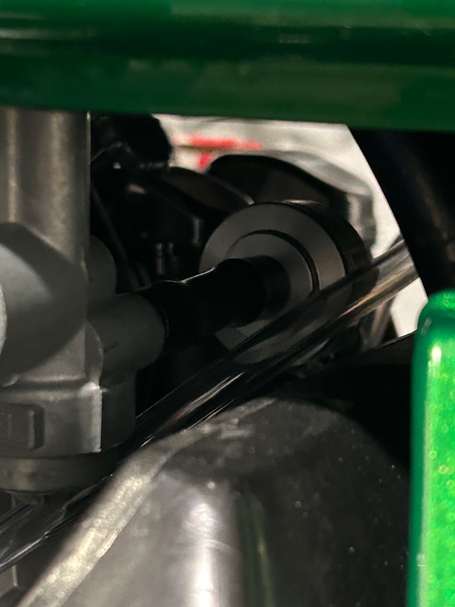

10 Sep 2025 21:31I would think you can get the brass port back in to the carb either as Tex indicates or use some fuel proof RTV or the like. Wanted to say the stock petcocks for the H models are all vacuum operated and have 2 ports on them. One for the fuel to get to the carbs, and one to provide vacuum to the petcock to allow fuel to flow. I have added a pic of a set of vm24 carbs with an accel pump and a vacuum port on #2.
Great picture, thanks! Helps me understand what I have here.
That is a fairly common problem. Last time it happened to me, I knurled up the brass tube with a pair of pliers and carefully pressed it back into the petcock. Worked a treat.
I've knurled it just by trying to get it out of the hose to which it has bonded. I think I will use a bit of Seal All on it when I put it back in.

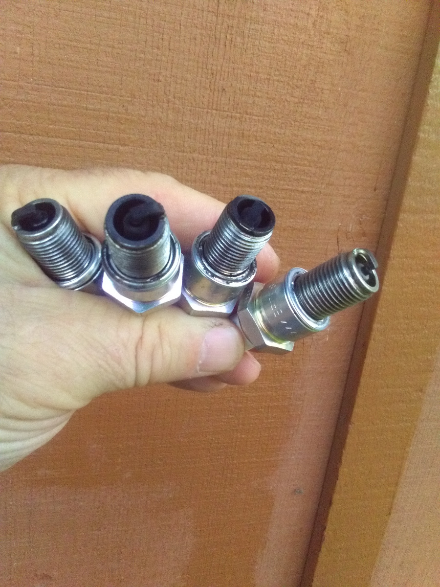

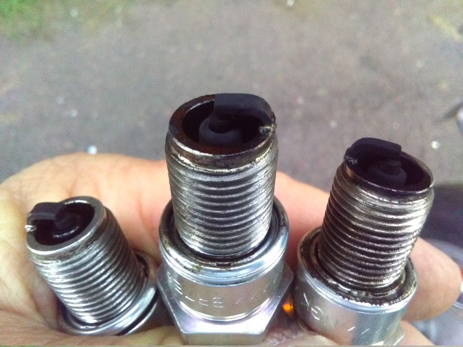

Took it outside today so I could let it run a little longer than I care to in my attached garage. After a few minutes it started to smoke a bit, not what I would call "a lot" but definitely noticeable out of both sides. I let it run maybe 5-7 minutes. I did have the grungy old air filter in it at the time so maybe I will repeat part of the test tomorrow without it. New filter is on the way.
I figured it might not do any good but it wouldn't hurt to run the compression again while it was hot, and there wasn't much change but it did even out a bit. All cylinders were till low but all were at about 90 psi. 3 of the 4 the brand new BR7ES plugs were already fouled from the short 10-12 minutes this has run in my possession. Left to right, 1-2-3-4 below
1-2-3 below
The #4 may not have been firing until today's test which may or may not explain its better condition. It looks to me like 2 and 3 are the worst, so maybe coil is part of the issue? If you think I'm hoping to avoid a carb teardown before winter (which is 6 weeks away) you are right, lol.

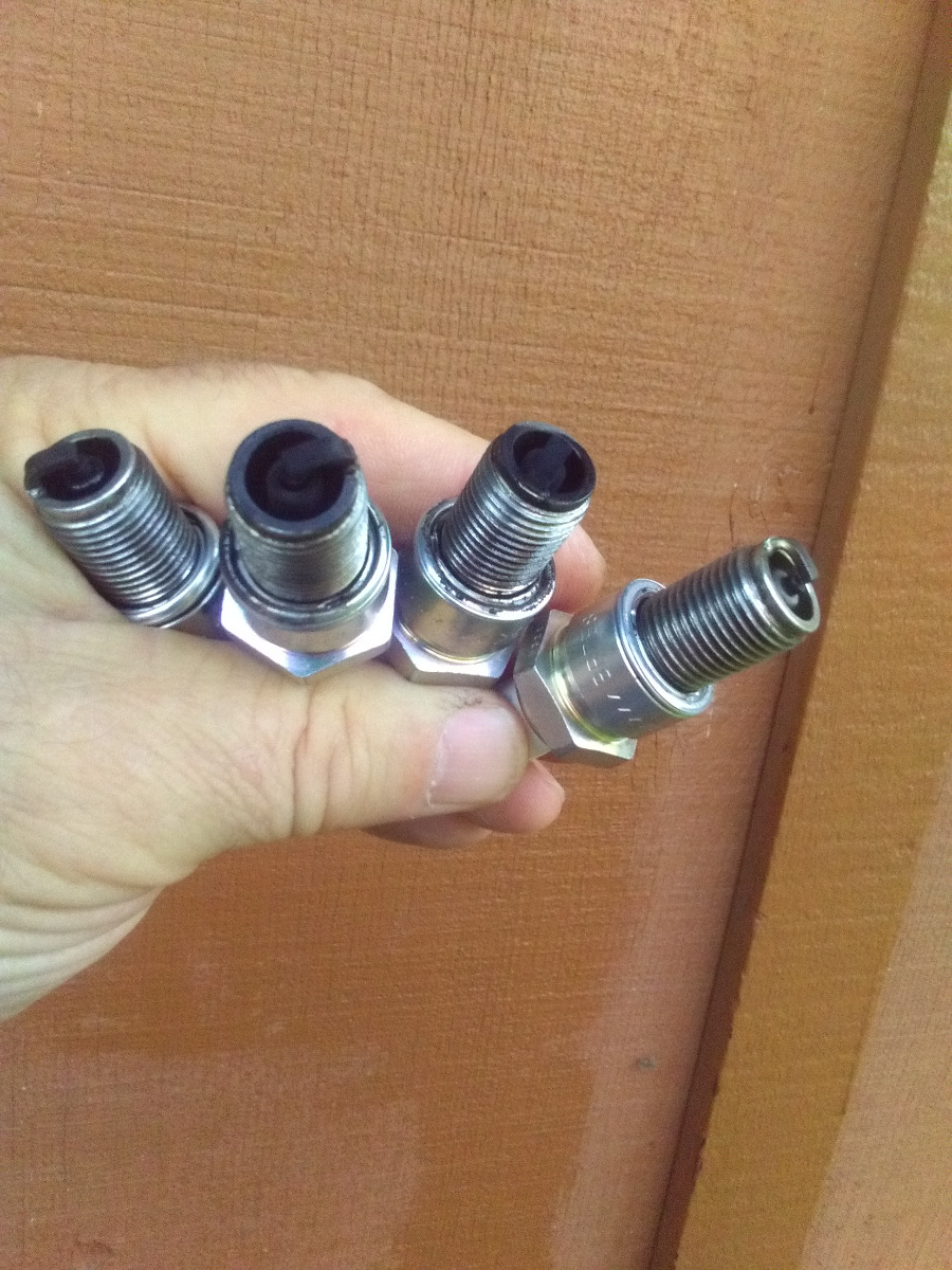

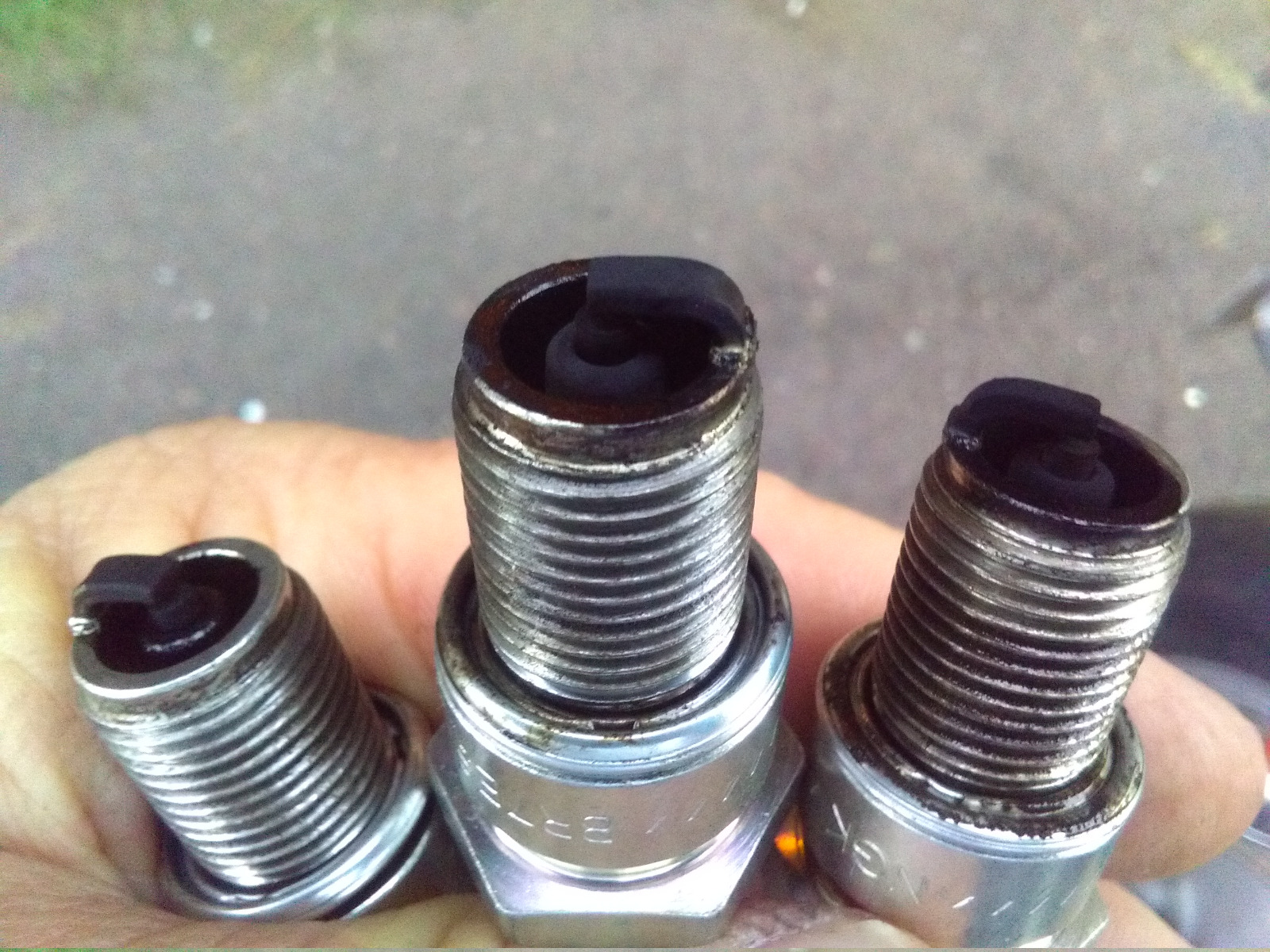

1-2-3 below
