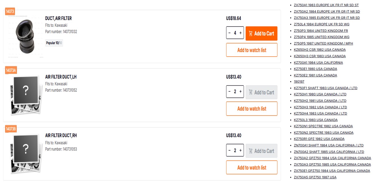

Thank you for that bad news, I needed to hear that. I bought this in part because Partzilla showed the ducts available, but I just called them and in fact they are not available. Drat. I'm not enthusiastic about pods and rejetting. I can try softening the ducts I have, but in my experience that's a very temporary fix. I will also check with clausstudios.com and see if they can make some, but that probably won't make economic sense. But this is all OK, I knew there was a good chance of unexpected problems ahead that might derail my interest.

Interestingly CMNSL list the "CSR specific" left/right boots as unobtainable but also list a generic part number for all 4 ?????

They don't list an 81 but what is your build date ? is it a July on 81 (82 model year) ?

the -1032 ducts are for the 82/83 models that have the BS32 carburetors. same ducts and carb holders as the 750-4s. aftermarket -1032 are available and can be adapted to the VM24 carburetors. usually by using radiator hose or similar. cut into rings to fit over he carburetor intakes. then the ducts fit over that. some have had success. others not so much.

So if you are on VM's surely Zeds "air correctors" and quality pods is the best option ???

02 Sep 2025 18:07They don't list an 81 but what is your build date ? is it a July on 81 (82 model year) ?
built 12/80. No such luck!
#916717 So if you are on VM's surely Zeds "air correctors" and quality pods is the best option ???
Yes that may be the easiest, cheapest and possibly best option. Had to do some reading here to learn about them but I'm pretty sure I can do that without screwing it up. I hate the pod look though, but I hate not riding even more.
I'll be the "not so much guy" lol, so I will pass on that. I spent the last 10 years trying to keep the ducts on my 305 alive and thought I was leaving that kind of trouble behind. Guess again! I've also heard horror stories of people going to pods and having lots of trouble so I have a bad attitude about them. I was not aware of these air corrector jets before now but if they work as well as people say then I may have to reconsider my position on pods.
