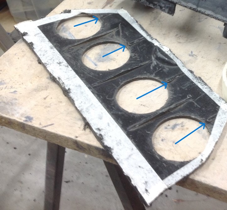

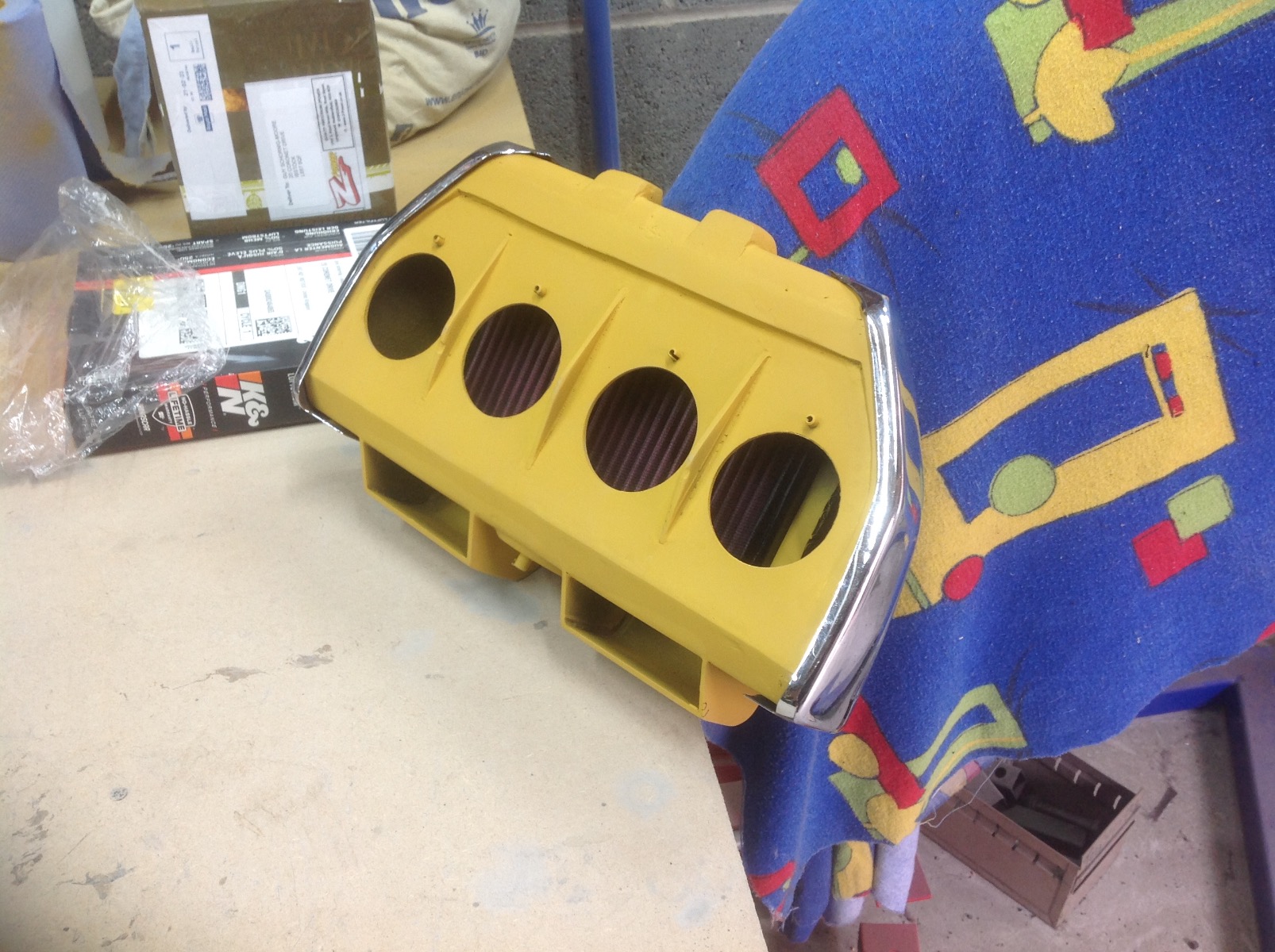

If you really want to keep the stock air box you could always take the "left field" approach I did. Get some rubbers that fit the carbs then replace the bulkhead in your air-box to fit. The pics show the removed section and the finished item (you can get a sheet of 3mm ABS plastic from Amazon for a few bucks) I needed to move the holes 15mm lower to raise the air-box

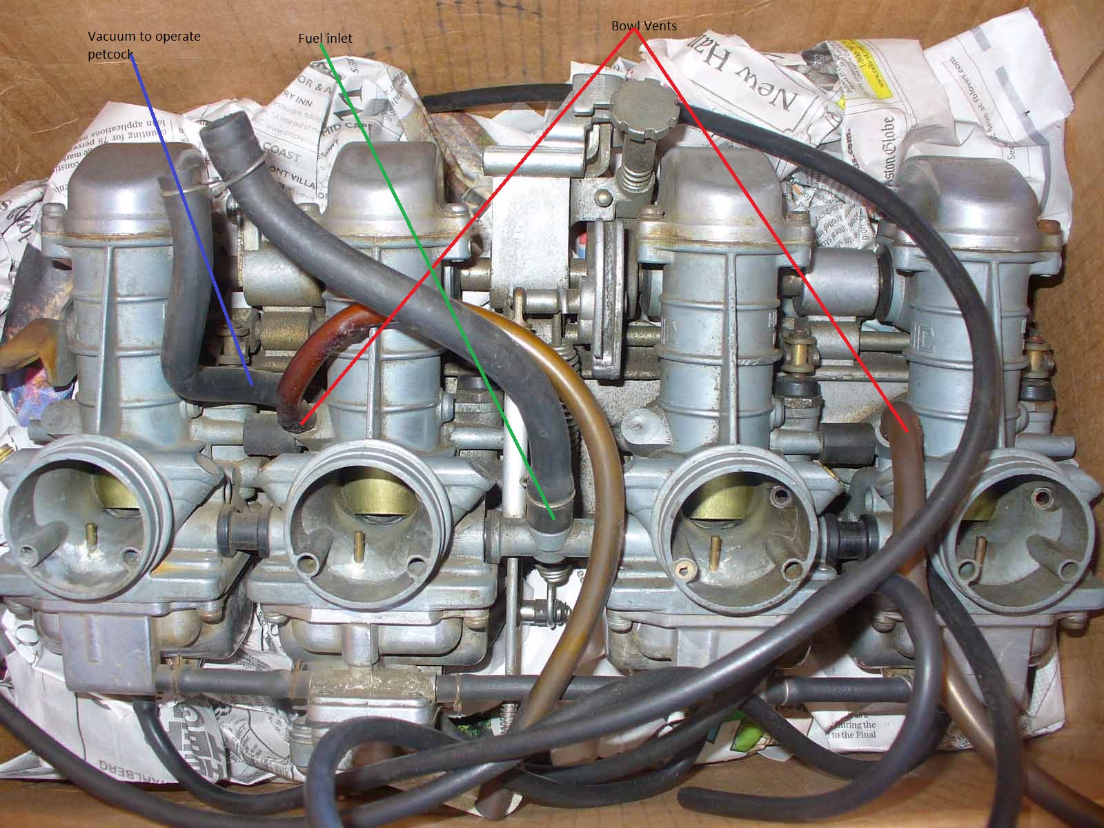

I would think you can get the brass port back in to the carb either as Tex indicates or use some fuel proof RTV or the like. Wanted to say the stock petcocks for the H models are all vacuum operated and have 2 ports on them. One for the fuel to get to the carbs, and one to provide vacuum to the petcock to allow fuel to flow. I have added a pic of a set of vm24 carbs with an accel pump and a vacuum port on #2.
