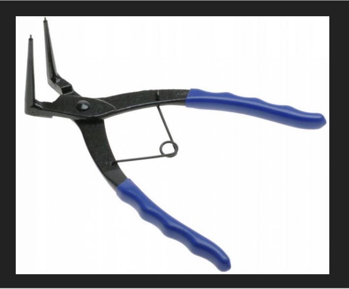

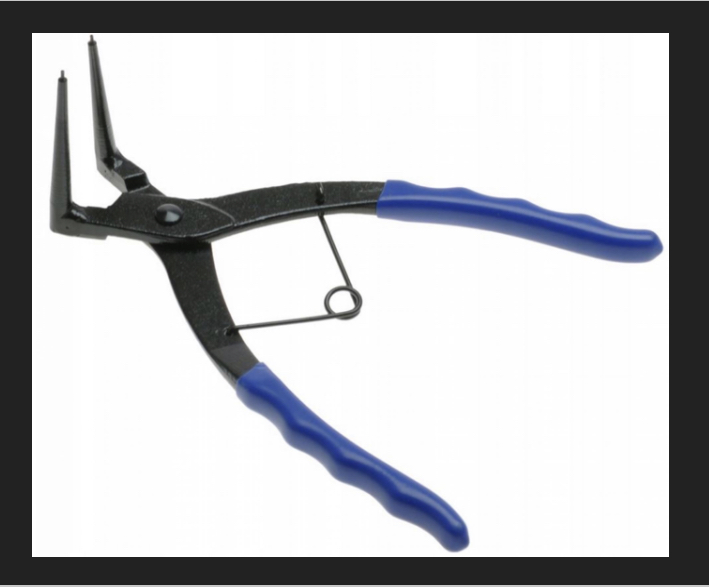

78kawltd I think the 78LTD has the trapezoid shaped master cylinder as in the first pic below the one on the left, if so your lucky cause they are easy to remove the piston. They have a plastic piston retainer and very easy to remove, just be careful and don't break it that part is NLA. On the other hand if you have the tall round master they can be a pain in the ass to remove the circlip.
I dismantled mine last night and had a hard time removing the circlip!!.......I had to get rough with it and break the c-clip in order to get the clip out. I've done quite a few of these and this one was the most difficult so far. Also notice the crystallized brake fluid around the outside of the piston, this one was way overdue for a rebuild. I'll take more pics as I move along, once you get the piston out it's just a matter of cleaning the bore very good and reassemble.

That's a good point Wookie but very few people do that, in my younger years I'm guilty of that type of neglect. In the FSM it also says to replace the caliper seals every other brake pad change which few people do...guilty as charged on that one also. If you notice all the crap that was in my rear caliper I would venture to say nothing has been done to this brake system other than a pad change since the bike was new 45/46 years ago, as I rolled it around the brakes seemed to work but with a heavy bike like these I wouldn't want to trust them with my life.
