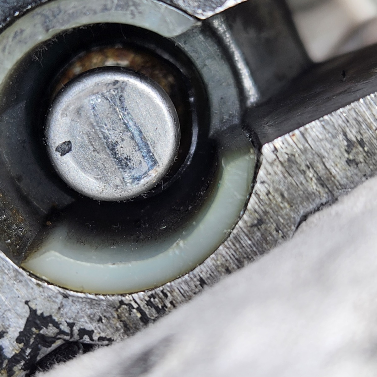

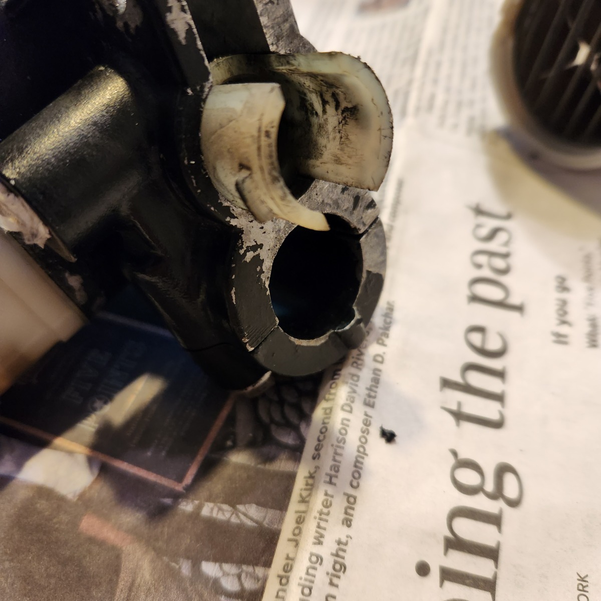

Moose1800, just my luck, I have the trapezoid MC. Poking around and cannot seem to loosen the plastic piston liner. Gonna try some brake cleaner and then some silicone spray. @ Partzilla Number 9. Unless anyone has a better workable solution ? Thanks.

Disregard. Got it. A little luck and the hairdryer. I can easily see why they are NLA now. B/C they are delicate.

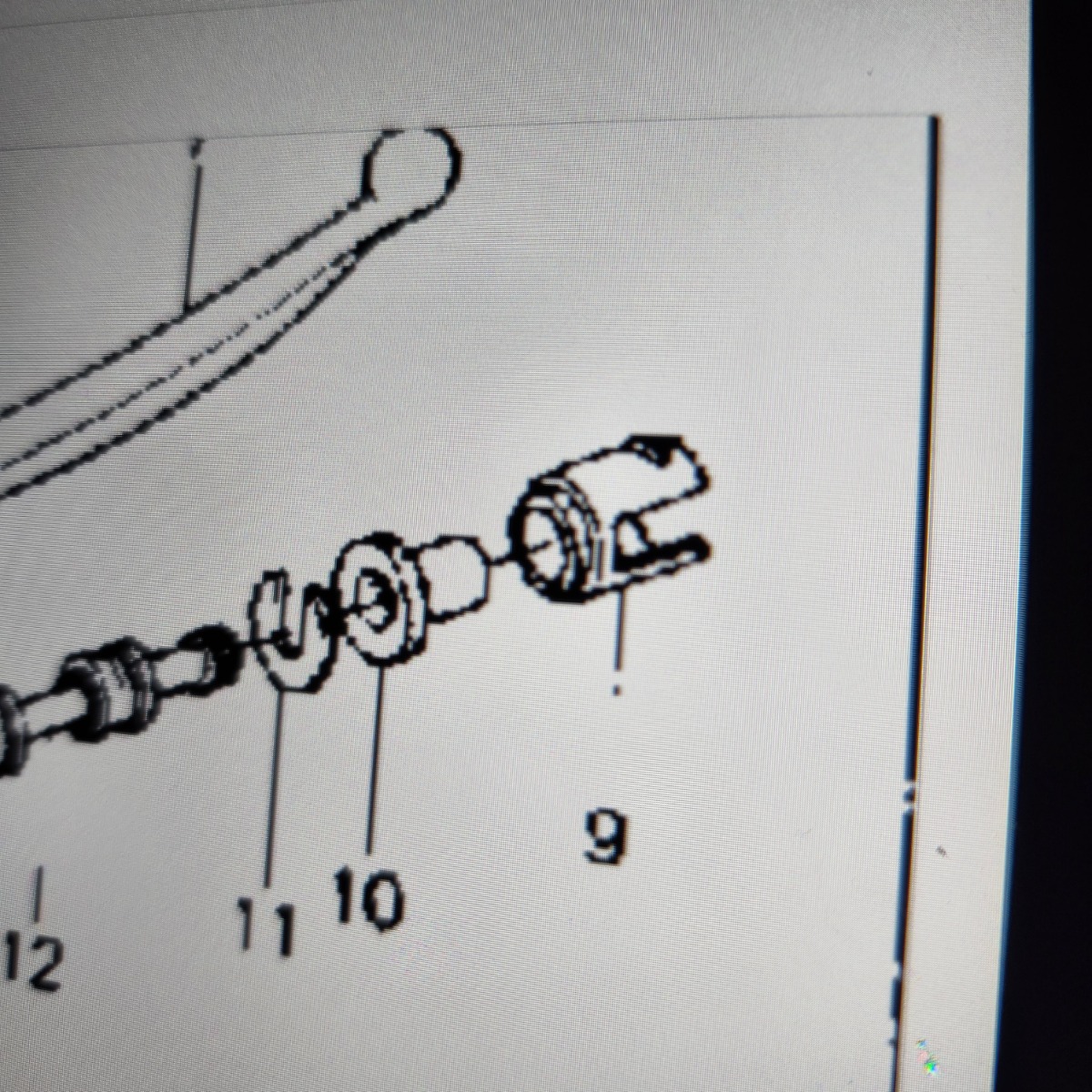

If you look at the diagram of the part #9 that small dark spot on the top is a tab that snaps into the body of the master cylinder and there is another one on the opposite side. You need to push down on the piston to relieve the spring pressure and hold it down as you take a very small flat blade screwdriver and pry the plastic retainer inward and up just above the tab, when you have the tab out you will have a small gap then move to the other side and do the same thing. When you have both tabs released you can let the piston come up and pull out the plastic retainer.
Be careful prying on the plastic retainer!!........if you still can't get it out let me know.

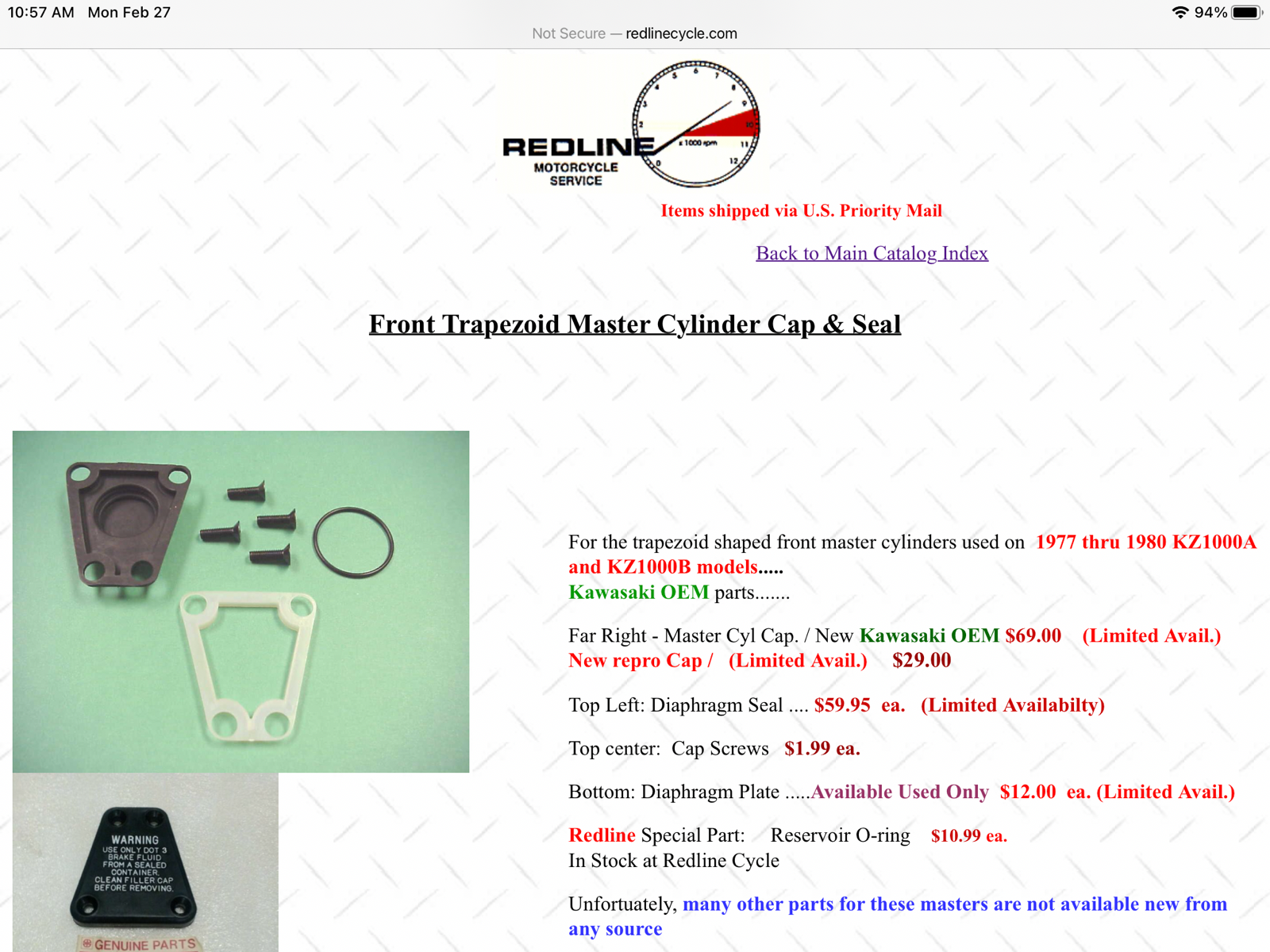

27 Feb 2023 07:53Yes I don't have a hone that small so I used a 20 gauge brass brush from my gun cleaning kit to clean the bore then rolled up some 320/400 grit sandpaper and tried to get a slight cross hatch in the bore. Also make sure both holes are open in the reservoir the smallest can get blocked very easy, I used the smallest wire in my torch tip cleaner to do that with the piston removed. Also if the reservoir isn't leaking at it's base I wouldn't remove it, that odd shaped o-ring may be impossible to find.Yes, back on track. We must've crossed thru the site. Thanks, nevertheless. Now w/ a good cleaning, rinse and some masking for the paint touch up.

Other- Ironically, I was wondering about your good suggestion also. Relevant, but Should still be good tho. No leaks.
"Also if the reservoir isn't leaking at it's base I wouldn't remove it, that odd shaped o-ring may be impossible to find".
