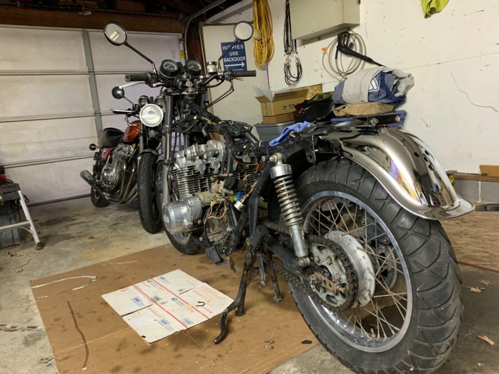

Definitely a solid bike to start out with. much better already. I see a few hacks on the harness, if you plan to replace it I’m a buyer for the old one.

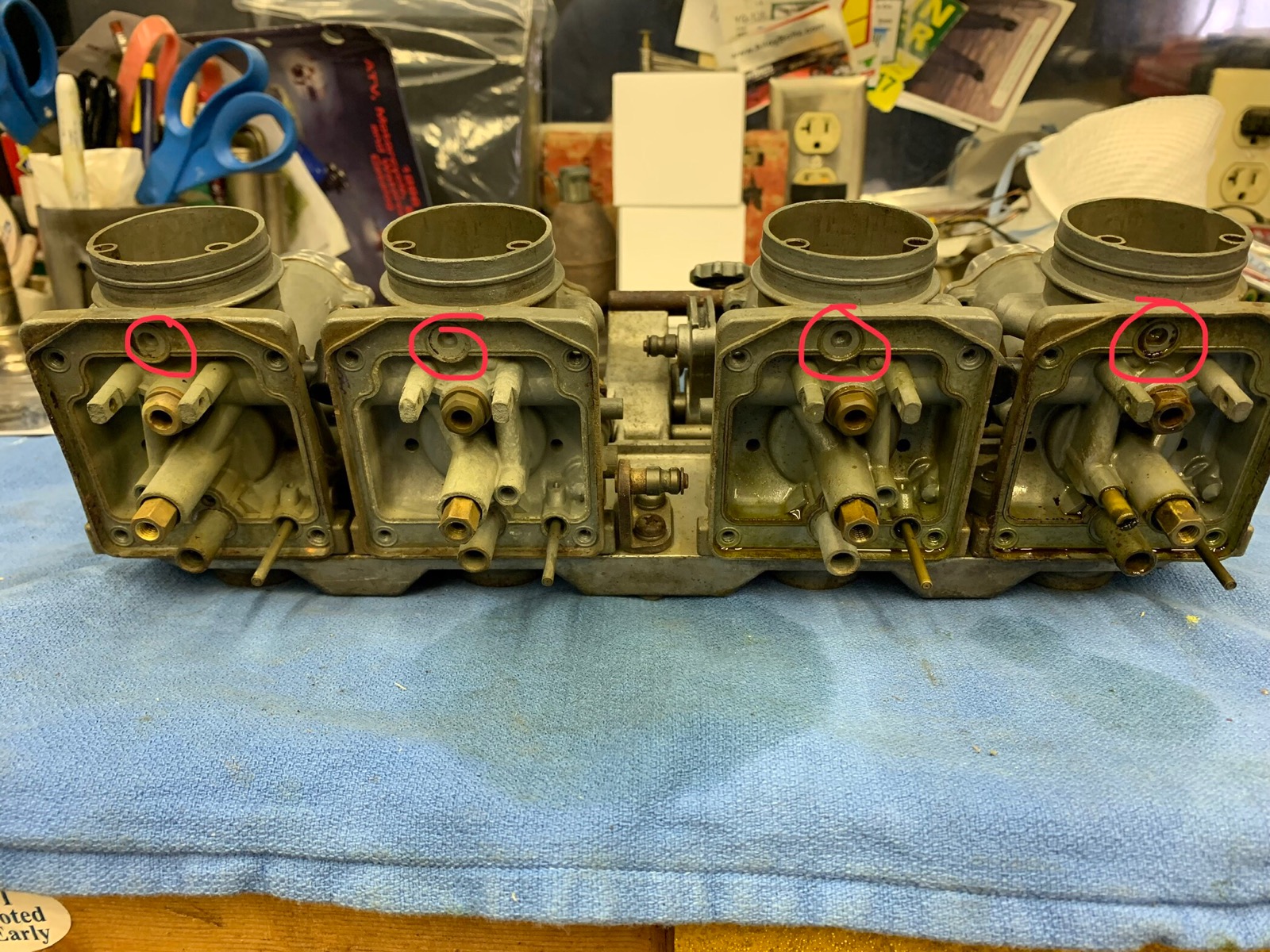

Hard to tell in this photo but make sure, in the areas circled, there is no whole going through to the carb inlet throat. If there is a hole then these are gooned up accelerator pump carbs.

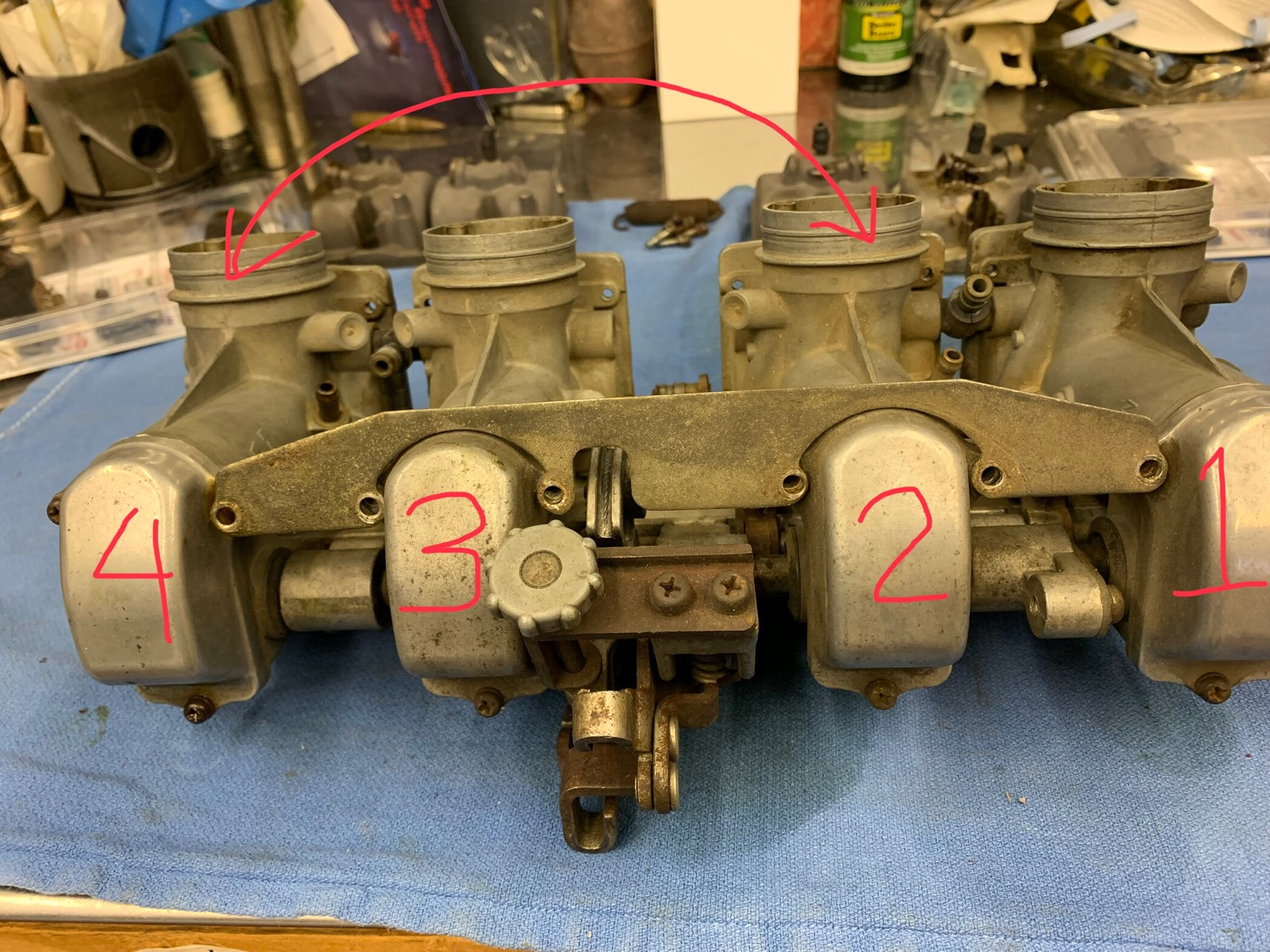

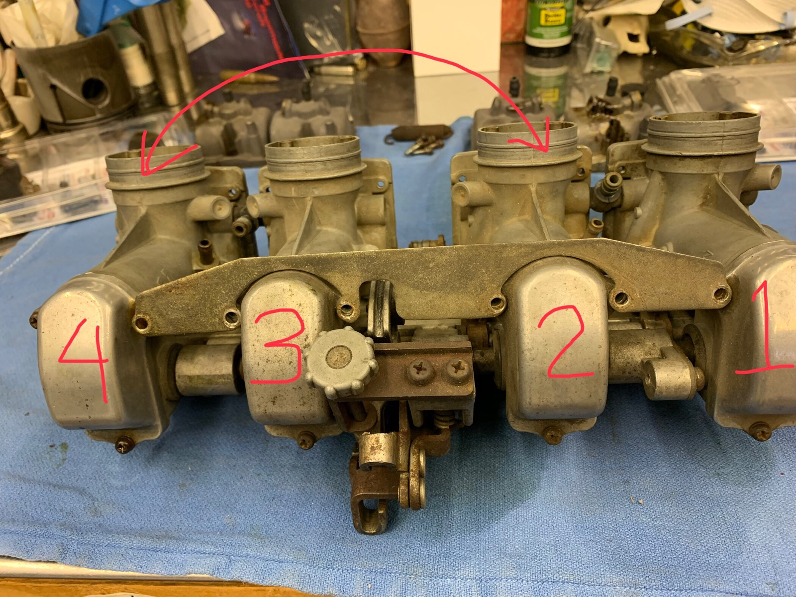

15 Nov 2022 06:50Good eye Mikaw ! I noticed that when I was removing the bowls, a WTF moment. I'll need to be sure to double check everything now.Wrong orientation switch #4 to #2 and 2# to 4#.
The carb bodies aren't drilled for accelerator pump so all good there but thanks for the heads up on that I may have overlooked that tidbit without you mentioning it.........Thanks!
