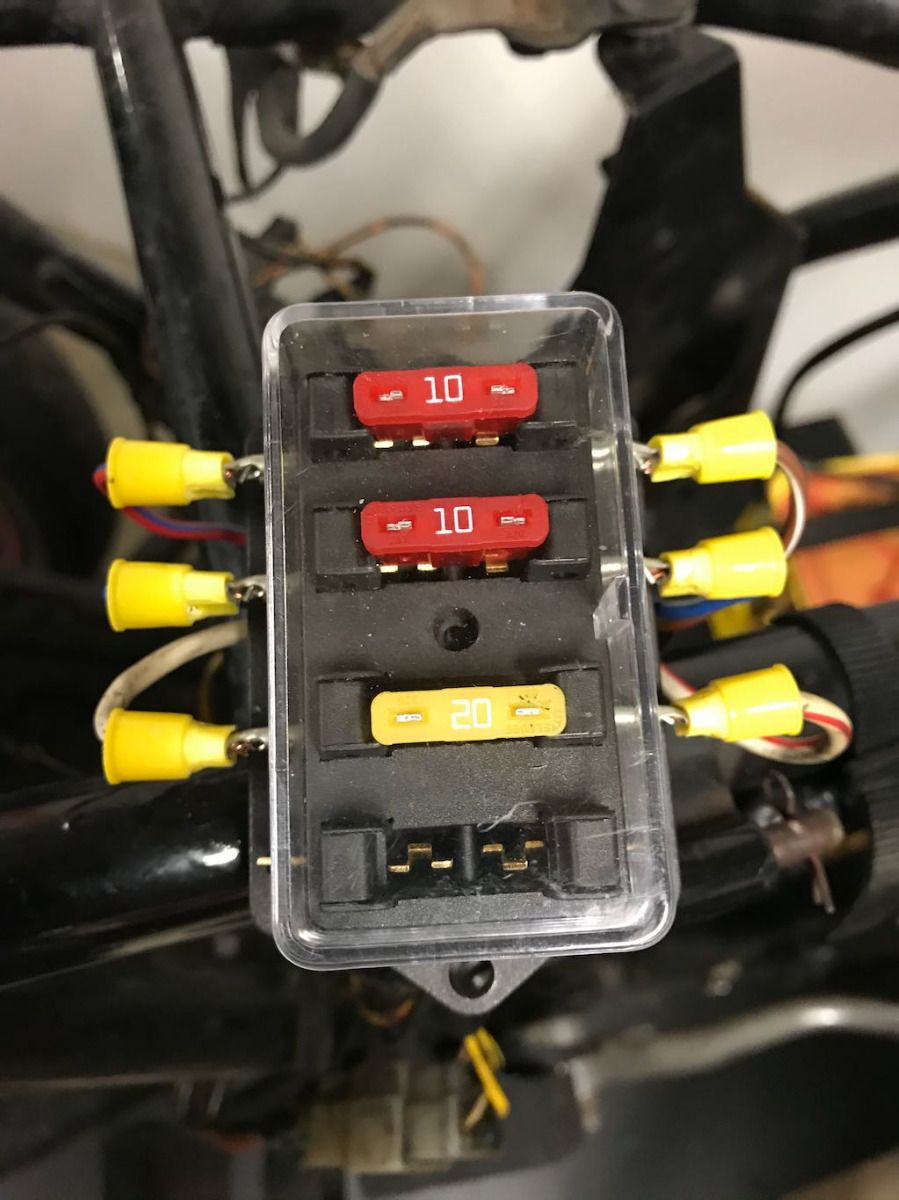

28 Mar 2021 07:04You didn't mention budget, so we'll go with bang-for-the-buck:
Older bikes were built to a price point, and this is often evident in the electrical system.
Installing modern blade fuse holders in place of the tube fuses is worthwhile in some cases, especially on heavily loaded circuits. The single-fuse-for-the-whole-bike situation on Z1's comes to mind.
Also this. Can't believe I forgot about it.
Here is the one I installed on the KZ440B project bike. It didn't suffer from the single-fuse issue you mentioned but it's still nice to get rid of the Buss fuses. The box itself is very simple and was about $7 on Amazon.
