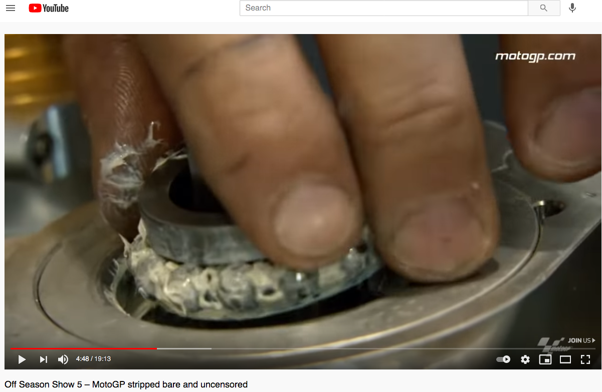

The All Balls tapered steering head bearings is fun debate.
I tried them and went back to OEM Kawasaki loose ball bearings.
Setting preload on the All Balls tapered bearings was not as easy.
It was either too loose or too tight.
Alot of people prefer the All Balls.
Funny, there is a million dollar Aprilla motogp bike that uses caged ball bearings instead of tapered bearings on youtube.

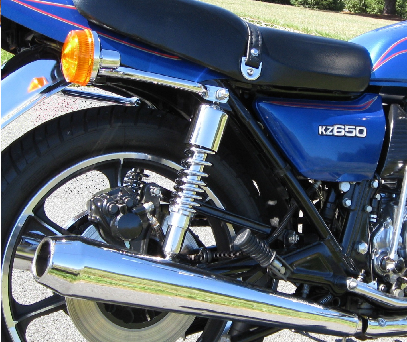

I have a 1977 KZ650-C1. I replaced the ball bearings and races in the steering stem with All-Ball units - huge improvement! Also, I installed Hagon shocks - another huge improvement over the worn out stock units. Ed
4:48
Well maybe that's why that Aprilla hasn't won anything. Maybe they should use the All Balls setup.

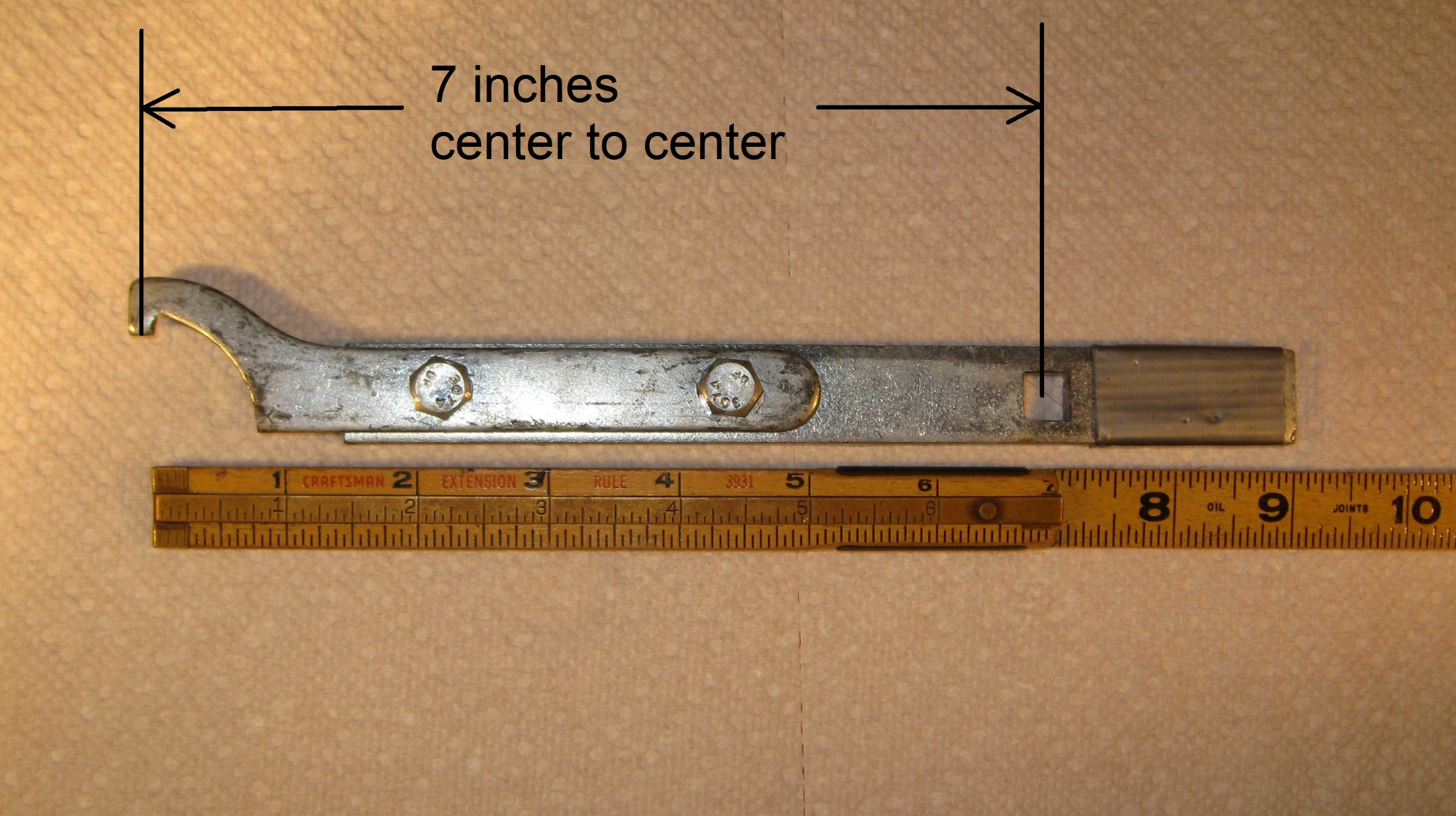

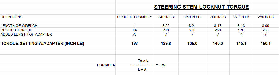

F64 wrote: "The All Balls tapered steering head bearings is fun debate.I tried them and went back to OEM Kawasaki loose ball bearings.Setting preload on the All Balls tapered bearings was not as easy.It was either too loose or too tight."
I modified an adapter and calculated the torque for the length of that adapter plus the wrench before making the change. I had zero problems, but I guess some folks used a different approach and had big problems. Ed
