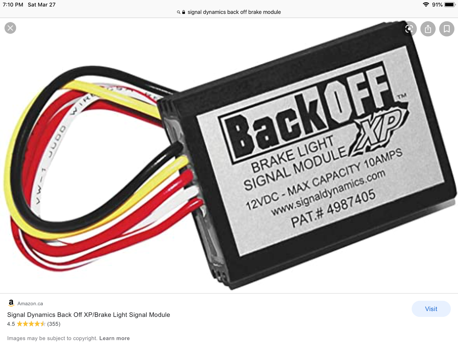

Back in the good old days, all we had to worry was the traffic/people ahead of us. Now with distracted driving, we have to watch behind us even more. So I always install Signal Dynamics Back Off Brake Module and it works with LED brake lights. A bit expensive, but well worth it to get driver’s attention.

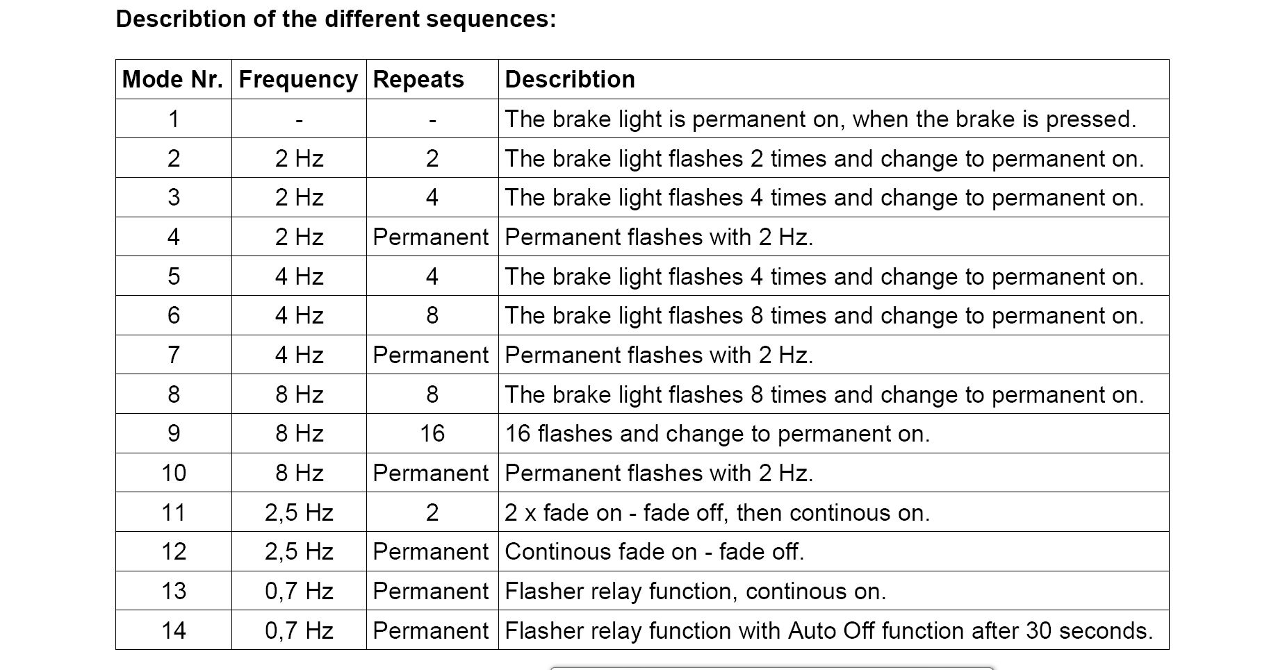

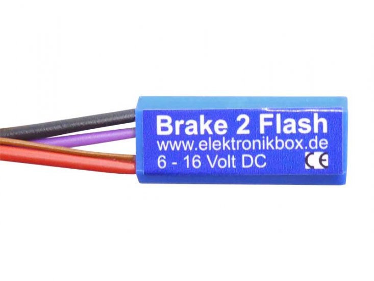

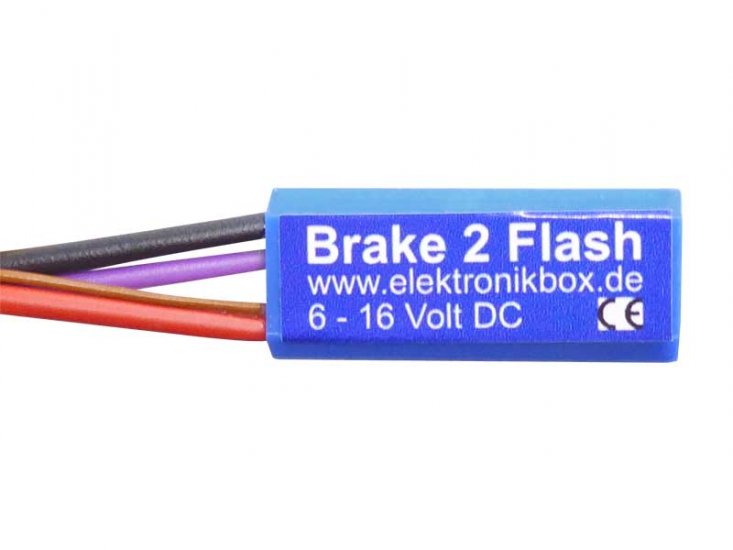

Did the same on my KZ to get more attention to the distracted/inattentive drivers behind me. Brake 2 Flash is an adjustable brake light flasher module and you can choose between 14individual flasher sequences.
