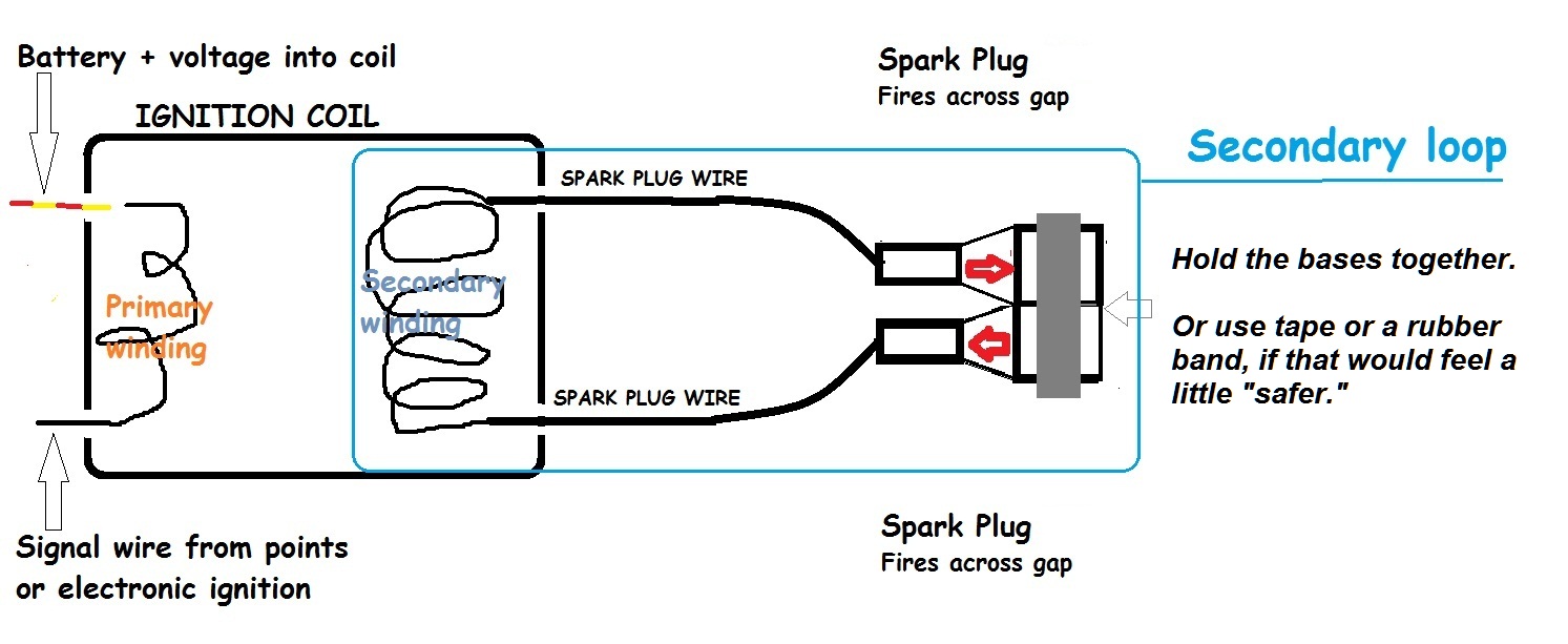

18 Nov 2014 03:09Nduetime wrote: ...In terms of the spark at the points. Early on, I managed to pull the plugs out and ground them to the motor to check for spark. Hard to properly do by oneself, in the middle of the summer afternoon, using the kickstart....
With a wasted spark system, if the plug wires are long enough, may ground the plug bases to each other to achieve continuity throughout the secondary loop, which is same as allowing the plug bases to be connected via contact with the engine head.

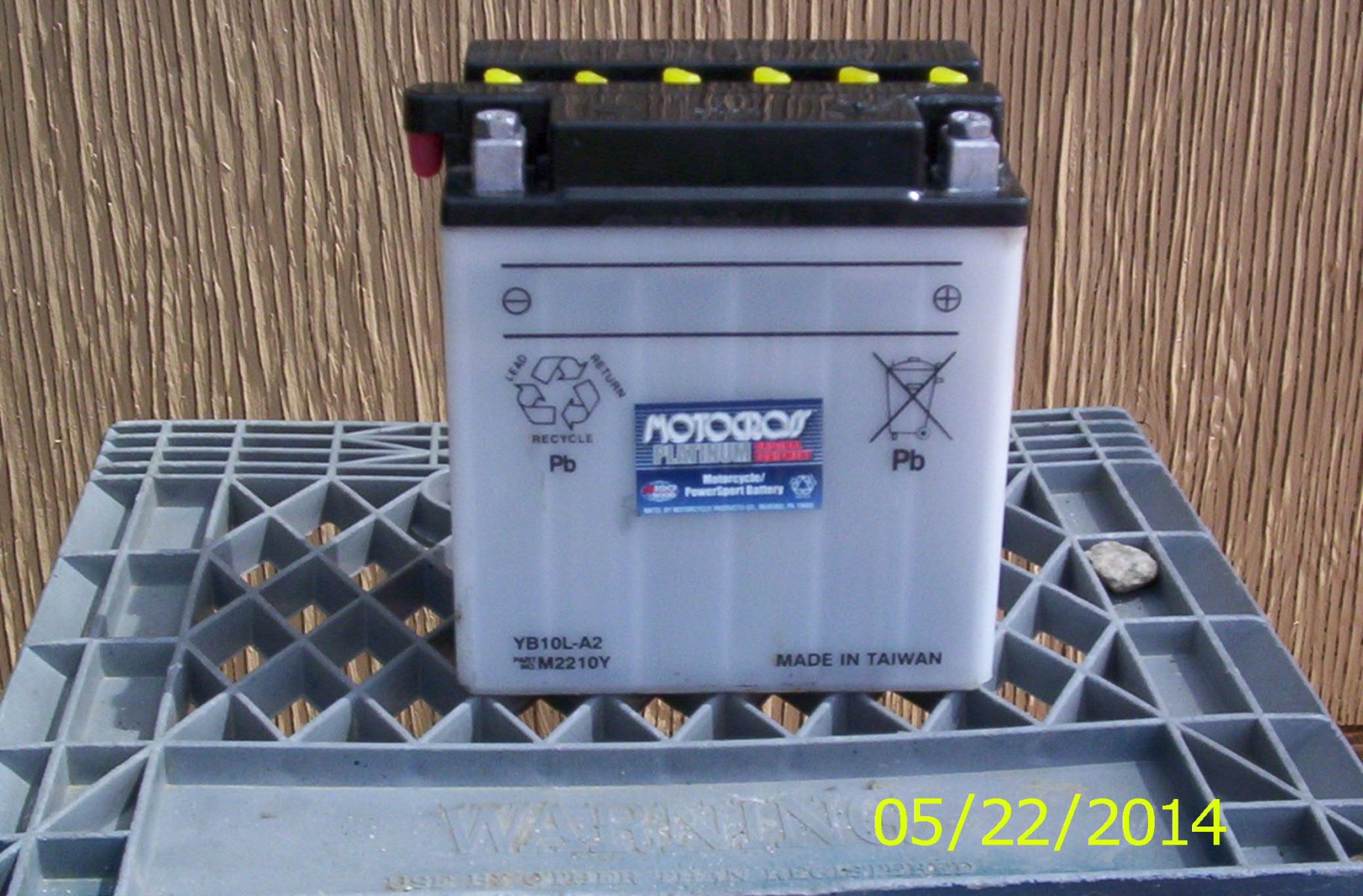

Batteries can be very expensive. I bought one at AZ for $80. It didn't even last a year. The warranty was only 90 days. I found a seller on Ebay, Battery Solutions and got one for $35 plus shipping and a one year warranty. I bought it but it was much smaller than the one I had. I called them and they sent the right one for $5 more. They didn't want the one they sent me because it had acid in it. I sold it on CL for $25. I highly and do recommend them.

So I recently purchased a new, full (proper) size battery from the shop I mentioned in the first post. Old battery was very small and inefficient.
