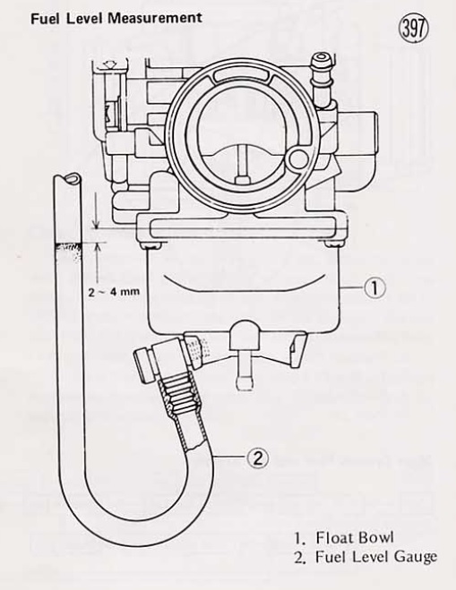

The carbs at hand apparently have simple, single-function drain screws (remove screw to drain the float bowl), and with the float bowl nipples serving only for overflow discharge.
For a freely downloadable workshop manual, may click on this link
www.kz400.com/
Next, in the left column, scroll down to and click on Workshop Manual
Or, use this link to go directly to the Workshop Manual
www.kz400.com/WorkshopManFrameset-5.html
See page 106 for information about the clear tube test for determining the service fuel level, which includes the following illustration:

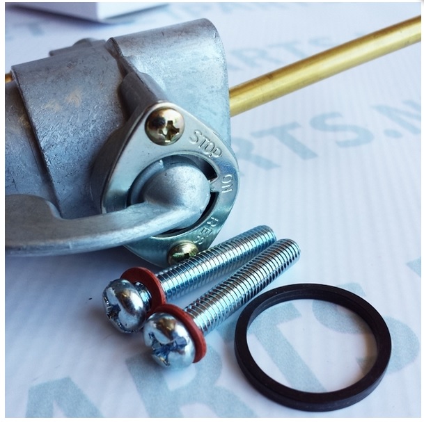

As to the fuel tap, it's probably a manual petcock with STOP - ON - RES positions,
But the fuel tap (aka petcock) might possibly be either:
• a manual petcock with ON - OFF - RES positions,
• a vacuum-operated petcock with ON, RES and PRI positions.
With a manual petcock, STOP and OFF mean the same thing, that is to say, "No fuel flow from the tank."
For the clear tube test:
• manual petcock ON or RES fills the float bowl;
• vacuum operated petcock PRI fills the float bowl.

The special tool isn't essential.
A clear plastic tube with suitable outer diameter will self-thread into the open hole from where the drain screw has been removed.
In my experience, using an appropriately size clear tube is faster than fooling around with screwing and unscrewing the special tool.
Could consider carrying a float bowl to the hardware store or hobby shop or aquarium supply to help assure getting the correct size tube.
Of course, a fuel-proof plastic fitting that inserts into the drain hole to provide a leak-free connection onto a clear tube may also suffice. But, honoring the KISS principle, I just use the clear tube alone.

I would add one thing to Patton's last post. If you have the manual tap and the fuel level is very low in the tank, no fuel will flow. When the level in the tank gets low, the fuel tap must be switched to RES in order for fuel to flow. This is a subtle hint to the rider that it is time to find a fuel station.
Try switching to RES and see if the fuel flow.improves.

26 Oct 2014 06:39 - 26 Oct 2014 06:40TexasKZ wrote: I would add one thing to Patton's last post. If you have the manual tap and the fuel level is very low in the tank, no fuel will flow. When the level in the tank gets low, the fuel tap must be switched to RES in order for fuel to flow. This is a subtle hint to the rider that it is time to find a fuel station.
Thanks, TexasKZ!
So true.
I edited the post to include either ON or RES to allow fuel flow from the tank with a manual petcock when determining the service fuel level by performing the clear tube test.
