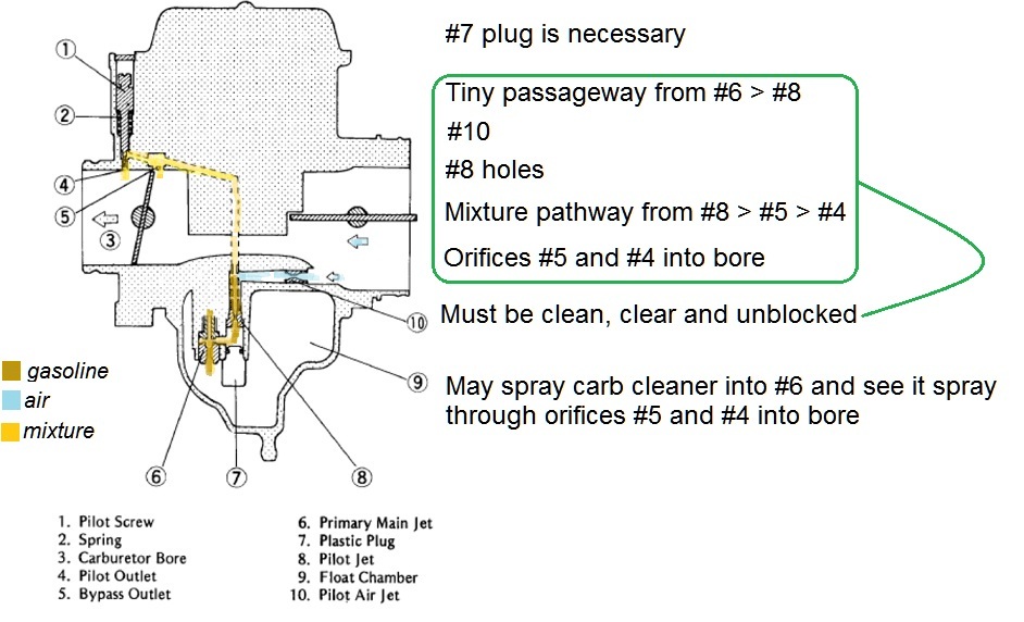

When using carb cleaner in a pressurized spray can to clean the pilot circuit, be sure that the cleaning spray passes through the small orifice into the carb bore.
If the pressurized spray can't get through the orifice into the carb bore, neither can the fuel mixture as it's supposed to do in normal operation.
The following illustration may not exactly match the carbs at hand, but shows the basic idea.
