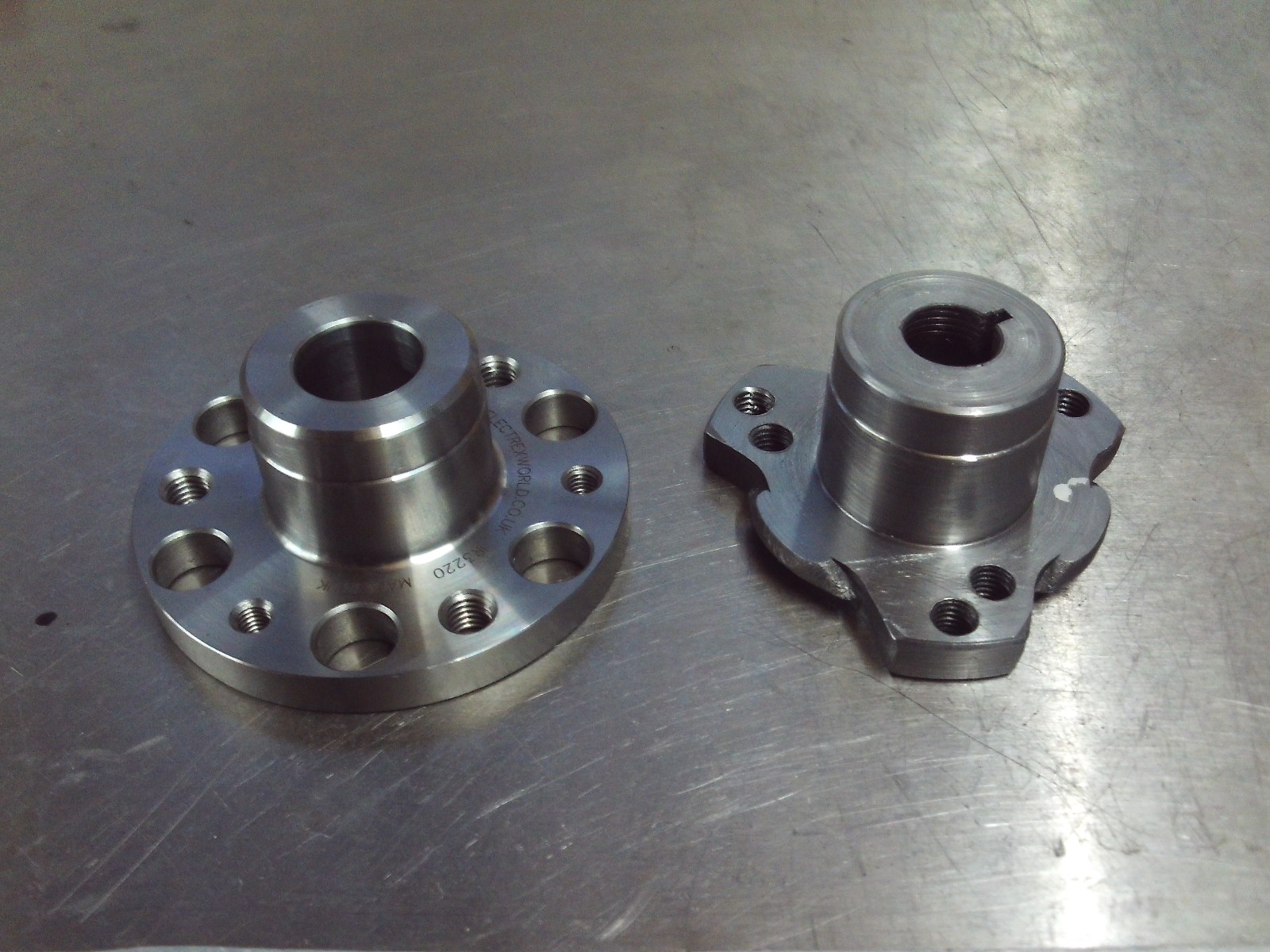

17 Aug 2024 15:09 - 17 Aug 2024 15:10On the left is the supplied rotor mount for the large taper non keyway MK2, J and GPZ cranks.
And on the right is my rotor adaptor for the earlier keyed crank which i made using a modified steel core with key slot from a spare z900 rotor i had.
And this is it installed along with the rotor and quite a few other mods it needed before it would fit.
Thanks for sharing. This looks like it could be a solution for my KZ750 track/race project. I'll have to make my own engine cover obviously and who knows what else, but this looks like it may be easier and better than what I was previously dreaming up.
Do you know the dimensions of the MKII crank taper? 750 twin tapers from 25mm to 20mm over a 25mm length.

18 Aug 2024 03:08Yes! the Mk11 crank is 25mm down to 20mm over approx 25mm ( I have one here that is going in my turbo build ).
The actual taper angle is the same as the earlier crank ( although on a smaller diameter ) and most Kawasakis seem to use the same angle.

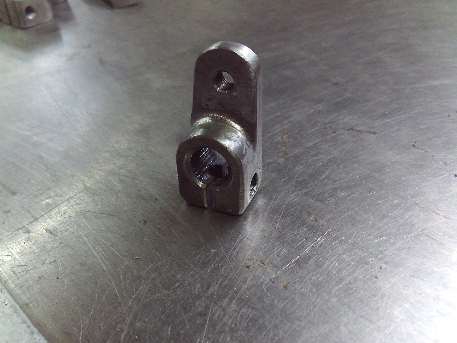

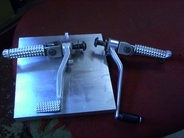

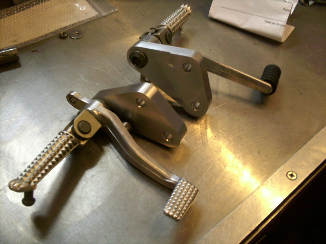

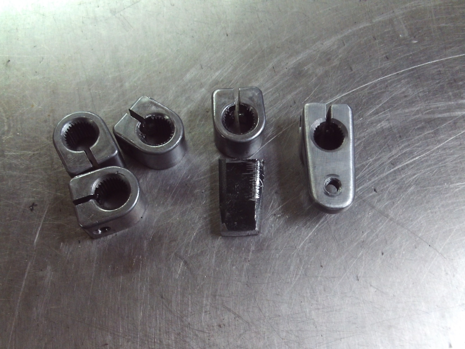

22 Aug 2024 11:56 - 22 Aug 2024 11:57Outrigger plate is 10mm dural but you could use 8mm.WOW!!! I love it! Quick question....what did you use for the rear sets and shifter on the shaft. Also, what thickness was the plate for the clutch slave cylinder/countershaft bearing? Thanks for the info.
Footrests are Yamaha R1 mated to ZXR levers with some one off nylon pivot bushes .
And the mounts from 16mm alloy plate.
The splined linkage arm is home made using one of these bought splined knuckles which was later zinc plated.

22 Aug 2024 13:54Most Kawasaki and Yamaha use the same gear spline.Thanks for the info, very much appreciated. Do you (or anyone out there) know if the shift shaft the same size as other newer kwaks? Like ZX's of different models. I don't have access to a welder.
Did I tell ya I love that bike?
I've used Yamaha R1/R6 and ZX10R aluminium ones on previous builds.
