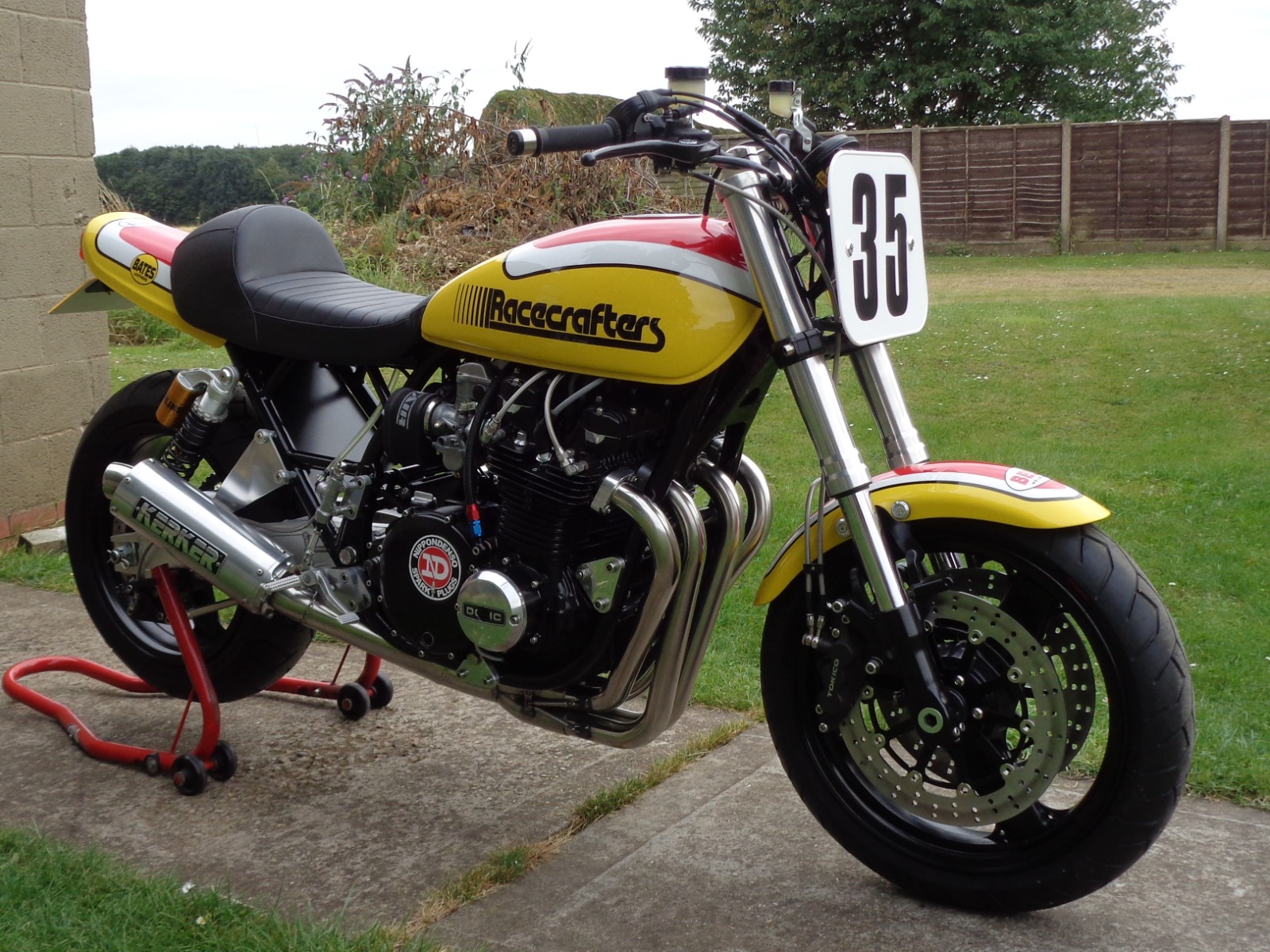

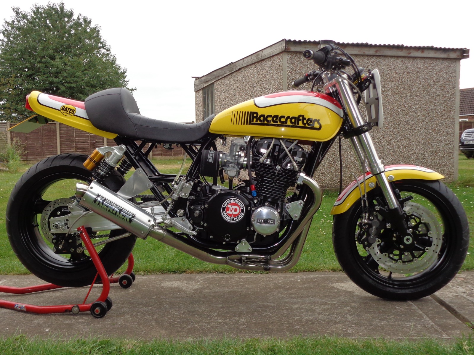

Just finished one of my latest projects so thought i'd post a couple of pics you might like ?

WOW what a stunner (not that it comes as a surprise) you know I'm gonna be chasing you for the back story on this gem

What exhaust system is that?

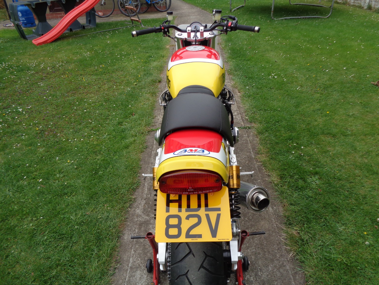

Also, what bike did the tail light come from?
Yes, we are going to wart you until we get the whole story......

Home made exhaust with shortened ZRX1200 Kerker can and period NOS Pre supertrapp Kerker "Racing system" badge.
Rear light is Honda Blackbird.

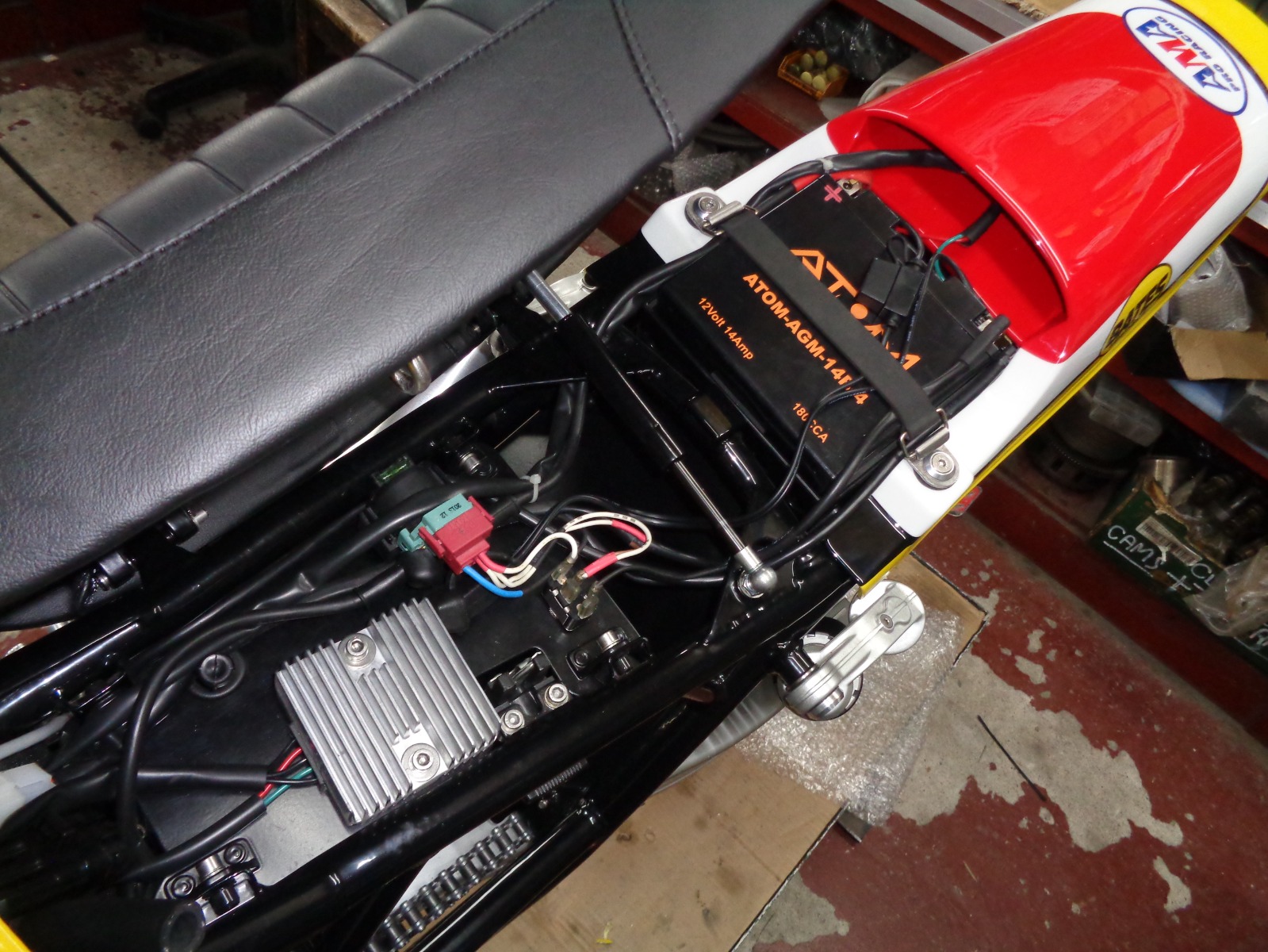

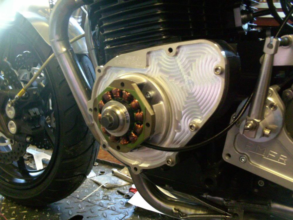

Can you give us some details about the electrical and charging system?
What is under that custom generator cover?
Is there a battery hiding somewhere under the seat or tail?

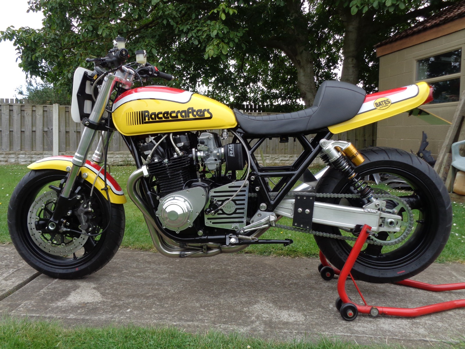

The minimal electrics are hidden under the seat .
Basically a battery, reg/rec, starter solenoid and a 30 amp toggle switch for power on/off.
And the generator is an 25 amp GPZ1100 Electrex race item that i've modified to work with the smaller Z900 small taper keyway crank .
It uses the same windings as the alt i used on the alloy cafe racer in this pic but is enclosed and allow the use of the starter motor.

Really nice work, I like the "gas strut" to hold the seat up

The bike is for dry days only and for daytime use the minimum you need is a constant sounding horn.
No lights or anything else required so why not take advantage of that and build as close to a race rep as you can.
I have fitted a brake light though for when i'm in traffic .
