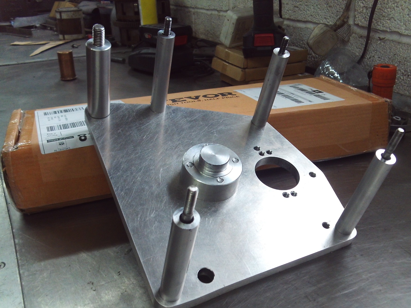

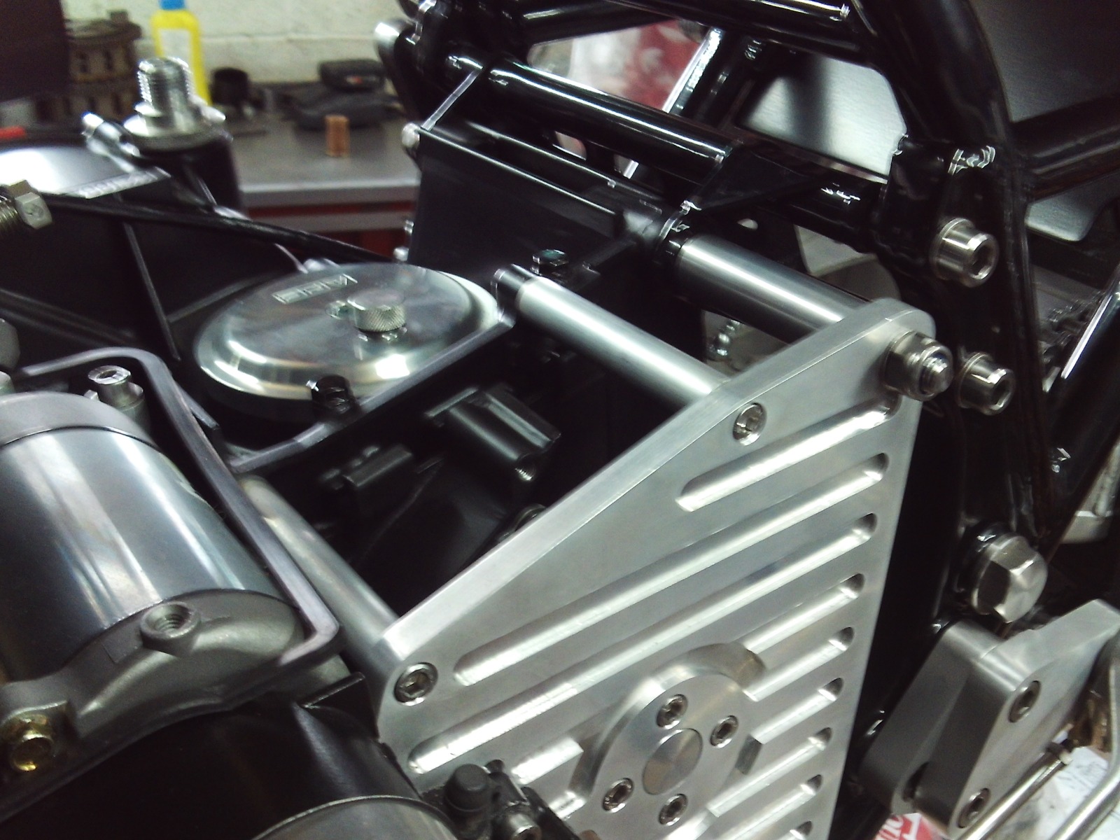

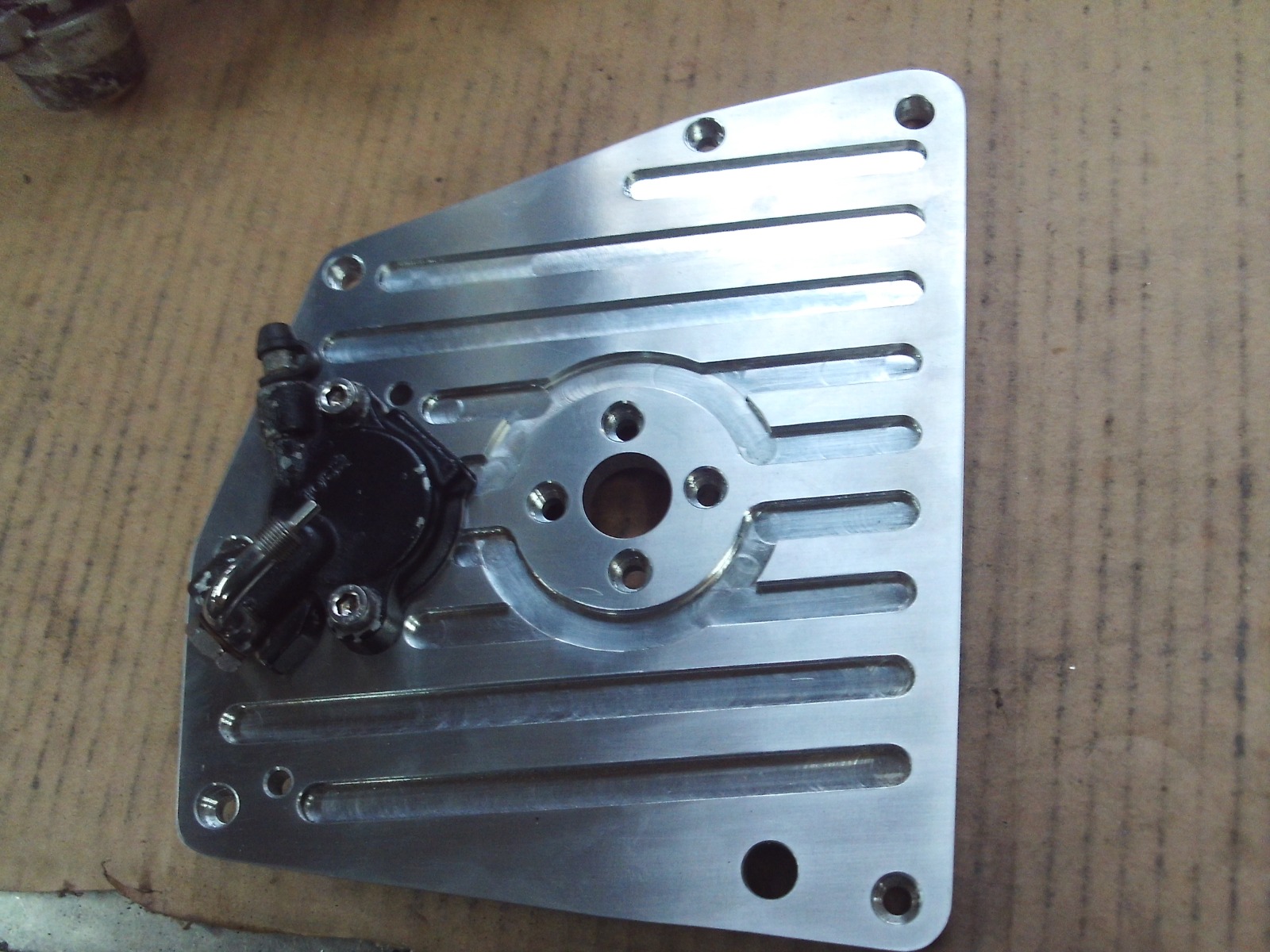

I like the hydraulic clutch setup. What is it from and how is it mounted?

15 Aug 2024 05:39 - 15 Aug 2024 05:40It's a Kawasaki ZXR750/ZX9R slave cylinder mounted on my own outrigger plate.I like the hydraulic clutch setup. What is it from and how is it mounted?
The master cylinder on the bars is a Nissin radial item from a ZZR1400 .

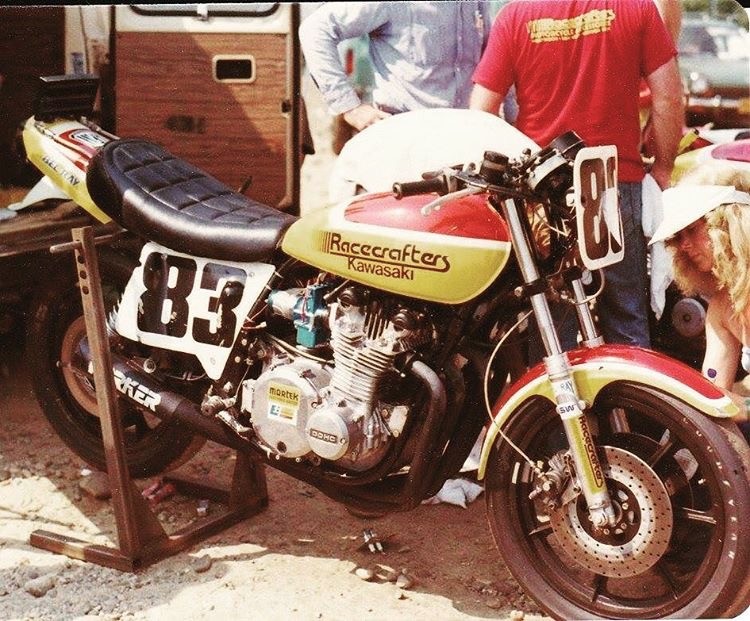

You got to kick up the tail section and put an oil cooler on it. Then it would be a true Klinzmann special!!!!
Klinzmann raced that bike as #31.

I never liked the look of coolers on the tail and the tail angle was a bit too steep for my taste so no cooler and i limited the tail lift to around midway between stock and the race bike which i think is near perfect for the lines of the bike whilst retaining a nod to the style..
As for the number.
Every man and his dog goes for #31 but i'm not a sheep and like to be different so decided to be less predictable use either 35 or 83 that has been used on the odd occasion.

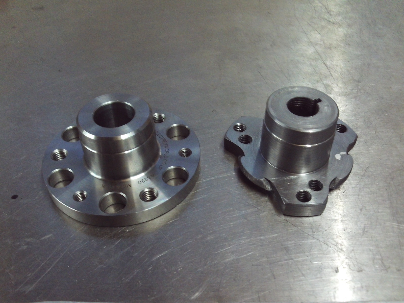

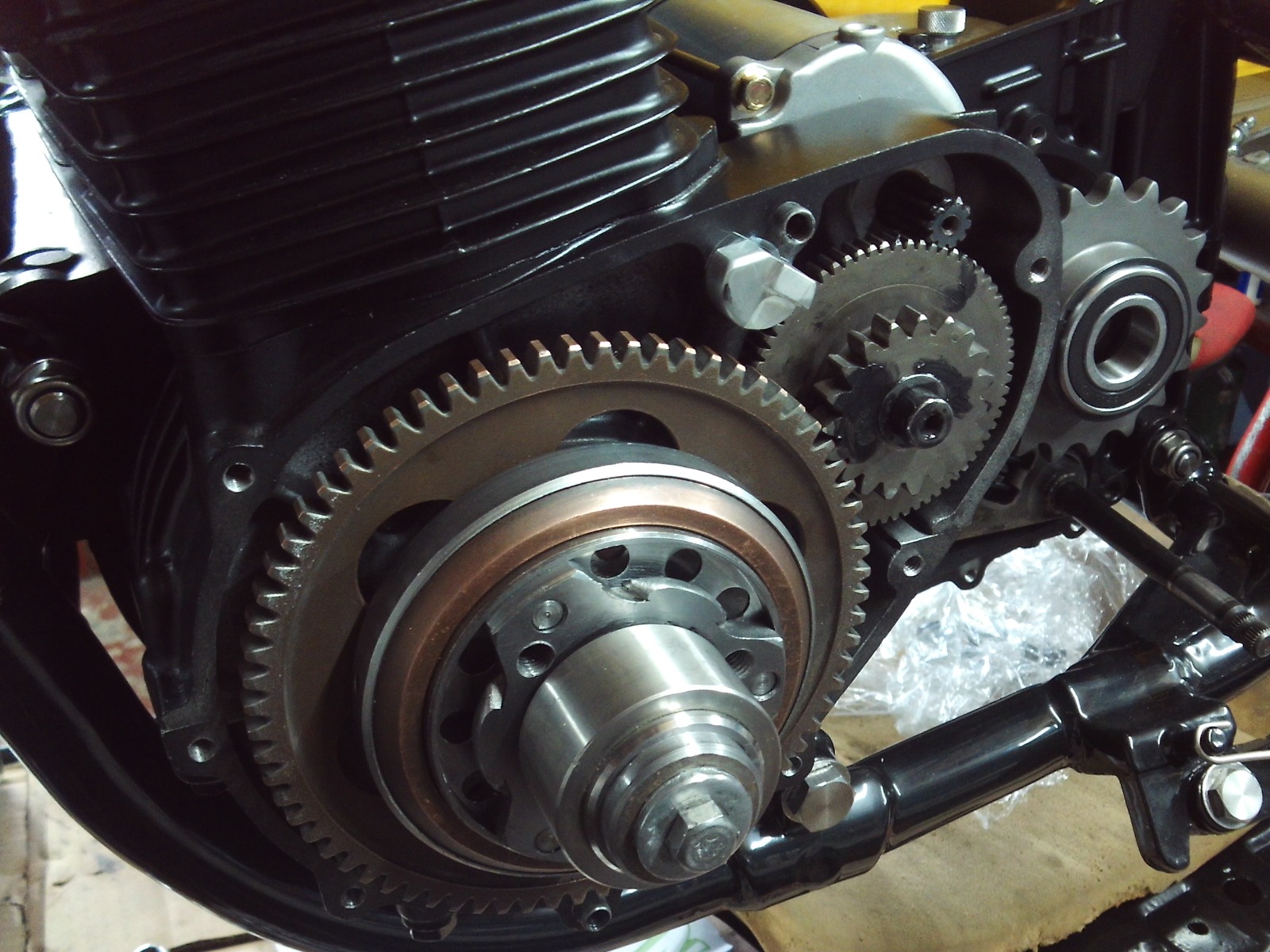

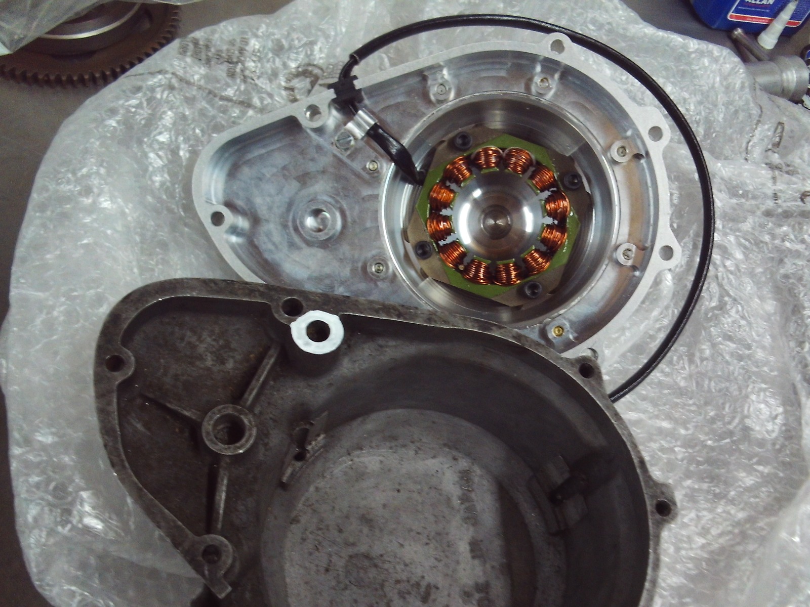

17 Aug 2024 01:06This is a very cool piece of kit. how did you modify it to work with the smaller taper? nice work as always.

17 Aug 2024 06:52 - 17 Aug 2024 09:40This is the inside of the enclosed version ( above a stock case ) which uses the same windings as the above open type.This is a very cool piece of kit. how did you modify it to work with the smaller taper? nice work as always.
On the left is the supplied rotor mount for the large taper non keyway MK2, J and GPZ cranks.
And on the right is my rotor adaptor for the earlier keyed crank which i made using a modified steel core with key slot from a spare z900 rotor i had.
And this is it installed along with the rotor and quite a few other mods it needed before it would fit.
