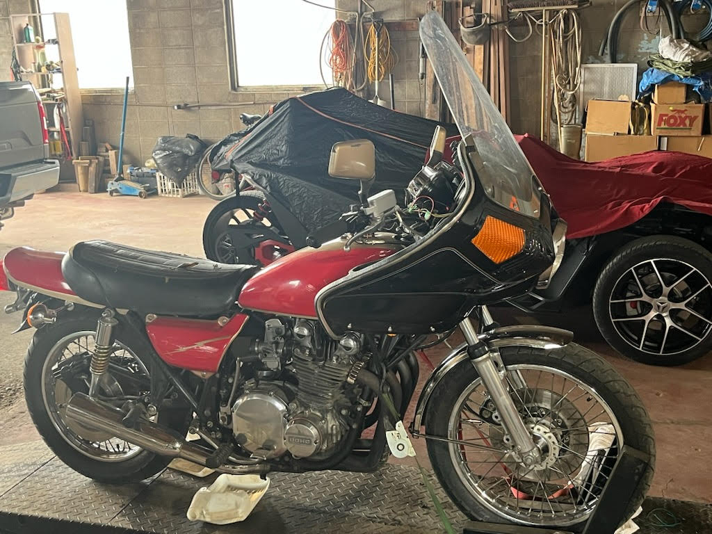

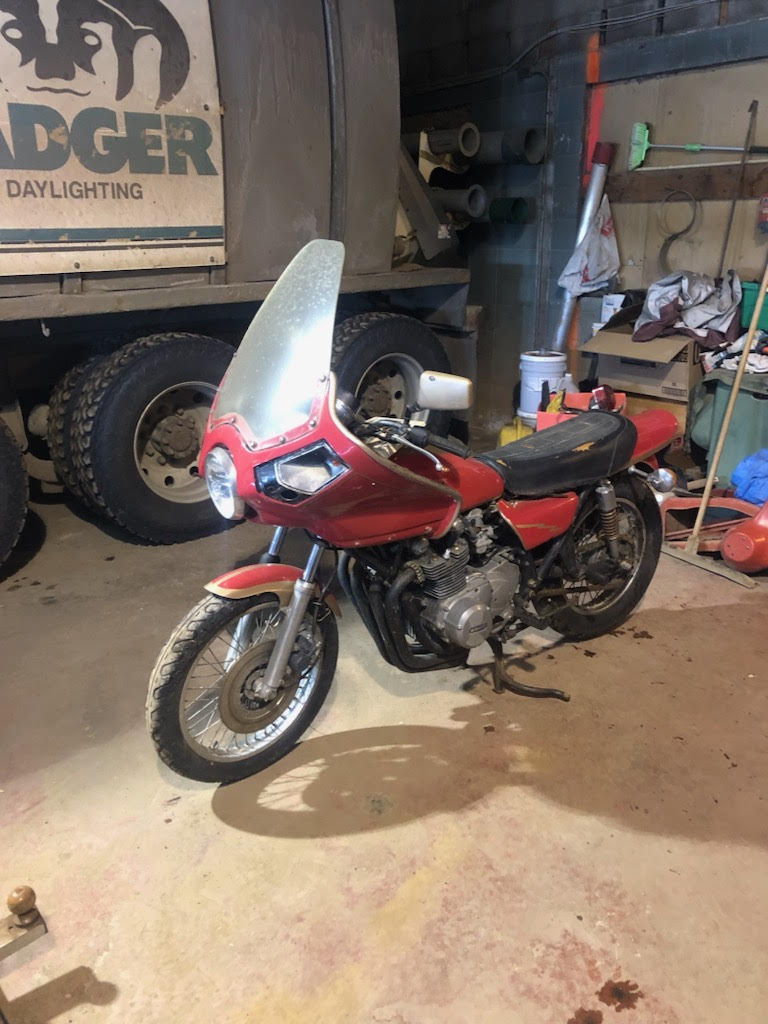

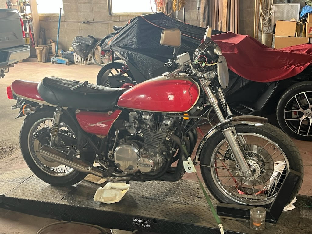

27 Jul 2025 21:39I thought I'd throw in a few before and after pics. I know it's the opposite side. But pretty amazing what chrome polish, aluminum buffer and wax can do!
For now I'm leaving the paint. My friend did a pretty go job, for a home paint job. And sitting outside for 12 years.
The first one is shortly after I got er. The fairing had a big crack in it. I was able to find a fairing with a really good windshield, plus fairing and lowers and a rear rack with trunk. For less than a new windshield.
I really like the look of the naked bike the best. But I'm just not a big fan of being blasted any more.
I've got an almost new front fender to replace the 440 fender this winter. She needs a seat cover and a seat pan ( or fix this one).
I'm going to paint the headers. And possibly frame and engine. Was a blacked out engine, OEM in 1978? I've been looking at pics, it seems it may have been both ways!?
