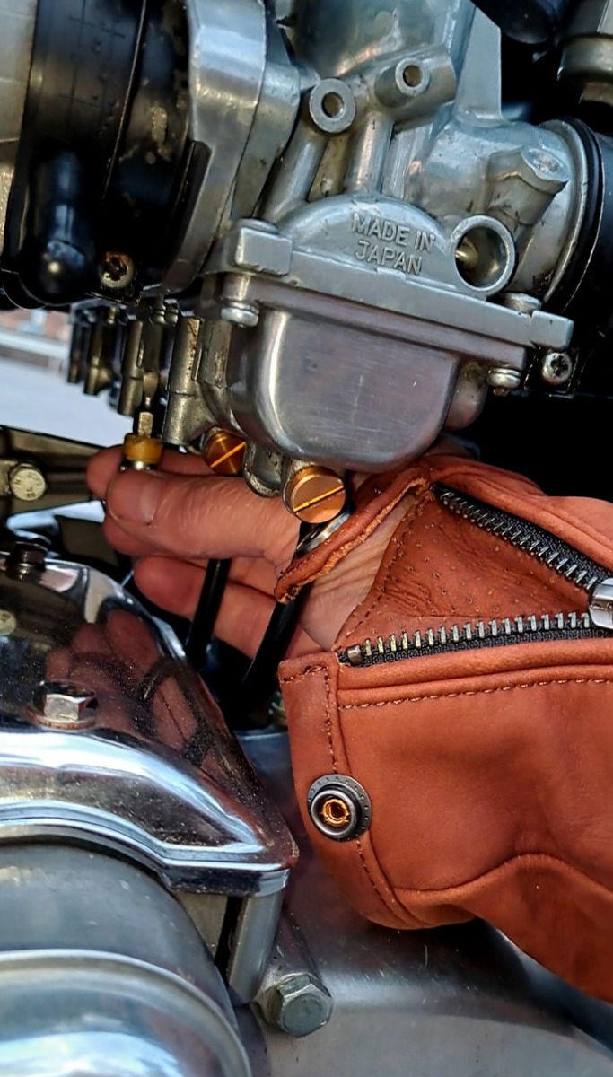

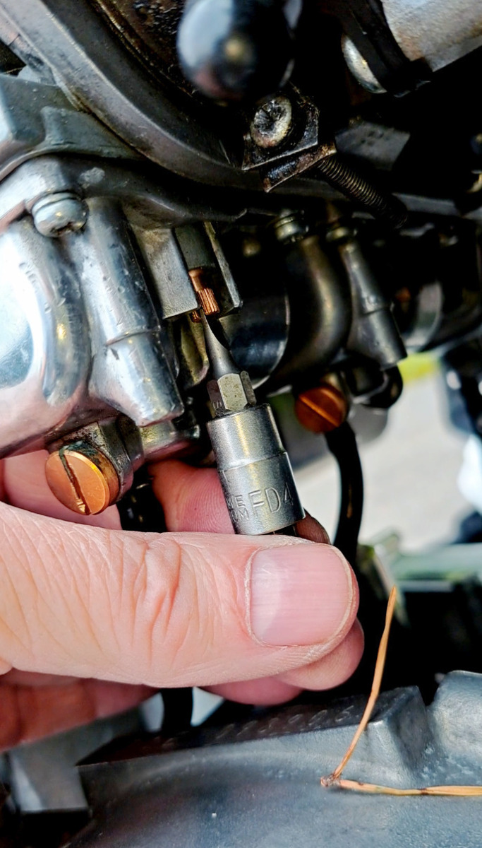

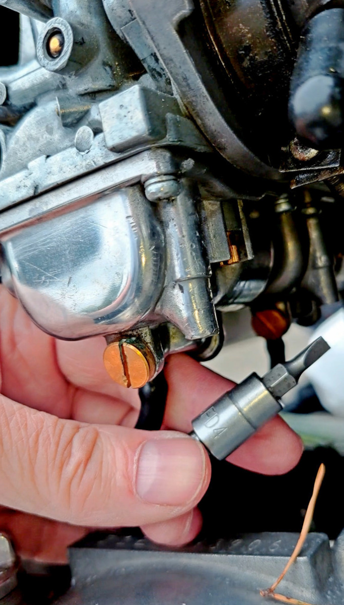

If one cyl not firing from to much or to little/no fuel you can try to start the engine and then use a little screwbit to turn on the mixturescrew .First turn it all in until it stops, but be careful use light force!!. then you turn the screw out until you can hear the cylinder fires. it can somtimes be difficult to hear that when idling so blip throttle a little and you will hear if it runs on all 4. You dont want to overheat engine so work fast and on a cool windy day or use fans infront of engine.
Re: new to me 1978 KZ 1000
02 Mar 2025 03:50
I would use a tight fit rubber fuel line to adjust the fuel screws.
You can also make a DIY socket like melting a plastic stick/tube and molding it by imprinting on the screw head.
It´s easier to handling this tricky task.
