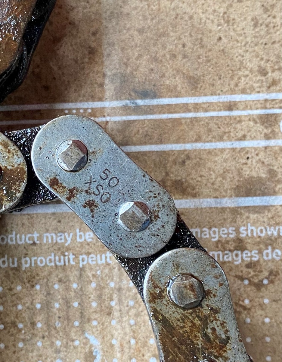

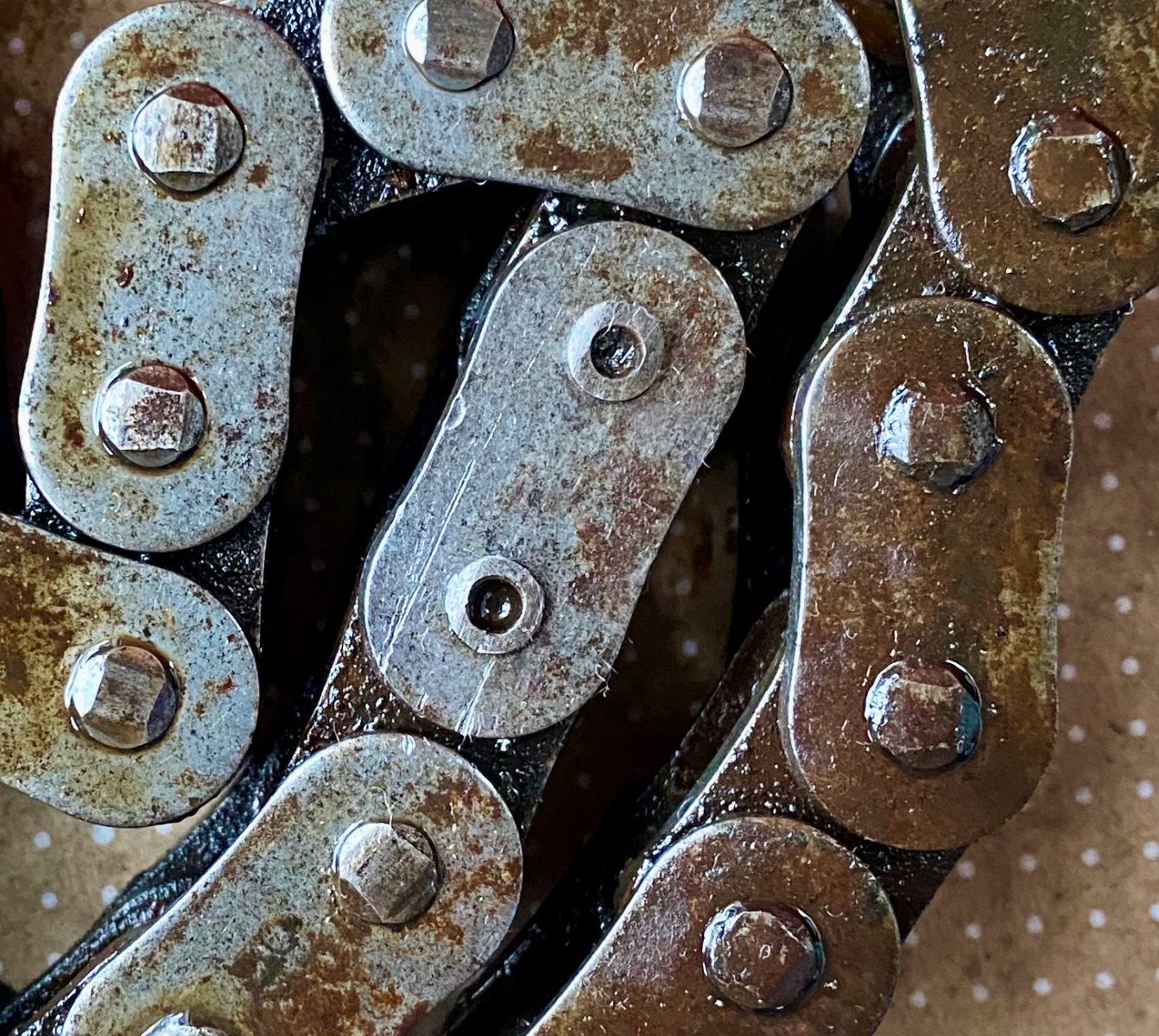

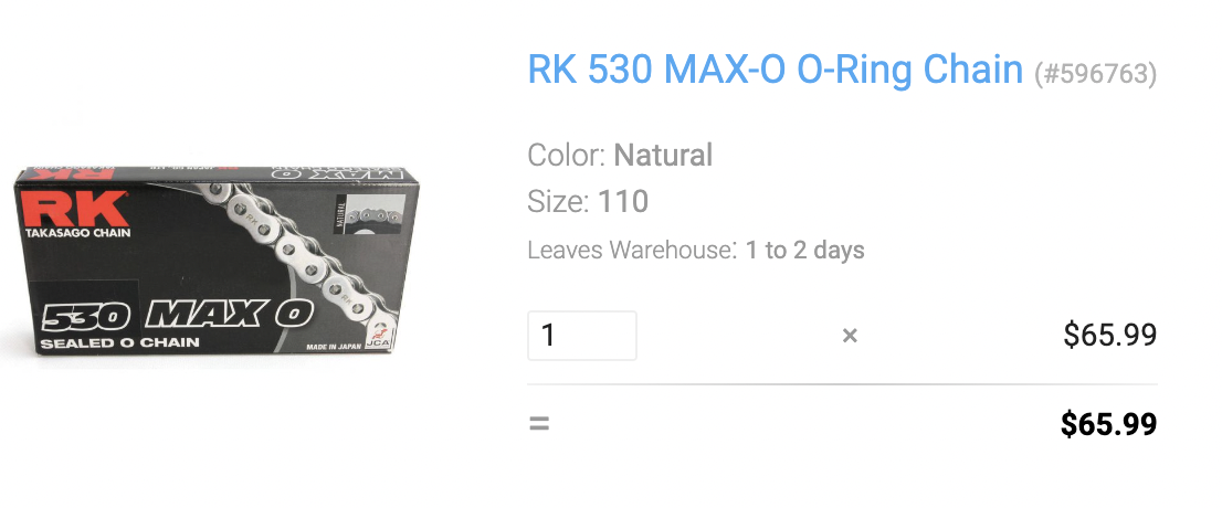

This is the chain on the KZ1000 when I acquired her. Nice thick plates, O-ring, loose joints, a firmly riveted master link, but dirty with some minor superficial rust.
I see the 50 XSO etched on one of the outer plates, and figure it's an RK chain which should be OK to use.

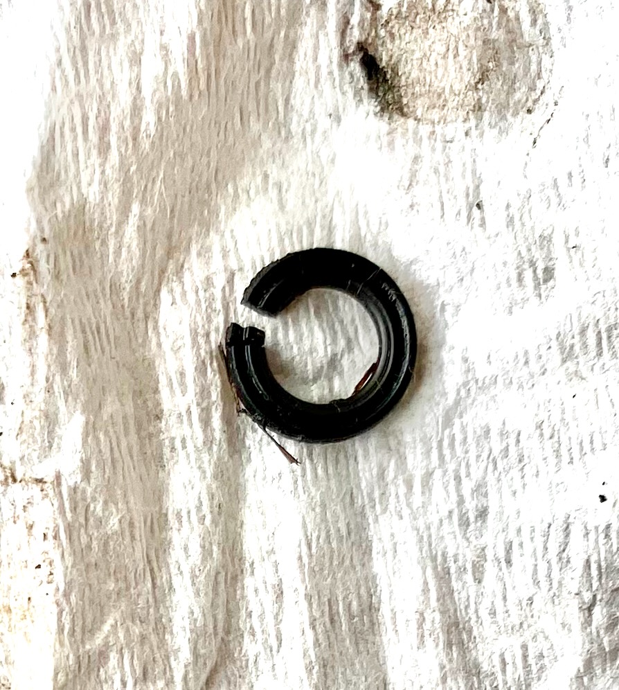

However, it looks like it is losing its O-rings, and I tossed it. The O-ring pictured is brittle.
Do you guys have recommendations for chains. Preferably good and strong, O-ring, and revited master.

I think I'll order this chain tonight. Should be OK, no power shifts into second gear are planned!
Probably has a clip master link, but it looks like a sturdy design.

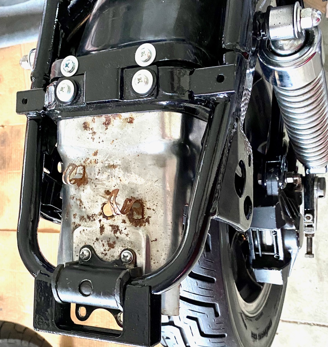

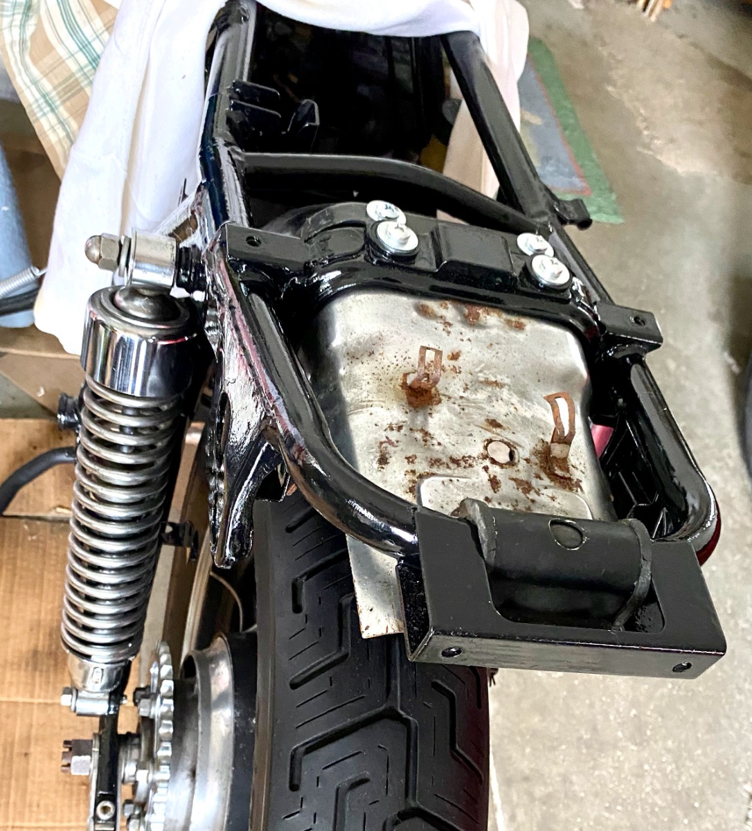

Butchery and shear madness from teenagers. I cut my teeth on British sports cars from the 1960s, and not one improved in my young hands!!
The 77KZ1000 did have a good rear fender and tail light, but the previous owner need it for another project, so I'm left with the "bobbed" beauty.
I had a used fender and tail light lined up in Toronto, 600 km round trip, but the seller vanished.
I'll look for a "For Sale" section in KZRiders

I bought a nice used Z1 (or maybe KZ900) rear fender on eebay last spring, $40US plus about $10 for shipping. They come up pretty regularly, some nicer than others for reasonable money. Seen a few tail light brackets too, but not too often.

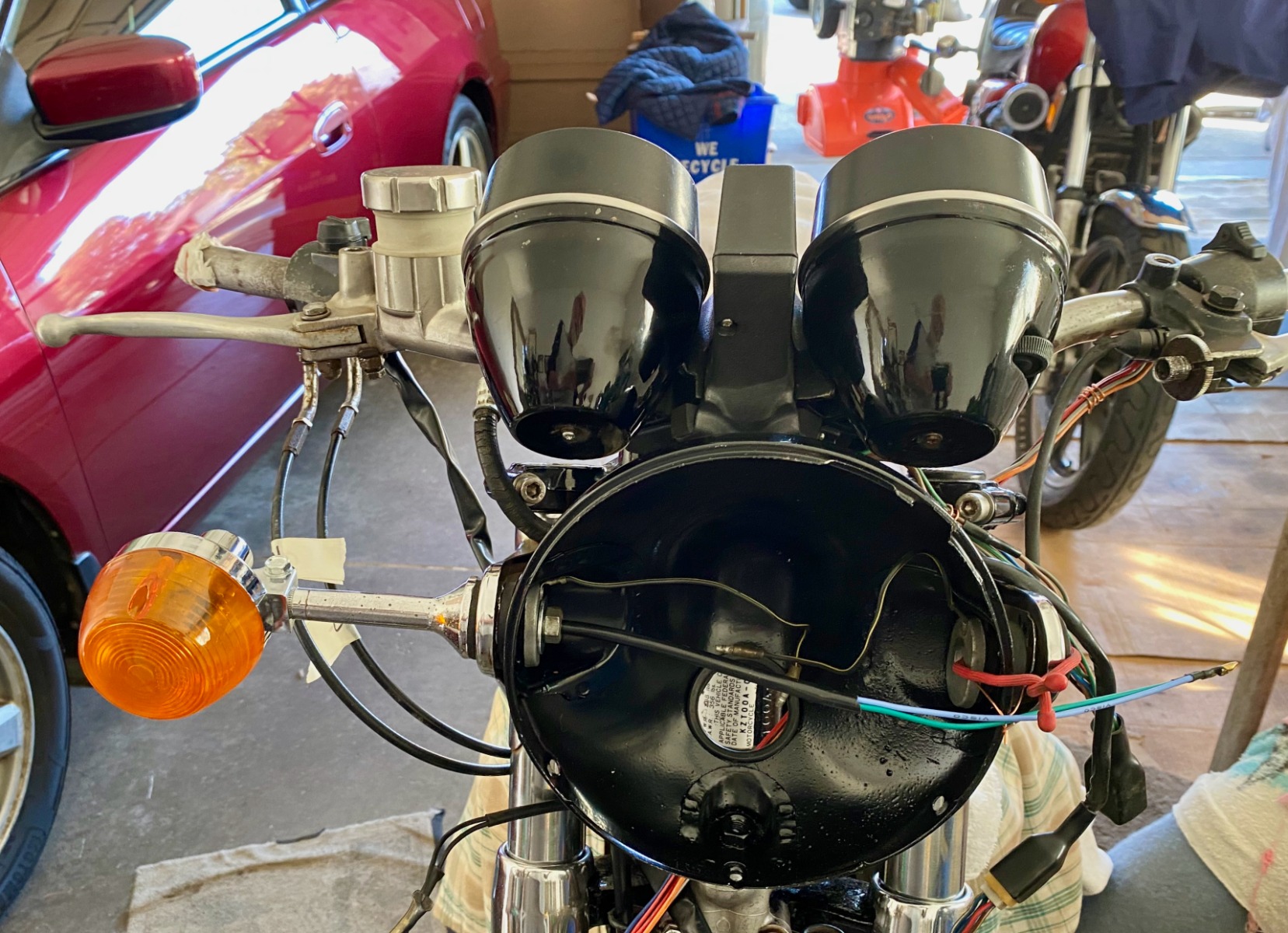

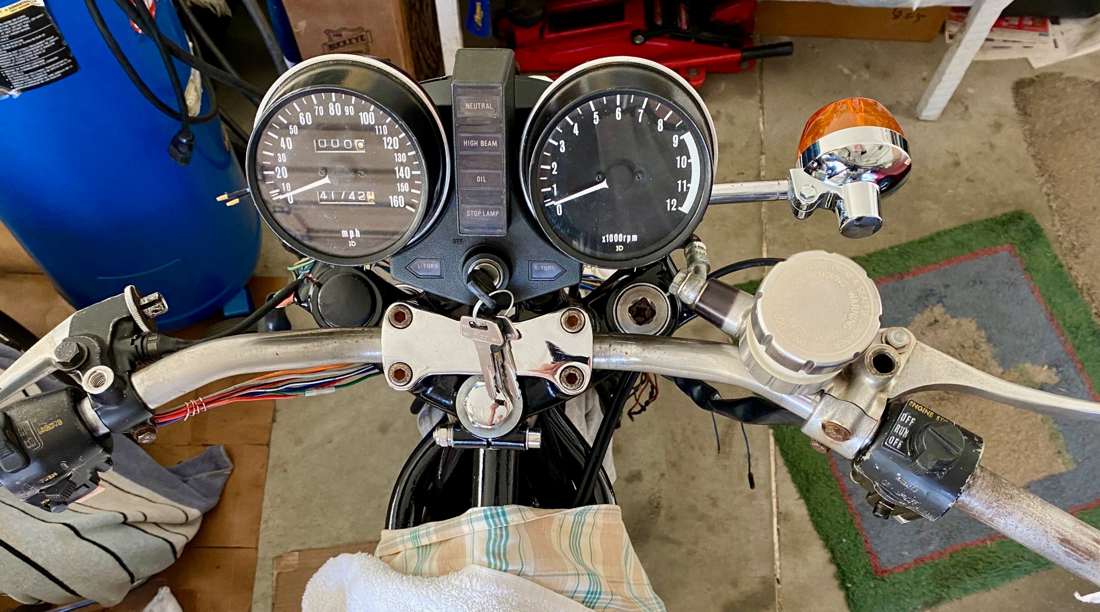

A few more items add to the old Zed.........meters and ignition switch, etc............and the headlight shell and front turn signals.
This means the electrical spaghetti is starting to accumulate, which frightens me with futre work and confusion.
In Winter my attached garage can dip below freezing, but I think the meters can handle the cold without going wonky.
