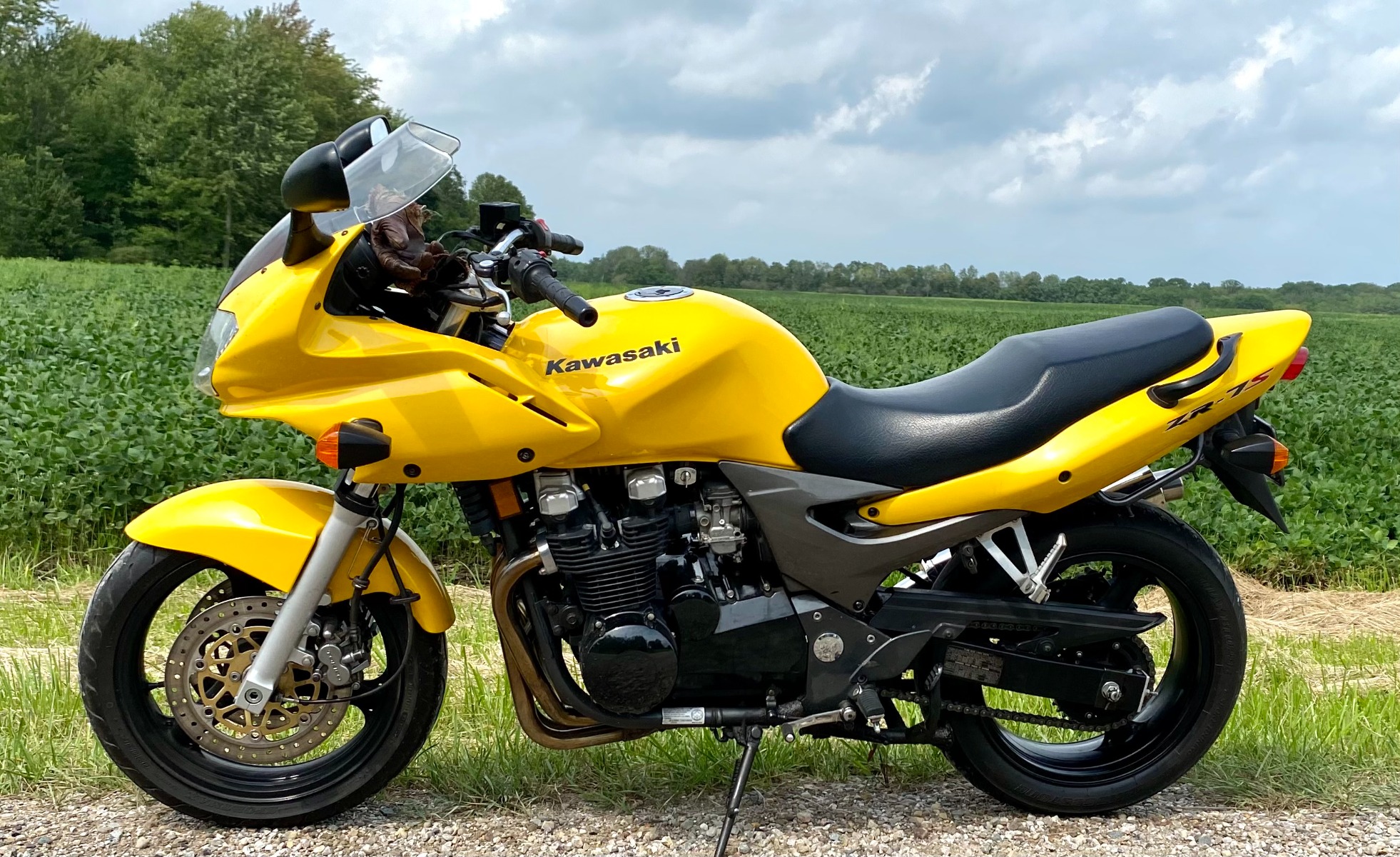

I can't complain about the ZR7s.
She returns more than 70 miles per Imperial gallon, and the only failure I've had was the front signal stalk rubber mounts, which cost 12$ each to replace.
When I first bought the bike there was a low rpm rattling sound coming out of the instrument cluster. The dealer gave me a brand new headlight assembly to install, but the rattle buzz remained.
After way too long investigating, it turned out to be the speedometer needle experiencing an axial resonance just at a specific rpm. I shimmed that axial play out of the needle, and the buzz buzzed off.
It's my only bike with Z-rated radial tires, which I've concluded are unnecessary for her power output, but are perhaps a benefit for stopping her. I've only had to do one "balls out" stop for a country dog that popped onto the road from a drainage ditch, and the ZR7s can STOP!!!

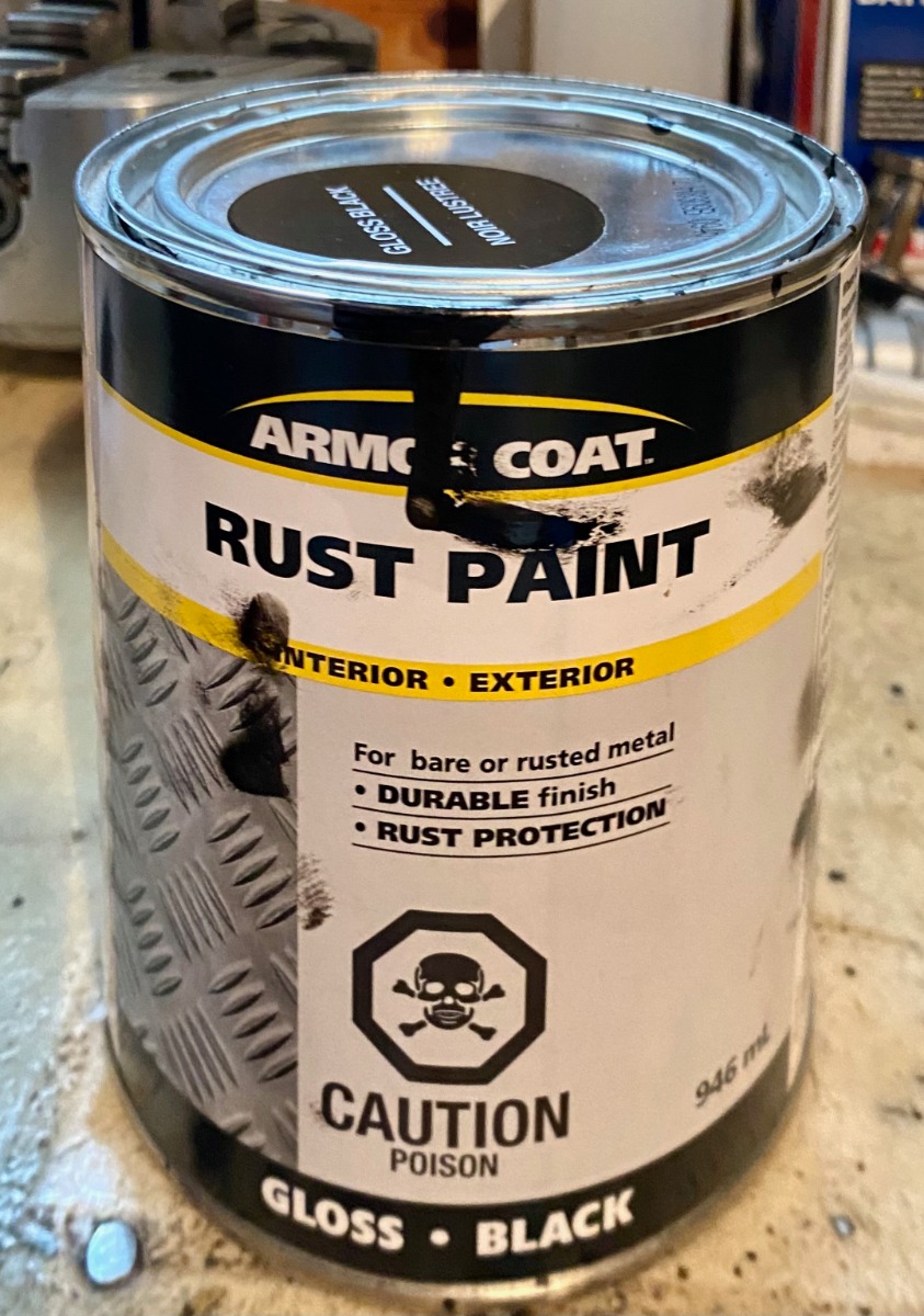

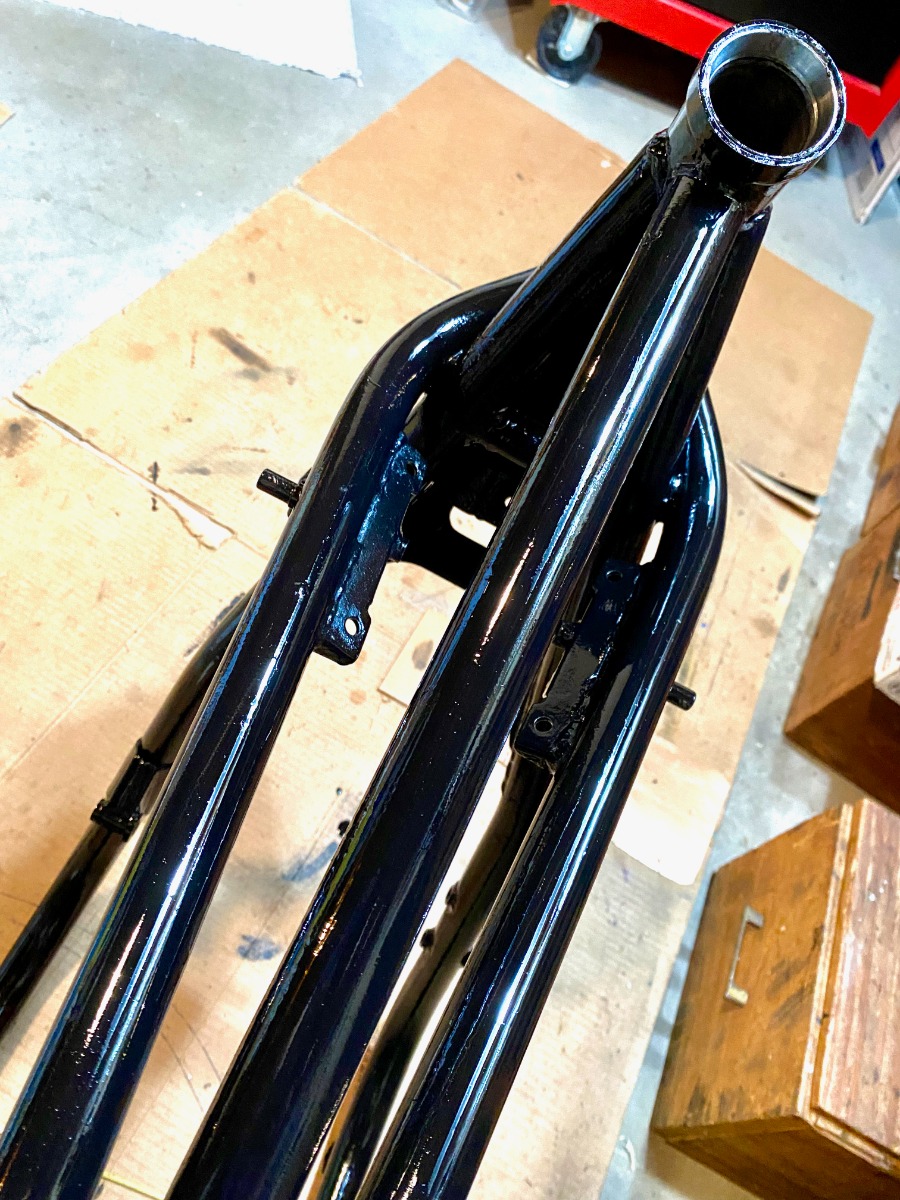

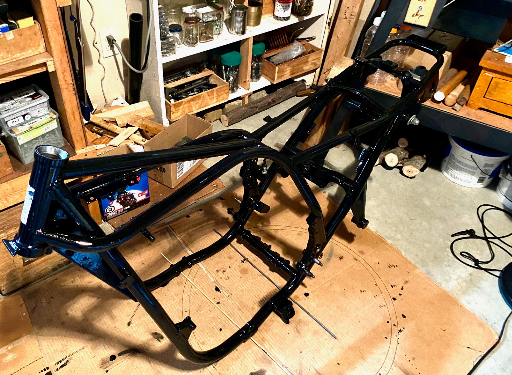

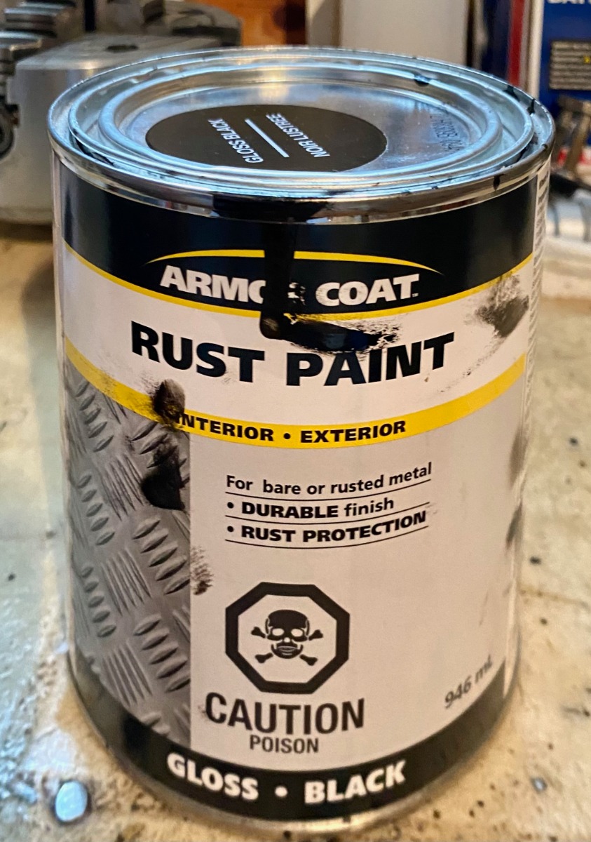

A cold rainy day motivated me to do some indoors work, and got busy of the 1977 KZ1000 frame. After pressure washing I gave the frame a strong scrub down with warm water with detergent and an industrial grade coarse ScotchBrite. The factory paint was more durable than anticipated and the pad gave it a nice etch, but not often down to the steel.
Then a rub down with a clean cloth and hydrocarbon heptane based brake cleaner.
That Armor Coat gloss black paint goes on very well, even with a cheap brush, and levels very quickly. I can't spray as well as this paint goes on. But it does take more than 24 hours at room temperature to cure to the point of handling. And nearly a month for a complete cure.
I'm sure I missed a few spots, but black is an easy touch up.

It’s tedious cleaning and painting the frame but so worth it when the job is finished.
I wish I used that paint when I did my last project. I used spray paint which is easier but not as good as a brush on paint.

Thanks blipco, these modern paints are pretty good. And you can get a thick coat in one application, which is why the cure rate is so long. I don't know if that Armor Coat is total oxygen cured alkyd or polyurethane which is moisture in air cured. I'll google it.

I googled and thought I saw polyurethane but double check. And only sources in Canada came up. I was on my way outa the house but anyways, I don’t need it now but it would be good to know about.
