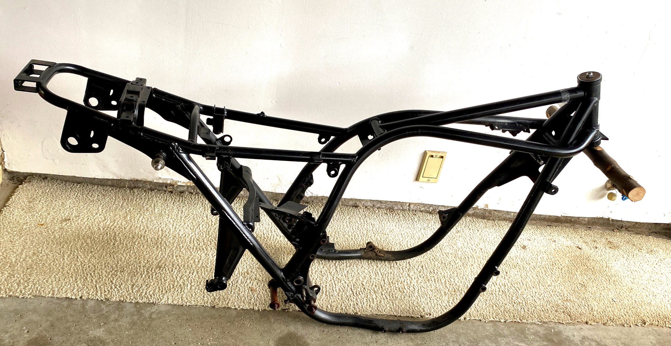

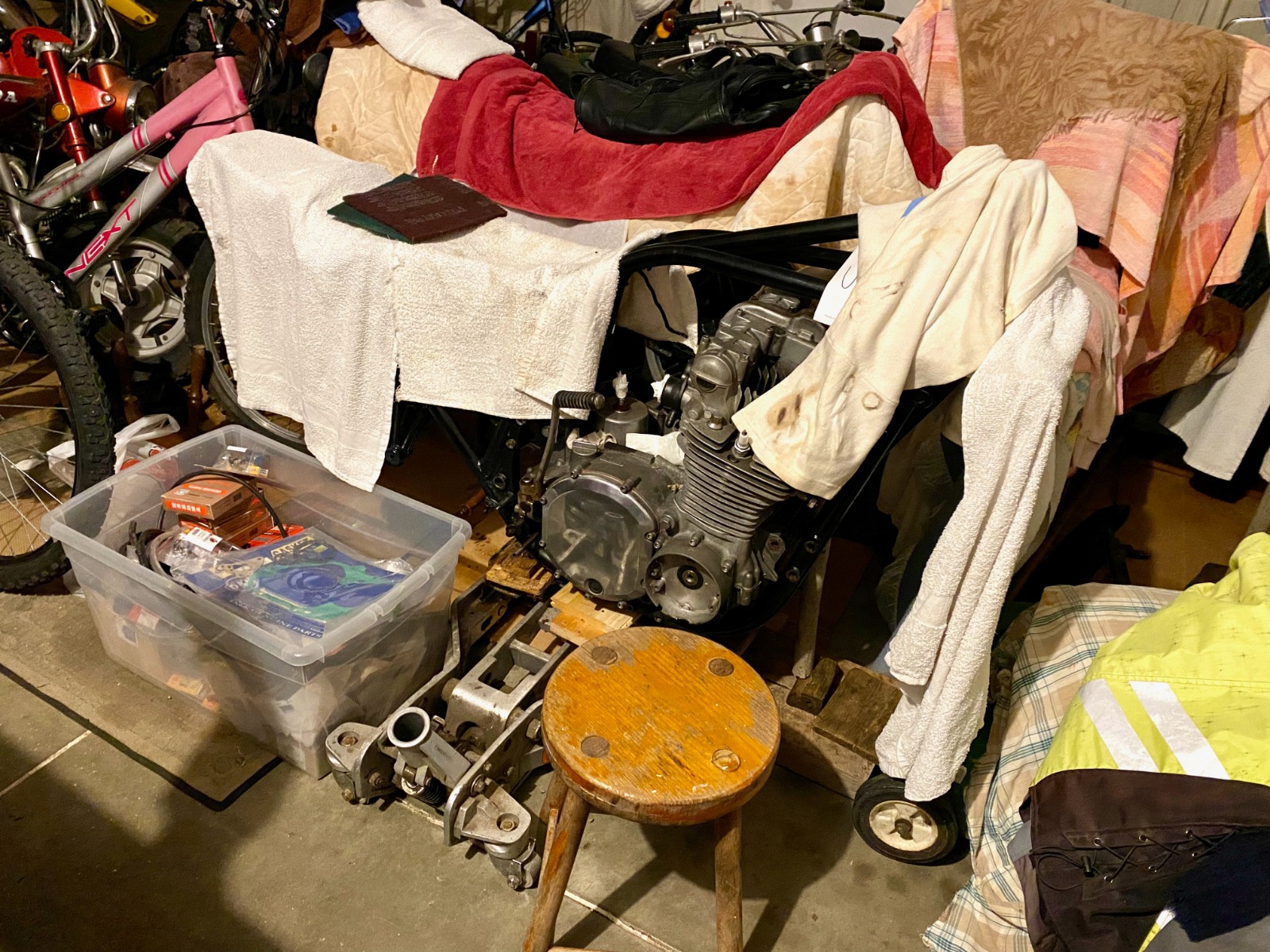

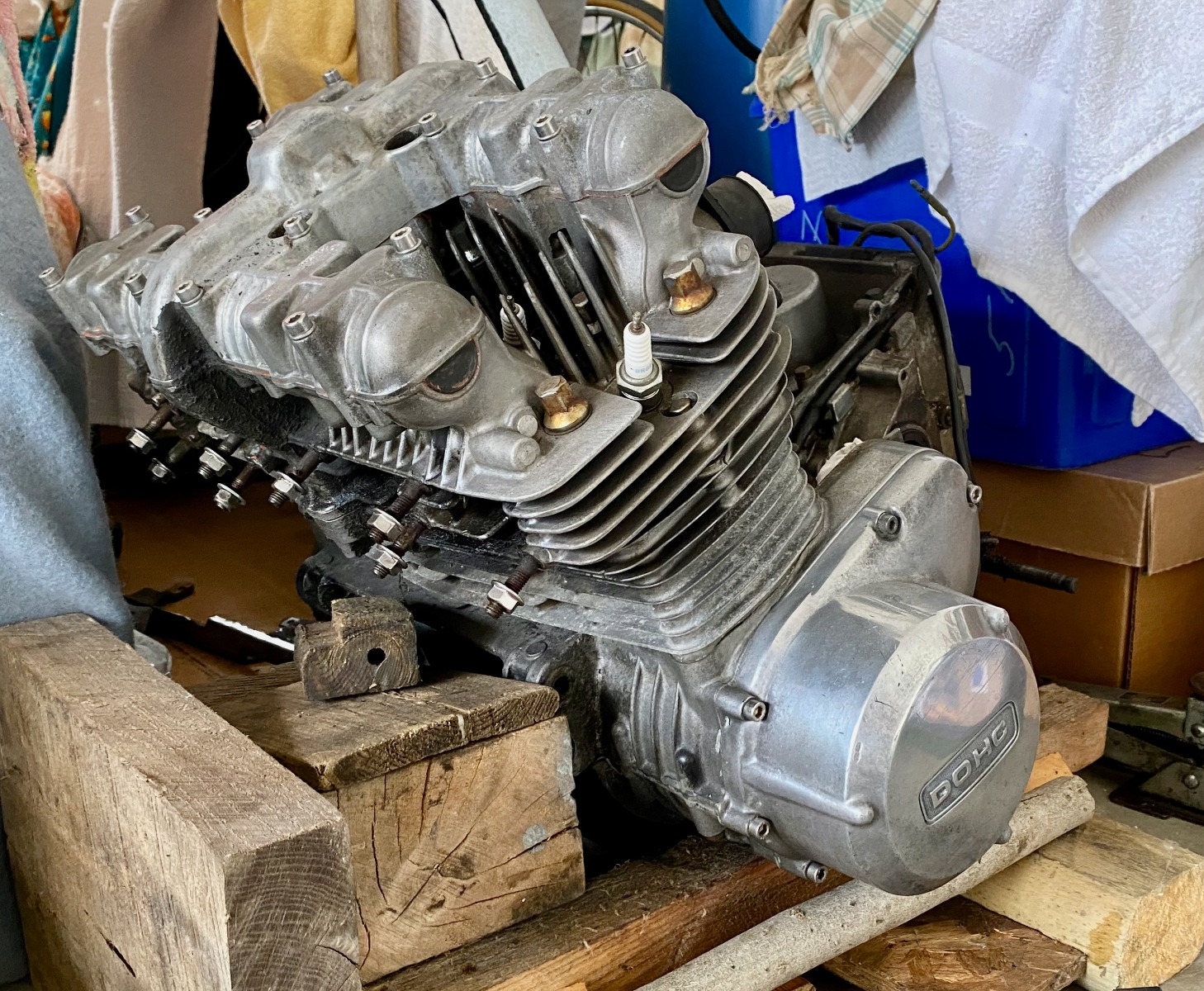

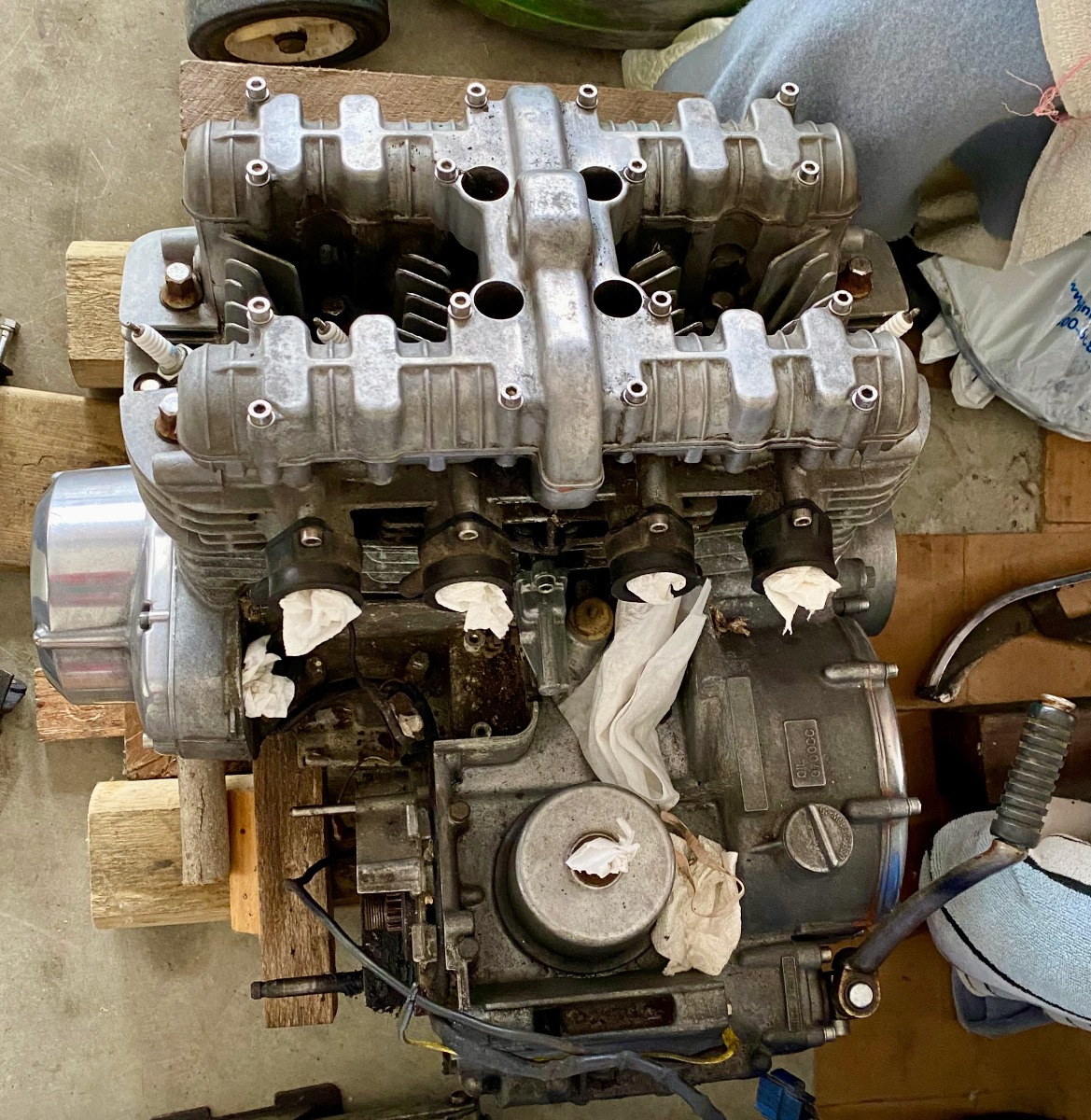

Living in the shadow of the Great Lakes means a rainy April, so there was some time to get back to the 1977 KZ1000.
I had a "lift party" in the garage, and we got the frame/engine combo off the jack, and then extracted the engine from the frame.
So, I've got a bare frame now to clean up and repaint, which will occupy several hours. Note the specialized tree branch at the headstock tube to assist with the lifting. No hillbilly here!!
The engine sits on a wooden pallet, and I'll start in on that when the frame is done.
More coming.........................and looking forward to continuing helpful commentary

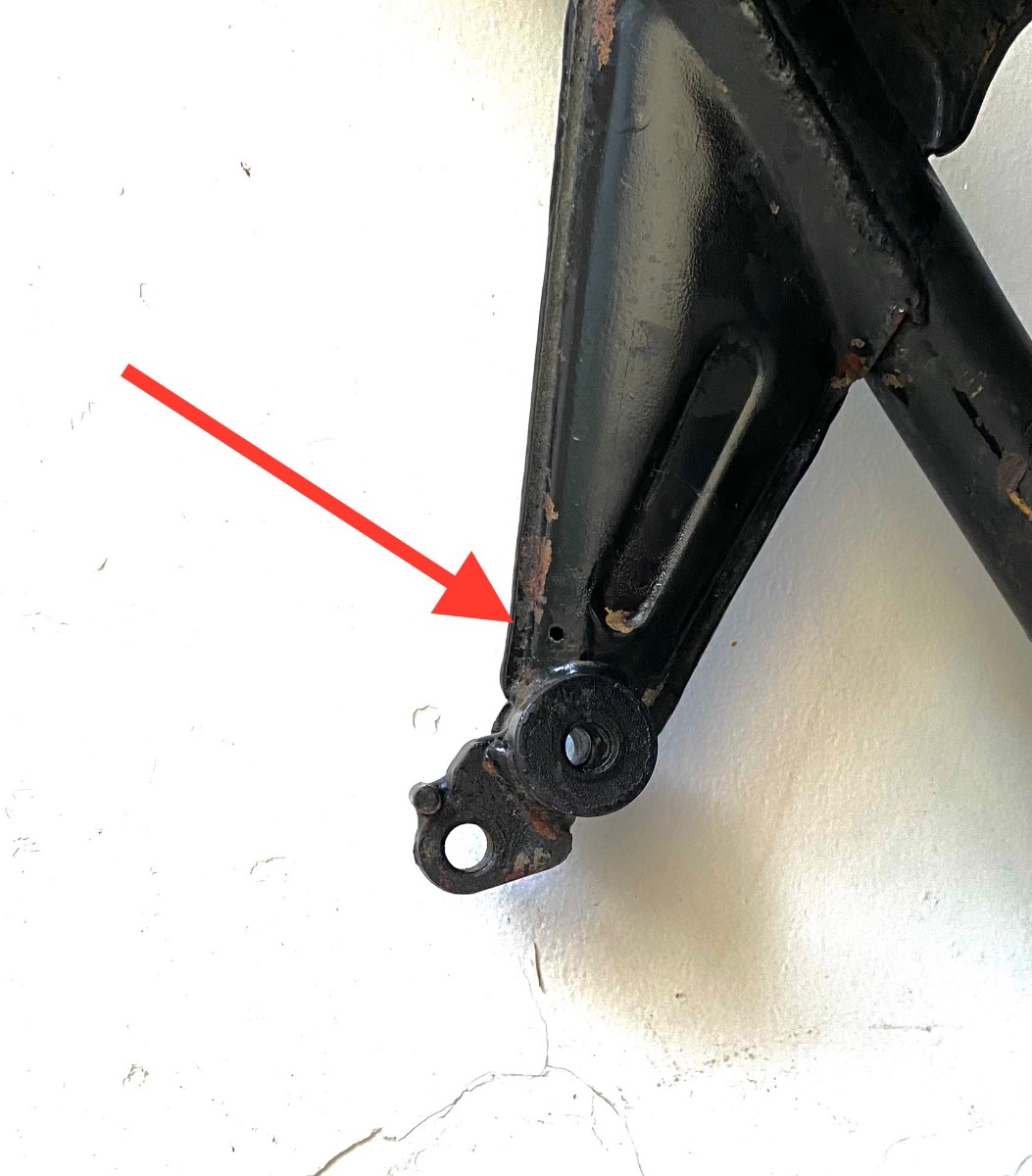

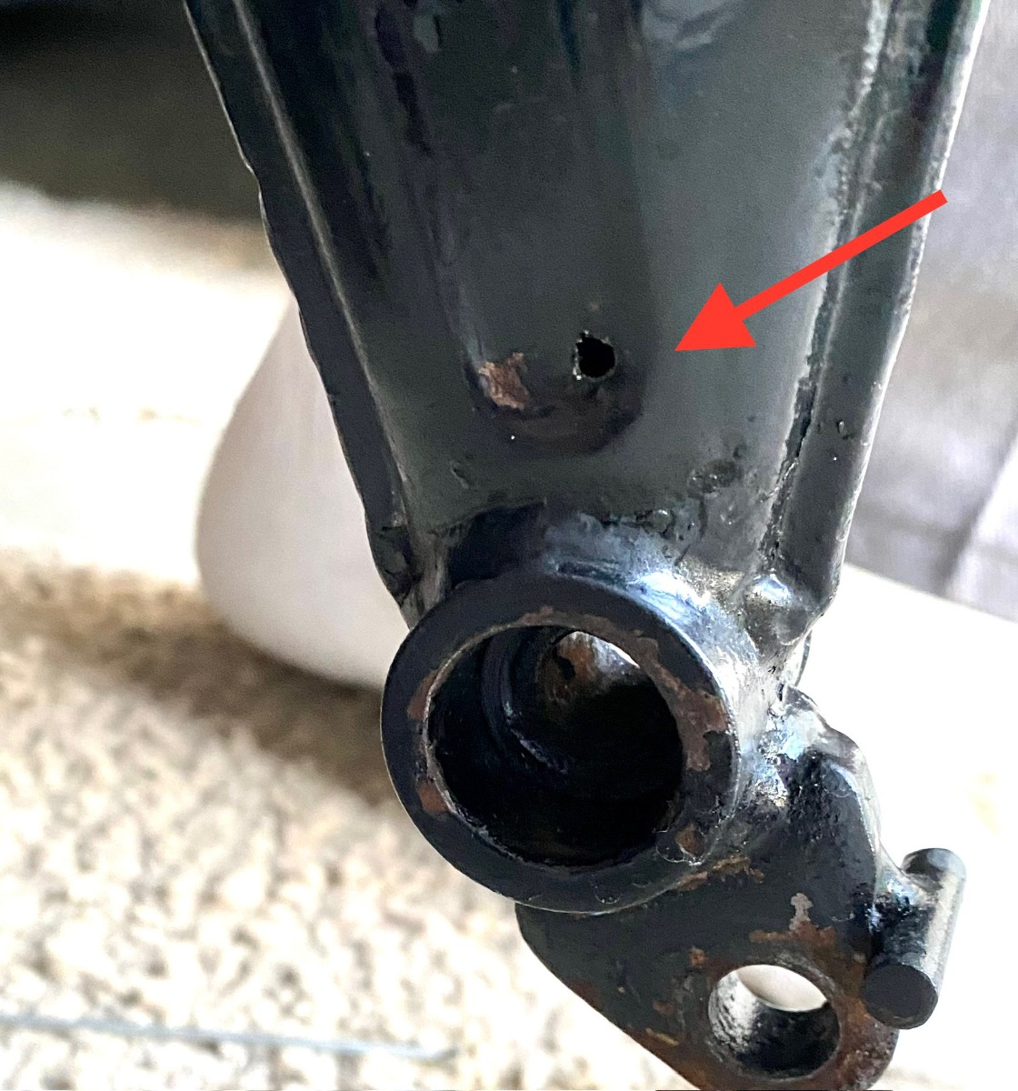

Gave the bare frame a pressure wash to shift most of the dirt and grime. I was surprised than very little paint was pushed off, adhesion being better than I thought.
Next step is the tedium of scuffing and cleaning with water, dish detergent, and an industrial Scotch Brite pad.
The red arrows in the photos point to what I think are drain/vent holes for the brackets welded to the frame tubes, where the rear foot pegs hang. When the pressure washer stream was directed where the bracket is attached to the frame, a good stream of dirt and water came out of these hole. And I did the reverse flow too.
I can't see any other vents or drains, but perhaps some members might direct me to anything I've overlooked. Thanks.

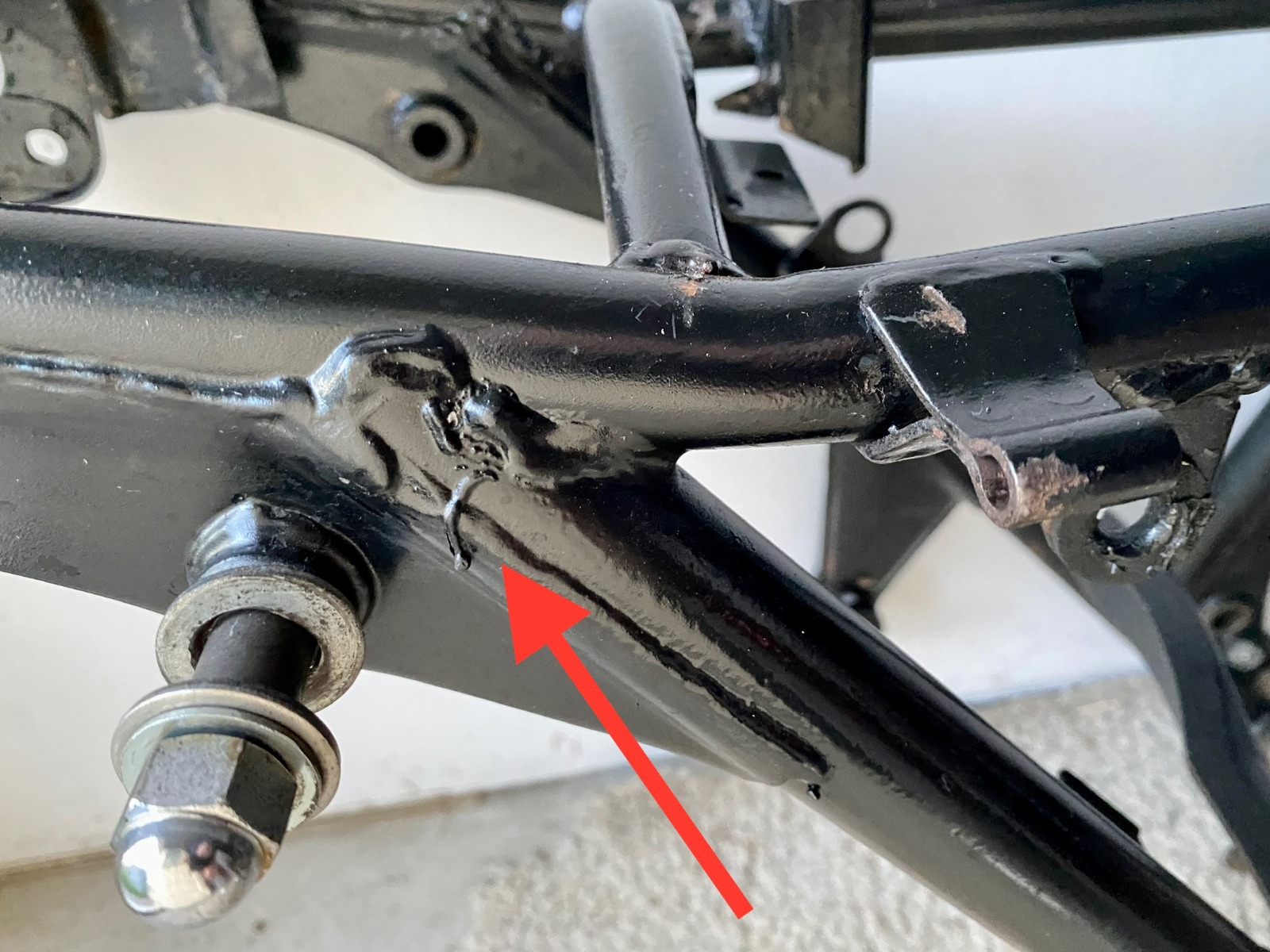

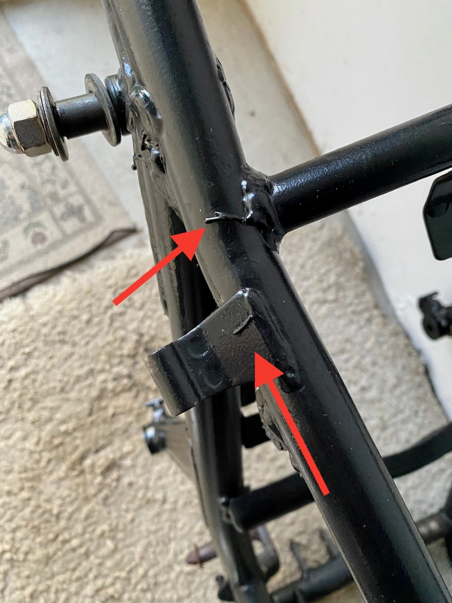

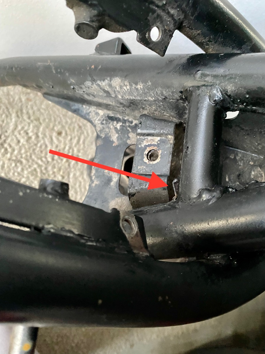

Also, a close look at the frame around the welds, after pressure washing, it looks like remnants of the MIG wire are present. I snagged them with pliers and the just broke off with a twist.
I suppose these frames pre-date robotic welds, and the human was a bit lazy about removing these whiskers. But you can't blame him, they only got noticed 55 years later!!
