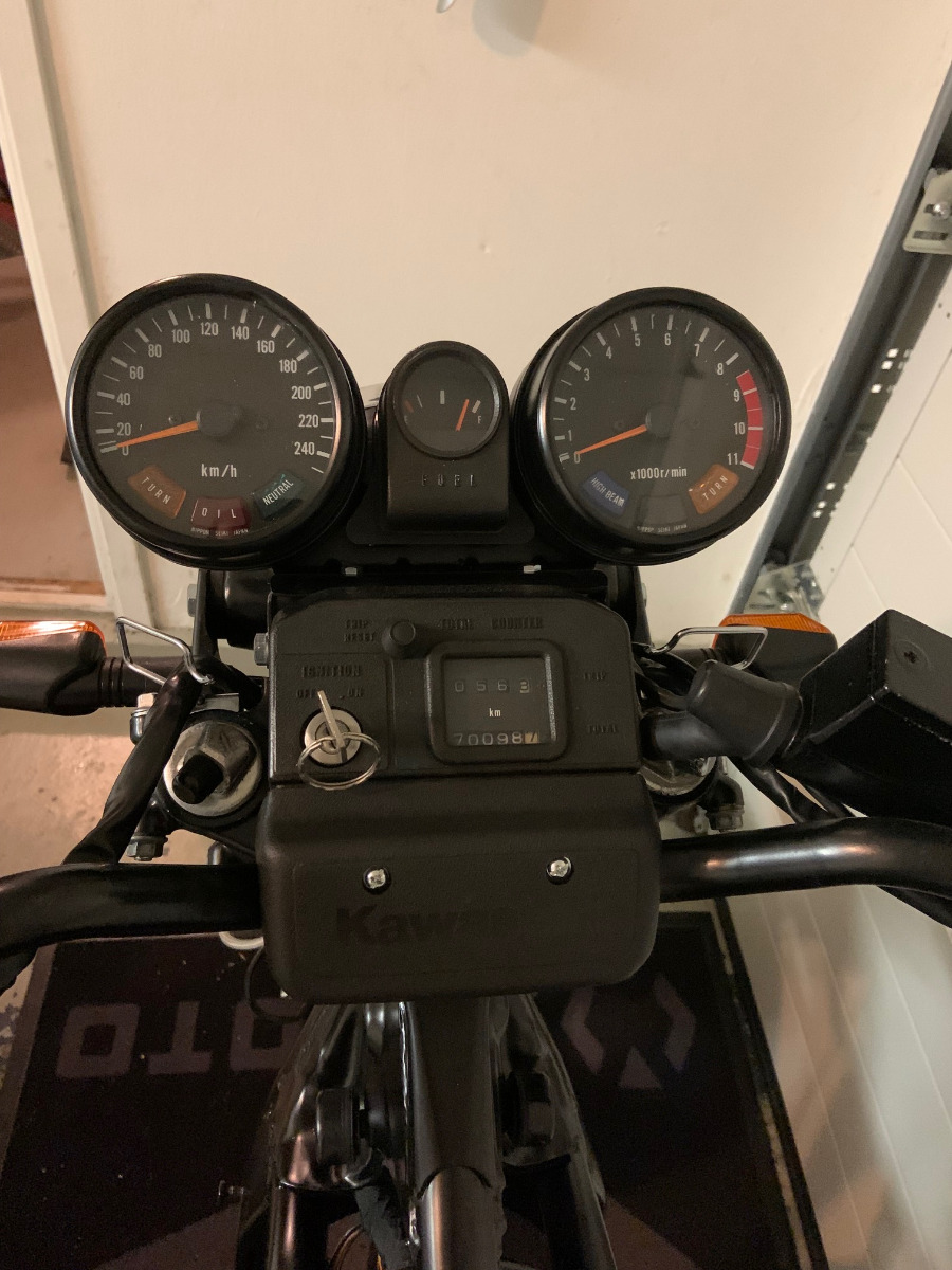

Its been a while since last update, but there has been some progress! I have sourced some parts from all over the world. A NOS handle cover and new center stand screws is some of the more important items (also some misc fasteners).

Handle cover:

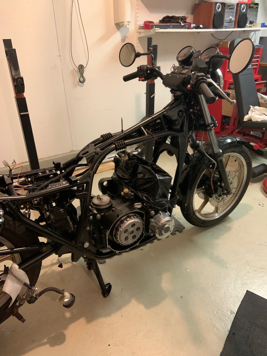

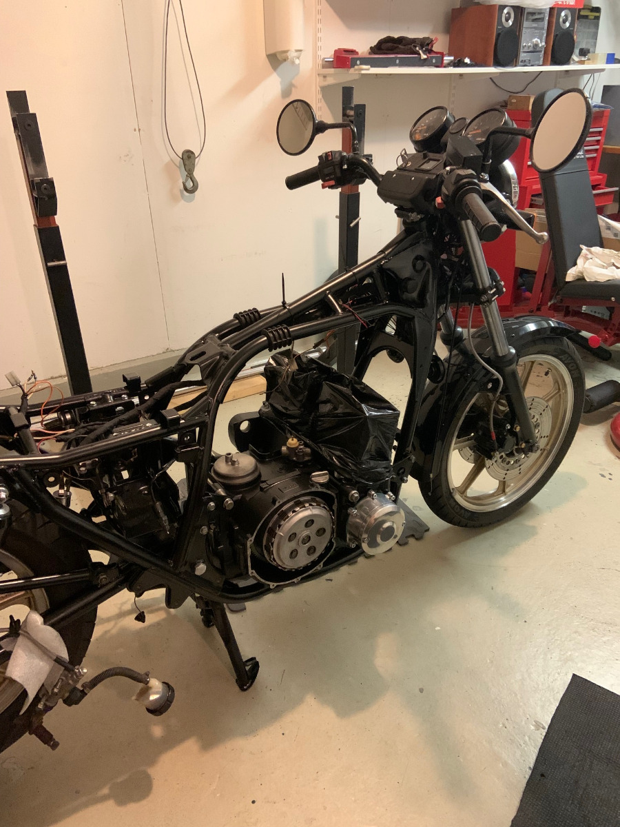

Bike on center stand for the first time since I bought it (convenient):

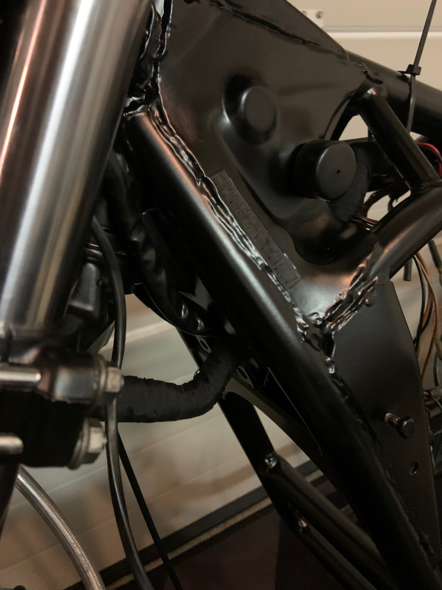

Question: How should the cables be routed through the frame from the head lamp?
Is this correct (everything above the brace): ?

Handle cover:

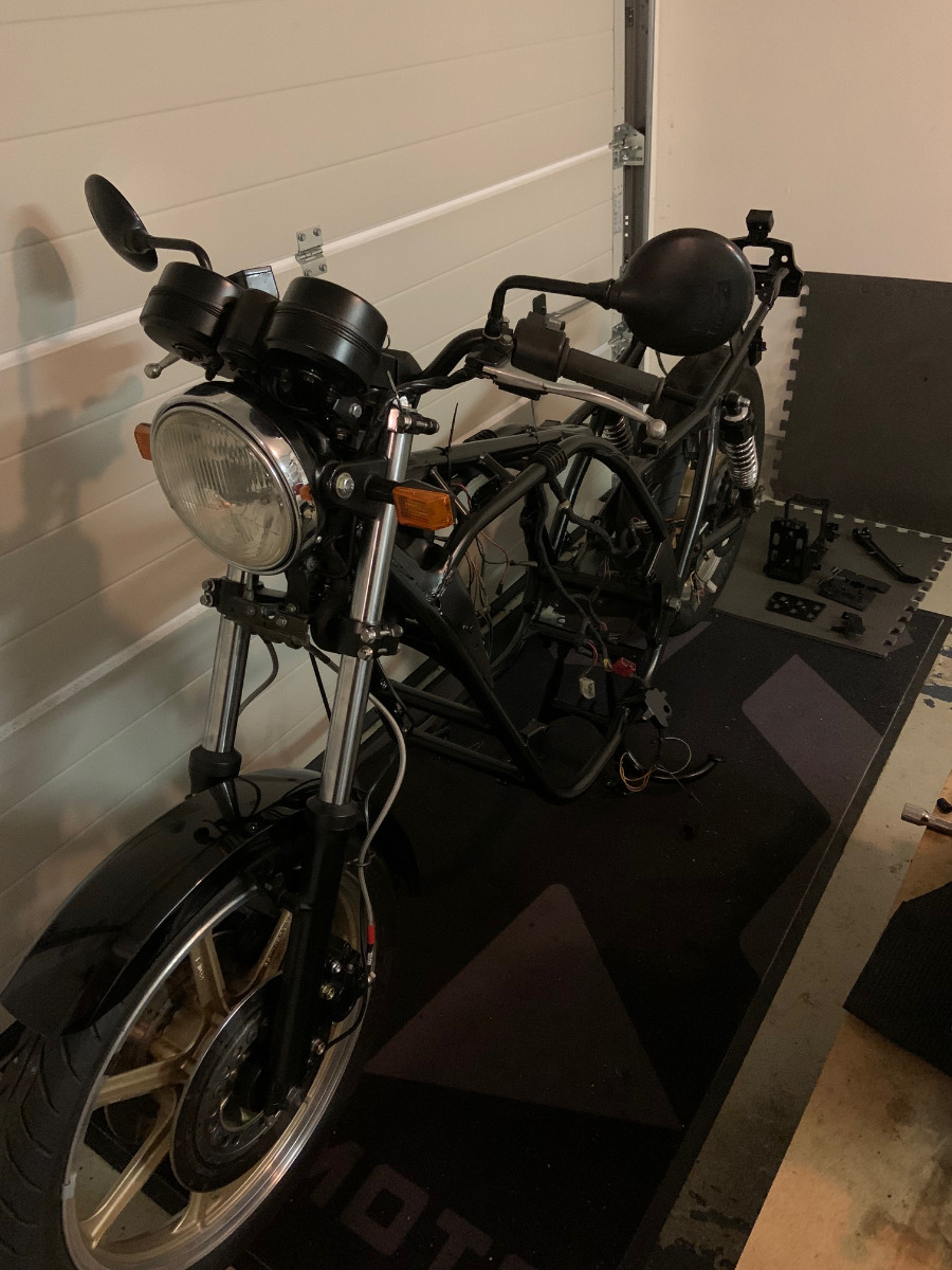

I have since last post replaced the swing arm pivot spindle with a NOS part, that removed all slack and its now ready for some high quality shocks.

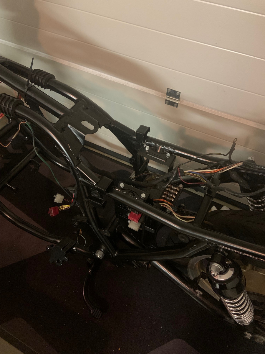

Spent some time cleaning and making the main harness more tidy.

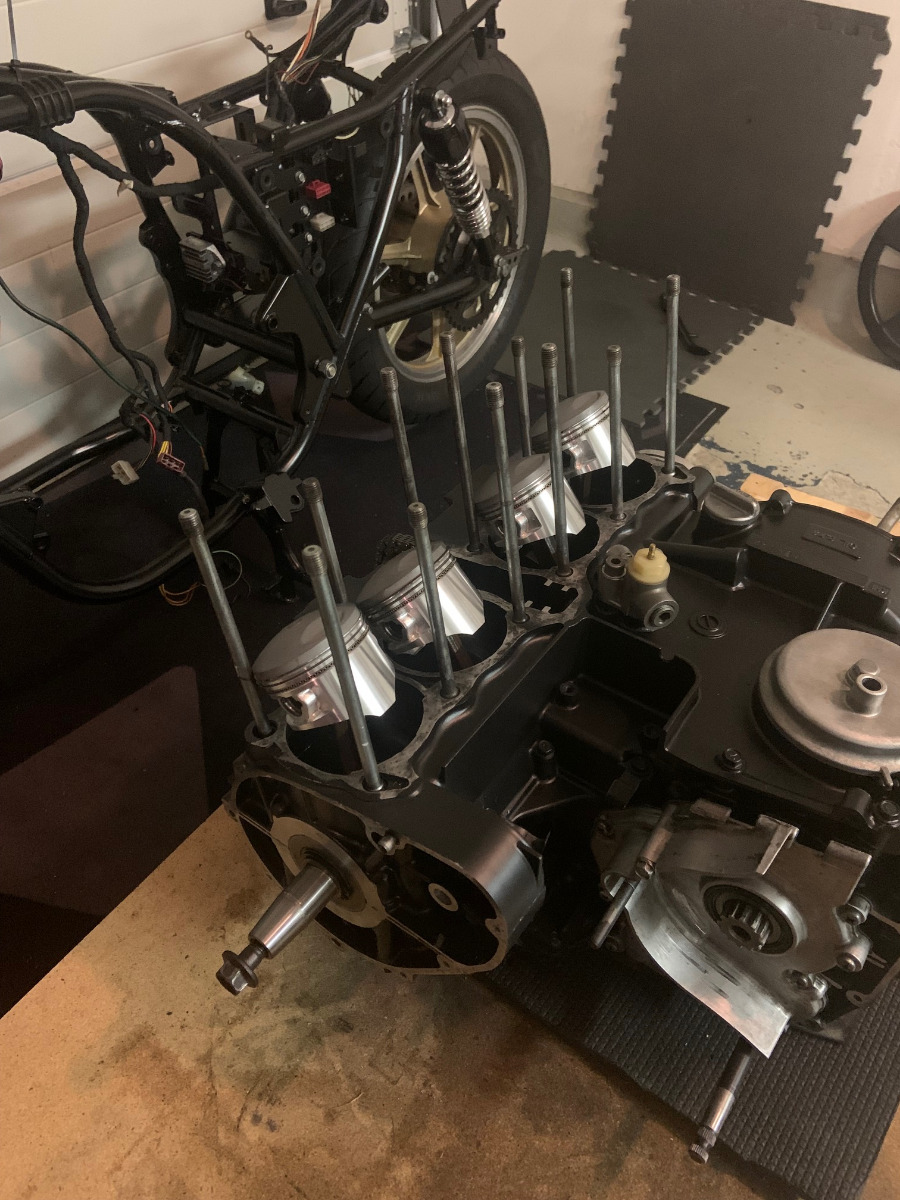

Today I installed the pistons. I thought the circlips was difficult at first, especially when in the engine, but got a hold of it eventually by twisting them in place with fingers only.
Maybe its time for engine into frame after this?
Battery tray intalled with a mix of NOS screws and re-galvanized by me:

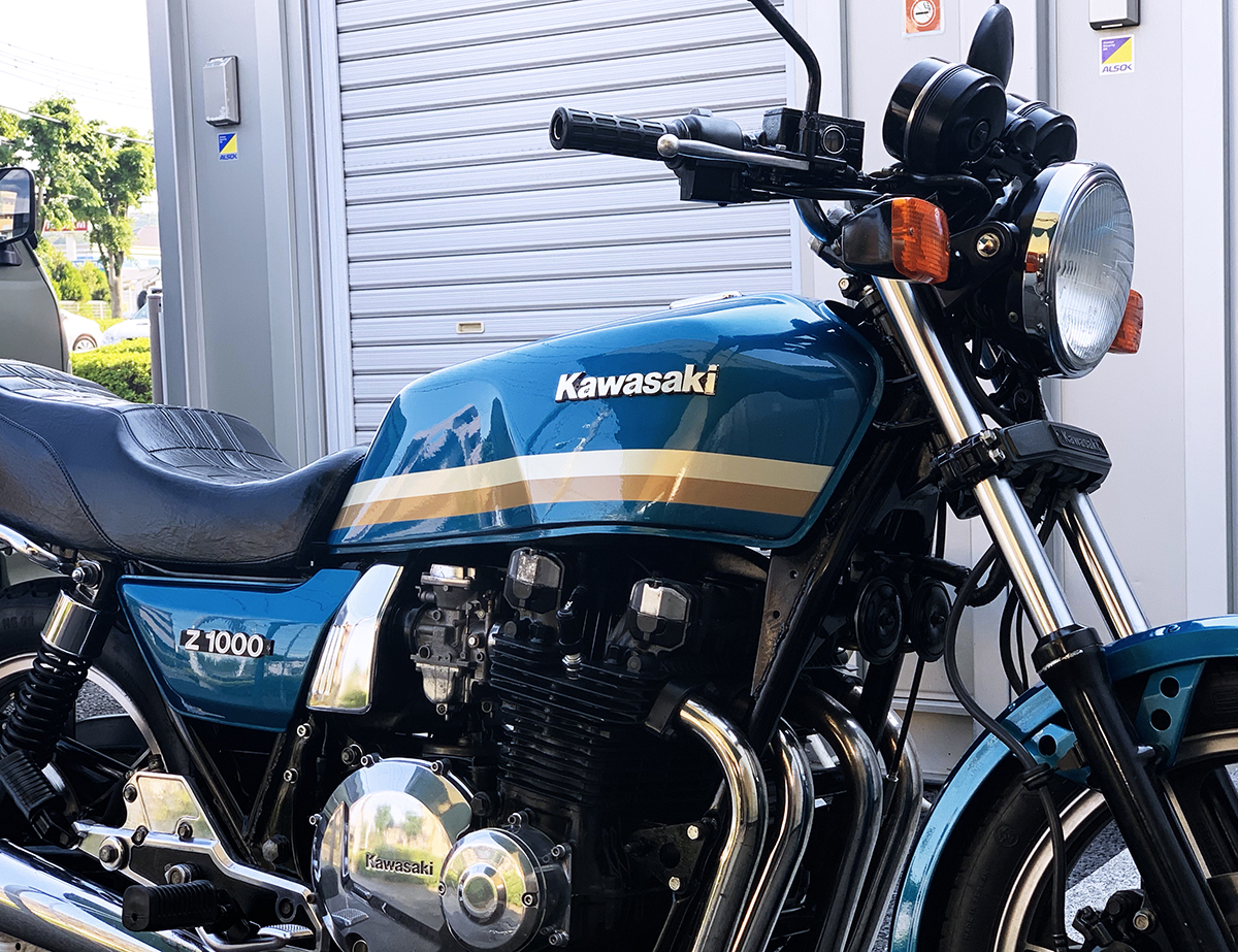

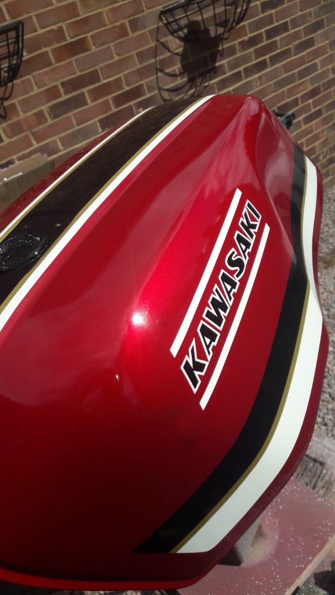

I googled around looking for different paint jobs and found this picture of a blue -J. I really like the color (and the bike), I think it would complement my green Z900 as well:
