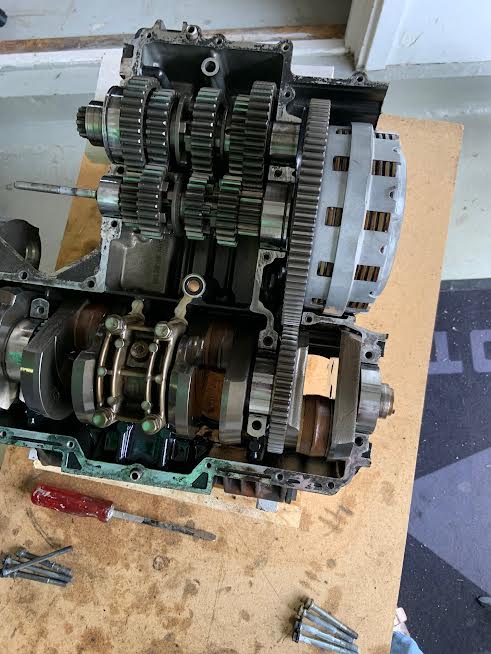

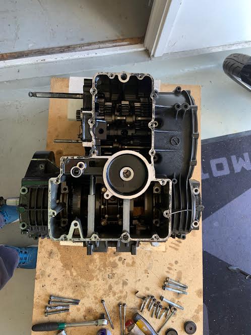

Here is a picture of the lower case if someone can find the holes to split it:
Im a big fan of removing fasteners with the impact wrench, but I dont use it to tighten smaller bolts. I did tighten the alternator bolt with it last time, and that worked and saved me some hassle!
It also says to use the pry points? was the 3 m8 holes removed on J?

Just got it open! Did not take much force with the pry method, im surprised
Next couple of days will be gasket removal (have not come across any magical way of removing them even though I have googled it for days probably) and cleaning of the cases.
Have found a source for a lot of parts in Germany, they have the original Morse camchain, guides etc that I will order. Plan is to get the crank case back together as soon as possible.
