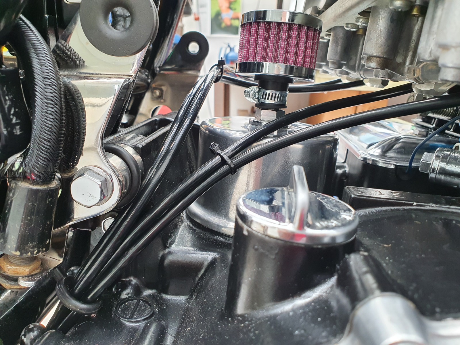

First job today is fit new overflow lines and route them through the original 'cock ring' hanger.
Then bolt on the crank breather. Not sure if I like it better than having a hose ?

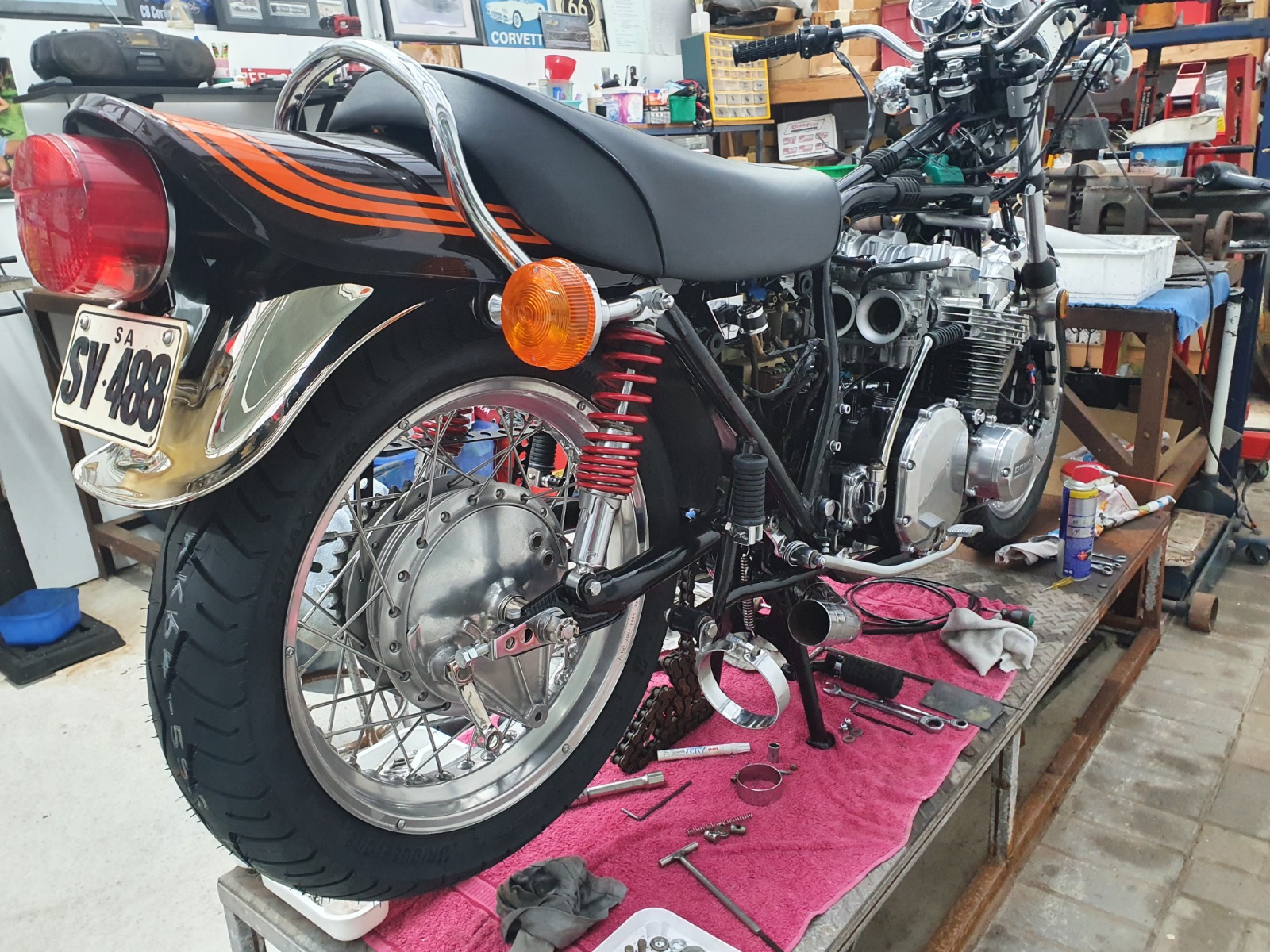

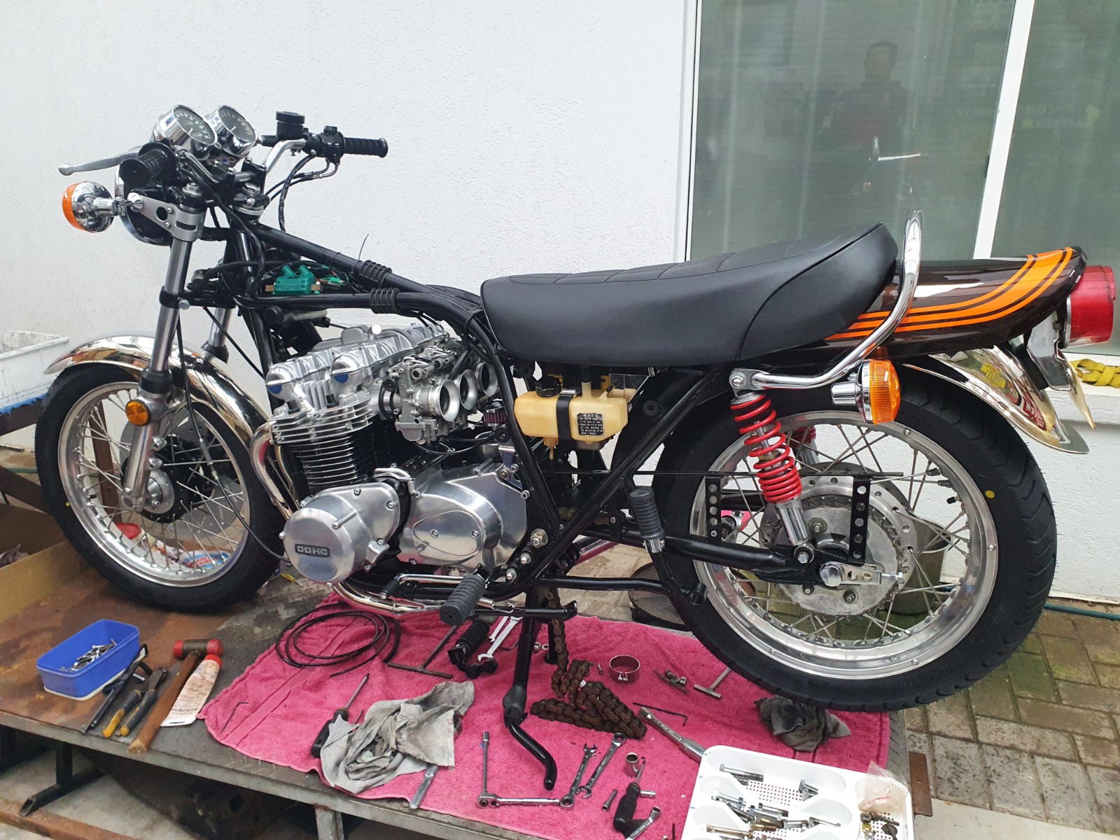

Now for some of the bigger stuff - time to get the new seat out, fit up the hinges, the seat catch and spring. After some minor adjustments it is closing and latching.
Then the ducktail, I fit up the new rubber and fastener set and bolt it on.
While I'm on a roll, its time to roll the rear wheel out. I need to put together the sprocket drive stuff, then the brake hub stuff and mount it all on the hub. Time to slip the axle through and mount the chain adjusters while I'm doing it (my bike has 10 mm adjusters fitted, the original 8 mm ones are in one of the spare boxes of bits).
I managed to get the rear brake pedal into position - geez that big spring can be a bit tricky to mount, before its time to call it a day.

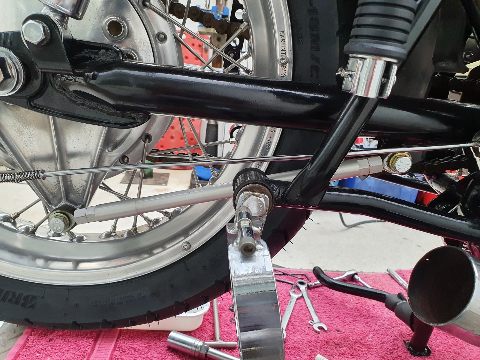

I continue hooking up the rear brake stuff - the brake bar I have is an alloy tube with rod ends on it, I had it made a few years ago and it makes a huge difference to the feel of the rear brakes, zero binding. The brake activation rod goes in as well and the rear brakes are working !

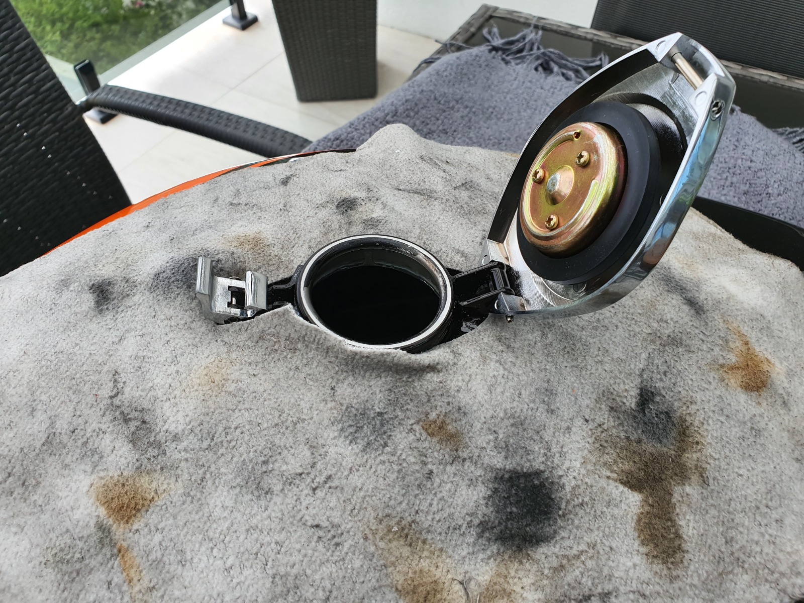

Next job is to get the new tank cap on the new tank. Well what was supposed to be a 10 minute job turned into a 1 hour job
The little latch wouldnt swing back enough for the bar on the cap to get under and be captured. It looked like part of the problem was the paint was too thick, I ended up getting a round file out and working it until the 2 parts would actually click together.

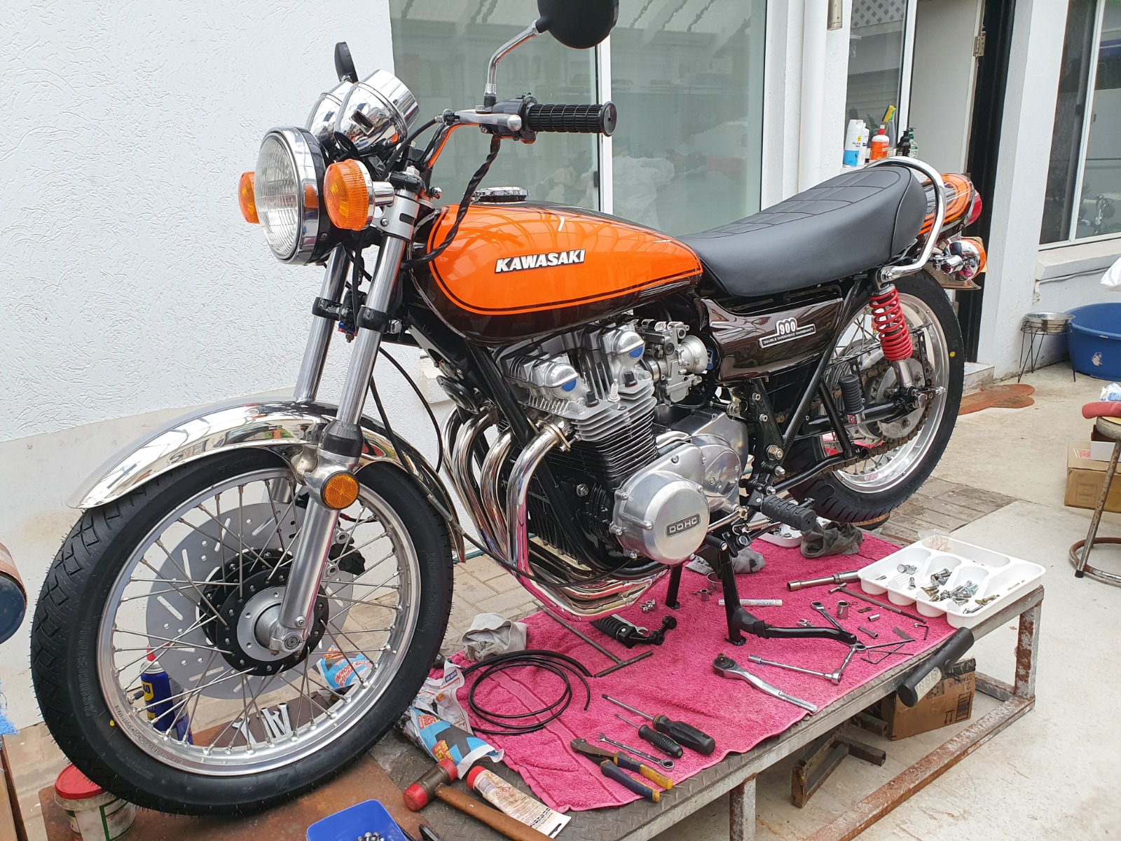

Fitted up the tank and the sidecovers - then got really crazy and put the mirrors on. They will have to come off again but couldnt resist.
There are still a number of jobs to do yet, but definitely starting to look like a complete bike
