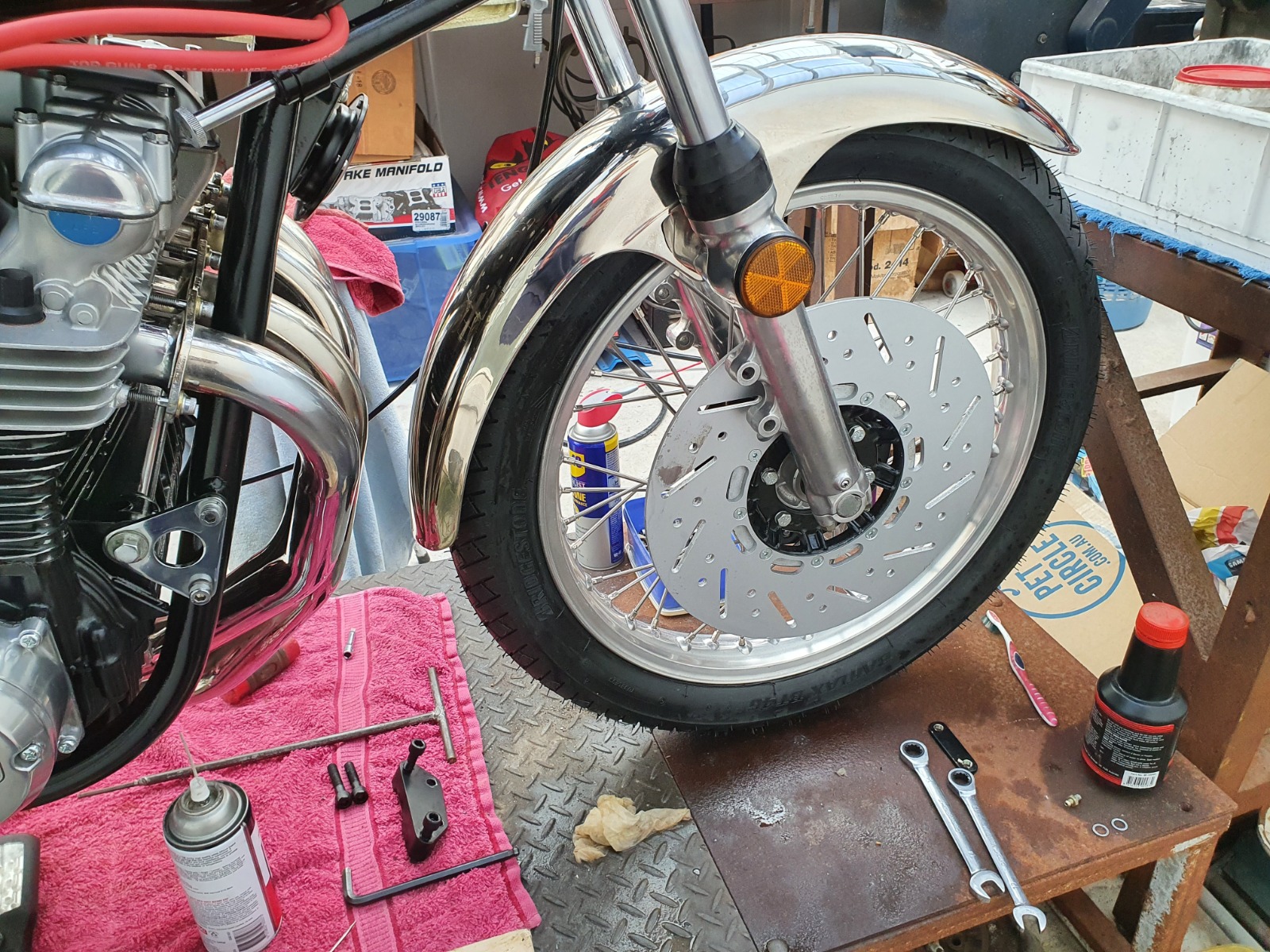

So, to be able to put it on the trailer I really need the front brake to be working so it makes it easier (and safer) to get the bike up and down the ramp.

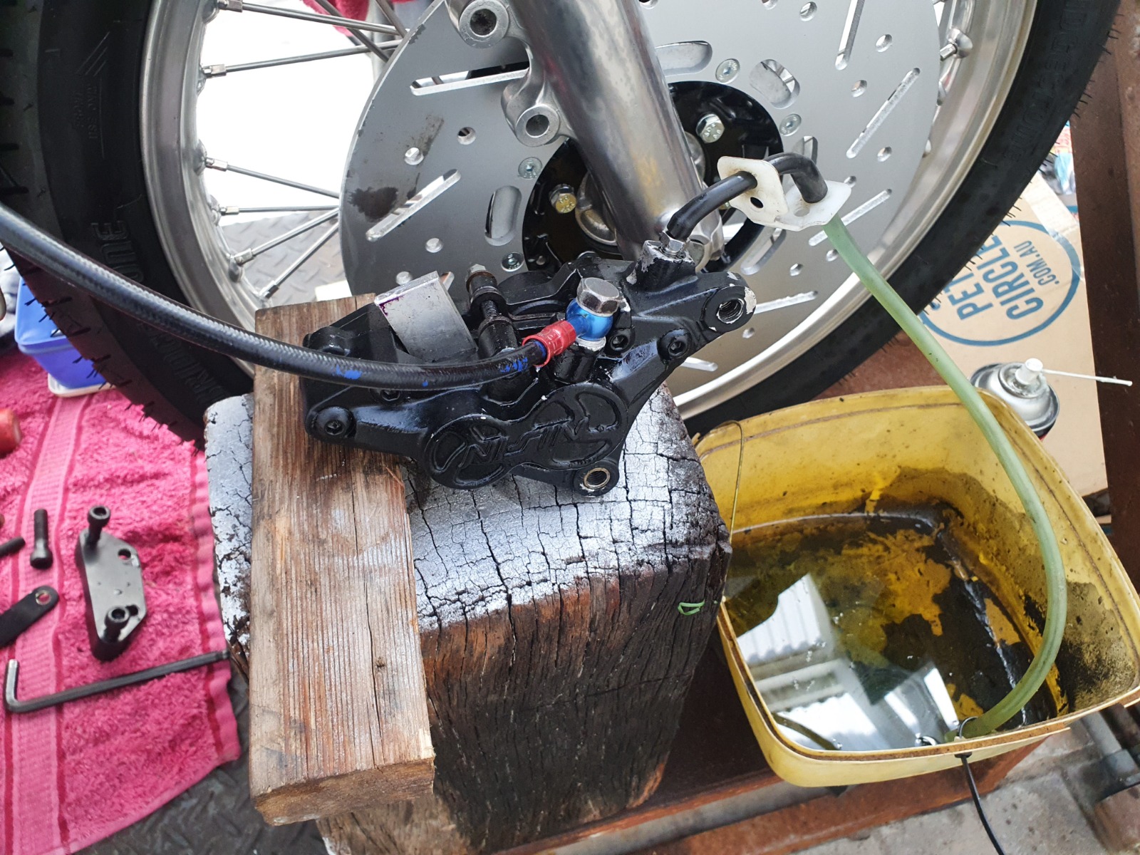

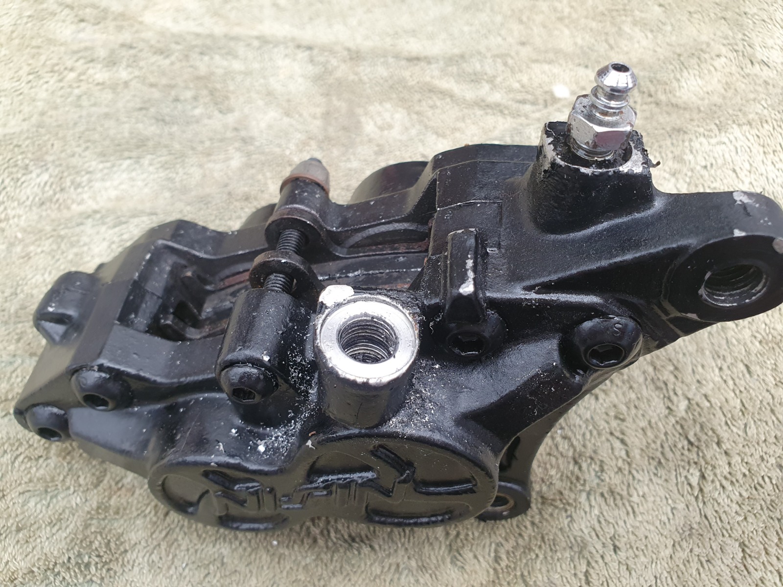

The brakes are all together and its time to add fluid and bleed it. The brake fluid wont come out the bleeder nipple. Soak the nipple to get the gunged up stuff out. Try and bleed again - this time the fluid is flowing out the line fitting by the washer. Try copper washers, still leaking. Try a steel fitting, still leaking. Look further, there is corrosion on the seat.
I have to take the caliper to an engineer I know and bring him coffee and sweet talk him into re cutting the seat by Friday.

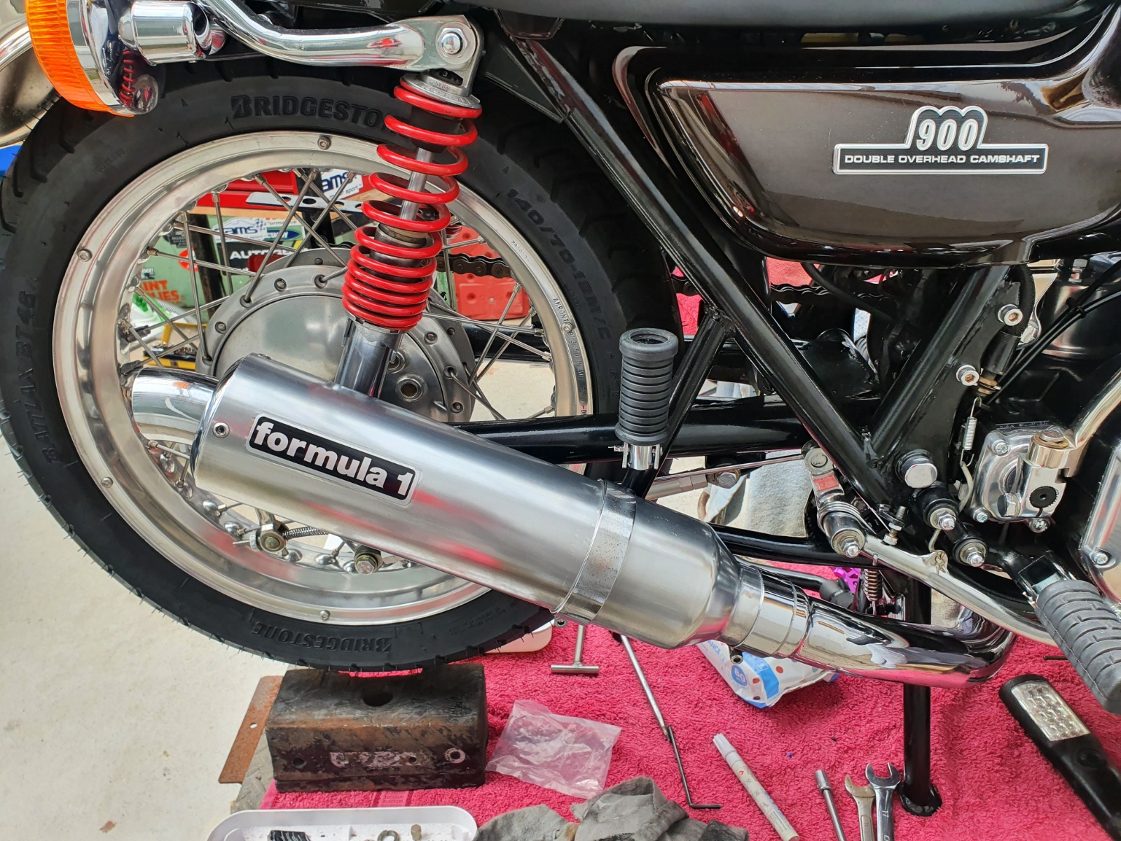

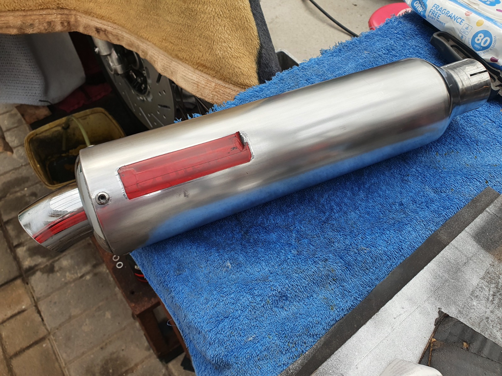

Time to get the muffler on, but first it has to be polished coz its looking a bit sad after all these years of sitting around.
The body of the muffler is alloy so it gets a wet and dry rub first before getting polished.
Now to bolt everything together and sort out the brackets and intermediate pipe. And then give it another polish

Looking good! What do you use to get that kind of (anodized?) finish after polishing?

02 Nov 2022 23:22I use Autosol (made in Germany) on the alloy.Looking good! What do you use to get that kind of (anodized?) finish after polishing?
It probably looks a bit duller as it has chrome on each end of the muffler housing.
You can get a better finish by spending more time wet and drying.

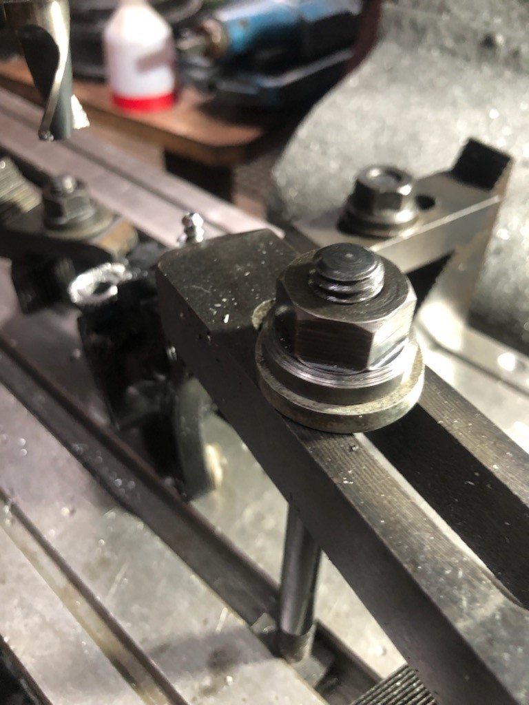

After a couple of days I get the caliper back, Jim put it in the milling machine and re cut the surface where the bolt washer sits.
When I get it home I have to separate the caliper halfs and blow it out.
Because it is a 4 piston I will bleed it on the horizontal first - then bolt it up to the fork leg.
Well that was a lot of time wasted on a leaky caliper bolt !

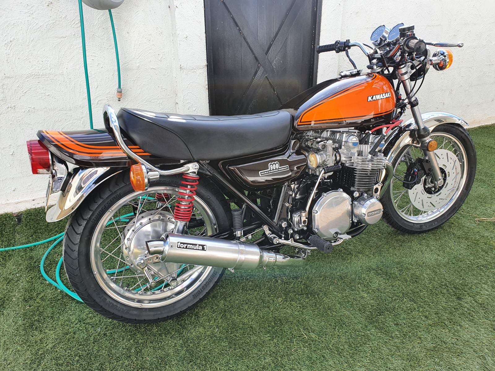

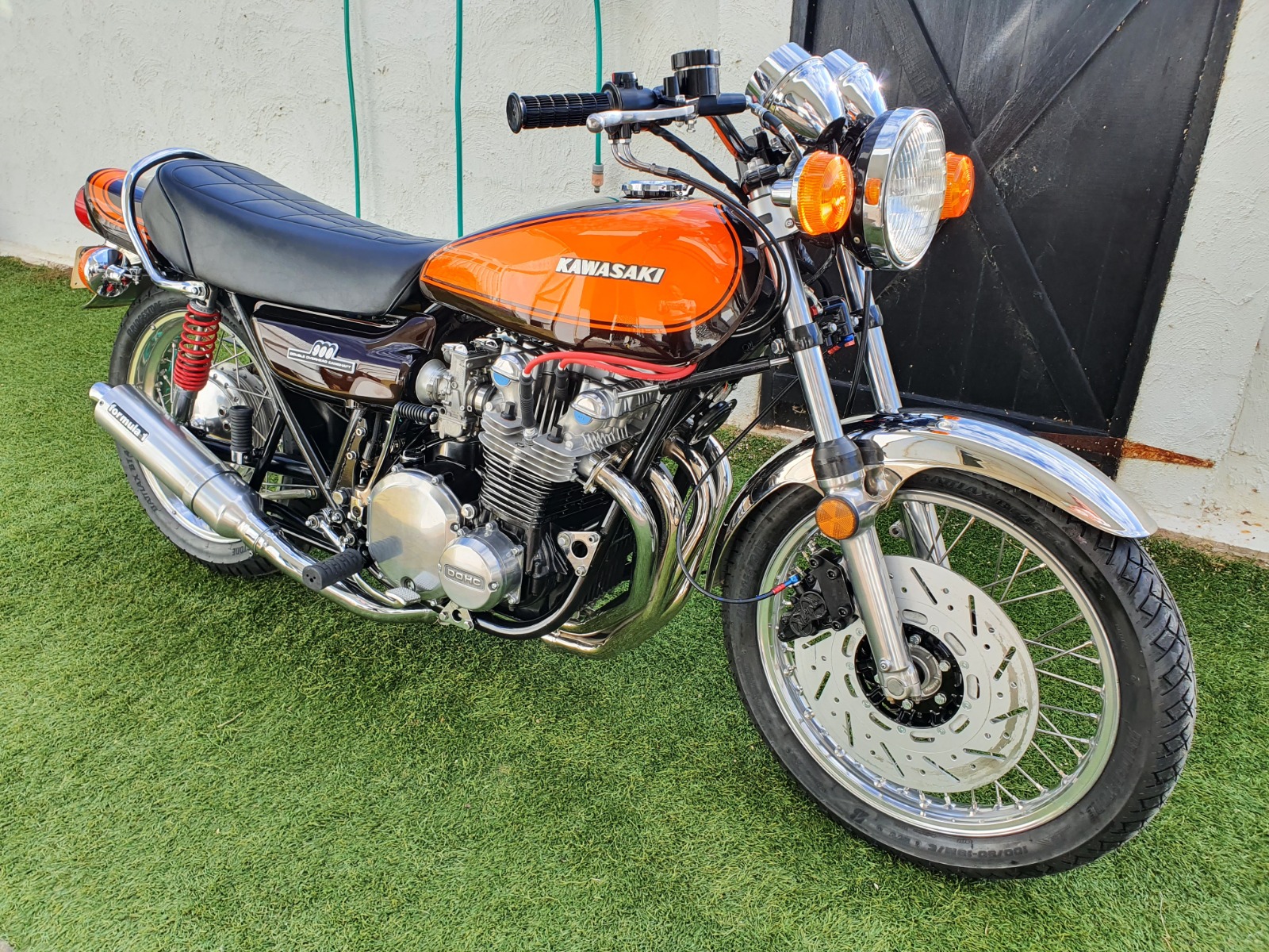

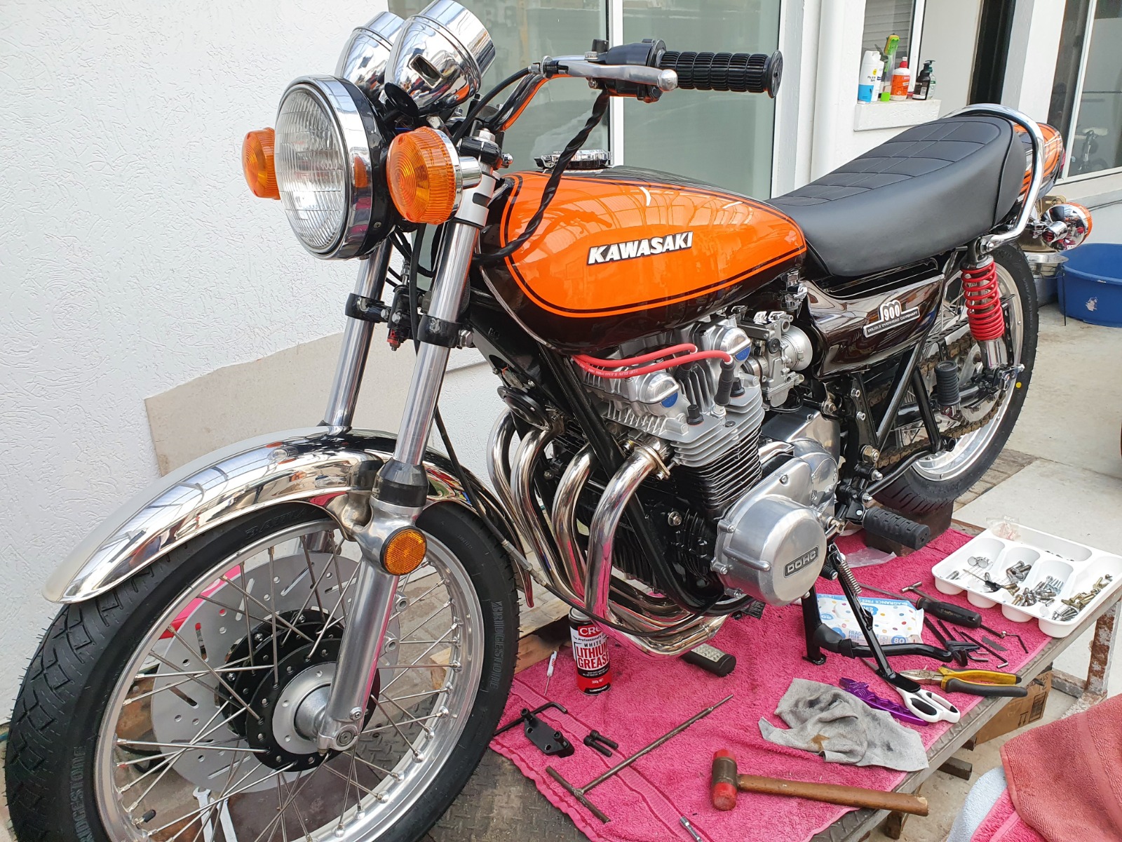

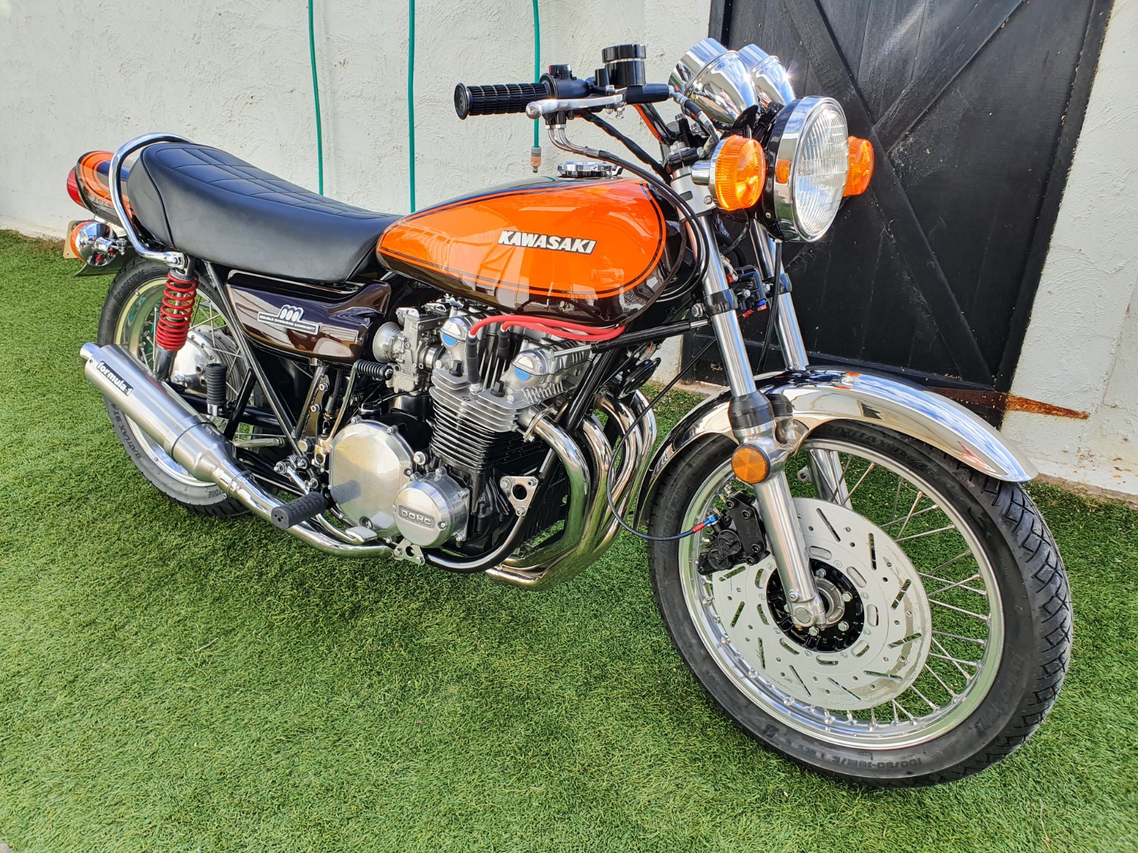

after some more fussing with different things its finally time to get the bike off the work bench.
Time to roll her out into the sun for the first time in over 20 years !

That is one fine looking beast! That oversize front brake should help improve what was one of the Z1 series weaknesses....poor braking.

Stunning bike in double quick time, I hope you are proud of what you have achieved
