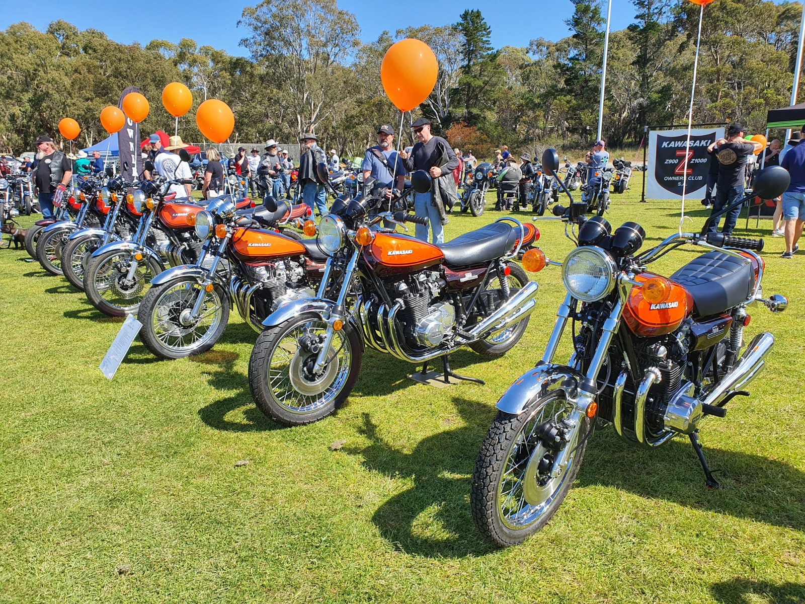

I made it to the Macclesfield bike show, the Z club had pride of place for the 50th anniversary display.
8 Jaffa's were central and about 50 Z's of different years and models around.
It was a pretty big turnout this year - easily over 1000 bikes covered the whole oval.

Congrats on your hard work!
Great to see such a turnout as well, what a great collection of zeds!

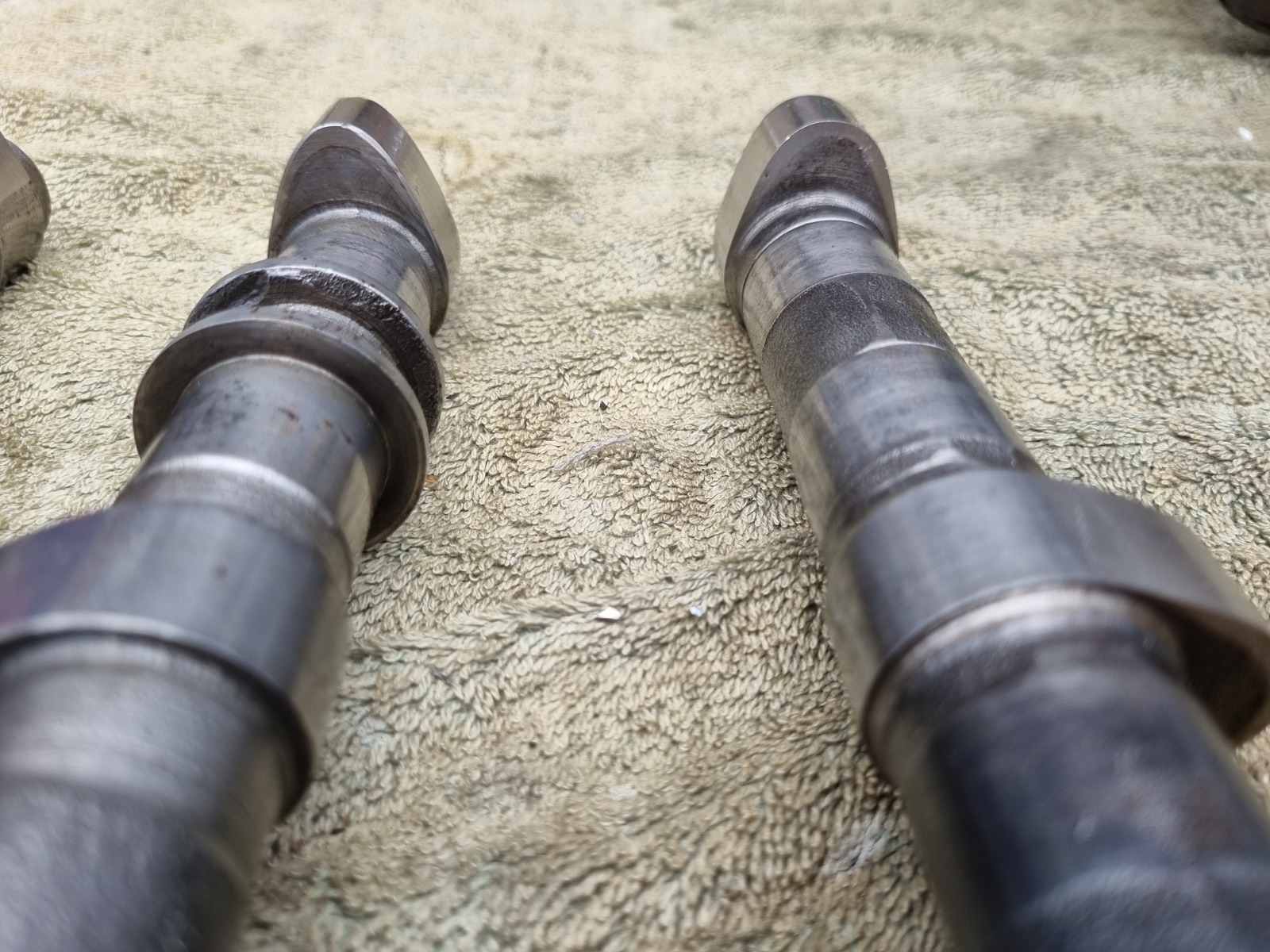

I got out the box with 2 sets of camshafts (both high lift) and was comparing - the set I dont use has got some serious duration !

Wow, those are some serious lobes. In the picture it looks like they barely clear to carrier by the gasket surface
definitely some "lumpy sticks"

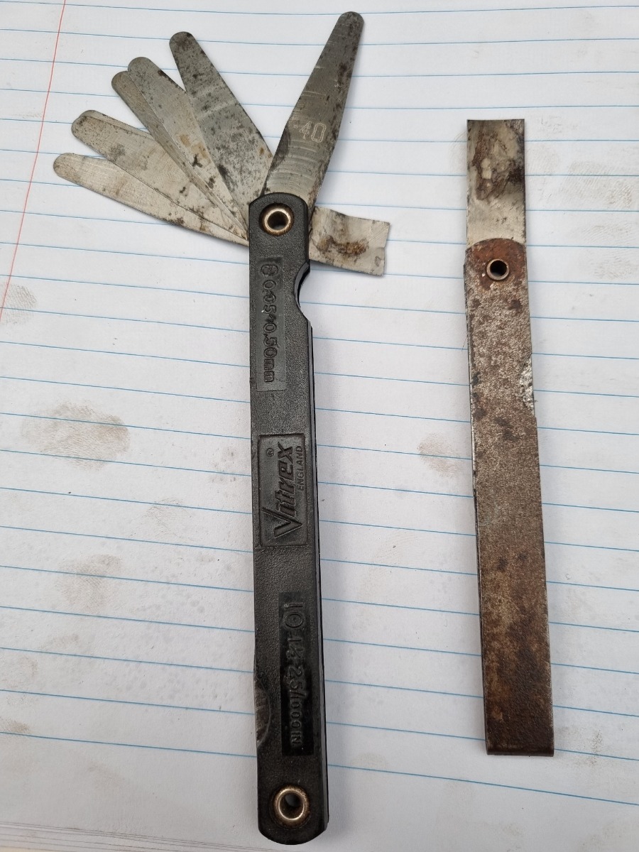

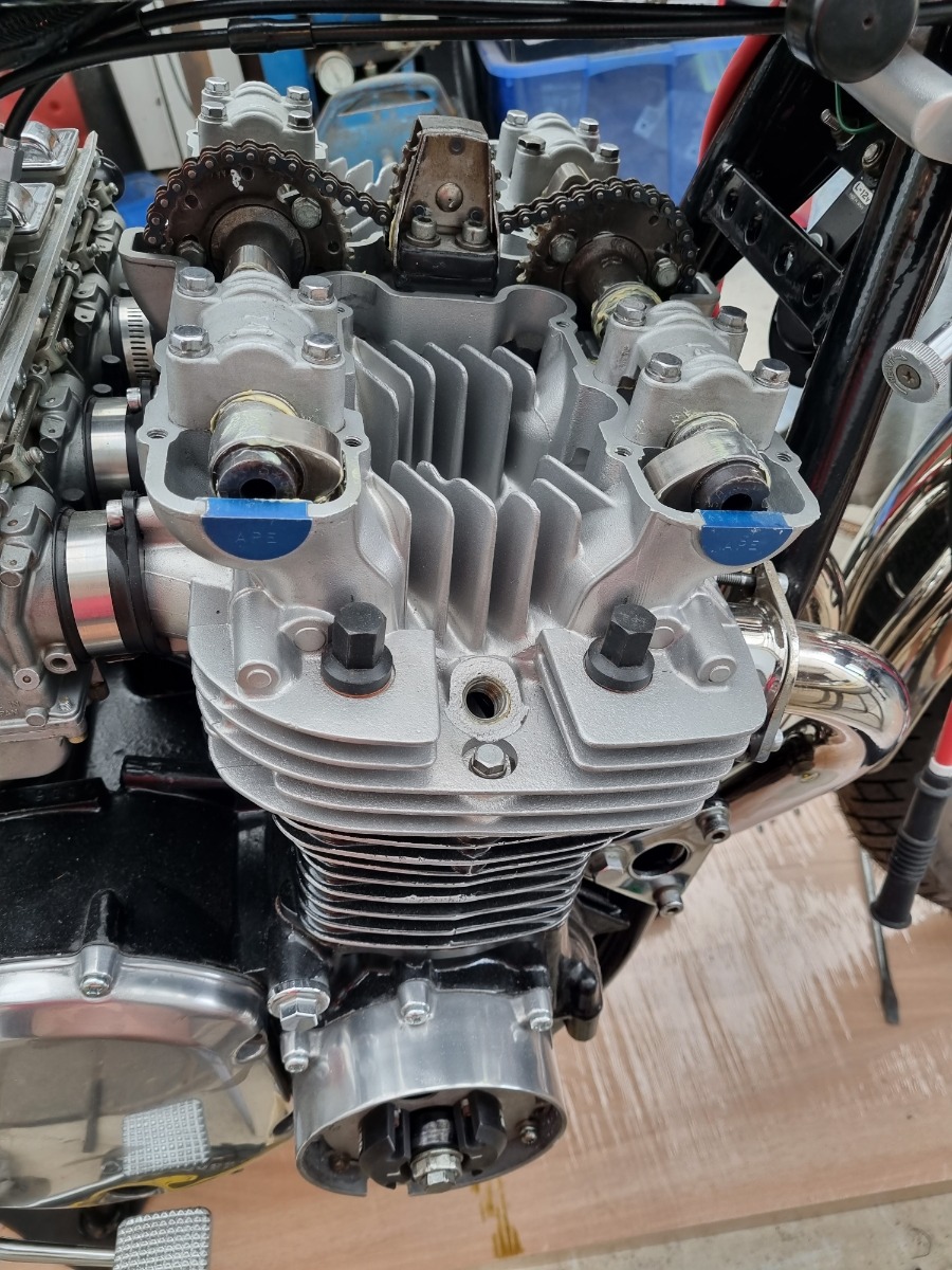

I think I was celebrating the cams going in just a little too early, 3 days later and Im still trying to get the shims done !
The cams have been in and out many times trying to get the shims sorted, 5 of the valves have no clearance so its just turned into a nightmare using the Kawasaki tool because you cant get the tight shims out. At first I was having to pull the cams out but that just got ridiculous. I needed sizes that I dont have in the shim box so had to go to the K dealer to get some more.
Having old broken feeler gauges didnt help so I had to buy a new set.

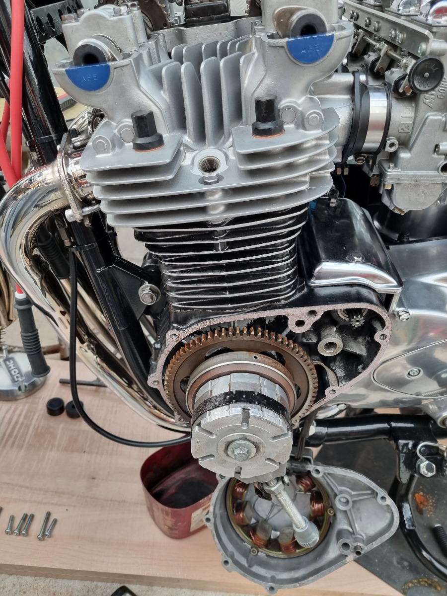

I am going to give up on the Kawasaki tool and get one of those crescent shaped tools, at least you can then use the bucket notch to get the shim out. I ended up putting an oil filter remover on the dynamo so I could rotate the engine backwards and forwards easier.
this week has been one step forward and 4 steps back !

Remember if the head has been rebuilt the gaps will close up as the valves settle. Last resort there is a spec in the manual to "top" the valve stems if you can't get enough gap with shims (is a last resort though as it would mean stripping the head again)
