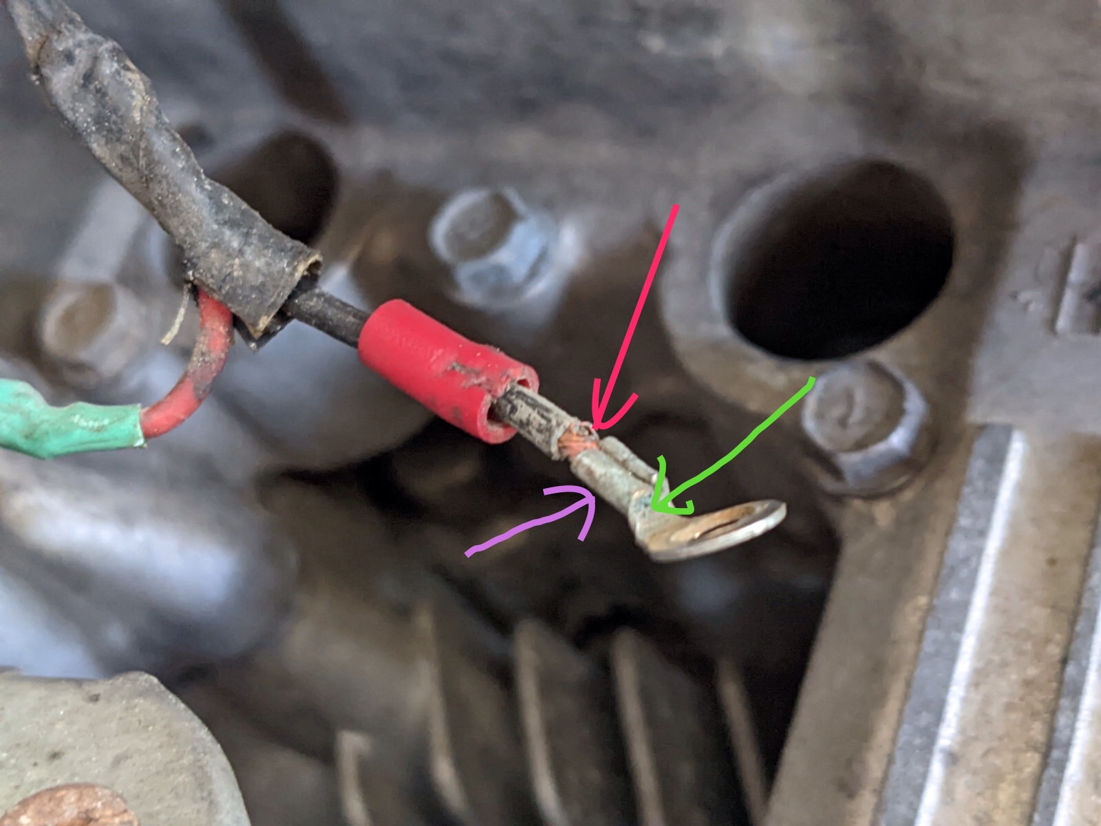

figure if Honda is cool with shipping soldered crimps out to customers, it must be ok as long as it's done right.
that is exactly it, soldering if often not done correctly ( people melt the solder with the iron onto the joint which simply "sticks it on top" )
The correct way is to heat the crimp connector from underneath with your iron (purple arrow) then dab the solder onto the end of the cable (green arrow) if it is hot enough the solder will be drawn into the joint. This is where you can have the issue Mikaw mentioned, if you over do the solder or keep the heat on too long the solder will be drawn up the cable by capillary action and you will end up with a rigid cable at the entrance to the connector (red arrow) this will then become a potential point of failure due to vibration.
Soldering is like everything else, it's got to be done right to work correctly

Would a potential alternative to soldering it be some sort of potting, or marine-grade heatshrink? I've got soldering skills, just curious on behalf of those who may not.

14 May 2022 07:10 - 14 May 2022 10:47This makes perfect sense. Not understanding the actual consequences or where the damage would occur. This clears it up. It’s not the connection from terminal to wire that’s in peril. It’s the potential of the wire strands to crack by loss of flexibility. Thank you.figure if Honda is cool with shipping soldered crimps out to customers, it must be ok as long as it's done right.

14 May 2022 11:02Ghostdive ultimately you are trying to prevent air/moisture getting between the cable and connector. Soldering is the "gold standard" for longevity but good heatshrink will do a pretty good job ( you could put a dab of silicone on the exposed cable end that heatshrink won't cover to seal it up)Would a potential alternative to soldering it be some sort of potting, or marine-grade heatshrink? I've got soldering skills, just curious on behalf of those who may not.
