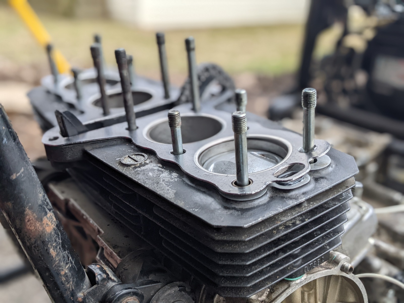

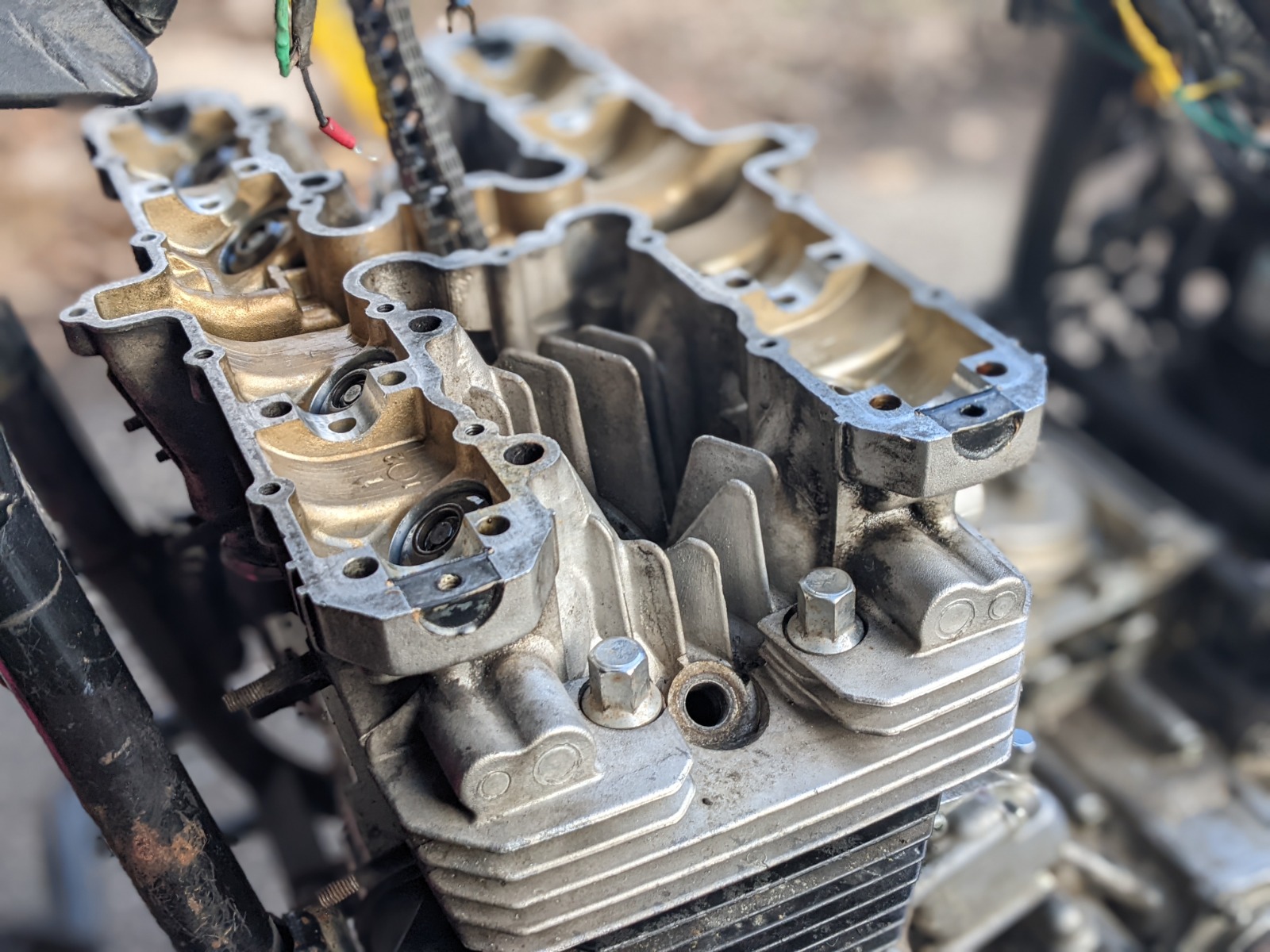

Blitzed the head after work and managed to install the valves, torque down the head, and set clearances within 3 hours. Got too chilly before valve cover went on but I'm pretty pleased. I can't use the words I want to use, but I had a tough time removing the old upper chain guide - probably the hardest part of today.

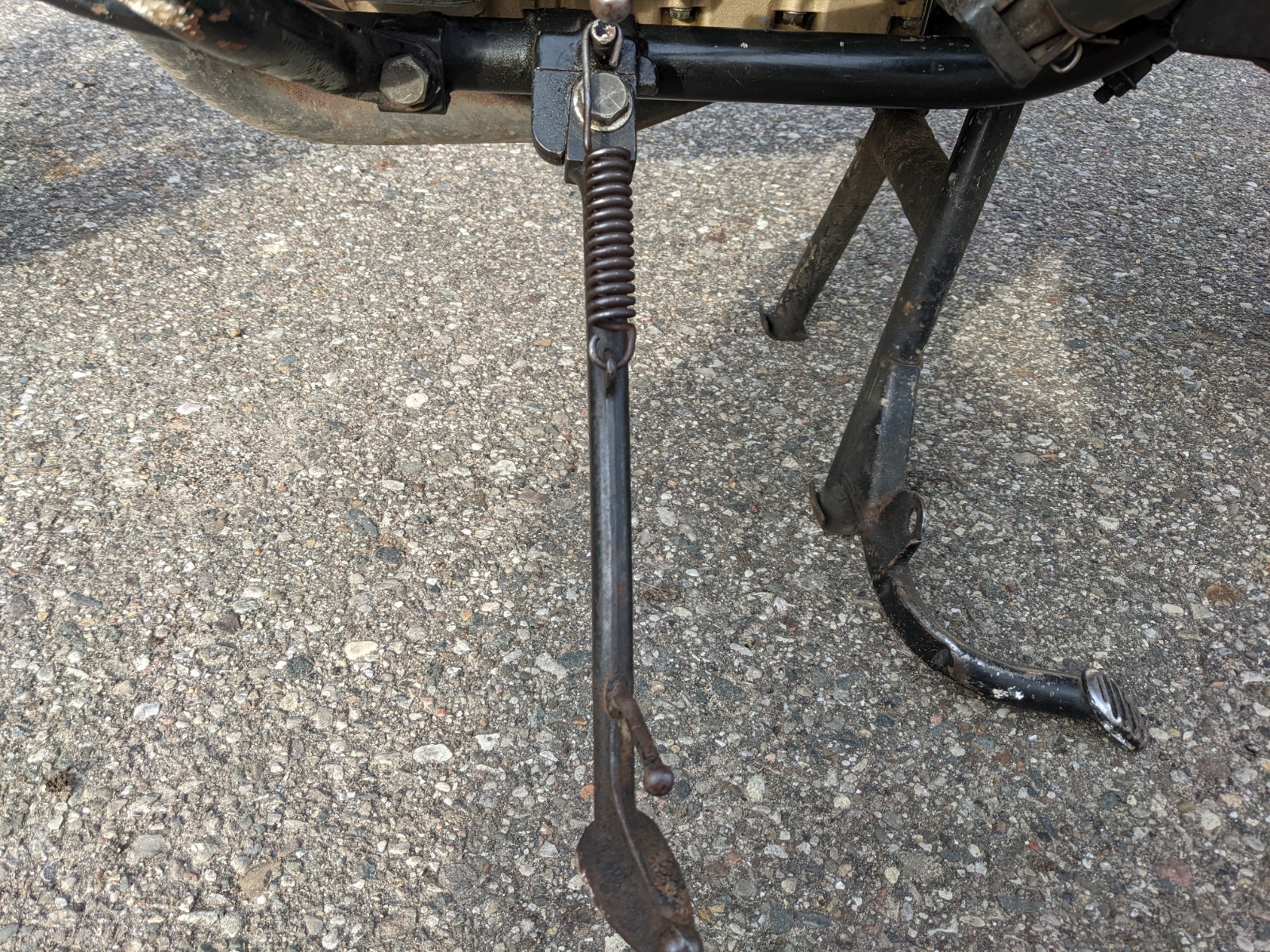

60 miles now after today, feeling pretty good. Exhaust leaks taken care of and timing adjusted; after I dismounted at home I heard a crash and saw a familiar scene behind me. Luckily there's no real damage - just some dirt on the mirror and a scuff on the fairing.
I suppose it's time to modify the kickstand so that it doesn't do this. I knew it would happen someday, but you know how it is.

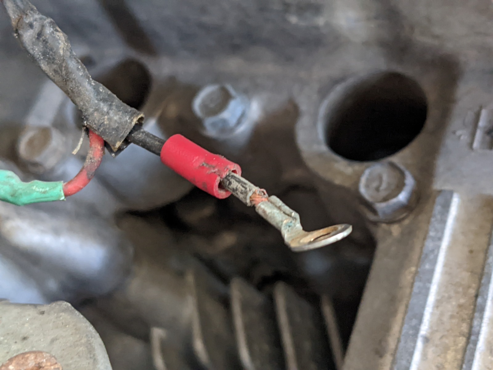

However, I think I found another potential cause - check this out:
Really starting to feel the pain of inexperience from when I first started fixing this bike up! At the time I thought that these huge crimp connectors were my only option. Oh well. Slid the plastic back over, heatshrink applied, same situation on the other side.

Looks like you have corrosion between the cable and the crimp, if there is enough slack cut the cable back to clean copper and replace the crimp but before you shrink wrap, solder the crimped connector. Once the corrosion takes hold the problem will only get worse as the resistance increases

Aah, can't believe that I missed that!! Great eye, thank you...
