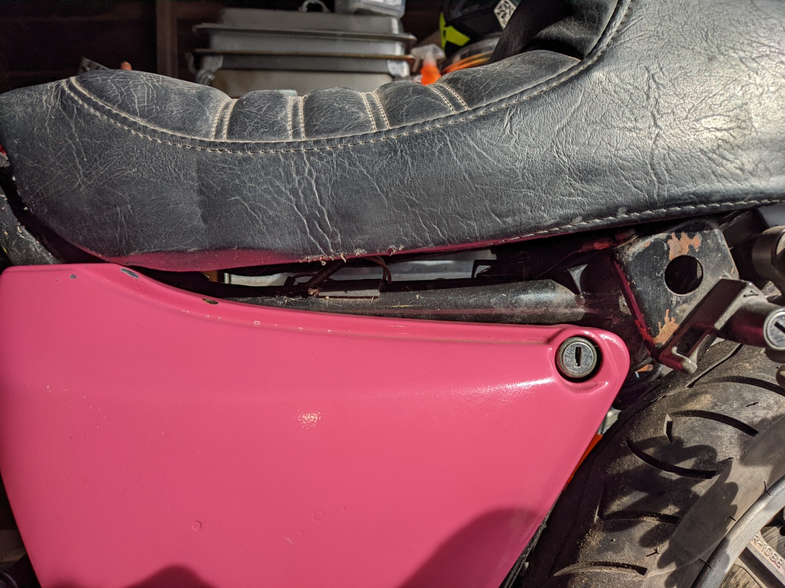

08 Mar 2022 14:35Sorry to hear the seat didn't work out for you, it is after all a seat for a KZ LTD if I were you I would put it on ebay for $125.00 plus shipping and break even on what you paid . It's in good shape and I don't think you would lose money.

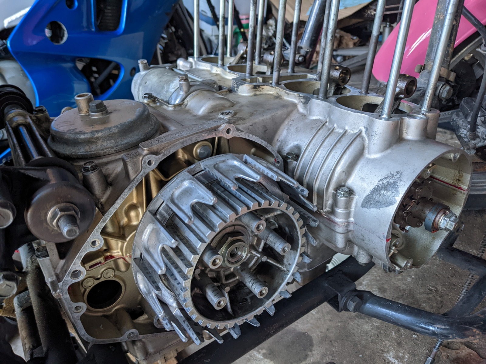

Made a little tangible progress - after spending nearly 5 hours in total scraping with razors I decided to buy a chisel, which made short work of the remaining half of the gasket. Still need to be careful not to gouge, but I've got some woodworking experience. I'm relieved to be done with this part!
Afterwards I torqued down the oil pan and bevel gear unit; clutch isn't torqued yet, I only have red Loctite and I'd like to be kinder to my future self than that.
I bolted awake this morning and immediately remembered that I forgot to torque down the spring-loaded shift drum bolt, so I'm kicking myself for reinstalling the engine into the frame. I get a little excited during this phase of rebuilds.

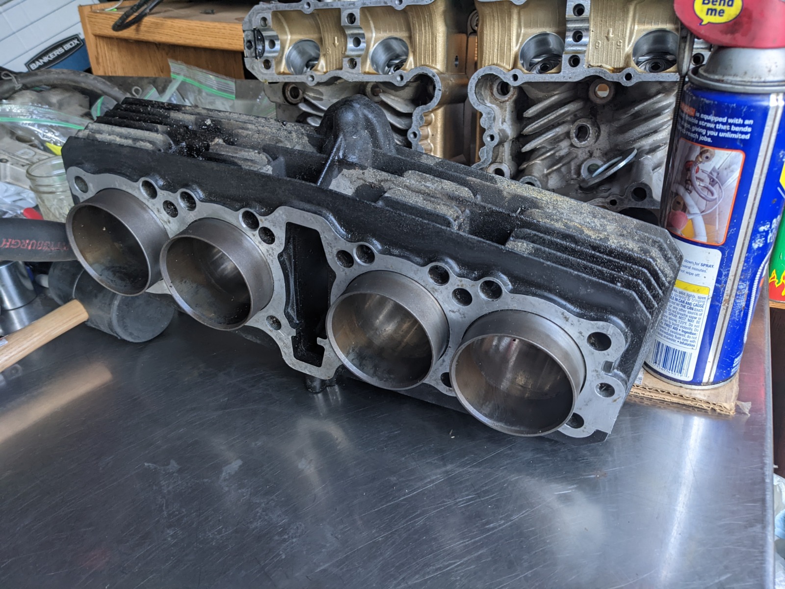

Was just about ready to put the clutch cover on when I discovered that I'm missing the dowel pins. Probably explains some of the past oil leakage...anyway, hoping I can find a part number for that instead of guessing.
Cylinders honed, pistons soaking in carb dip. Shouldn't be too long now.
EDIT: 92042-007 for the pins...I just remembered that I've got a couple that are longer stashed away, so if the measurements check out I'll cut those down instead.

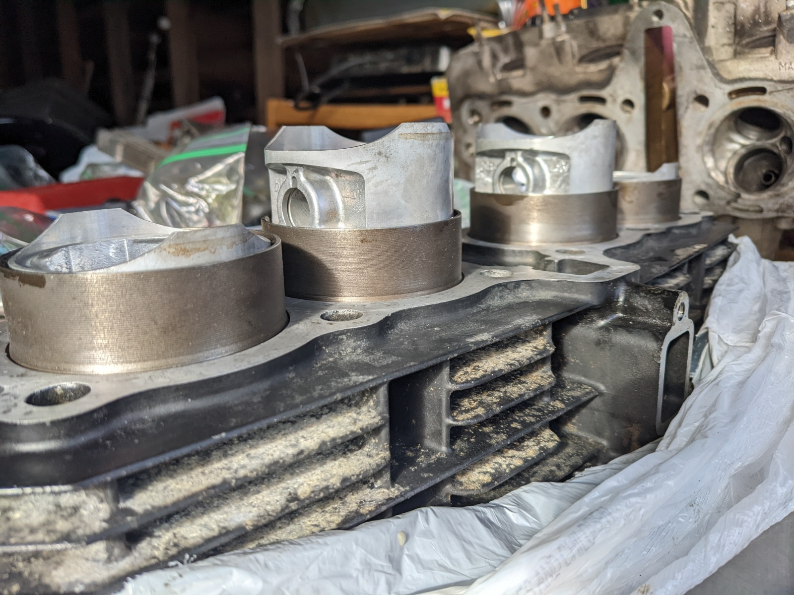

Little bit of progress; my girlfriend helped clean up the head, and I'm halfway done lapping the valves. I have the cylinders honed now, and the pistons nice and clean from soaking in carb dip.
As I was about to put the new rings on, I noticed something strange - they didn't fit! Turns out my bike has different rings than some other 1982 750-4s. Correct ones ordered, so I suppose I have time for more cleaning. If anyone wants an unused set of Cruzinimage piston rings for the cost of shipping, hit me up.
I was pretty excited to finally get it running again, mainly because I used my Ninja for deliveries last week and my back is on fire. Oh well.

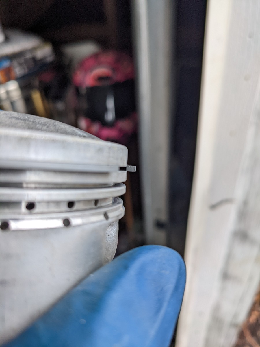

I slacked a lot waiting for the correct rings to arrive, so to make up for that I spent about 3 hours on the bike today. All rings measured .38mm gap on each cylinder, so I'm confident that - barring any possible ovaling, I didn't bother checking - my engine should be just fine. It's got maybe 30k on it by now, so I think much of my poor performance was the very glazed cylinders.
I decided to try this approach to installing it all:
Don't do this. It would be so much easier to just slide the cylinders over the pistons after installing the wrist pins, and even moreso if you have the right tools. Lesson learned I suppose.
I mentioned earlier that I was "definitely" painting the cylinders, but I changed my mind when gas shot up. As previously mentioned, I spend a lot on gas for work, so the KZ would help a lot with that.
I don't feel like looking at a wrench for a month after that debacle, but head work is easy and I'm about to start reviving my late grandfather's GL1000 (now my cousin's), so I'll do my best.
