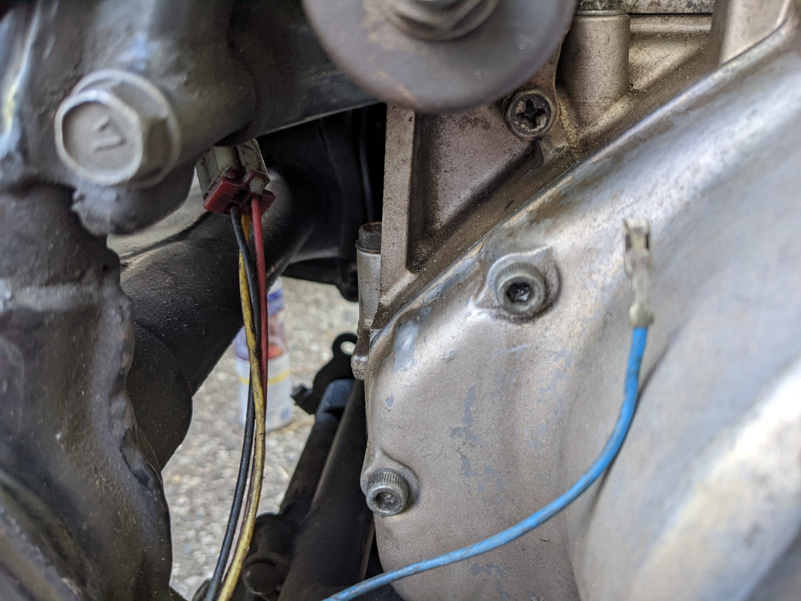

Load of help you guys are - I spent all that time redoing the connections with solder and heatshrink, no change. Had a eureka moment and found that one of my plug caps wasn't making a good connection to the plug. That also did not fix the issue. Had a eureka moment in which I found that one of the wires plugged into my coil-powering relay was pretty loose in the terminal. No change.
Guess I should have suspected something with the pickup sooner
Retaining tab on the blue wire was flat, so I bent it back up and it snapped back in fine. Voila, all four cylinders again. I really gotta get on modernizing the wiring...
...someday.
Seems like every time I come on here to ask for help, the issue is the last thing anyone thinks of, including myself. Remember when my coils were shorting to my tank?
Anyway. Thank you all.
...someday.
