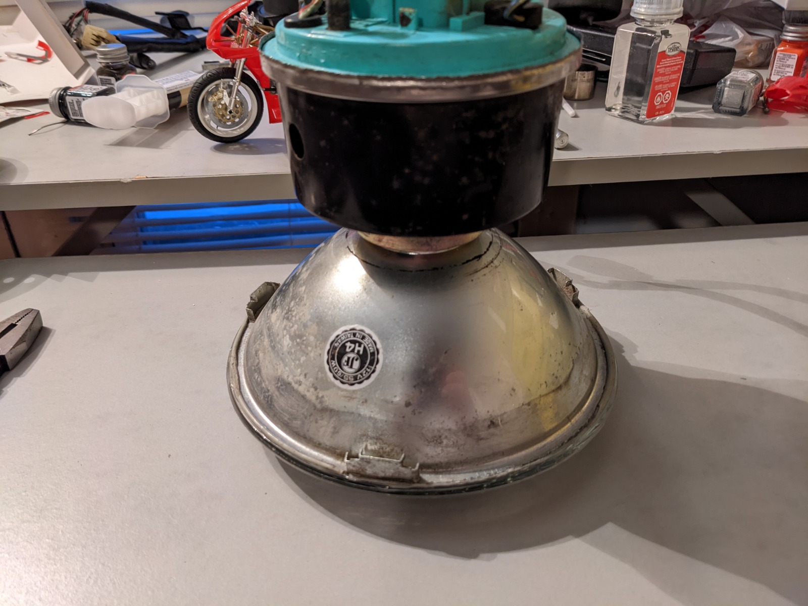

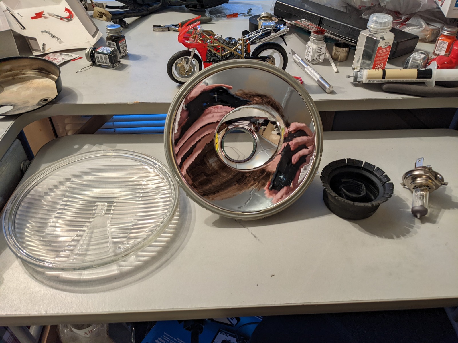

Old headlight was spiderwebbed with cracks and when I took my other one out of my Windjammer the glass popped off. I think I'm becoming an epoxy person... here's hoping I don't start putting RTV on everything too.

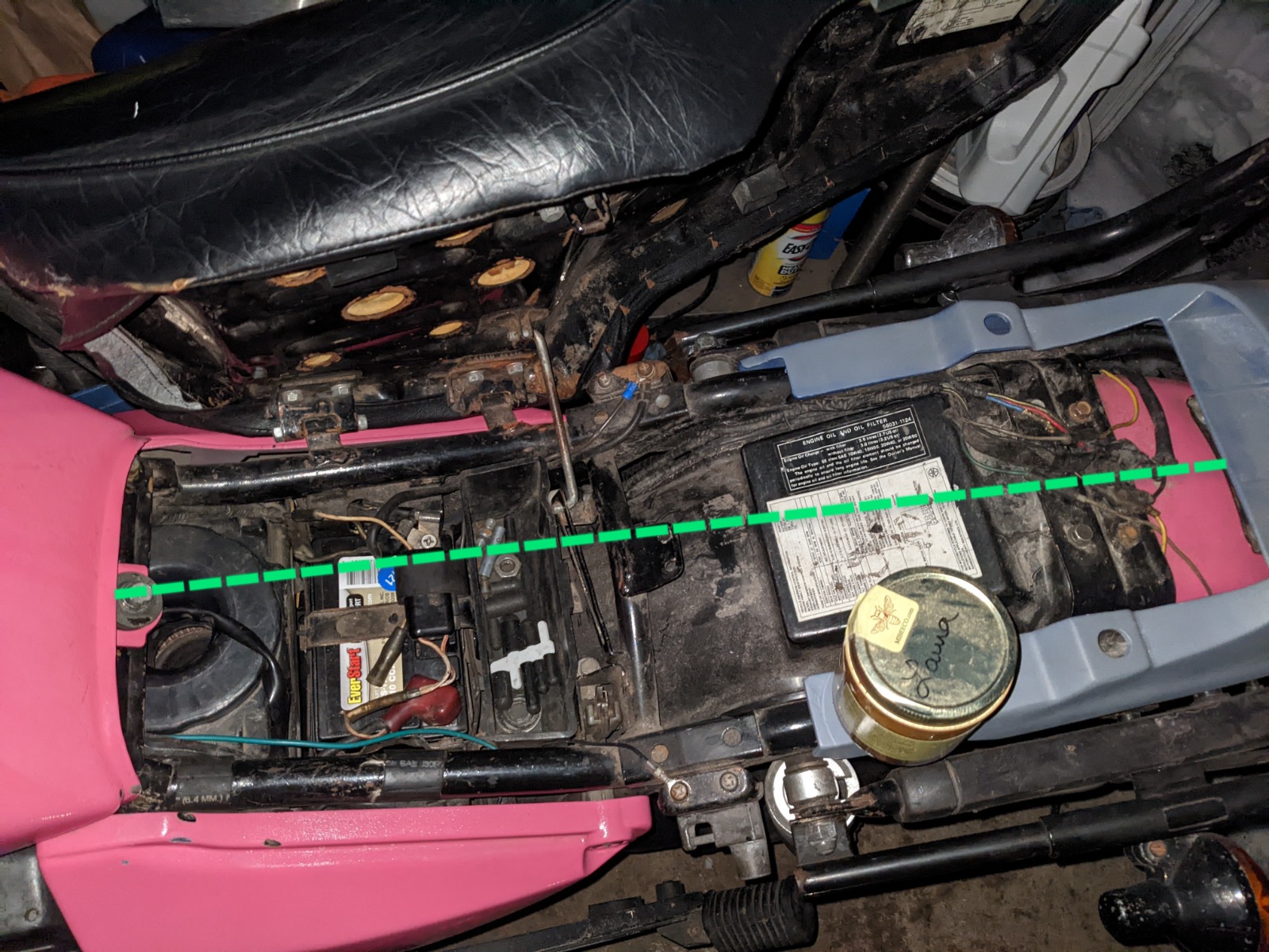

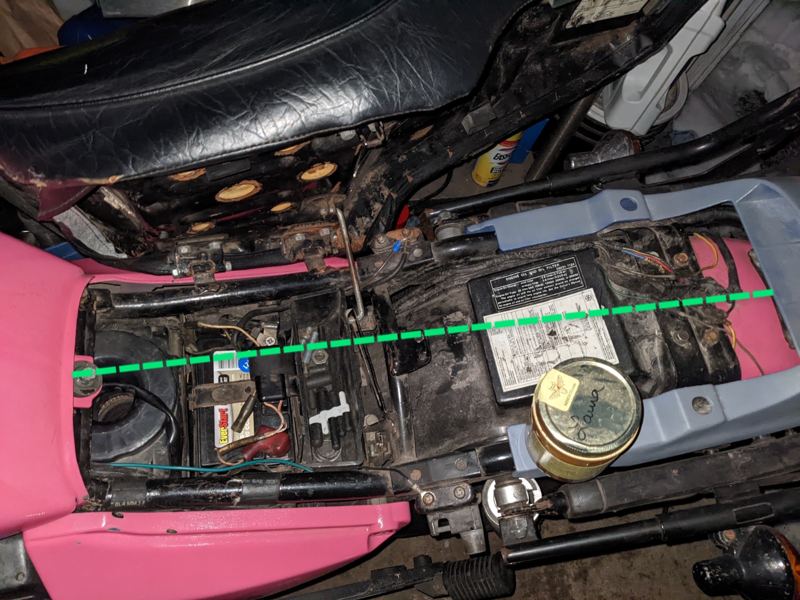

07 Feb 2022 16:53 - 07 Feb 2022 16:54Would any early big Z riders be kind enough to measure the distance of the dotted line on their bikes? The rear of the tank to the middle of the tailpiece. Where it sits on mine now - the most natural-feeling spot - is 60cm or a little under 23.75". It might be a pretty easy addition after all.
Limiting factors are my taillight (too wide) the seat (no cutout at the rear) and my grab bar (too narrow due to the thickness). Suppose I'll cross those bridges when I come to them - the taillight I don't care either way but I do like the 750N bar, so maybe I'll do some creative denting.

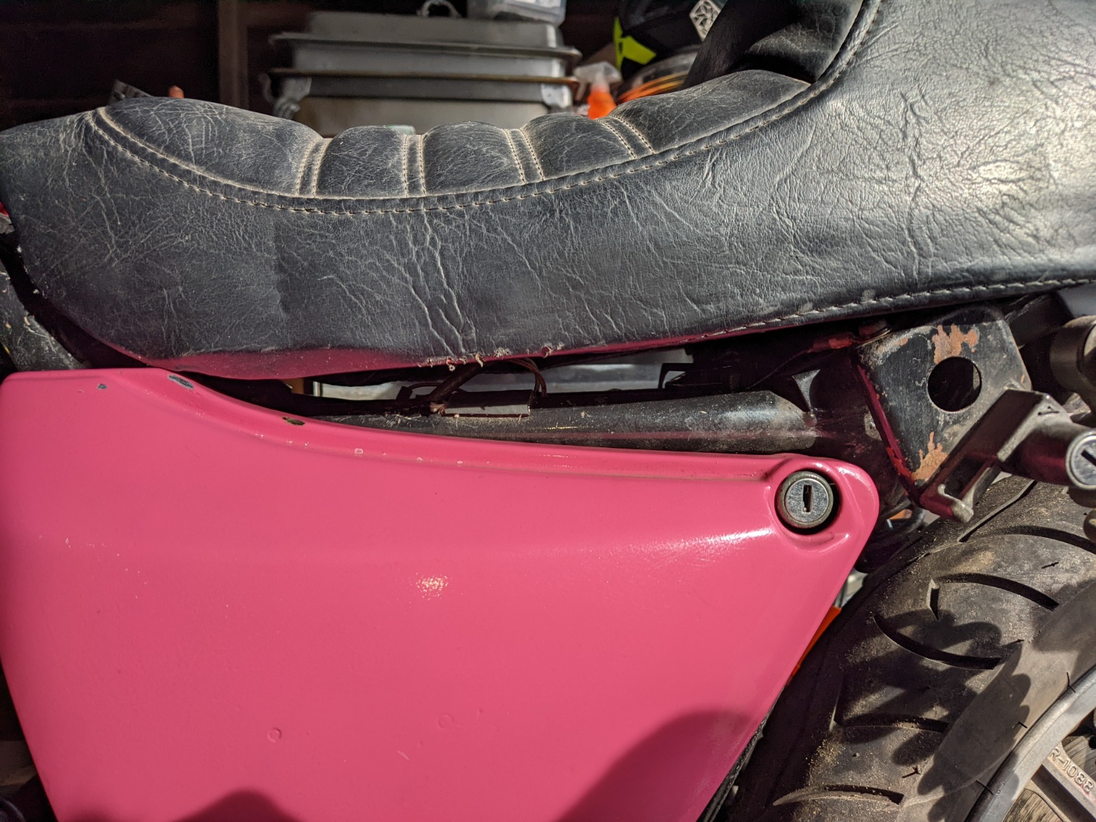

Suppose I've decided that the tail is in the right spot and the seat will fit fine - thanks to Mikaw for his advice on the matter. I'll do my best to hold off on committing to that until after I ensure there aren't more pressing big-spending issues. I'm a little bit reconsidering my plan to use the stock exhaust; I do like my bikes louder and it would be a lot of work I'm not equipped to do.

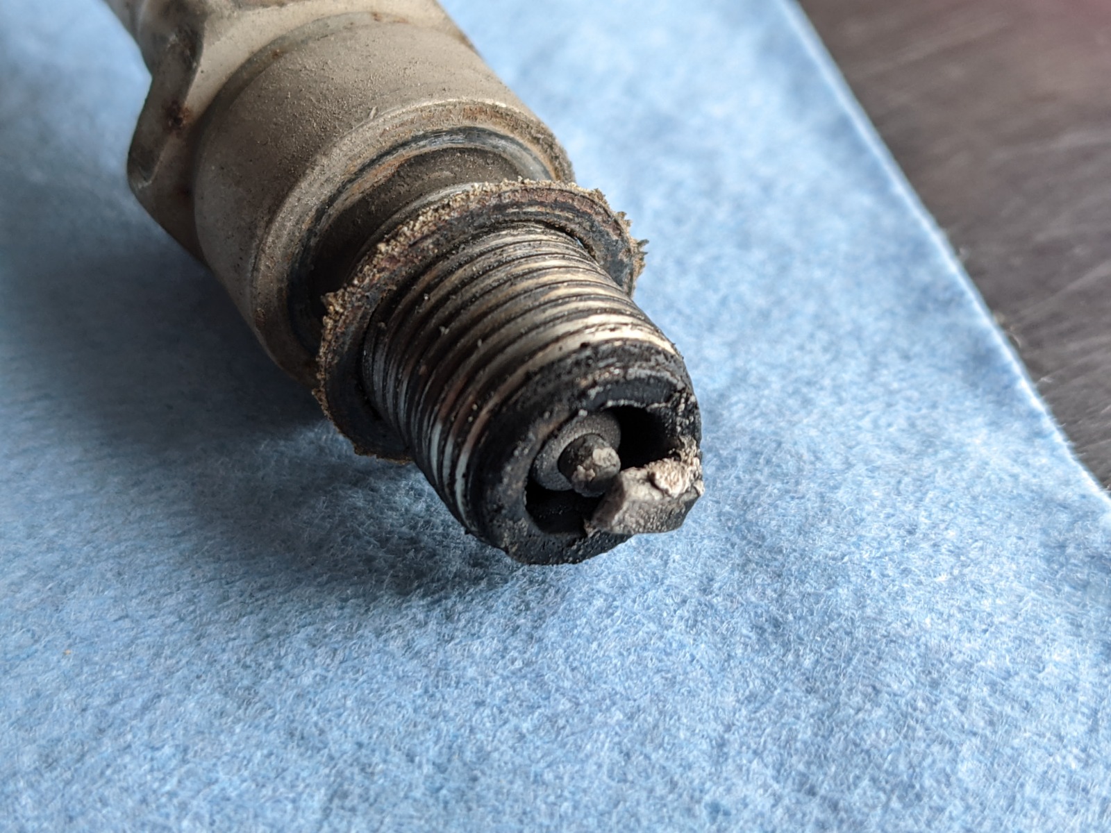

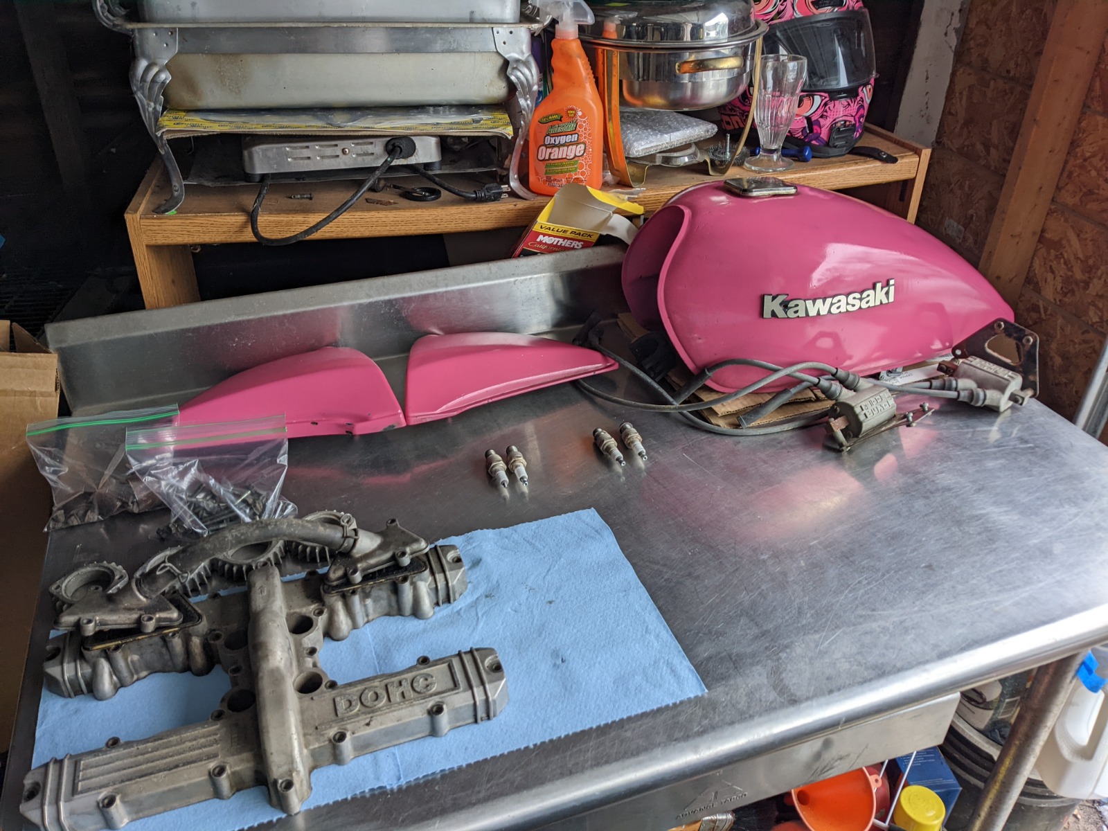

Spent a couple hours digging in. No major issues to note, thankfully, but a couple of my plug wires are now unusable - not a big deal since I'd like to have some with 90 degree ends instead. #3 plug did have some buildup:
Not sure what the cause is but I'm sure it's nothing. All plugs the same color, but maybe a little bit lean, which is probably from the stiff airbox boots - they were quite a challenge to put back on last time I was in the carbs.
Speaking of which, I'll reduce my main jet to maybe a 120; this will help with fuel consumption and bring back some popping, which I consider a win-win. The parts list grows.

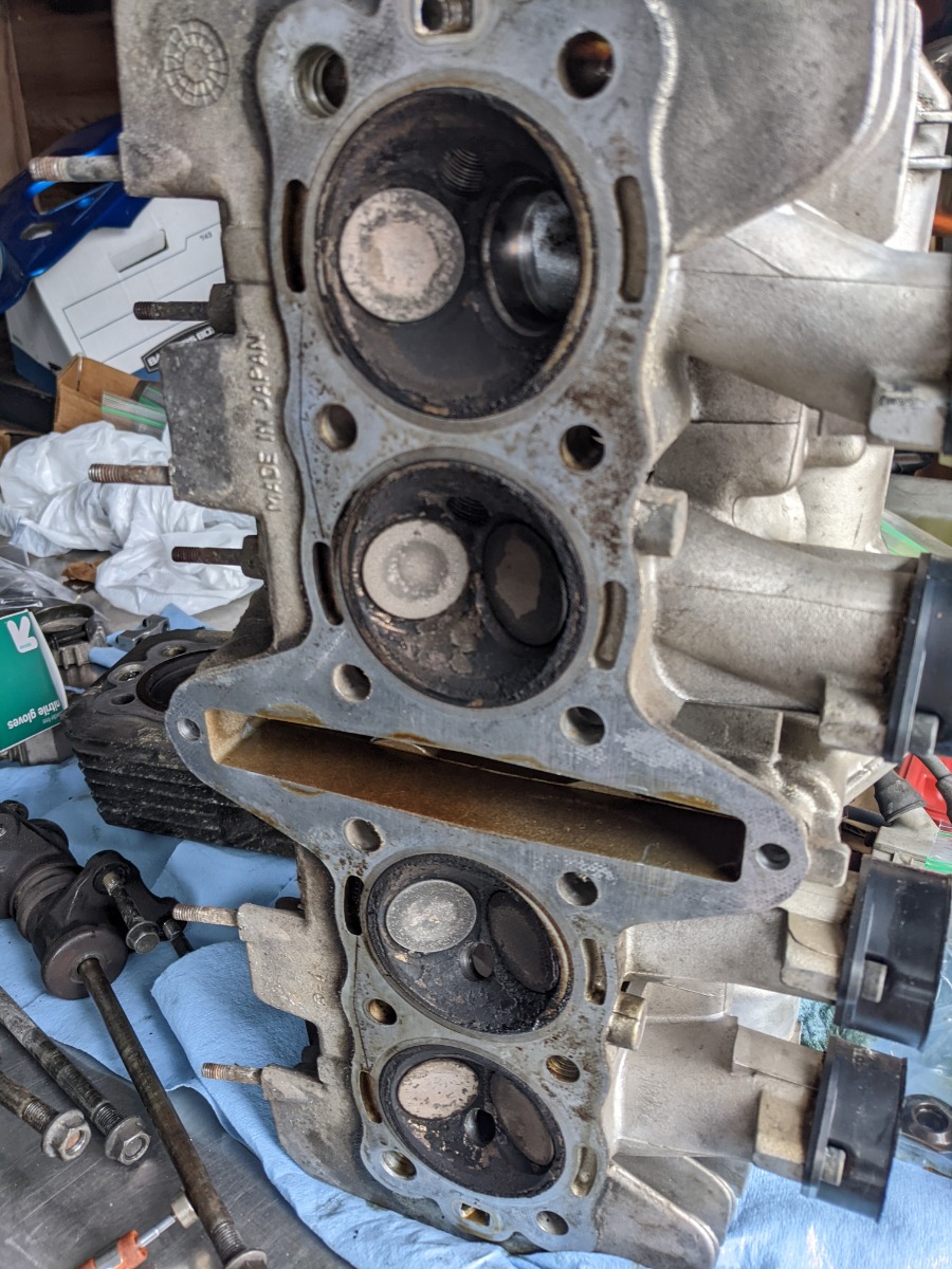

Woke up early from nightmares about frying wontons and dealing with customers...clearly I'm not handling the overtime well. I made the most of my time in the mid-40s morning temps by getting the engine ready for removal; it's a little heavy even without the head and cylinders so I'm gonna wait for my girlfriend to help me out.

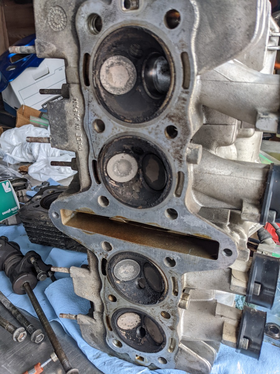

I've seen much worse, so I'll scrub this off and lap the valves; I've got some viton seals as well. The pistons aren't too carboned, but I'll focus on cleaning and reringing those so I can see if I need to add any rings to my big Partzilla order. I know it's a distinct possibility I'll snap one or more of my new ones. EDIT: after checking the price of am OEM ring set, I have resolved to not snap any rings.

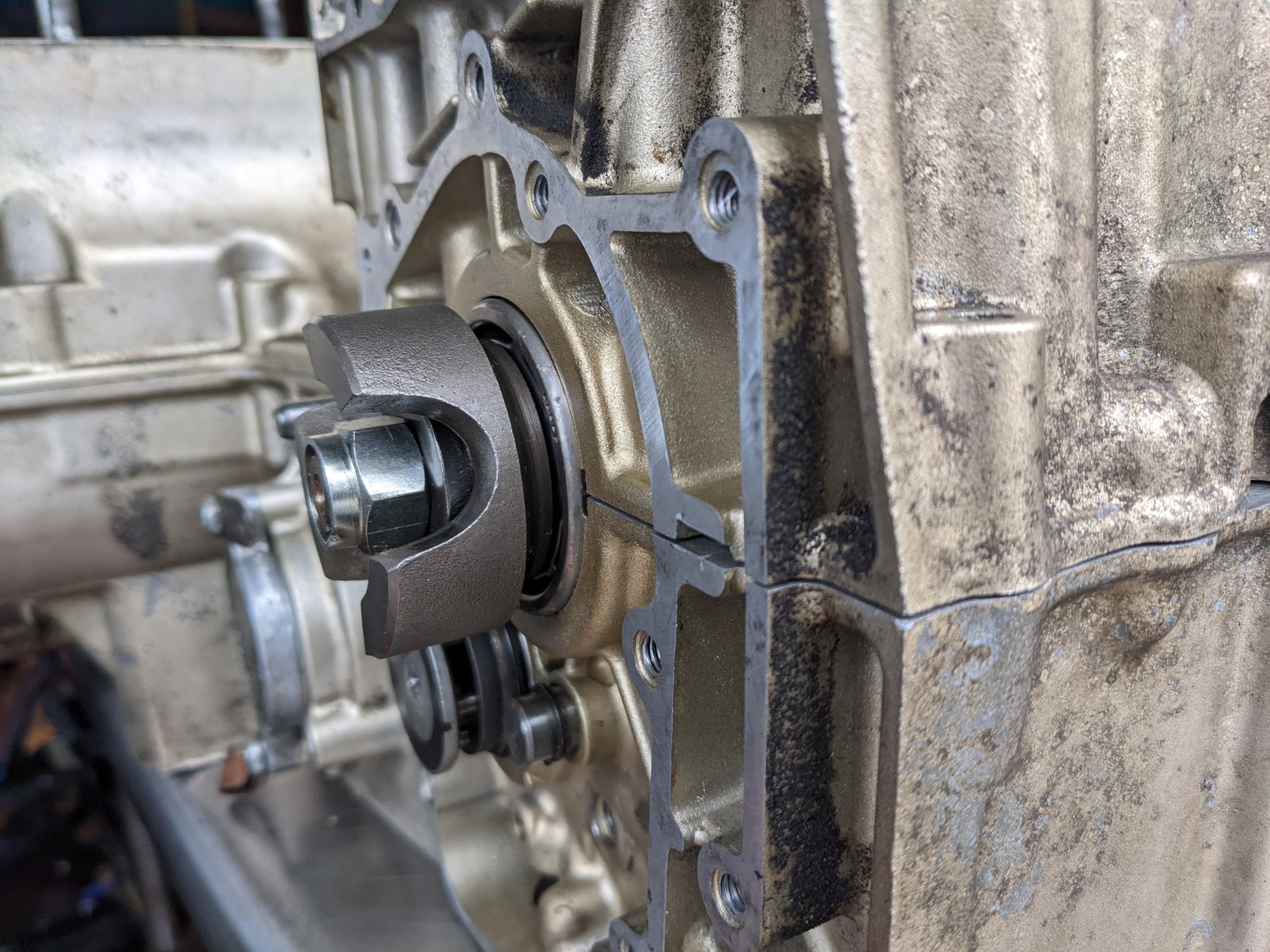

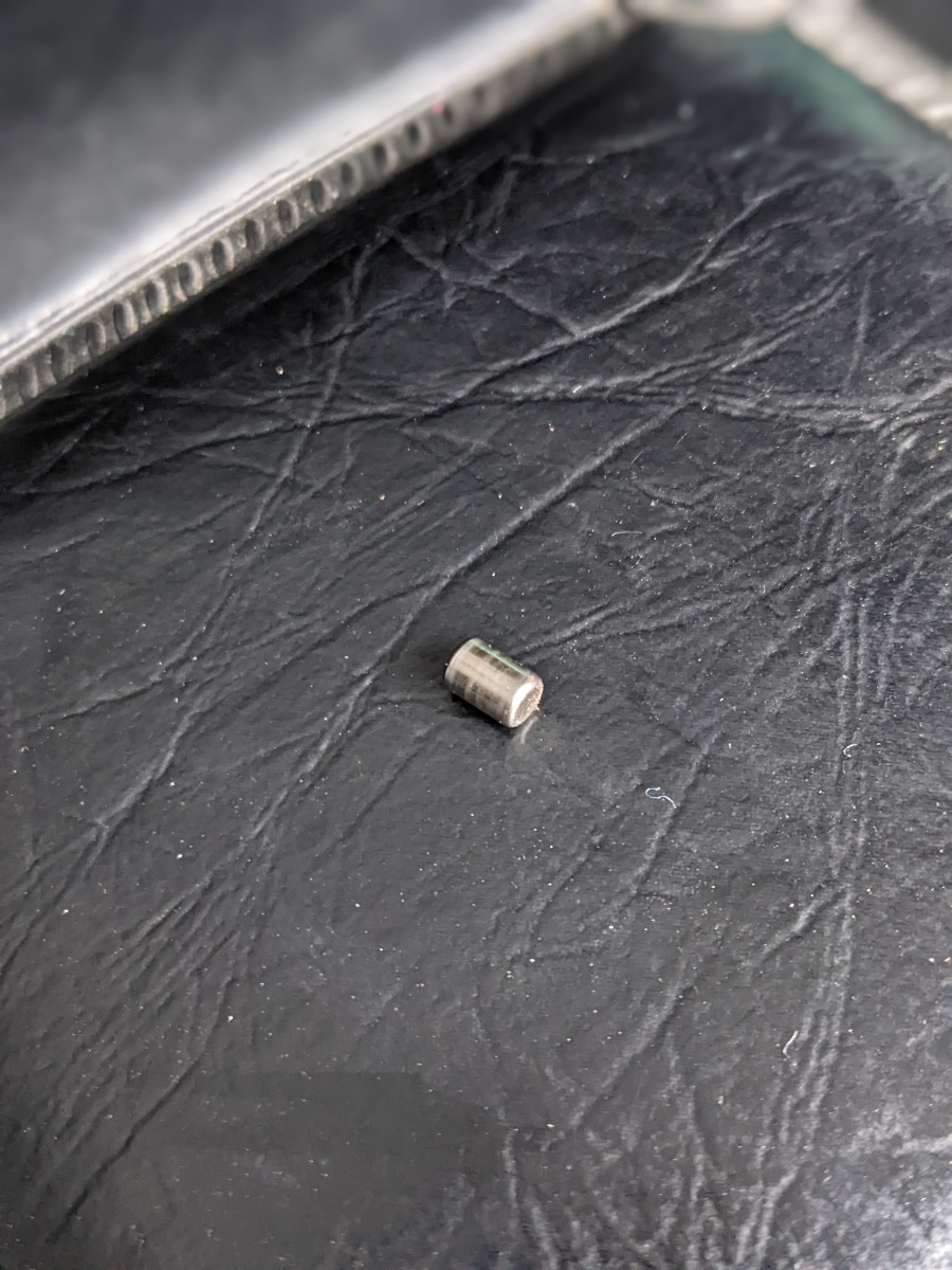

The bane of my existence as a shafty owner is this dowel pin - no easy way to press on it when you're removing the shaft! I got it done, but jeez. Not my favorite.

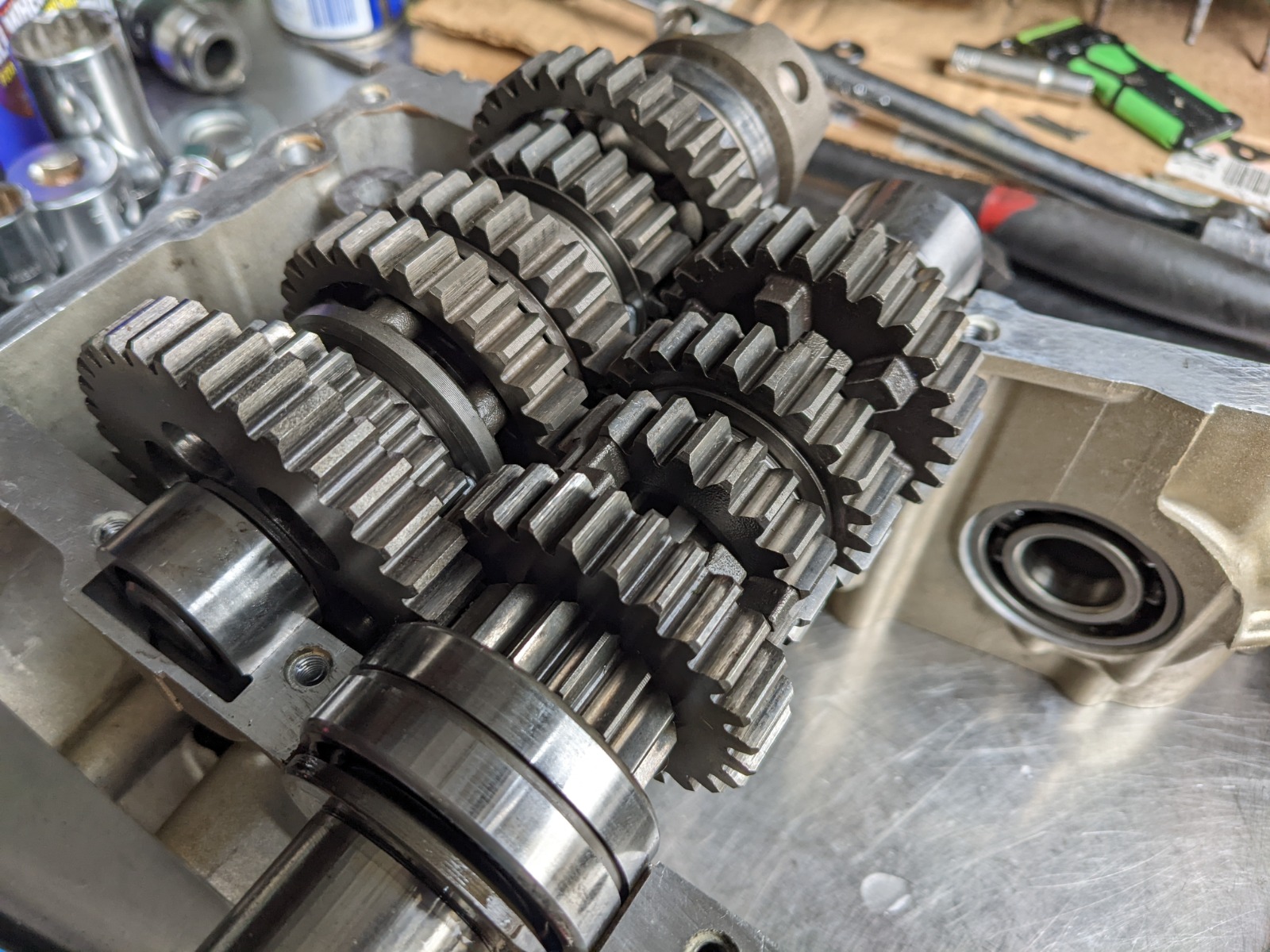

The transmission in question; it's from a 1983 550 shaft, which is very exciting for me as it has six speeds. If my research is correct, I'll essentially have a stump-pulling gear followed by the five speeds I had before, with the final gearing being slightly lower than before - guessing my RPM at 70 will be around 4k.
