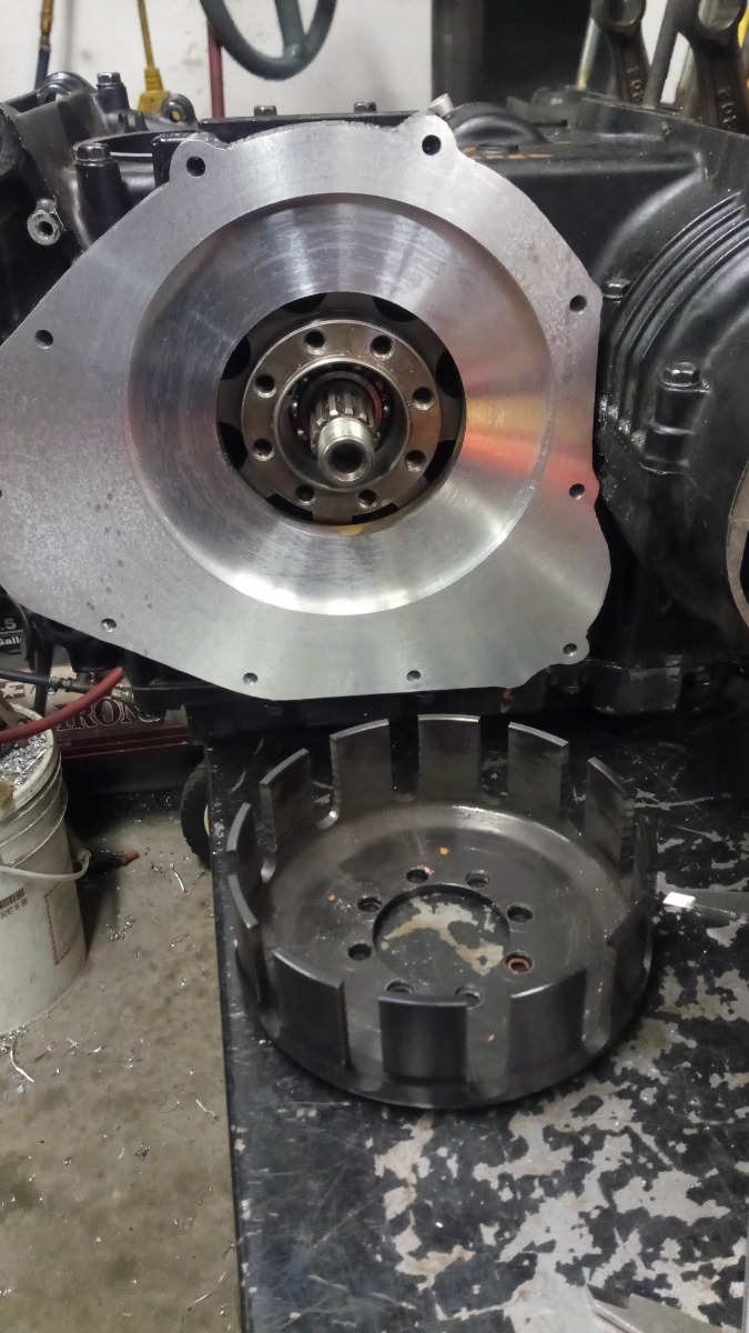

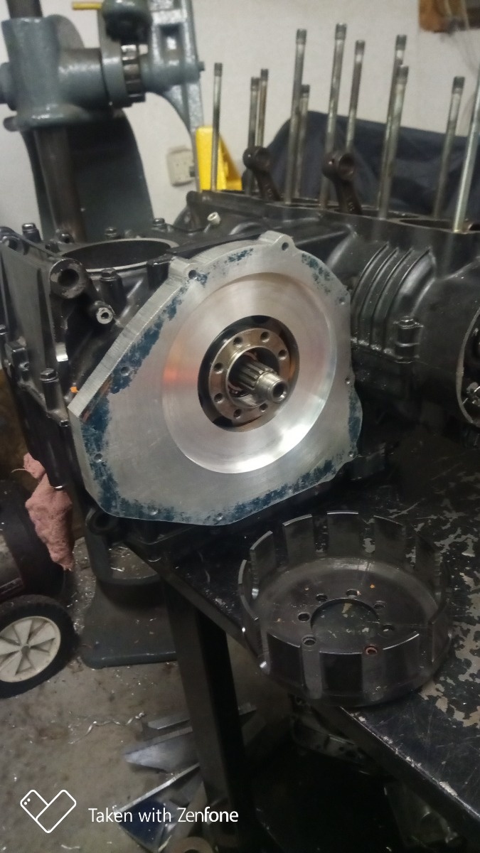

Built this road racer a few years back
As a challenge , it's been competitive
Now I've decided to go down the rabbit hole
And build a dry clutch
Took lots of pics on the build over the last month,not tooting my horn yet because
Only 75% complete,but looks promising

It would be interesting to see how you did that.

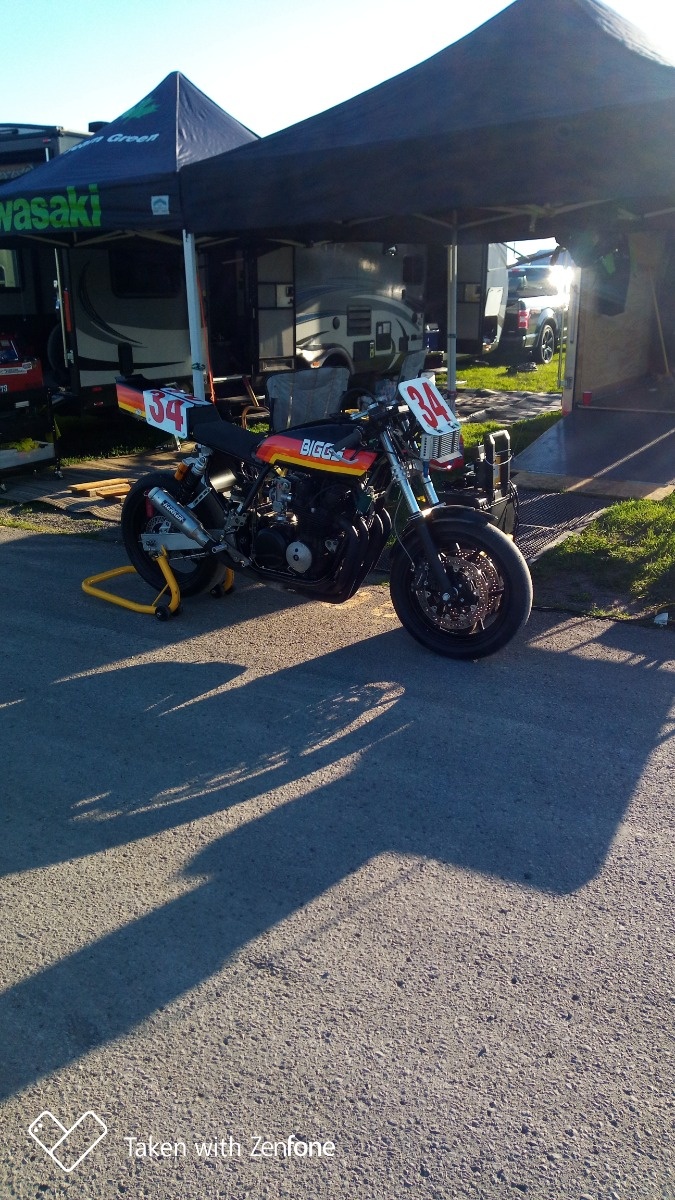

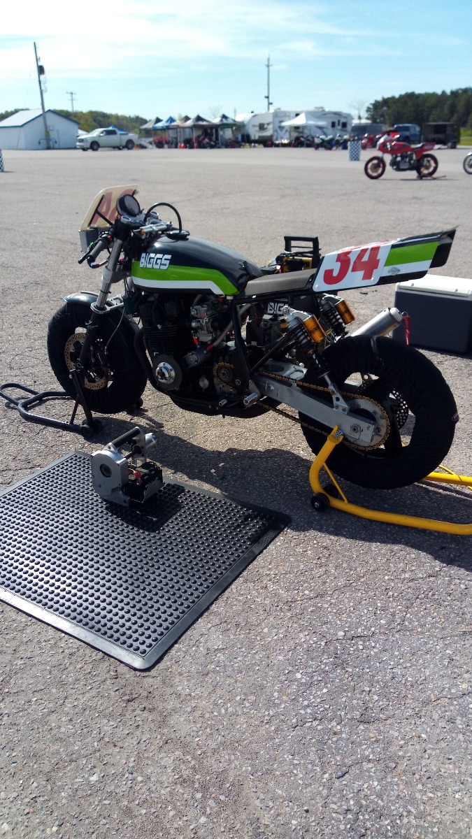

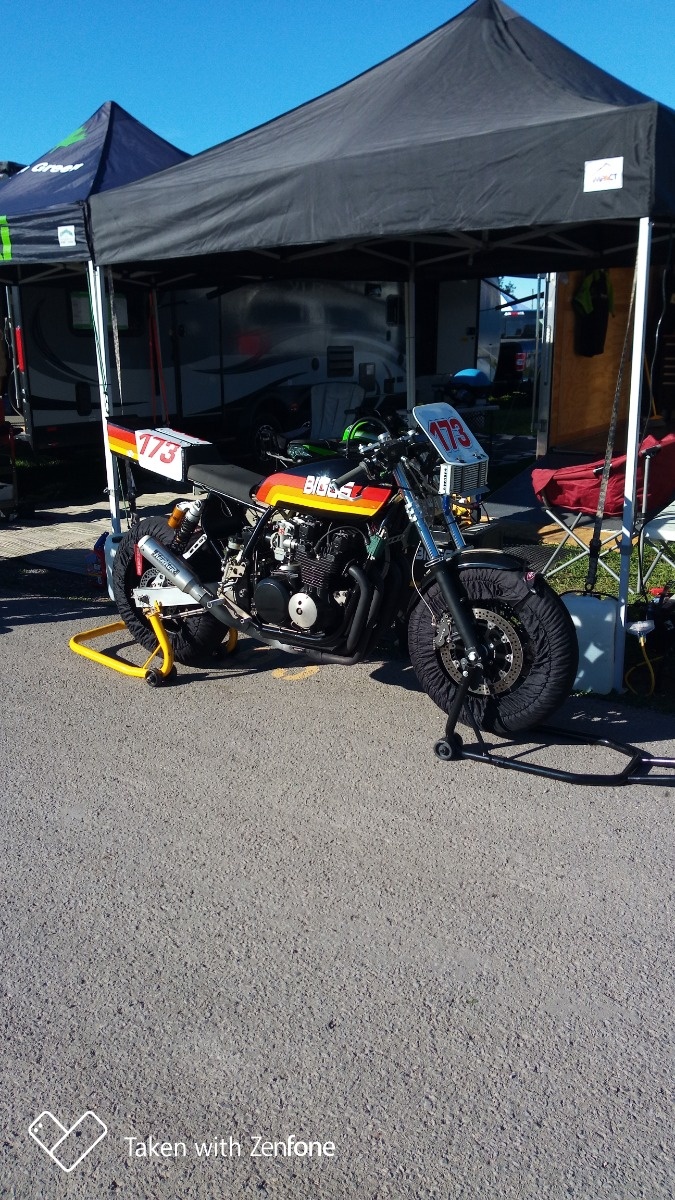

Looks like fun. Are those two different paint jobs, or are the stripes different colors on different sides? Also, what's that gizmo with the tube coming out of it located where the starter motor used to be?

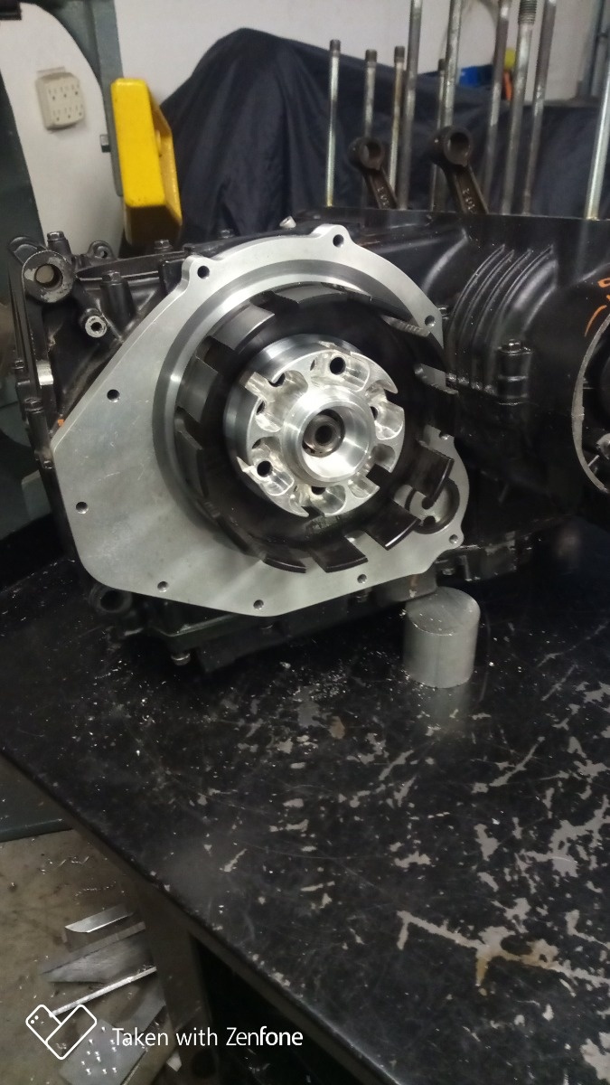

Gizmo is my remote starter
Slide into cog ,hit button using one hand
No kick ,bike starts then remove
That's another project LoL

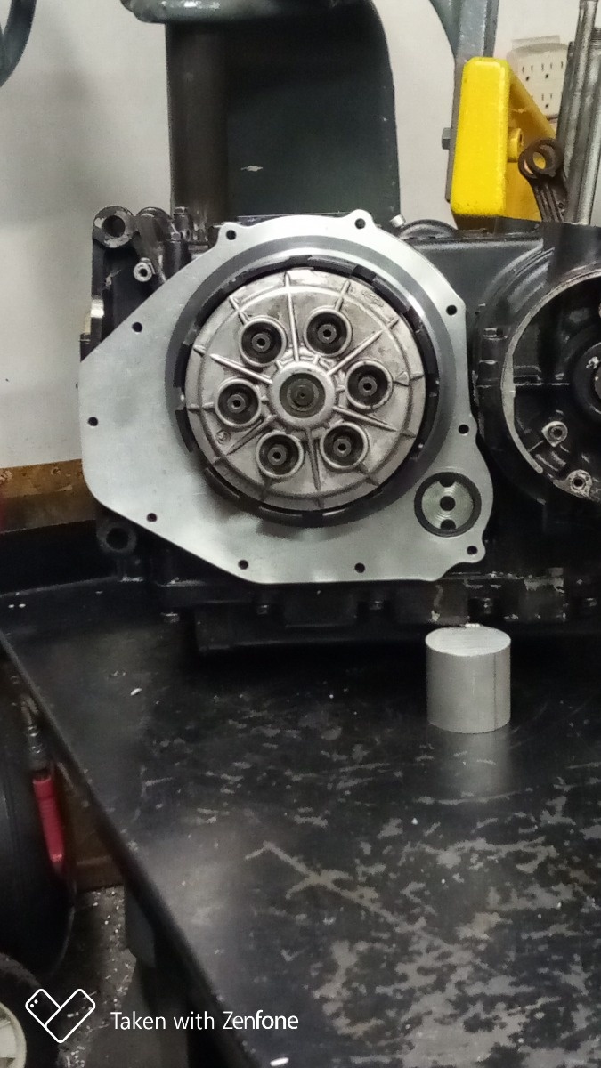

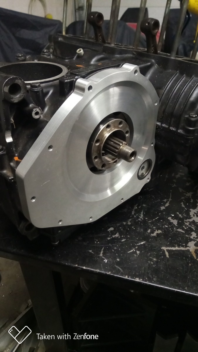

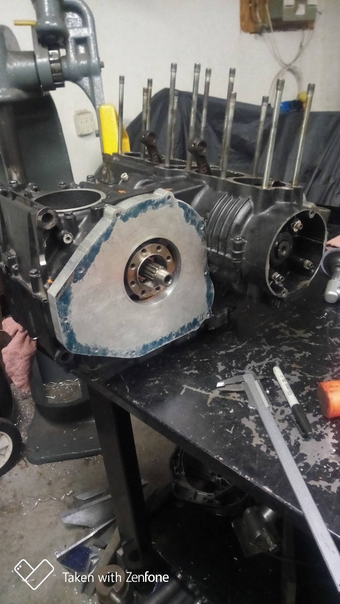

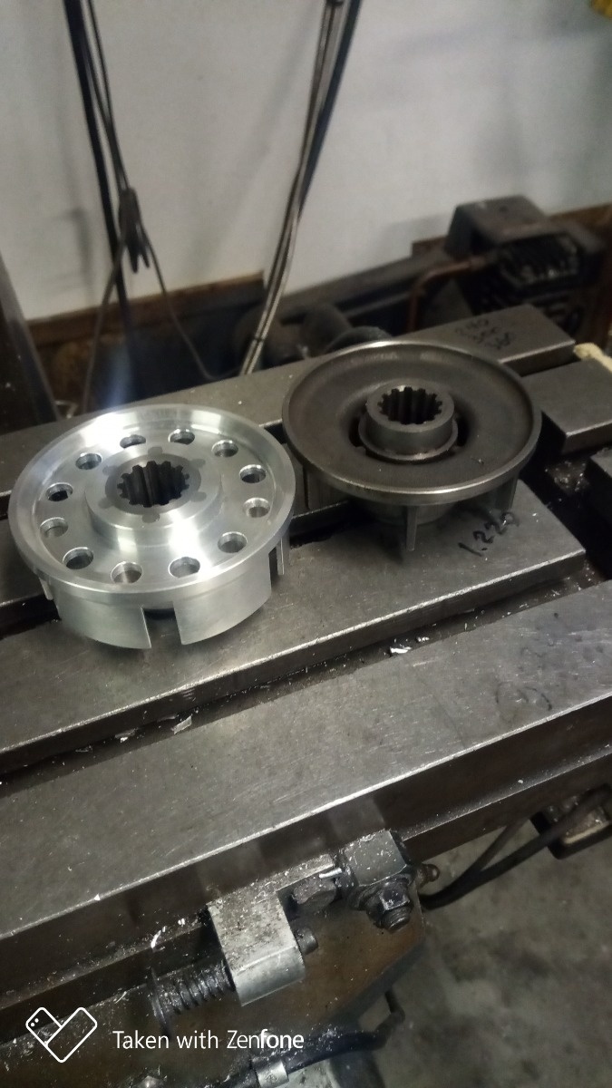

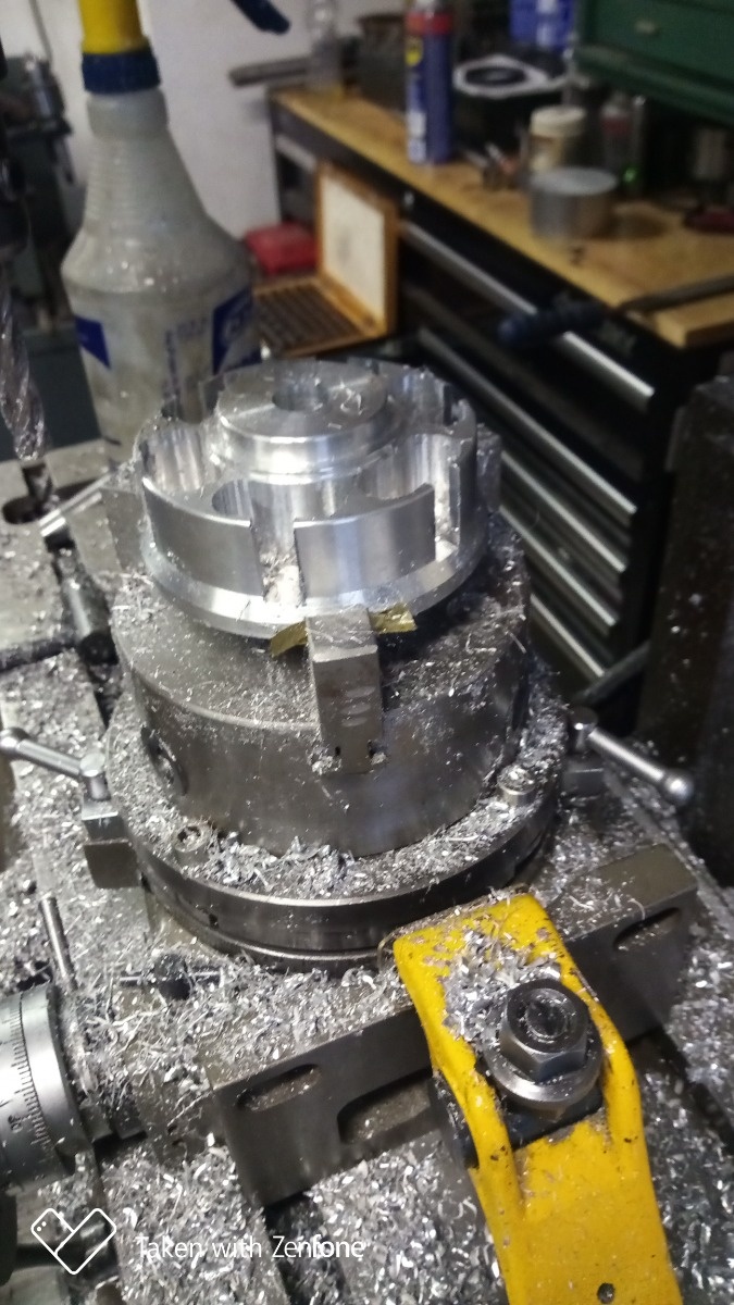

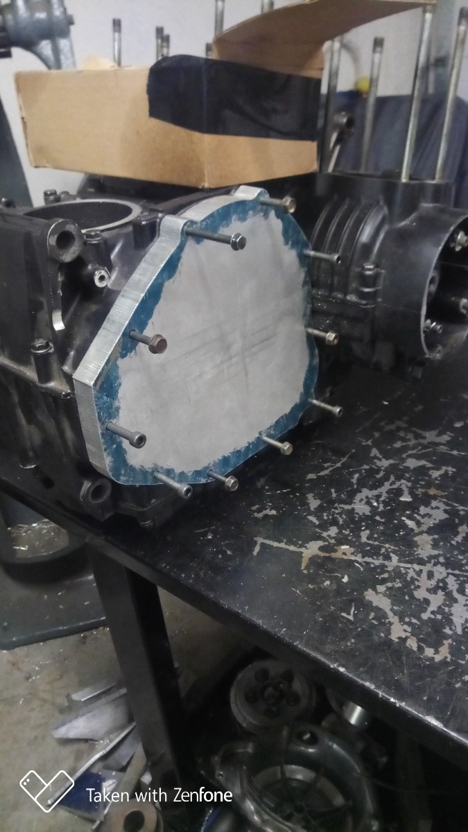

I will try the insert,I'm better at machining than tech Lol

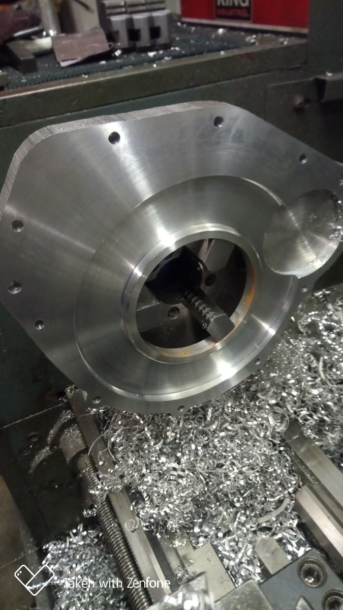

Basically I used a Ducati monster tried and trued dry clutch and slowly converted to kawasaki

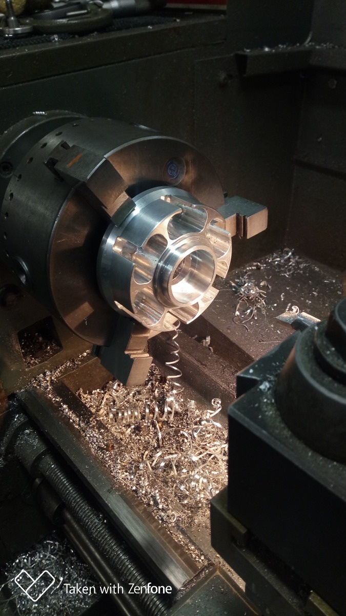

Wow impressive machining, and the bike looks great too. any more pics of the bike? what organization are you racing with? keep the pics coming!

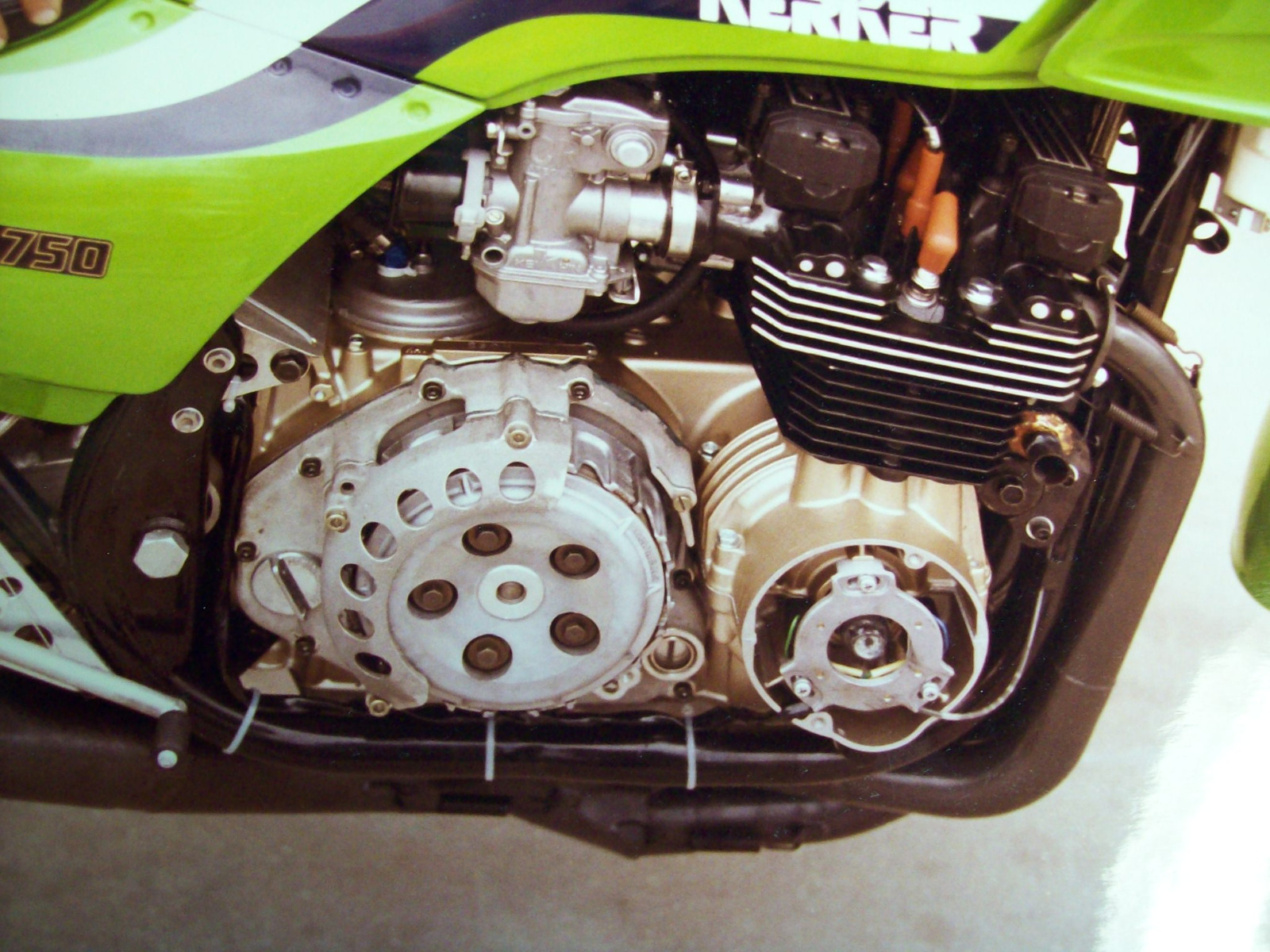

Interesting project!!!! Going to keep an eye on this one for sure!!!

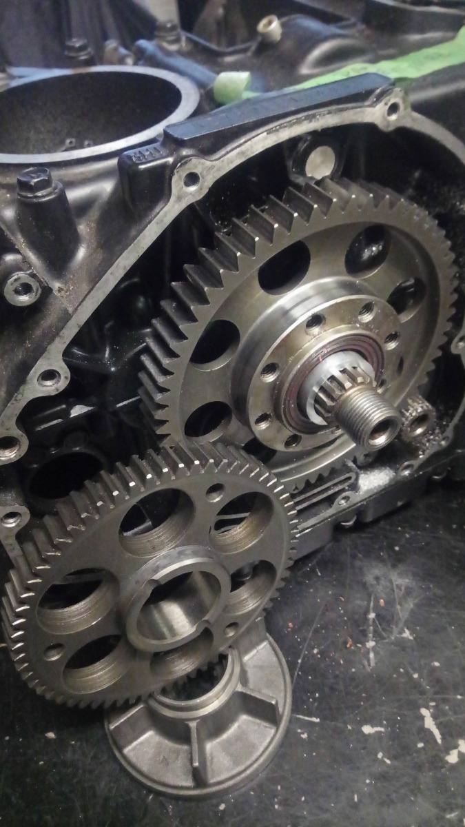

Here is a close up shot of the dry clutch set up on the factory GPz750 Kawasaki that Mr. Muzzy put together back in 1983.

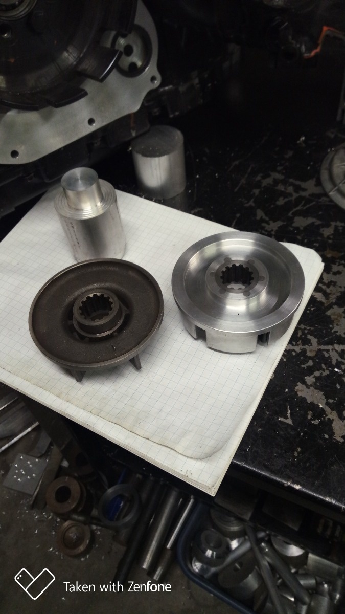

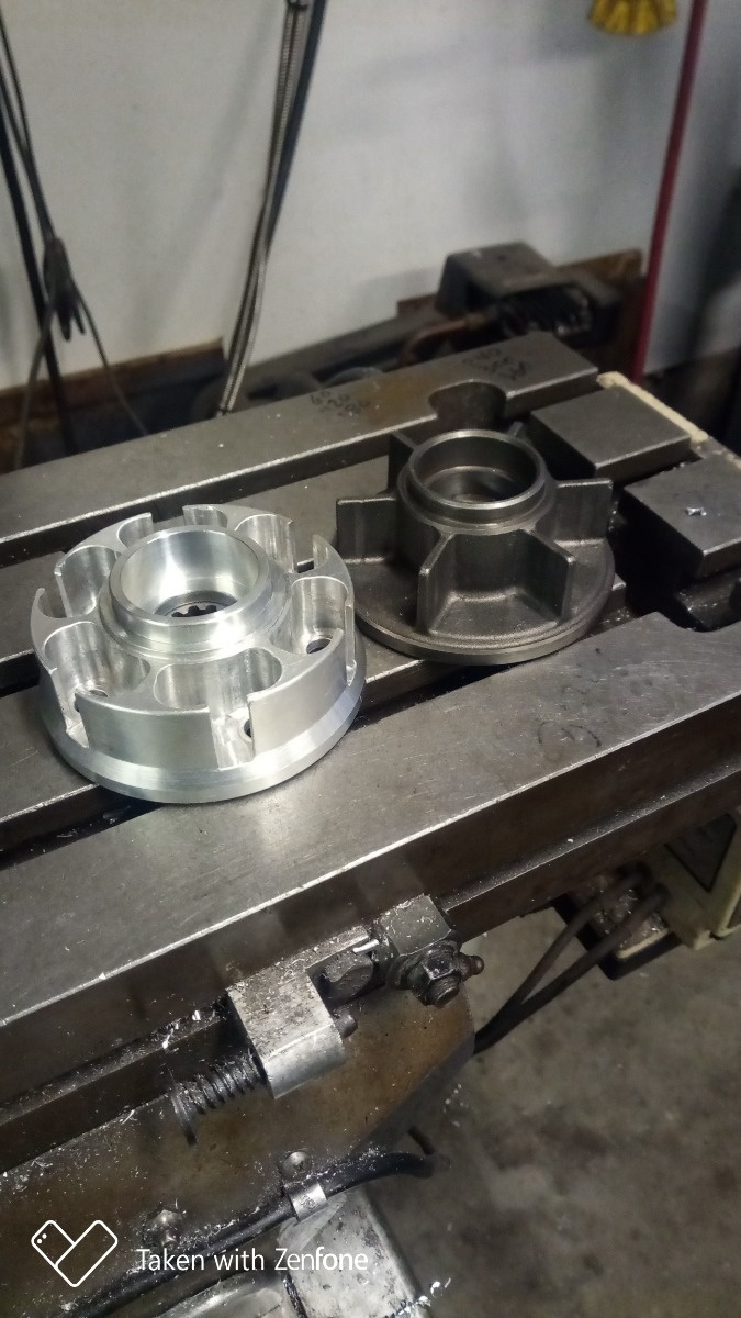

03 Jan 2021 13:46

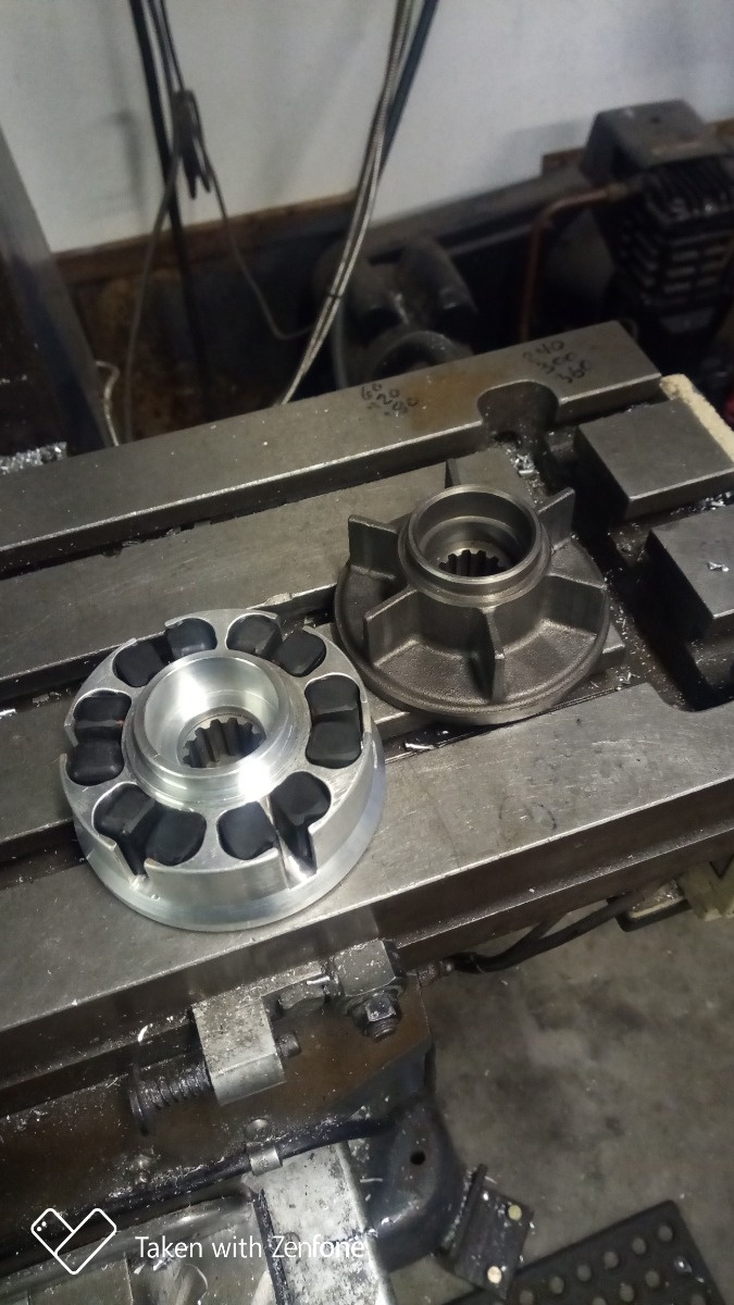

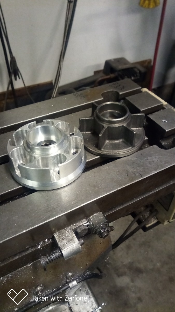

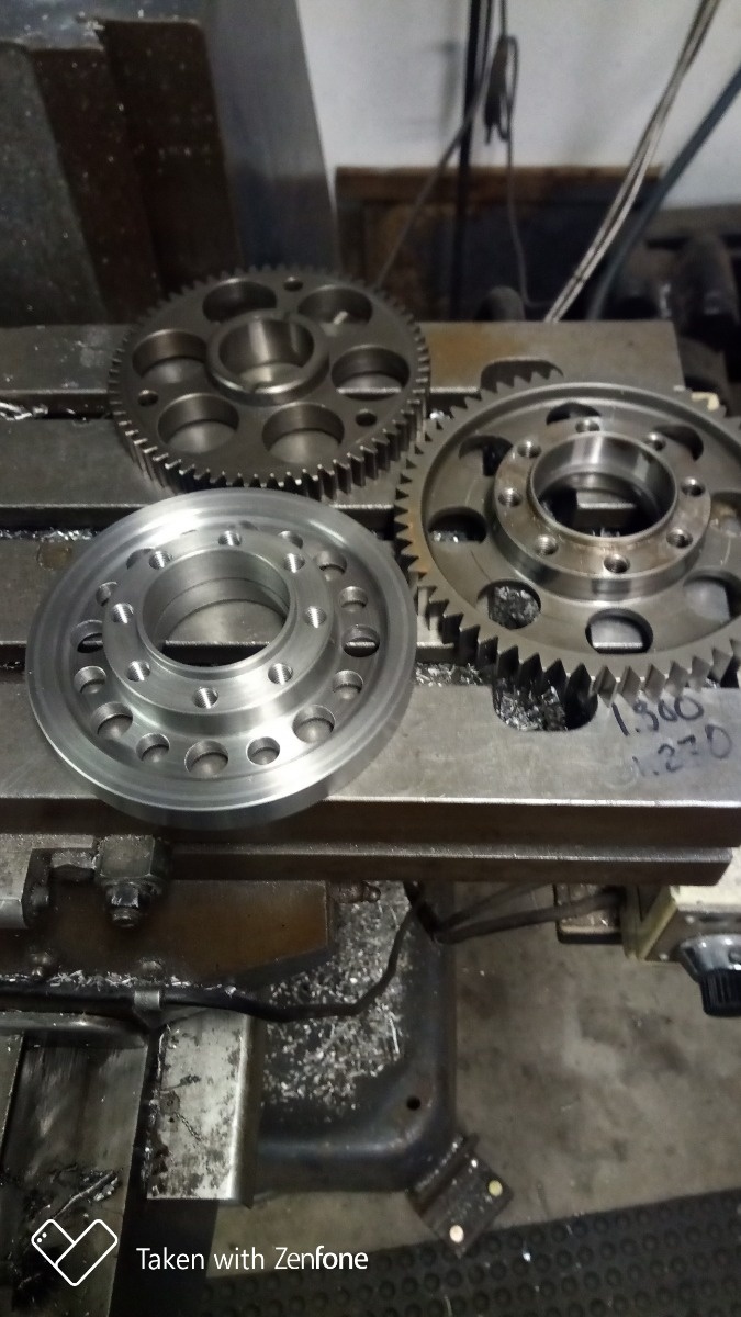

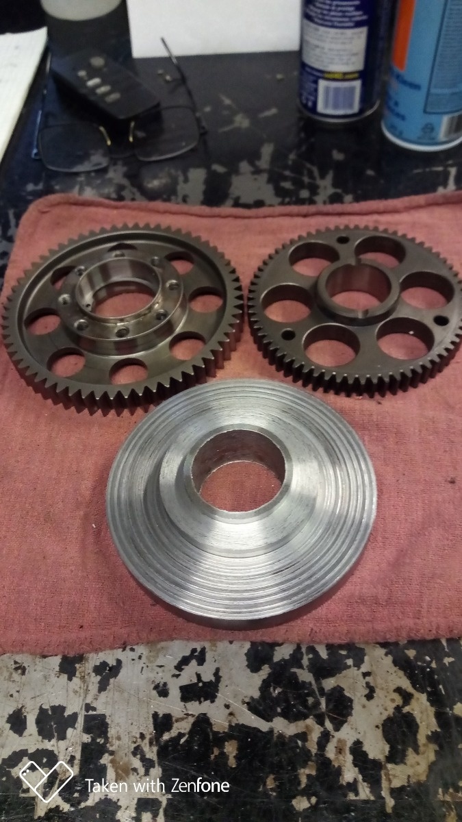

This shows how the Ducati cast iron cush drive was made into a different design
Using aluminum,the original Kawasaki clutch basket spline was removed from the cast alum basket and pressed into the newly fabricated billet cush drive
