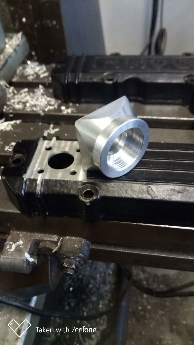

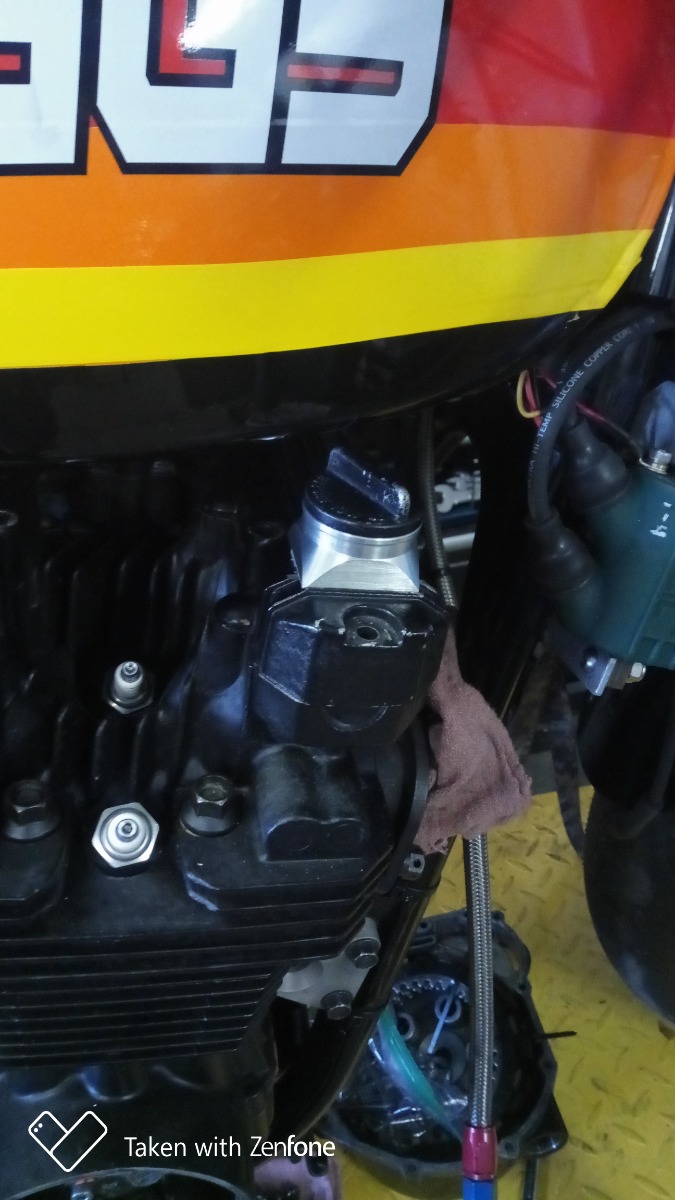

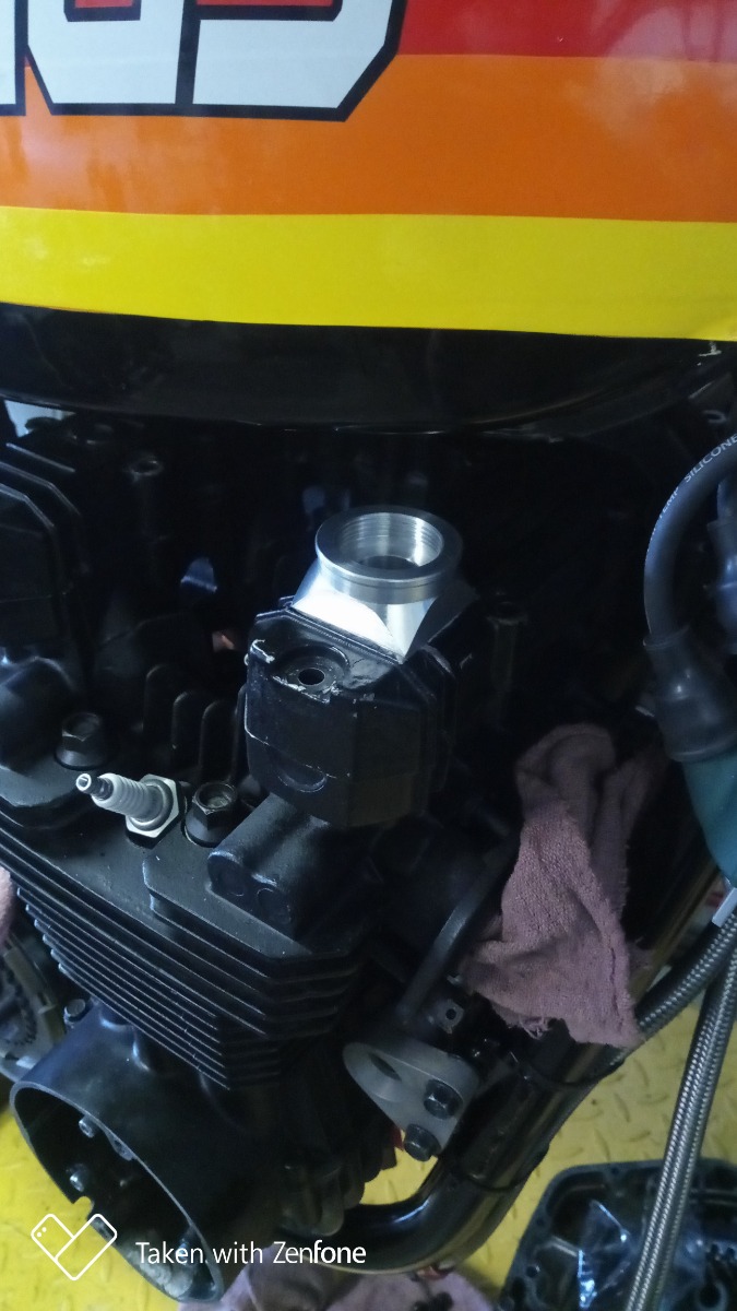

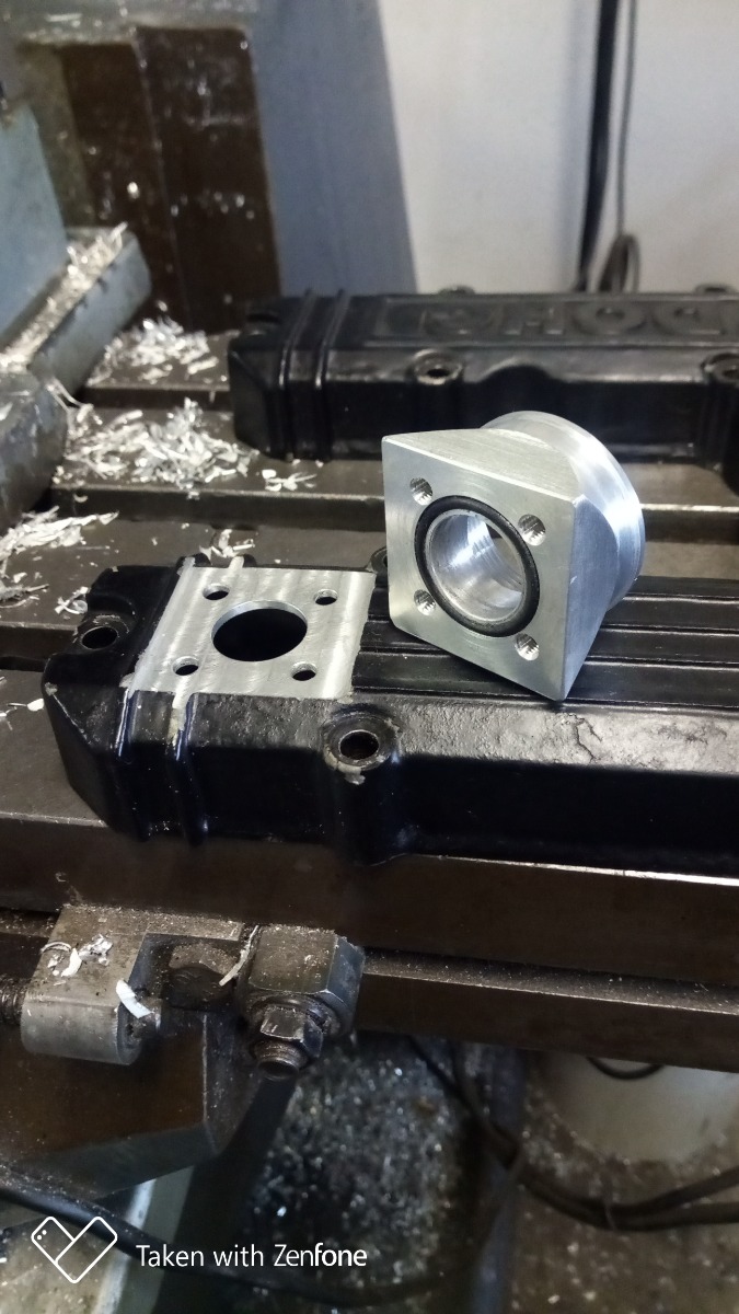

Because the lack of room on the main housing, the oil filler location had to be relocated
It's not ideal but sometimes there's no choice

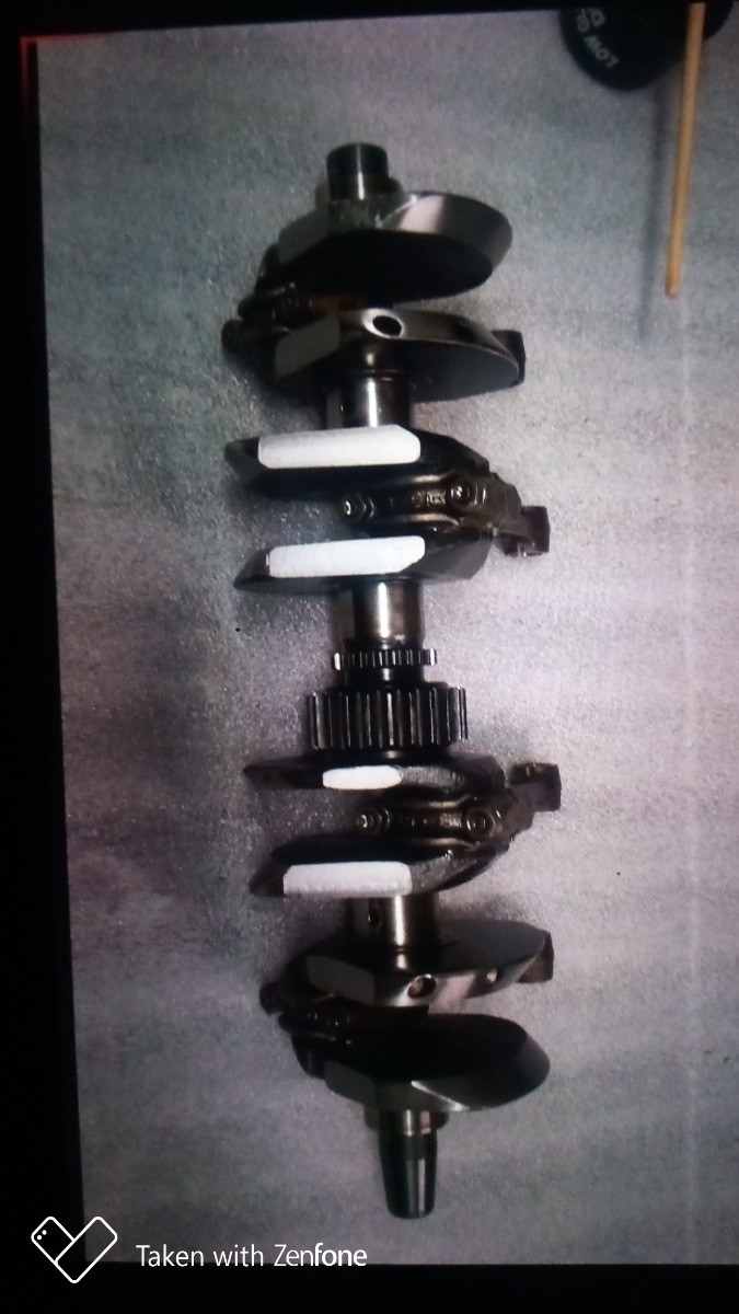

Hi richard, top shelf work you are doing there mate.

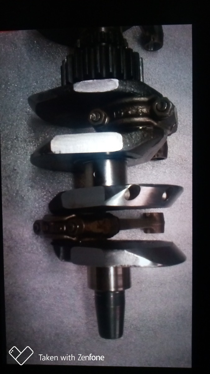

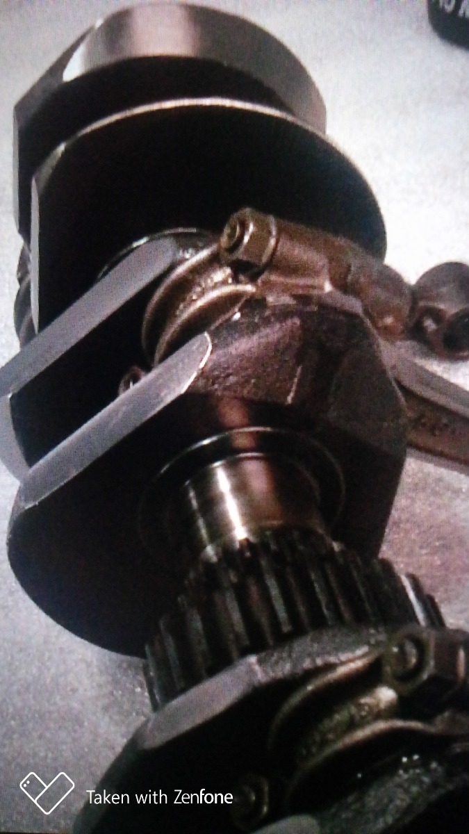

I was wondering if you have a record of the process when you lightened your crankshaft, I'm sure many here would be interested in that aspect of your build.

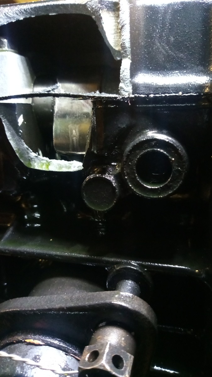

I might have a picture of the crank on my old lap top
Will look this evening
I read so much on the subject that it was dizzying , heavy good , heavy bad ,decided to look at typical modern performance motorcycle crank for inspiration R6, Busa,zx10R
If it's a fail I simply put a spare stock one back in ,
Needs to be properly balanced in the end
It was a successful, very snappy and responsive

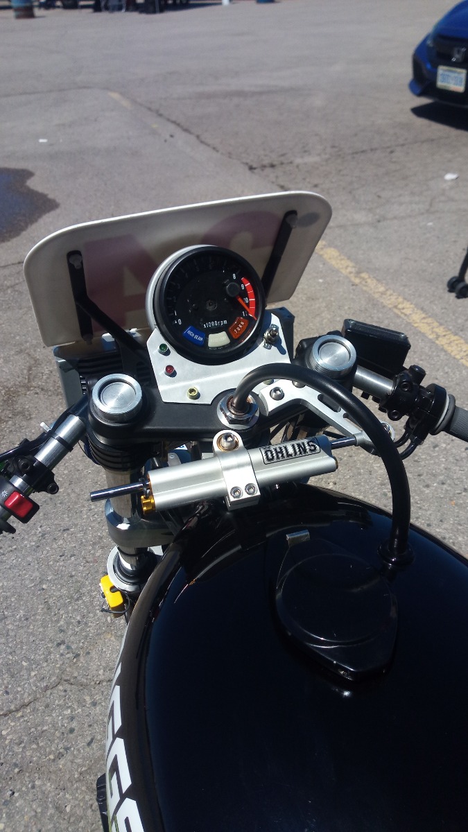

I seriously broke 2 kz1000 J tach needle
In 2 weeks and my spare Autometer tach
Needles kept falling off after 1 session
Even though they were soft rubber mounted
I don't have a proper explanation
This KZ revs far from a TZ LOL
have gone digital since
Picture shows needle at the bottom of the tach window

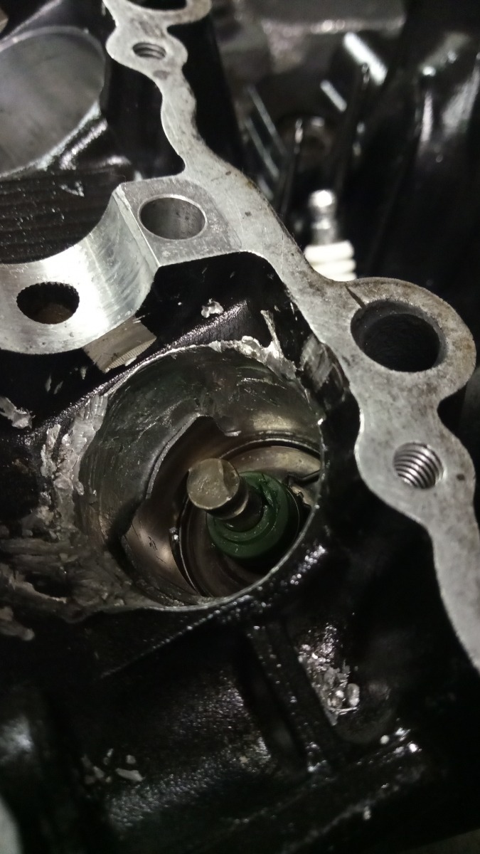

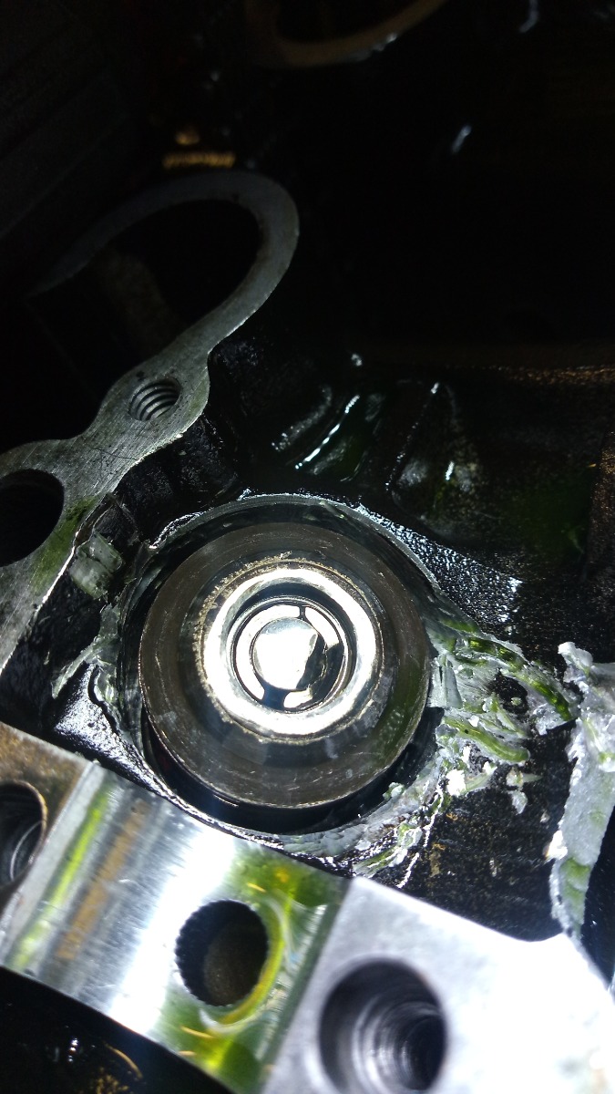

With gains come losses

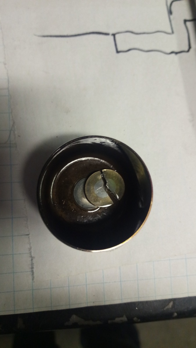

Because the lack of a tack and rev limiter
At one of the races,my rider had an engine failure,he said the engine was happy and pulling high RPMs
Problem is what is high RPMs?
I suspect close if not above 12 000
Pics show the damage
Bucket went through the head and broke 3 shims
It's rare to break those tiny shims let alone 3
It's all back together with a new head
And running great,....rev limiter now set at 10 500 to avoid that mess again

Dang!! That's a Wake...up call!!
Re: Kz 750 road racer , dry clutch project
11 Jan 2021 18:05 - 11 Jan 2021 18:06
So the lesson is that revving an engine far above the manufacturer's redline limit can cause serious engine problems. Gee, who would have ever expected that? :laugh: Ed

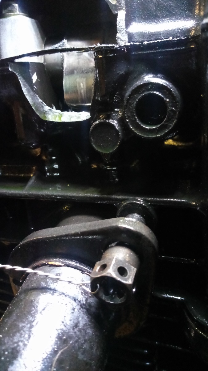

These are the pictures of the crank
I'm no expert on the subject but was
Pleased with the turn out and how it performs , it was outsourced for proper balancing

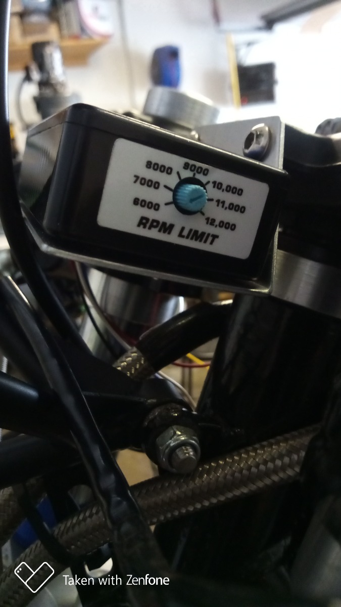

I have thought about a rev limiter for my build to, just to get rid of the gauge.
I´m new for that typ of things, but that thing you have looks easy to use?
- richard
- Posts: 84
- Thanks: 15
12 Jan 2021 09:21
Very easy to use
If I remember correctly 3 wires
Easy install,
A good back up when eyes are focused
On the track
Easy install,
On the track
